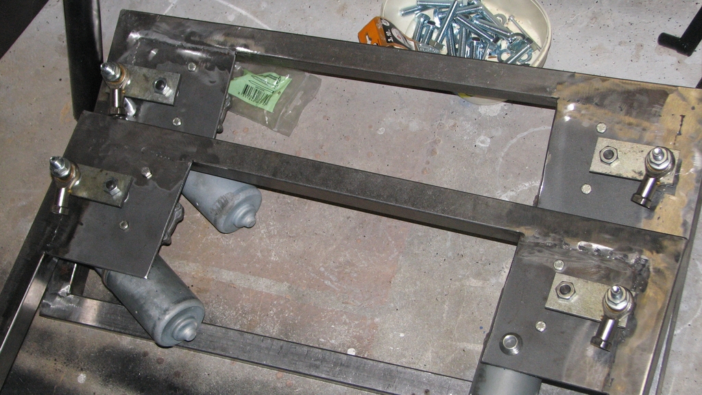

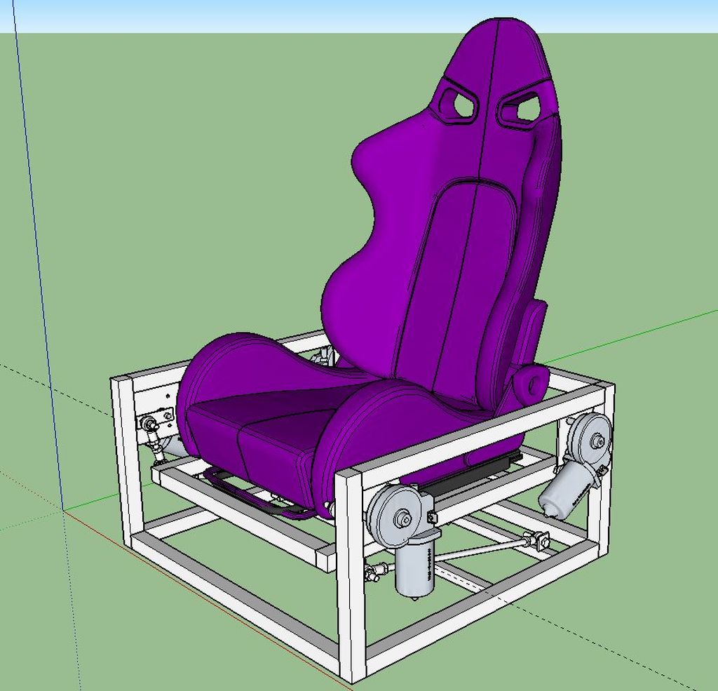

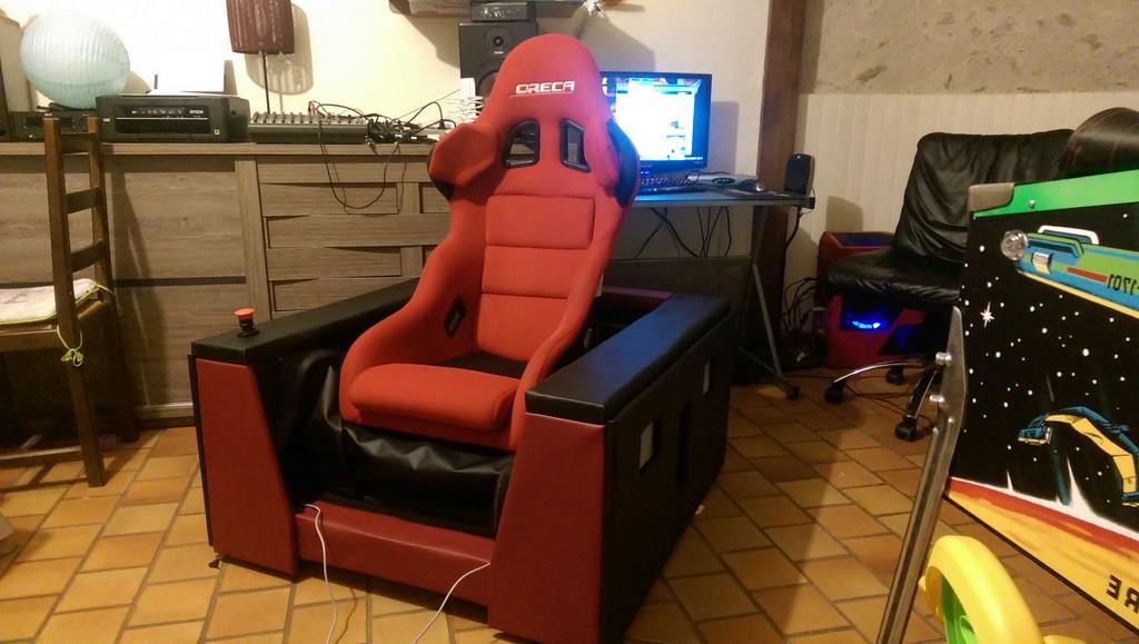

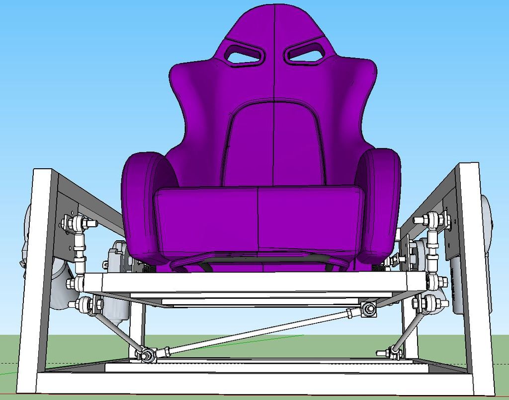

  6. mariano68
    mariano68 Active Member
    Nov 15, 2014
    574
    builder contractor
    Argentina
    3,341Coins
    +394 / 2 / -0
    2DOF, Arduino, 4DOF

    Hmm, that's a really neat looking rig, though it doesn't necessarily include the pedals and wheel, which is a little of my problem. Seems like you could add them easily enough.
