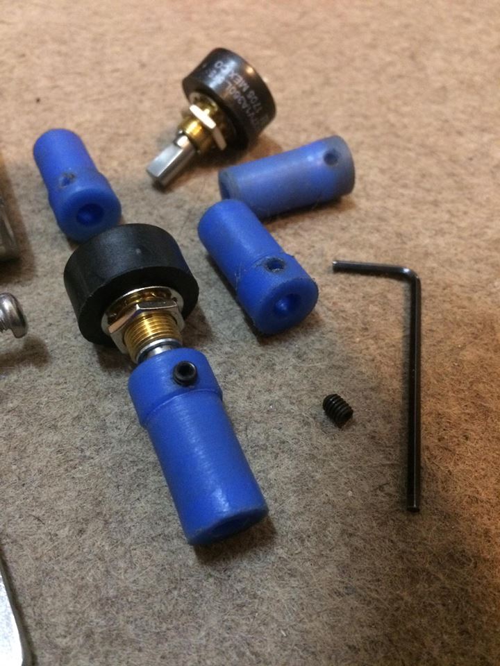

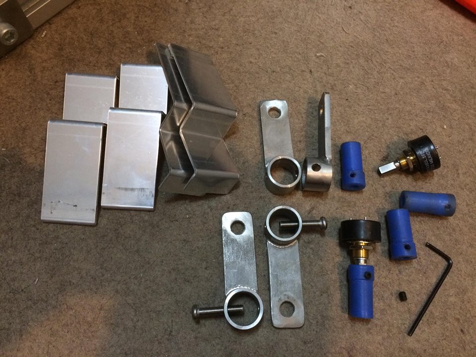

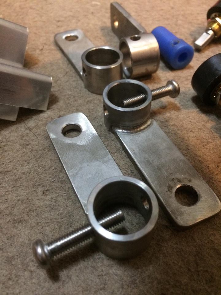

    Thank you.Sorry but I missed the words, my mistake. I mean the tube that go from motor to seat (hope i'm explained better :) )
    Anyway, thank you so much for your explanation :)

    i use SimCalc for calculate the length hug:
    and the tube is made from stainless steel tube argon welding with stainless steel nuts

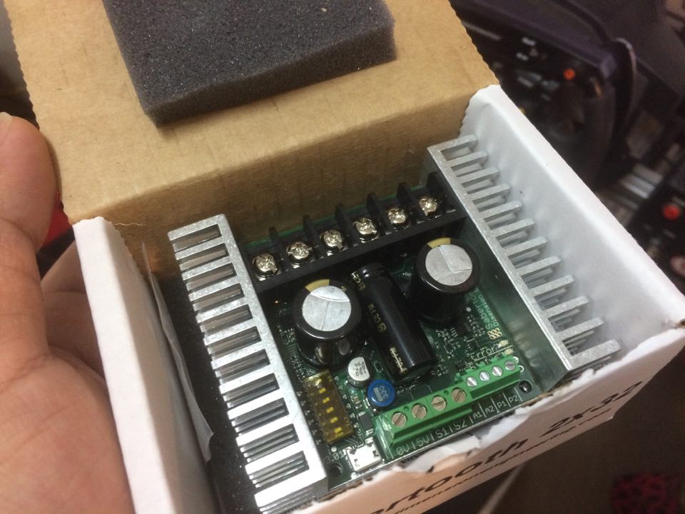

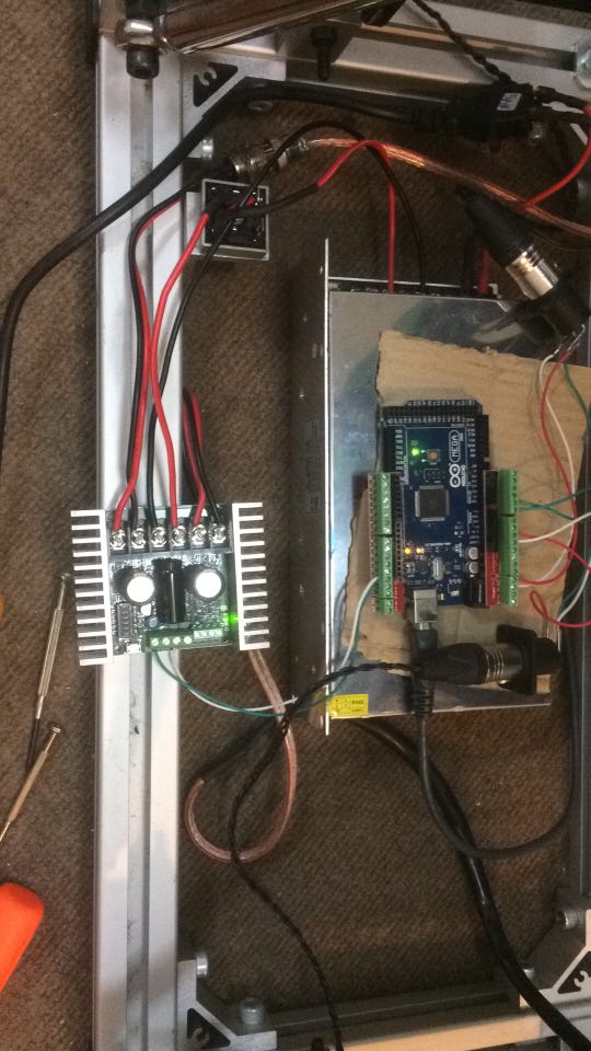

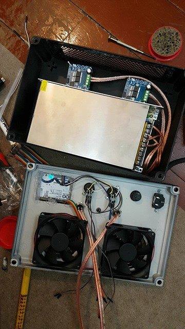

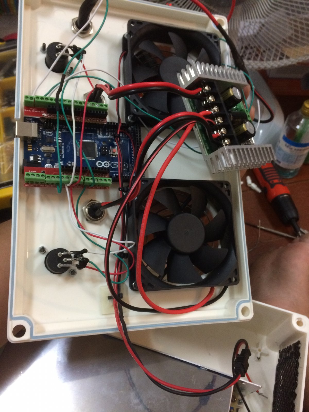

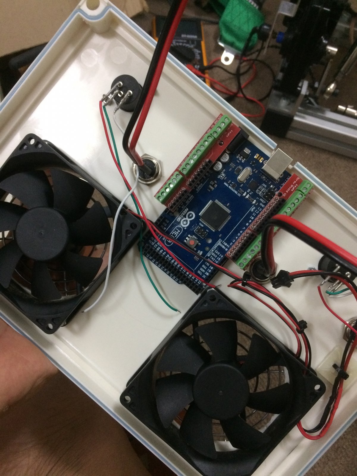

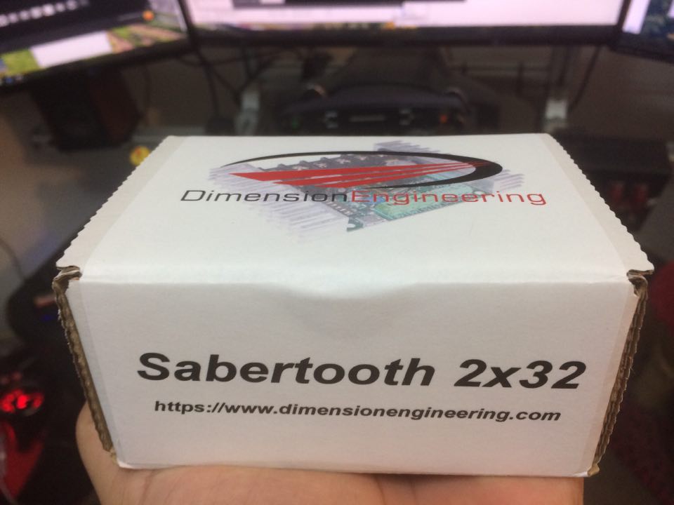

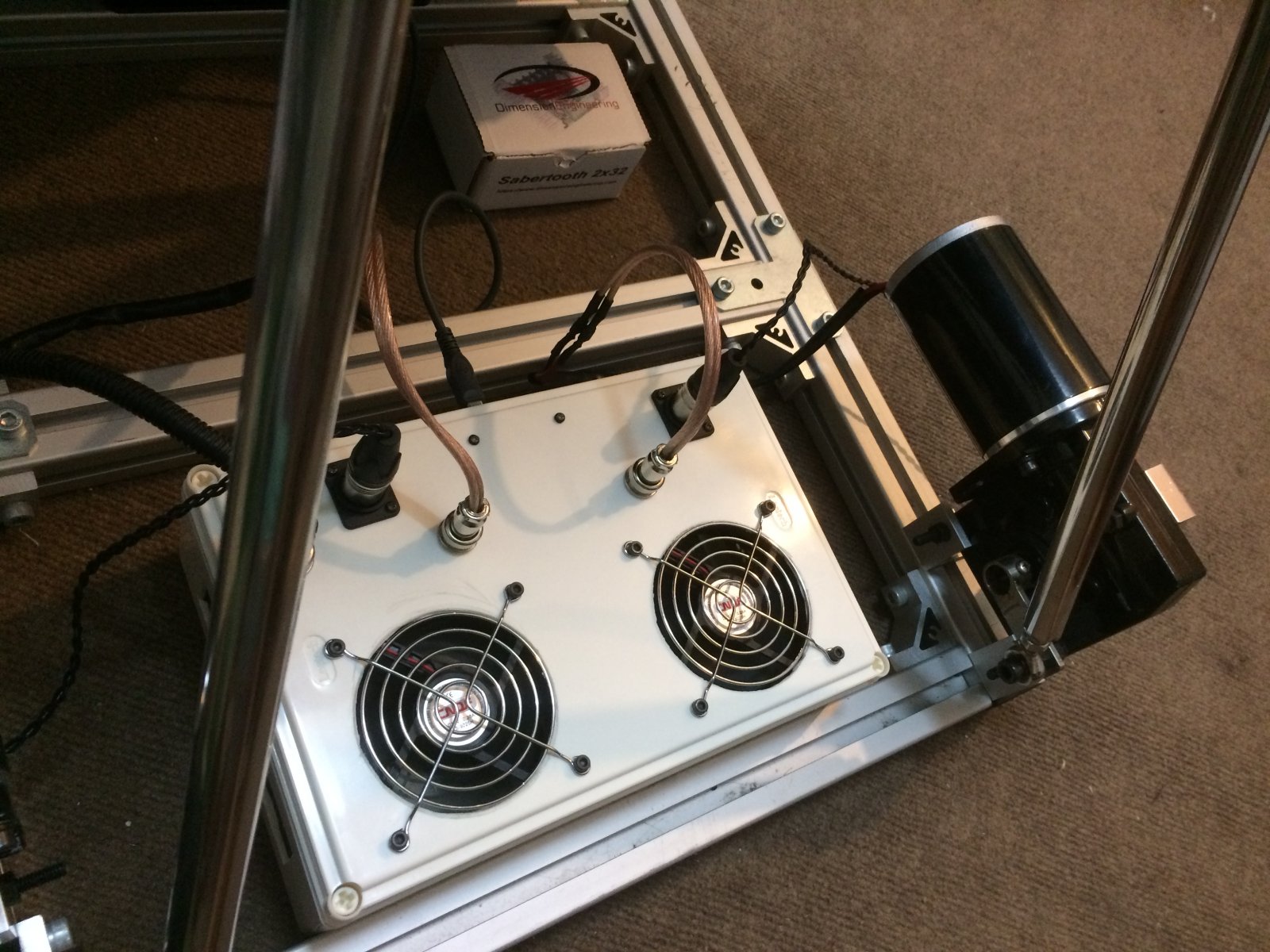

    update : upgrade to Arduino Mega & Sabertooth 2x32
    now the heat problem at H-Bridge was sloved. power and effect are much stronger and smoother
    heil to the Sabertooth hug:

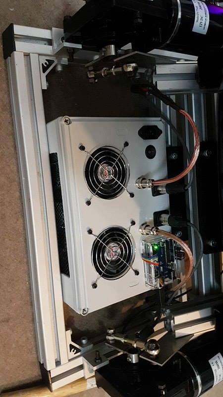

    nice project,
    -how many meters of 20x20 aluminum you used?
    fer
  5. ferslash
    ferslash Active Member
    Feb 8, 2011
    495
    4,798Coins
    +181 / 2 / -0

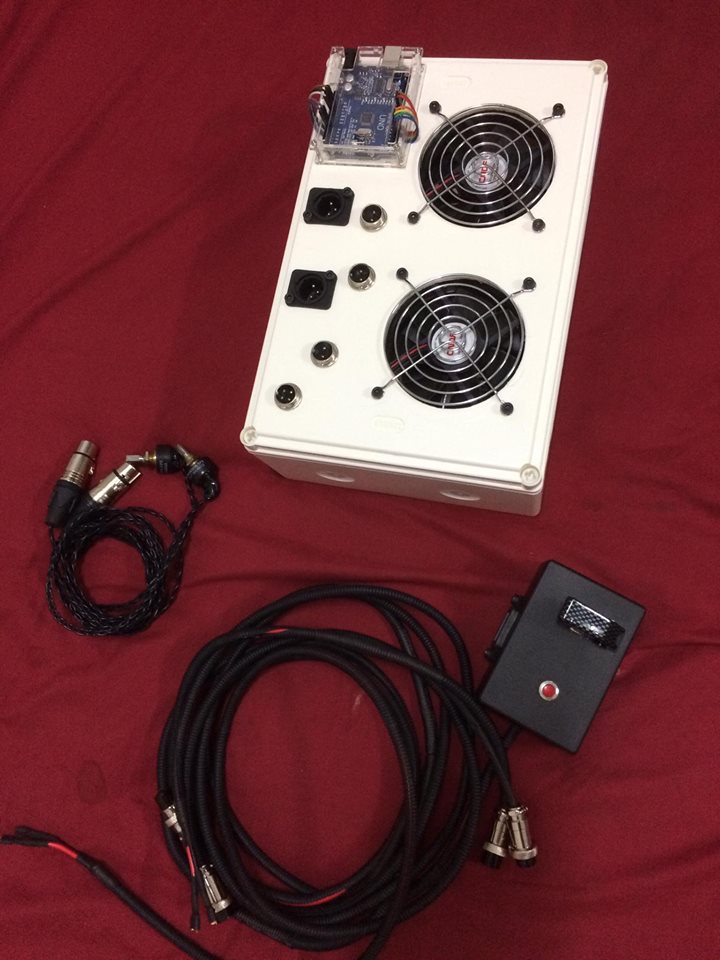

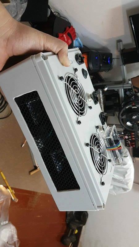

    also how did you connect the arduino, in a pic you post it apears beautyfully enclosured on an acrylic box, but with no connections
    :popcorn

    i use 40x40 alu
    Alu 4040 Heavyload 150mm x2
    Alu 4040 Heavyload 200mm x4
    Alu 4040 Heavyload 300mm x1
    Alu 4040 Heavyload 400mm x3
    Alu 4040 Heavyload 430mm x4
    Alu 4040 Heavyload 450mm x4
    Alu 4040 Heavyload 500mm x7
    Alu 4040 Heavyload 650mm x2
    Alu 4040 Heavyload 580mm x1
    Alu 4040 Heavyload 1050mm x2
    Alu 4040 Heavyload 1400mm x2
    End Cap 40x40 x24
    T-Plate 40mm x2
    i-Plate 40mm x4
    Bracket 40mm x24
    Hard-Bracket 40mm x24
    L-Bracket 40mm x30

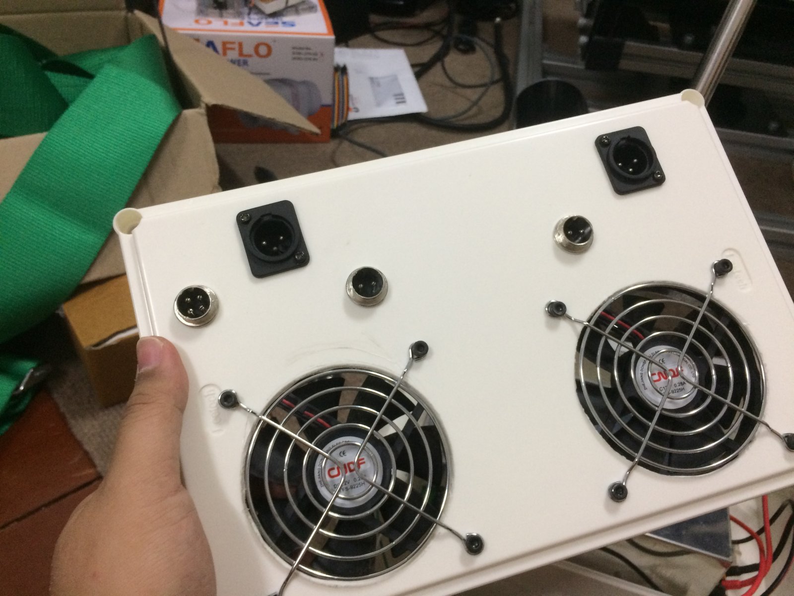

    this's my old version box
  7. ferslash
    Feb 8, 2011
    495
    4,798Coins
    +181 / 2 / -0
    man i think this is one of the most beautifull control boxes i have ever seen around. :cheers
  8. Meawto
    Meawto Sorry for bad English ;'(
    Aug 10, 2015
    96
    Thailand
    - 336Coins
    +43 / 1 / -0

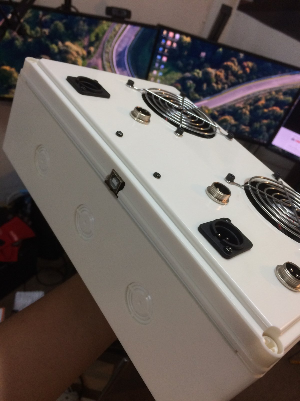

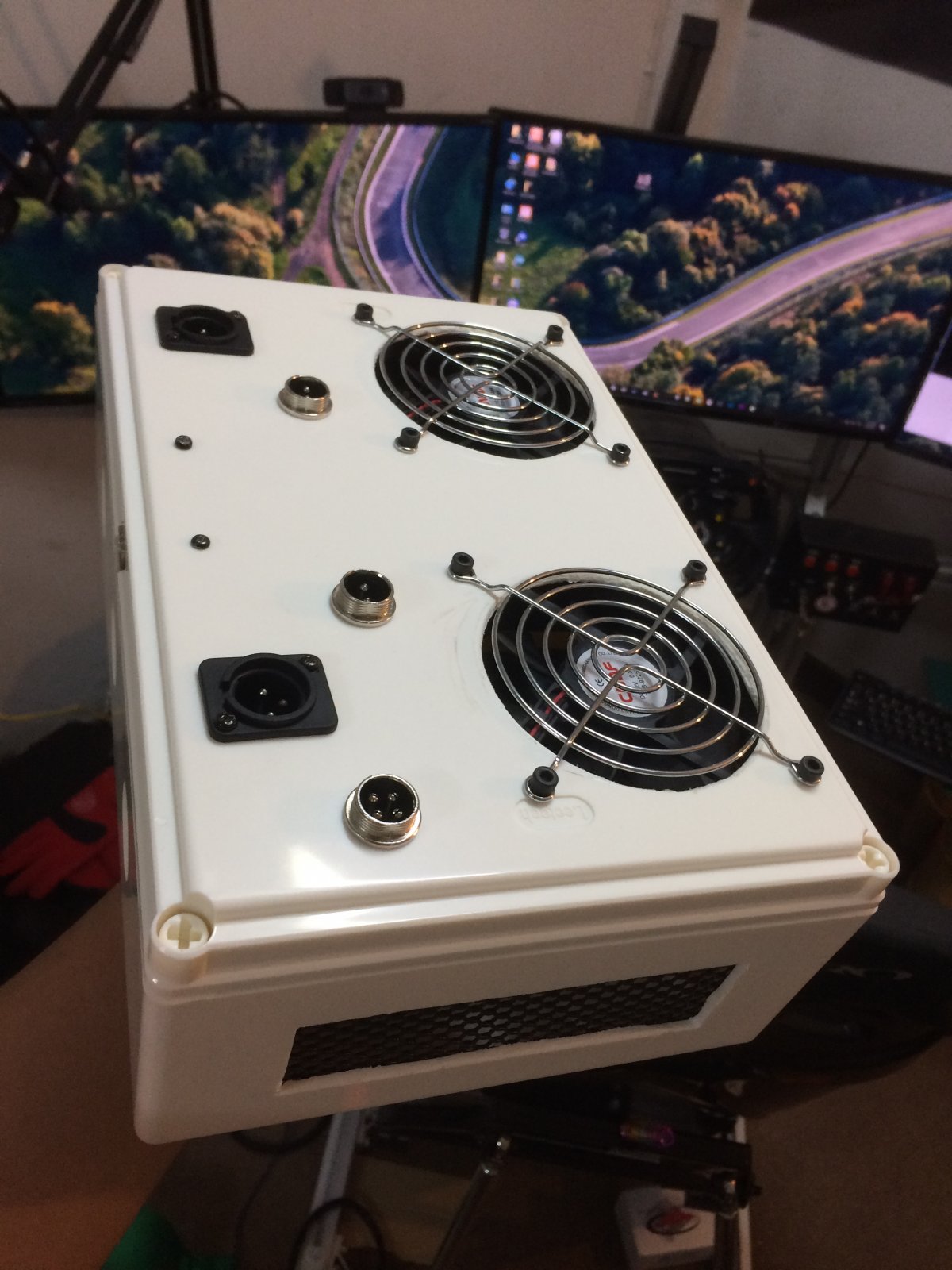

    thanks !! it's very cheap here in Thailand. cost around 15$ for box&wiring :p

    Awesome work, your electronics box and cooling fans very professional I am building similar and your posts are very helpful thankyou Meawto

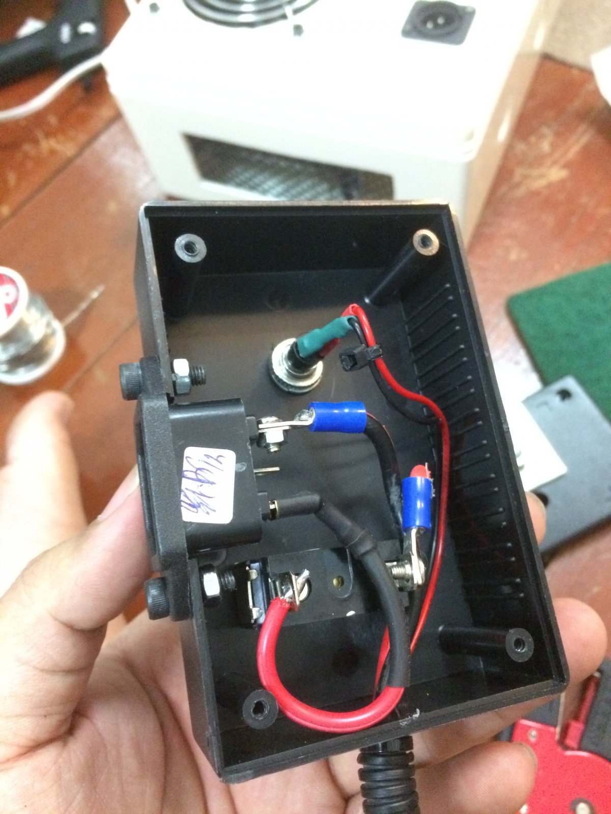

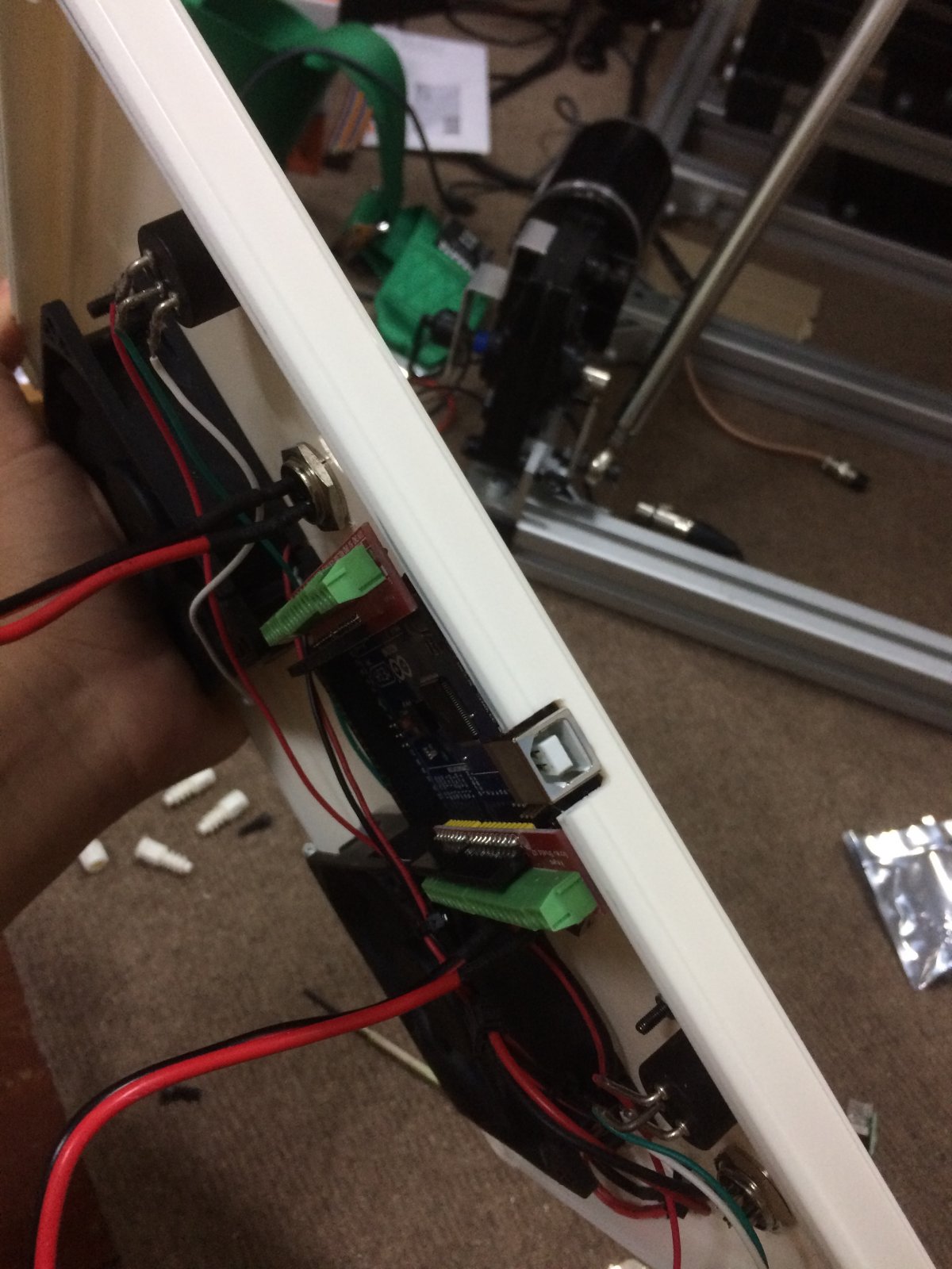

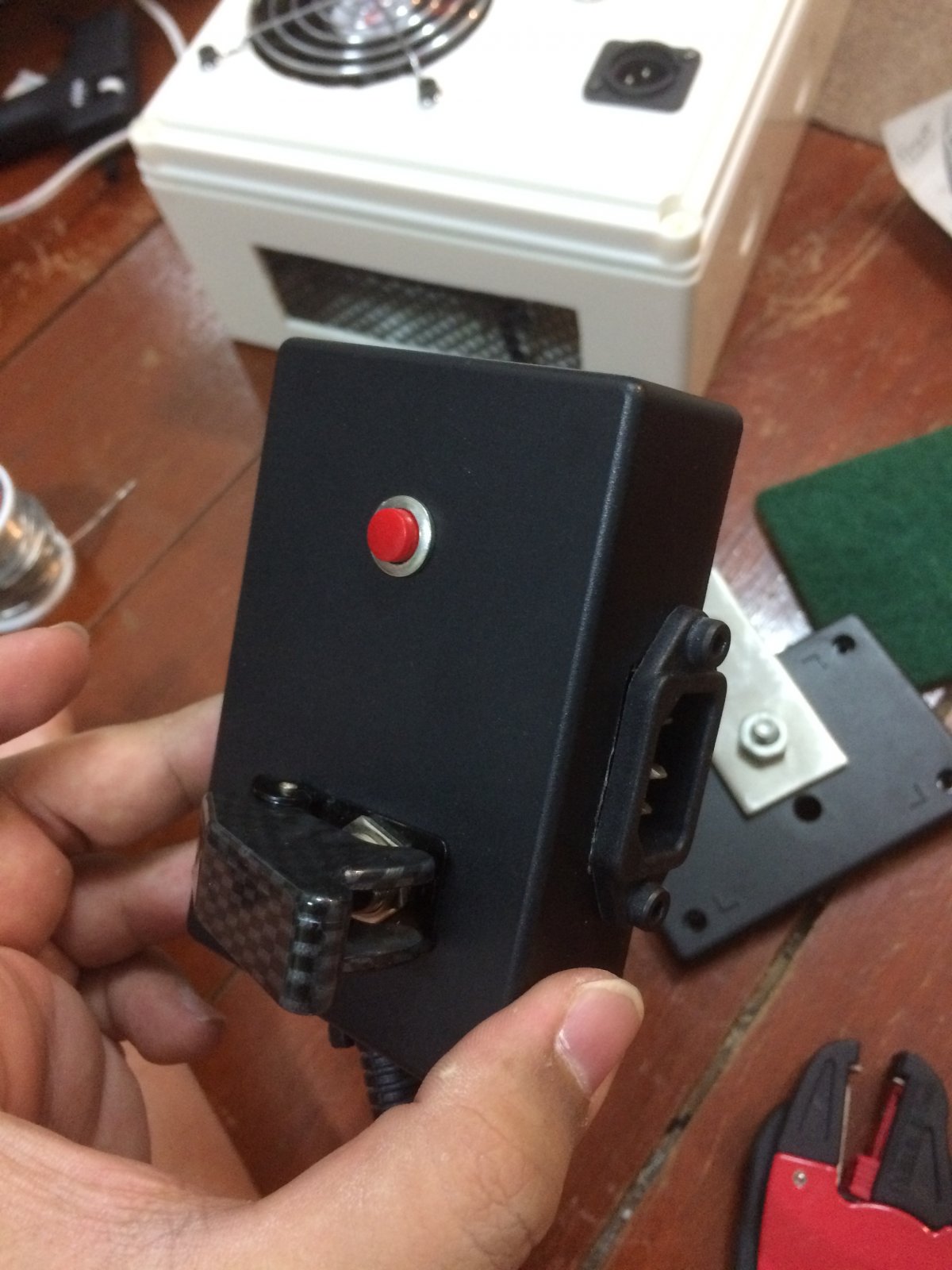

    update : make a new box for sabertooth&arduino MEGA. and add a standalone switch box for reset button and power on-off
