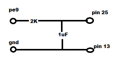

    thanks a lot, mate. Now it works without vibration, I also found that connected gnd from the stm32 to the chassis of the cn3 was improving a lot, the only doubt I have is that putting parameter 190 to 0 with the encoder at 0 I without force to pier the engine off alone, I have to put parameter 190 to -90 so the rotor's dead, this is normal?

    i experimented with pn190 and had a breakthrough. -140 makes all the oscillation go away.
    also to reply to the original question, pn190 at 0 is even worse then -100.
    for anyone else reading this, i am not using TDD DAC board, i have a low pass filter. and a 90st-m04025 motor

    i've checked all the parameters I don't improve the centre of the MMOS at more than 20% I have a / st130 M15015 adjustments will be different values, what I've checked is that with a DAC 1k 1uf is much more sensitive without prejudice to the engine noise I've even had to lower PN189 to 20, I'm just missing the material to mount it on the cockpit i test, with the DAC to 2k2 1uf to get the same force i answer I have to put PN189 to 40, thank you

    hello, perfect, I have it mounted in the cockpit, I will pass photos when I can of the mmos configuration i of the game, to calibrate the wheel without getting complicated you have to train in the game, put in mmos spring to 0, the steering wheel will turn in some direction alone, put the parameter Fn007 you put ok, and ready calibrate it auto, in the PN190 you will see that has changed the value that will be almost the perfect value,
    PN198:1000
    PN188:1
    PN189:75
    PN259:1
    with dac 2k 1uf
    Motor 130st-15015
    Thank you all for helping me
