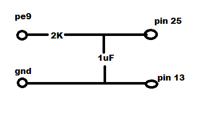

    He guys,
    Build the setup yesterday with an M10015 And I have to say, I'm quit impressed. Very strong (almost twisted my thumb out already ) and no jitter in movements.
    Just the high pitch noise is irritating for me and most likely for my 2 cats.
    But I'm not sure if this helps because it's very hearable.
    Any suggestions? Settings etc...
    Also the fanatec pedals I connected work but the "travel" of the potmeters seems like 75% of the travel I had before. Is there in this case something I can change?
    All in all I'm very happy with the outcome at this point. But fine tuning is necesssary.
    All suggestions are welcome.
    TIA
    Bakhol

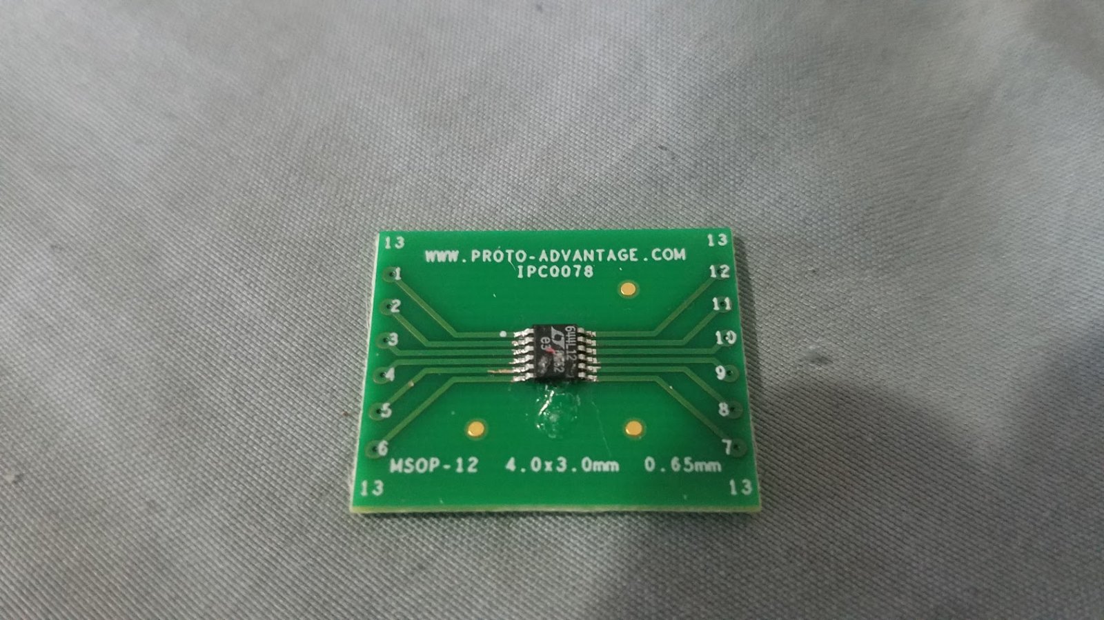

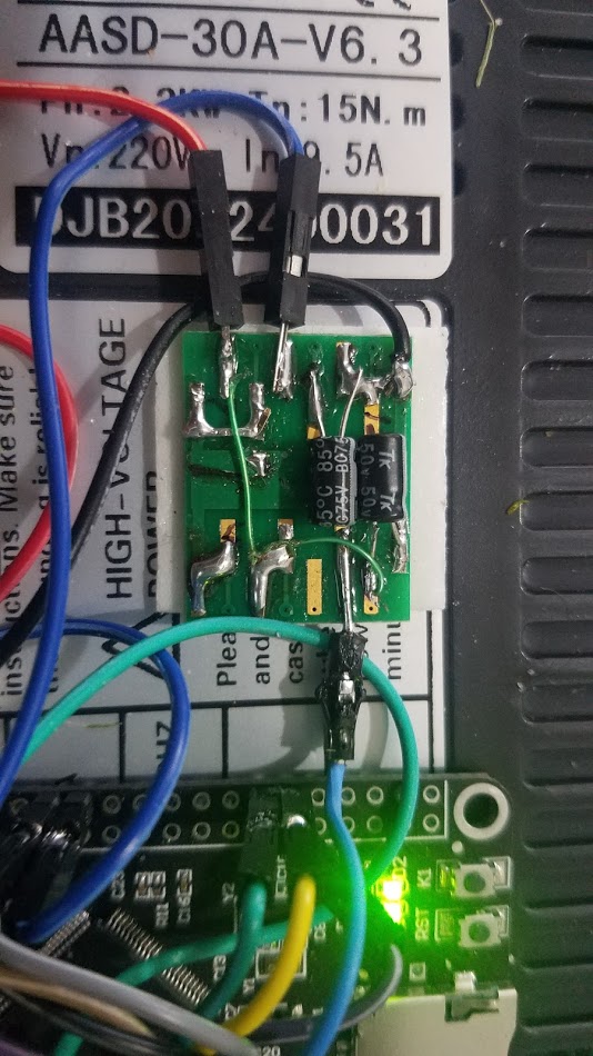

  5. T R Para
    T R Para i make stuff up
    Oct 18, 2018
    385
    Cincinnati, Oh
    2,444Coins
    +357 / 3 / -0
    AC motor, 6DOF
    The filter you show should of taken care of much of the noise. I used it on my wheel and it made a huge difference. If you remove it from your setup you should hear ten times the noise and vibrations. If not your filter is not wired correctly. I also installed the DAC converter chip in line with the filter and there is virtually zero noise or vibrations felt. I included the pictures of the DAC mounted on a carrier (breakout) board. The blank carrier board cost almost the same as the DAC itself. The other picture is the back of the board with the 2 bypass capacitors and the wire connection needed.

    @JonBakhol
    Does it sound the same on the jog test?

    @JonBakhol
    The same noise as in the JOG test is normal.
    Is mmos 16.8Khz?
    Are you using 2k and 1uf for LPF?
    ceramic capacitor?
  10. JonBakhol
    JonBakhol Active Member
    Mar 16, 2018
    107
    Netherlands harderwijk
    443Coins
    +46 / 1 / -0
    Sound with JOG test is okay.
    MMOS setup is 16 Khz..
    I do have the 2K and 1uF between PE9 and DB25 pin 13 and 25.
