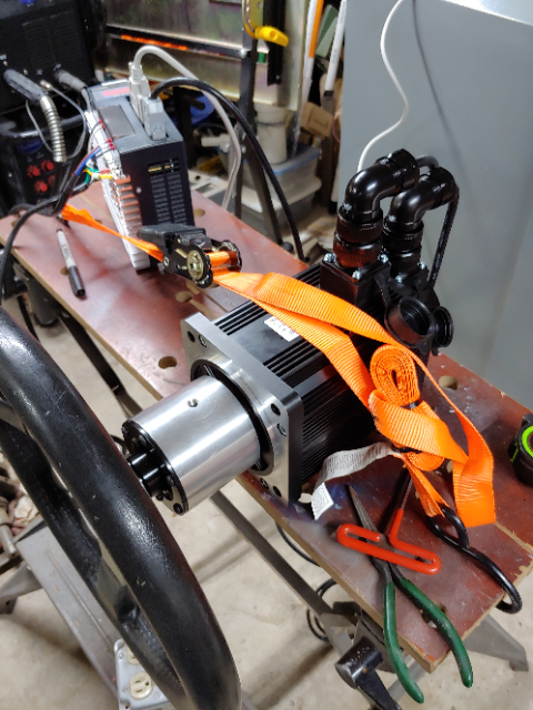

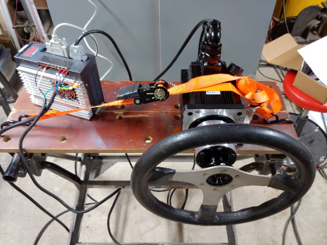

    Hope it's ok to add some pics in this thread of my +"$450" MMOS Wheel project. I exceeded the challenge price but I sort of kept with the DIY aspect, bought the Thanos PCB, Servo 130ST-M10015. Used Thanos' settings and set it up to give it a try. Had to play around a bit to understand how the software all worked and rewatch some of Thanos YouTube videos to get everything working.
    The computer I am using is not my SIM computer so I used the IRacing Wheel test program along with MMOS software, ran the setup on 120v. I heard no humming noise at all from this setup even hitting the stops (about 50% Max Force, wasn't even going to try 100% :)).
    Next up moving it to my sim rig and giving it a go with RFactor . . .

    Got my DD wheel onto my sim rig today and it works but, once I start RFactor2 up and I am in game with a car instead of getting feedback I get rotation when I turn the wheel, it rotates to the stop then starts back to the other direction to the stop? I can stop the wheel and return back to center but as soon as I move off center it rotates on it's own again? What am I missing in my settings? Outside the game it works fine same in RF2 configuration soon as you go in the car forces reverse. I'm using Thanos' setting from this post, I did set Pn190 to -50 instead of -100 to control wheel oscillation at center.

    SOLVED: I was using a Controller file I had modified that was originally used for my G27 wheel, used a OSW controller file (which I can now modify for my MMOS wheel) and it's working correctly . . . for the record 100% FFB is way more than this ole'man needs!!
    All I can say this setup is AMAZING! Thanks to all of you who share your info for those less fortunate to have the "brains" required to figure this stuff out! :D:D:D
