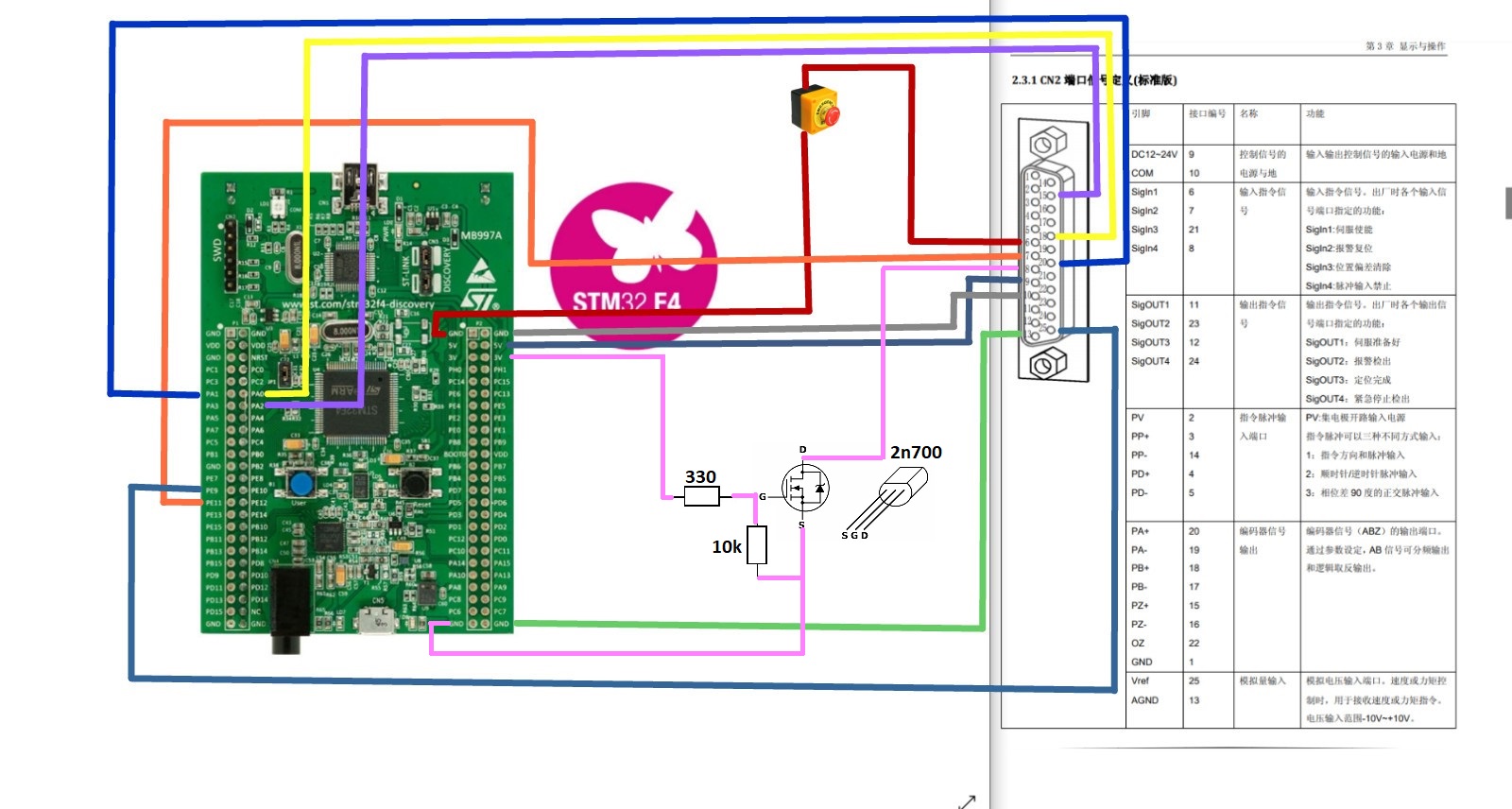

    These are 2 questions.
    1:I use 2 usb's 1 for data, 1 for the 5V
    (You can use the external voltage input with a 3,5mm jack...I think.)
    2: upload the vnm.hex or mmos.hex to your STM32F407G.
    3: check with mmos/vnm software.
    4: resolder the disco1 to DB25 pins.
    5: try again.

    Are you using the 0--50--100 setting from Milt?
    And the internal DAC (Pa4 to pin 25 from the DB25?)
    With the internal DAC the max voltage is 3,3V instead of 5V with the MMOS setting.
    Therefor you can up the PN189 to 100 (or begin with 75). And if the servo is clipping, you can always put the PN189 down.
    With the 0--50--100 setting most likely you have a big offset in PN190. If you take away the USB from you STM32 the wheel is turning a lot (It goes back to PN190=0) You can put an extra safety to the STM32, so if communication is lost, the wheel doesn't spin:
    And also change these settings on your AASD:
    Pn052 = 7 (E-Stop) ## pin 6 AASD
    Pn053 = 18 (DIR) ## pin 7 AASD
    Pn055 = 1 (ServON) ## pin 8 AASD
    Pn076 = 1 (E-Stop Reset)

    Yes, that's right, and in fact if I remove the USB socket the steering wheel starts to turn dangerously.
    Thanks for your suggestions.

    For the Mosfet, you only have to do the pink lines.
    The other pins stays the same as you have now.

    I've just built this setup using a 130ST-M10010 and AASD servo drive from Master Jiang 3SMT over the past few months. I used a STM32F407VGT6 board I had already, and I am running VNM firmware using the DAC output on the board with the safety shutoff circuit described above - it works well.
    https://www.xsimulator.net/communit...using-mmos-and-aasd.14657/page-23#post-214374
    Configured DAC output as per this post:
    https://www.xsimulator.net/communit...using-mmos-and-aasd.14657/page-21#post-213019
    Biggest issue I had was EMI problems - particularly glitchy on the amplifier circuit for my load-cell brake. Solved by shortening the power leads to the motor, wrapping the cable in conductive tape, and grounding everything I could find including those cables, motor housing, pedal frame, etc.
    For what it's worth I was worried that the small MiGE would not be enough power, and it's way too much. I am running under 50% to get good feedback without fighting it all the time. If you aren't getting enough from it, you can increase the gain as the ADC on the STM32F4 board is 3.3V out, and the input on the AASD is rated at 10V: scaling up to 100% was plenty but you can go higher if you need to. I suspect you won't need to.
