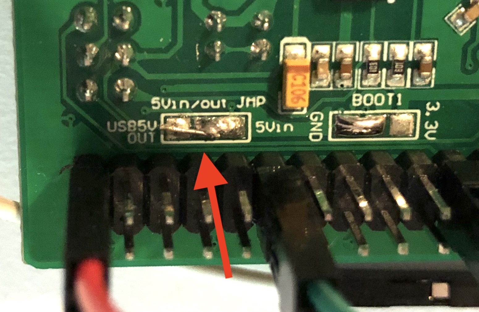

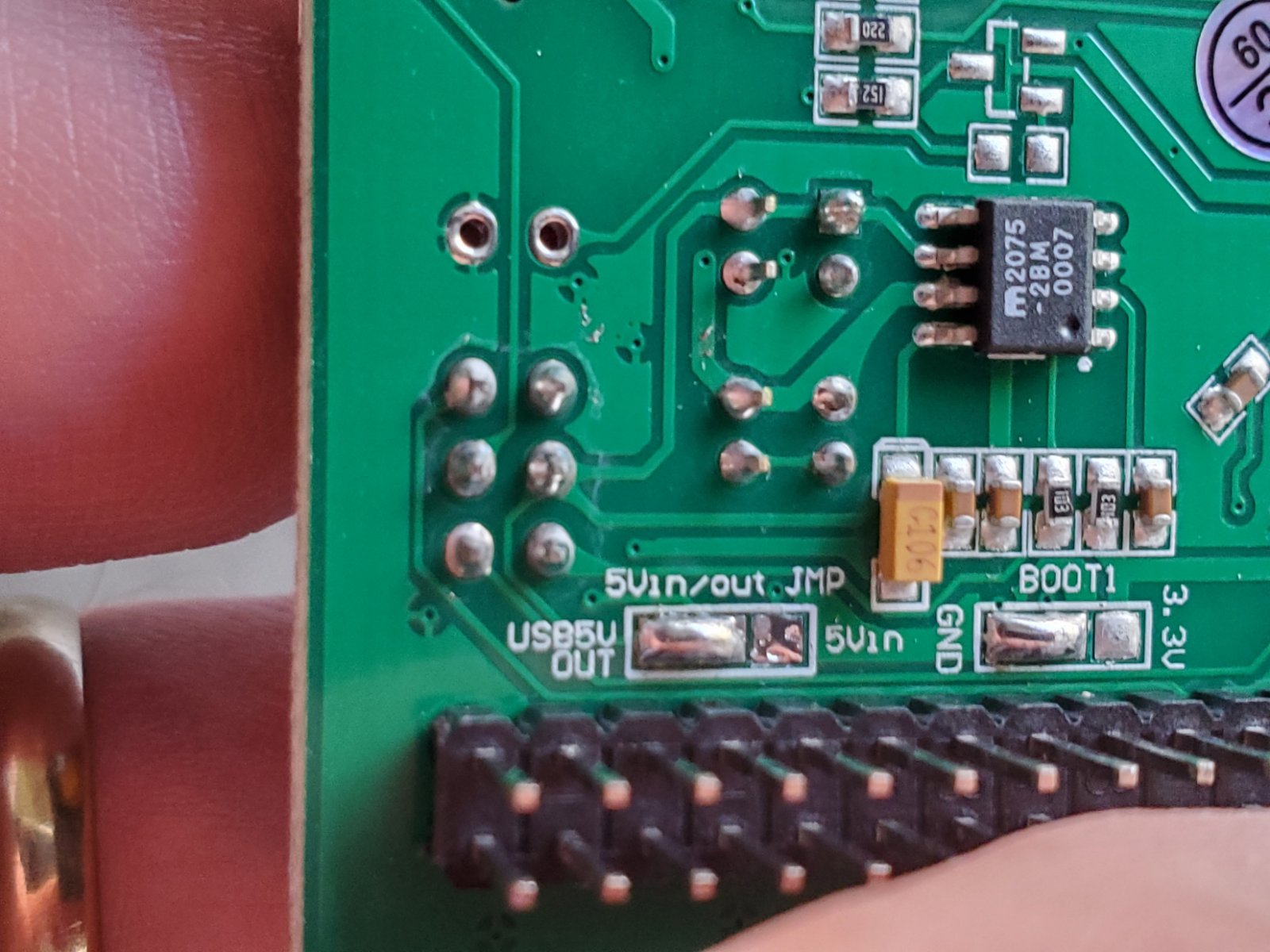

  8. phongshader
    phongshader New Member
    May 29, 2019
    39Coins
    It should be jumped like this?
    I'm not using the thanos board, wiring directly to the core407v board
  9. JonBakhol
    JonBakhol Active Member
    Mar 16, 2018
    107
    Netherlands harderwijk
    442Coins
    +46 / 1 / -0
    Did the jump like that worked? I do have a TDD board which I gave to a friend, but it isn't running yet.
    please let me know.
    Ride on
    Bakhol
  10. phongshader
    May 29, 2019
    39Coins
    NO! it did not, I was very wrong, fortunately I didn't fry anything. There are 3 pads, the board comes with the 5vin and center pad jumped, what you want to do is remove the solder that jumps those pads and add a solder jump between the center pad and usb5vout pad

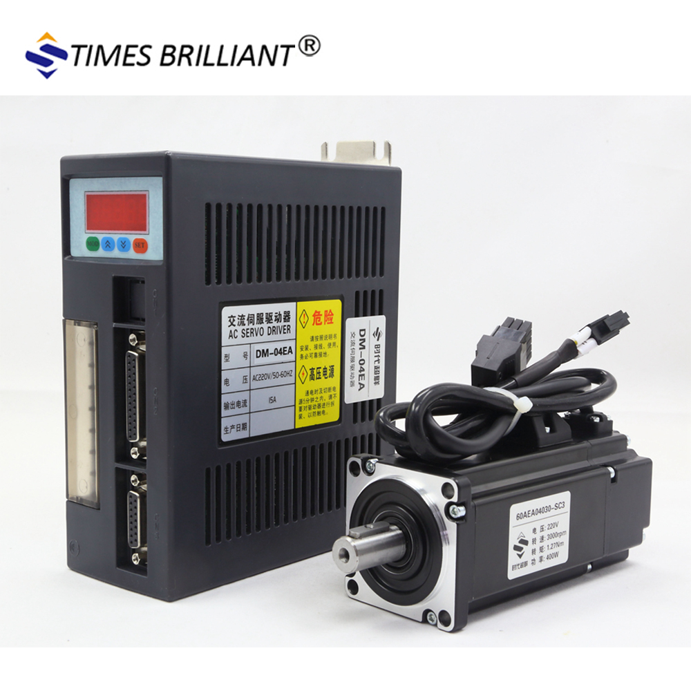

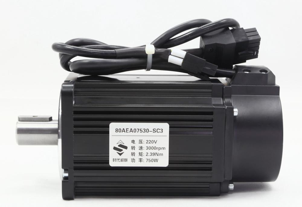

  11. votrungchi
    votrungchi New Member
    Jun 18, 2021
    11
    61Coins
    Hello @Peacemaker105, I found your work very interesting and I want to make mine one.
    I have a question, could I use other brands AC Servo motor like below? (Times Brilliant).
    The reason is I can not find MIGE motor at my local store. Thank you so much in advance.
    H11003d2eb559413f955d434eea01404fn.jpg Had7e8180d0804f09bda1fb2b5ea6a471z.jpg
  12. JonBakhol
    Mar 16, 2018
    107
    442Coins
    +46 / 1 / -0
    The Nm of these 2 servo's are very low.
    The most of us just ordered the servo online at Aliexpress.
    https://nl.aliexpress.com/item/3286...=glo2nld&spm=a2g0s.9042311.0.0.67274c4d5qpWWV
    Have a good search.
  13. votrungchi
    Jun 18, 2021
    11
    61Coins
    Thank you for your reply. I know I will select a bigger servo. The main point I want to ask is could I use another brand servo that looks similar for this DIY, are there servo from China compatible?
  14. JonBakhol
    Mar 16, 2018
    107
    442Coins
    +46 / 1 / -0
    Most likely you can use different servo's and controllers. The main question is that you need to put the same parameters in the controller as the controller used by Peacemaker. If this is the case, I don't see any problems.
    But maybe you have to wait for some others who used different controllers, for their experience.
    Have a good day
  15. votrungchi
    Jun 18, 2021
    11
    61Coins
    Yes, I think I could use these servos as well. But since I have no experience with AC Servo that is why I want to confirm. Let's wait for someone with their experience.
    Have a great day!
