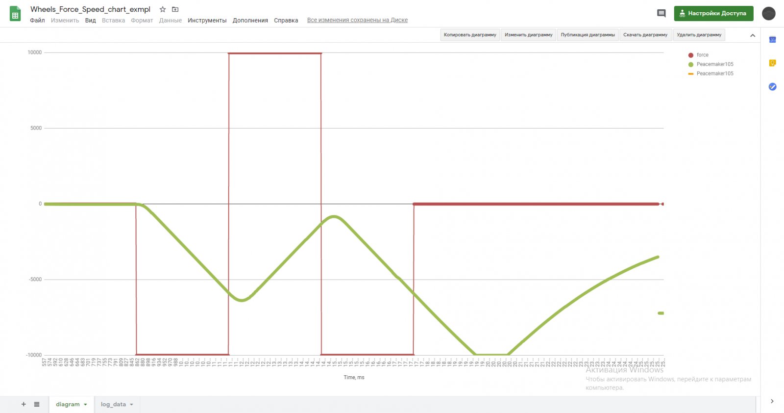

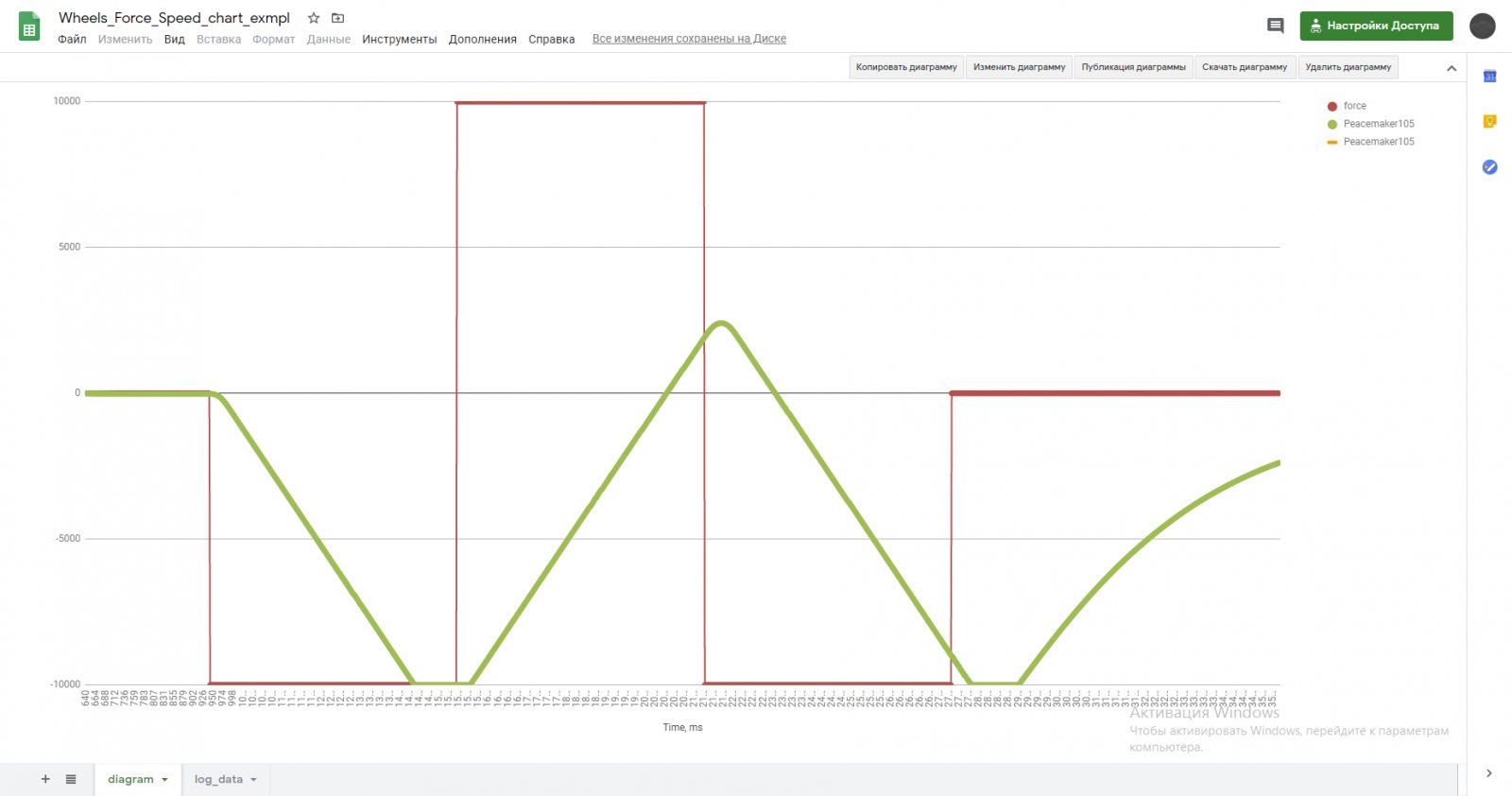

    Let smbd else, interpret it.

    Which tool you are using to make these graphs?
    I want to do some tweaks and its good to quickly graph some test results

    It looks like he's just using Google Sheets (basically the same as Microsoft Excel) to plot time vs signal/position. Should be straightforward if you are familiar with spreadsheet programs...

    It seems to be noisy, both audible and on reading the encoder too...

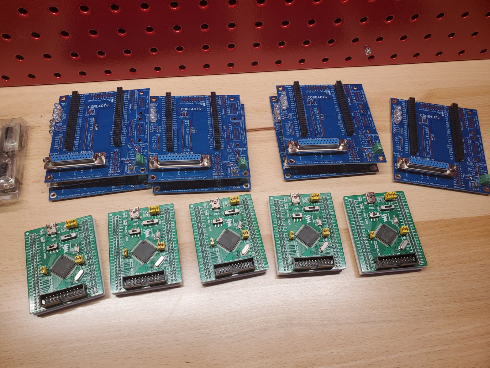

    Its still prototypes made. A better and smaller size board will be made that will be not only less expensive but also easier to manufacture. Gerber files will be available as well parts list, so if you want to build it on your own, you can. Its not something I want to capitalize on, its not my project or development. This TDD board was designed just as a way to avoid manual wiring things together and be as plug and play is possible with these inexpensive AASD servos, which are perfect for DIY.

    I have the few prototype boards ready, if anyone is interested leave a message on my Discord server...
