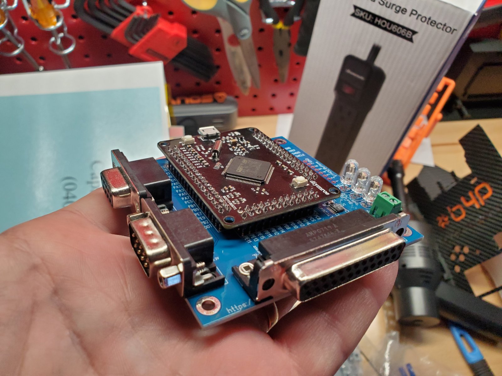

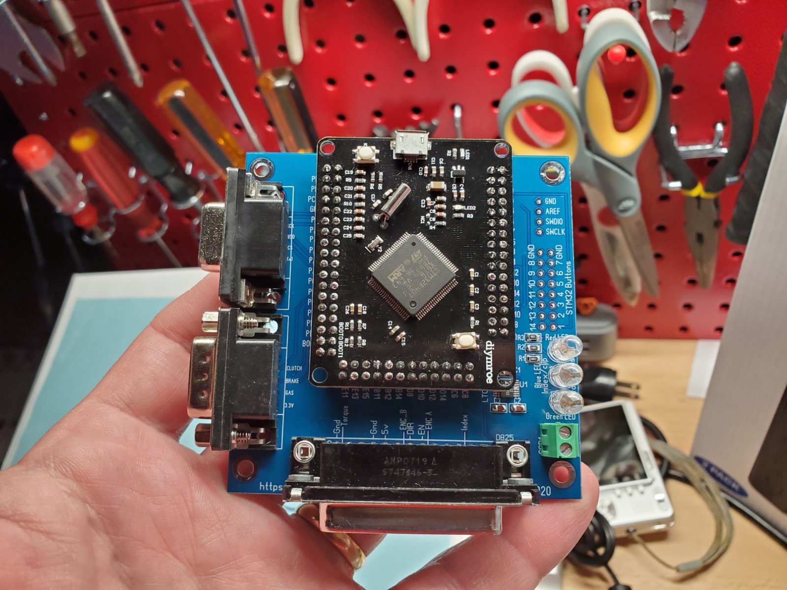

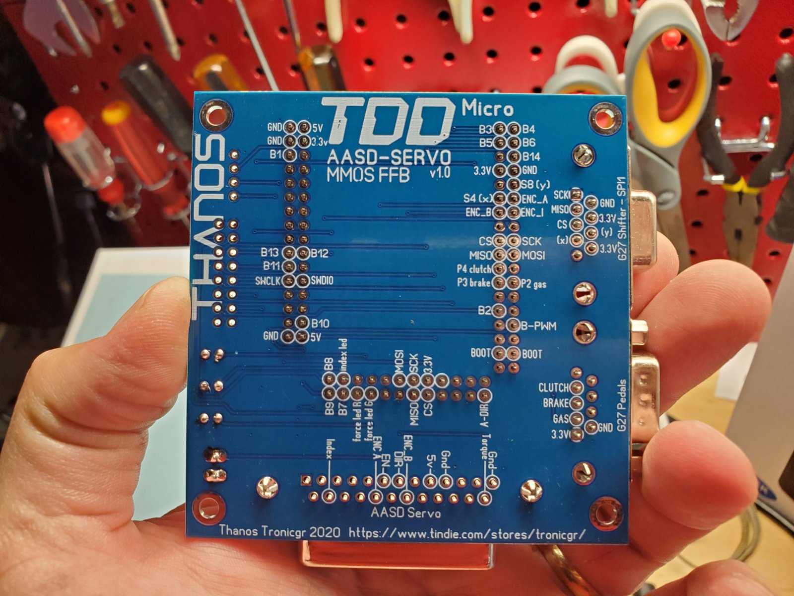

  20. Thanos
    Jul 6, 2017
    1,372
    Electronics Engineer
    United States
    2,862Coins
    +1,074 / 10 / -0
    There is no humming or oscillation when using the DAC...
    Making some smaller TDD boards actually...
