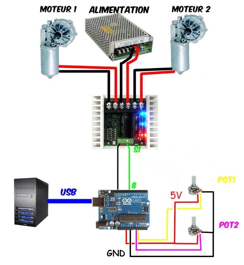

    Can you please send me the 4dof ino code you used and the image of the schematic of the arduino, h bridges , pots and gearmotors

    but this ino code and this schematic is for 2 dof, i need for 4 dof

    use two interfaces. one for each pair of motors and you will have totally 4 motors

    i rewrite what i wrote to you in pm:
    "Every arduino board connected to the sabertooth board commands 2 motors.
    So you for each sabertooth you need one arduino card
    sabertooth 1 card that commands the motors 1 and 2 :
    Pin 8 of arduino card TX data to connect to S1 Sabertooth 1
    Pin A0 of Arduino card - input of feedback positioning from motor 1
    Pin A1 of Arduino card - input of feedback positioning from motor 2
    sabertooth 2 card that commands the motors 3 and 4
    Pin 10 of arduino card - TX data to connect to S1 Sabertooth 2
    Pin A2 of arduino card - input of feedback positioning from motor 3
    Pin A3 of arduino card - input of feedback positioning from motor 4
    In schema10.jpg you can see sabertooth 1 card connected to arduino 1 card
    To connect sabertooth 2 card to arduino card you must use Pin 10 instead Pin 8,
    Pin A2 and Pin A3 instead Pin A0 and Pin A1
    That's all"
