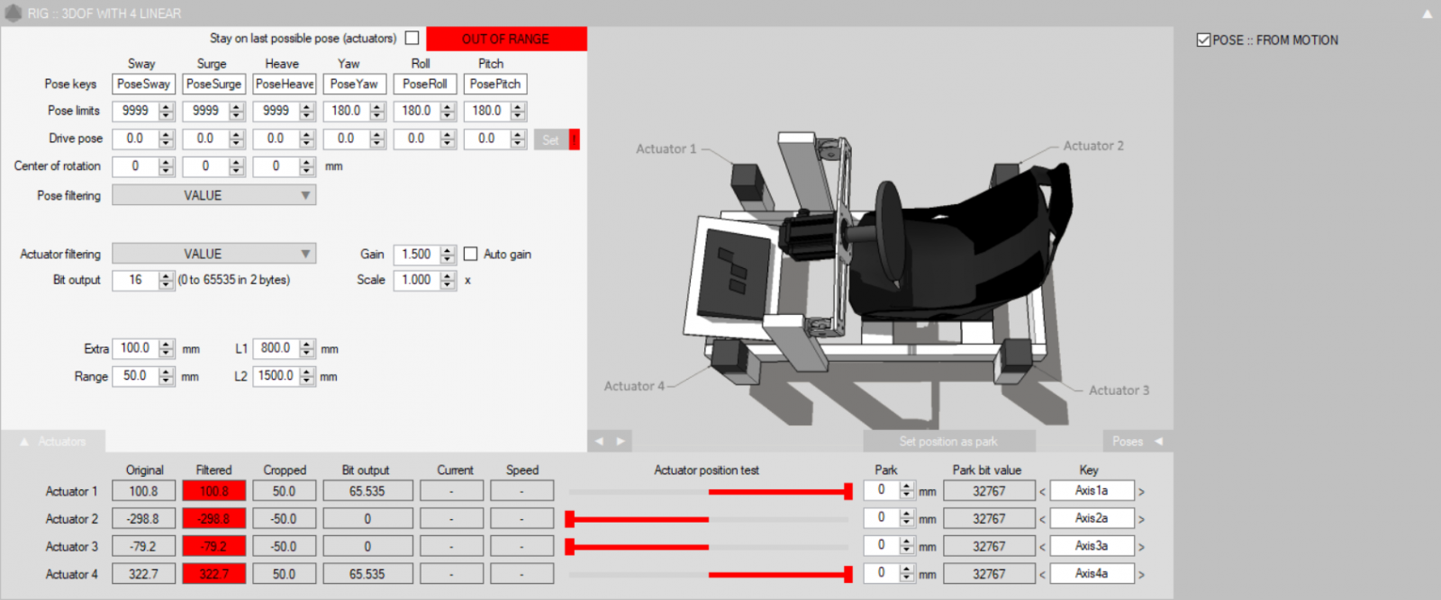

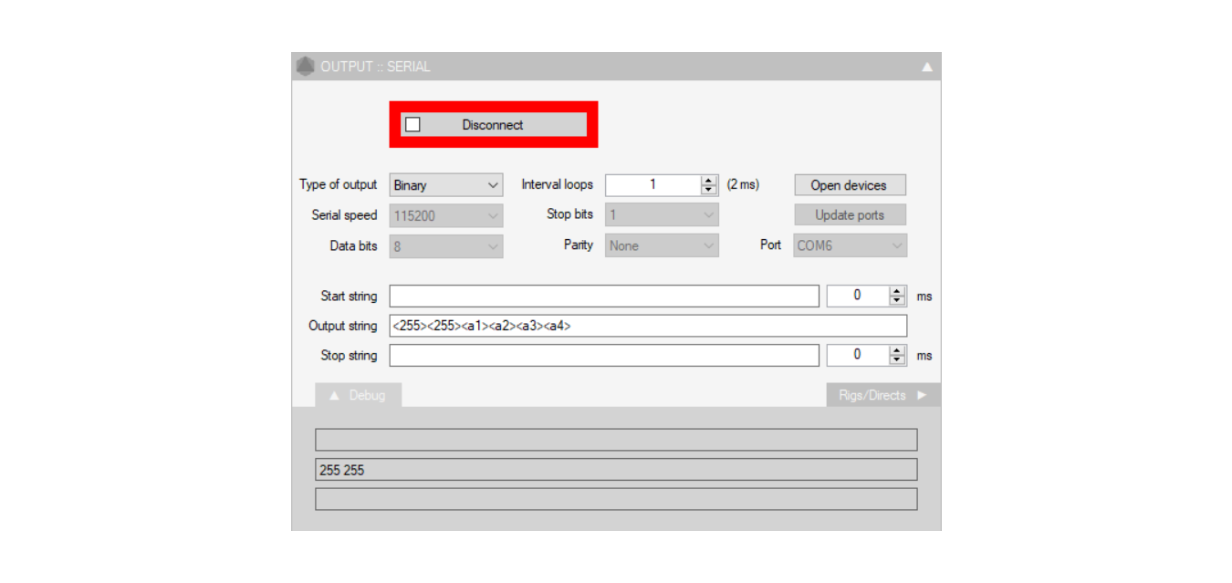

    I have been setting up your program with the Mega board.
    However in PtMover I am not seeing any output.
    I have tried ver 2.9 and ver 3.33
    I was wondering if the output string has changed...
    I am using <255><255><a1><a2><a3><a4>
  7. cubexxx
    cubexxx Member
    Oct 4, 2019
    69
    557Coins
    +41 / 0 / -0
    3DOF, AC motor, Arduino, 4DOF
    You have to use the actual actuator keys in the output string (you named your actuator keys "Axis1a" and so on), that's a standard FlyPT Mover thing

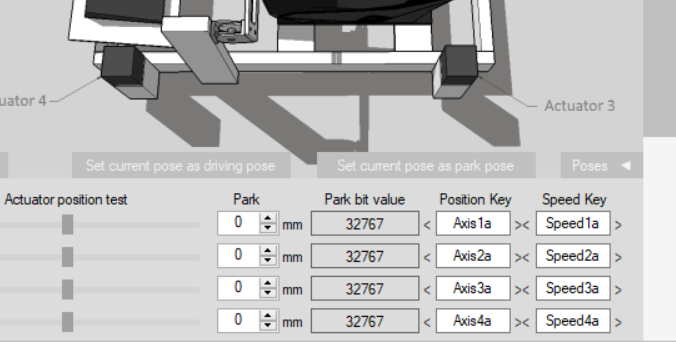

    Thank you.. That did solve the problem. I never saw the documentation on that and the program defaults to the "<Axis1a> format in the Rig Module. I see it now has a "Speed Key" any idea what that does?

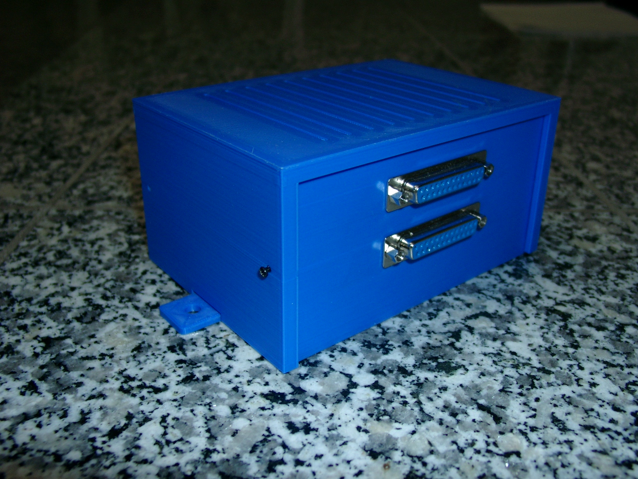

    Regarding some of the usb-problems that have been reported and that I had myself (sometimes mover would disconnect) I added another layer of isolation between arduino and drivers, i.e. I don't connect the output pins of the mega directly to the driver inputs but bought this little device for electrical isolation. So far it's more stable now and I didn't have connection failures since. Now when you look at the schematic of the aasd drives there should be already an optocoupler at the inputs but I think there may still some "pollution" come across and spread into the arduino and via the usb to the pc.
