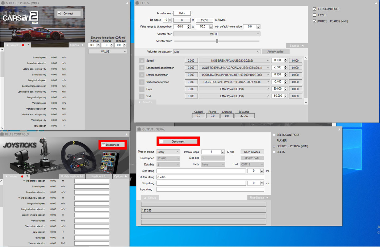

  6. cubexxx
    cubexxx Member
    Oct 4, 2019
    69
    557Coins
    +41 / 0 / -0
    3DOF, AC motor, Arduino, 4DOF
    Your screenshot is a little bit low-res, I can see the "interval loops" beeing 0.5 ms which seems very low, that is 2kHz, why so fast? That may be too fast for the baud rate, you may have to adapt the code for that. I never used less than 2ms, not much to be gained by going lower as the servos don't react that fast anyway

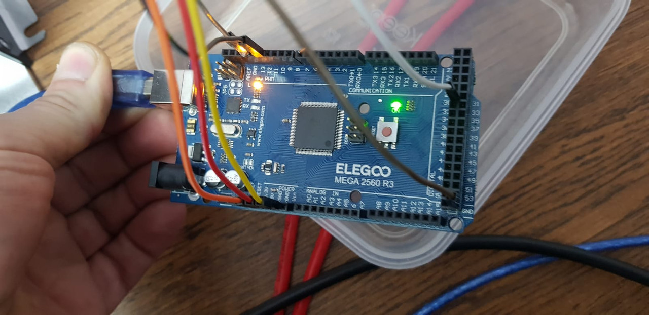

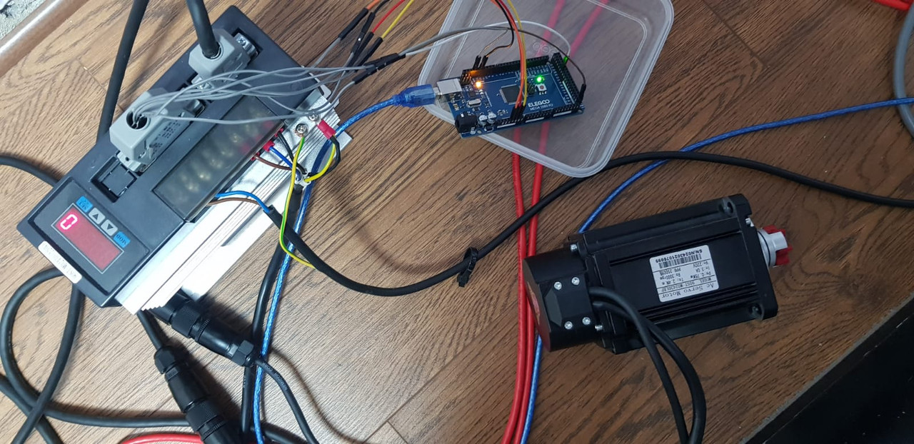

  13. Rolo F
    Rolo F New Member
    Oct 28, 2020
    27
    227Coins
    +7 / 0 / -0
    Hello!
    Long story short I have a 90 ST motor and the AASD controller. I have built all the hardware for the belt, and now I need to connect the AASD controller to a board that can "talk" with my PC.
    I have found 2 SW that could "control" the belt, one is FlyPt and the other is simtools, SRS does not work because I can't limit the "travel" under acceleration, it will get "lose"
    I have read about 2 options, but I'm not sure if it is what I need, and here comes where I ask for your help. I could buy a Thanos board (a bit overkill for only an active belt) or I could use Arduino to connect it to Flypt or Simtools.
    I think the most reliable and cost-effective thing I could do if there exist a way, is to build an Arduino Leonardo, connect it to a DB25 serial port and connect the Arduino to the PC.... But here comes my questions...
    (The belt is not an actuator like the SFX type, it uses a belt to make the belt move)
    -How should I connect the Arduino mega to the DB25?
    -Would the sketch that you have to work with FlyPt and one port?
    -I don't know anything about coding, should be done a lot of changes?
    I just want the belt working, I will not have in the near future more servo motors (shipping is in the sky, and with all the world shortage...), and... I have some very strong transducers that help with some immersion
    Any help or guidance I will appreciate.
  14. wingert
    wingert Active Member
    Aug 10, 2020
    129
    738Coins
    +100 / 0 / -0
    4DOF
    the mega supports up to four motors if you need only one leave the other spare.
    the AASD DB25 pin assigment is step=3, dir=4, enable=6, 5V=9, GND=5,10,14,
    the mega assigment for motor 1 to 4 is step=digital pin 12,2,7,45 dir=digital pin 30,31,32,33
    e.g. connect 3 to 12, 4 to 30, 6 to GND, 9 to 5V, 5-10-14 to GND

  17. Rolo F
    Rolo F New Member
    Oct 28, 2020
    27
    227Coins
    +7 / 0 / -0
    Hello!
    Got a few basic questions... cant make this work..
    I have connected this:
    3 to 12, 4 to 30, 6 to GND, 9 to 5V, 5-10-14 to GND (Mega to DB25)
    But I cant make it talk to flypt when I hit connect
    I also found this... Are 2 pins missing or maybe my problem is on another subject?
    pin 23 SigOUT2 (Treach)
    pin 11 SigOUT1 (Servo Ready)
    My first goal is to make the belt servo to work (move)... I will also need to understand Flypt but first.. connect it
    Thanks!

  19. hooshang
    hooshang Active Member
    Jul 6, 2011
    273
    275Coins
    +157 / 3 / -0
    need to have some pics from the wiring and pinout
  20. Rolo F
    Rolo F New Member
    Oct 28, 2020
    27
    227Coins
    +7 / 0 / -0
    Hello!!!
    Here goes the pics...
    https://postimg.cc/gallery/2VL6FrZ
    It's clear I'm doing something wrong... but I don't figure out what....
    Thanks for your help!!
