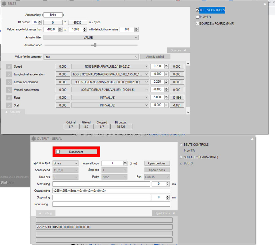

    Hello!!!
    Help, please!
    Every time I connect the board, the servo motor spins for a few turns... This is my belt servo.. it makes a mess!
    How can I do so when I connect it, it stays just where it is?
    Thanks a lot, my body and hands appreciate your help!

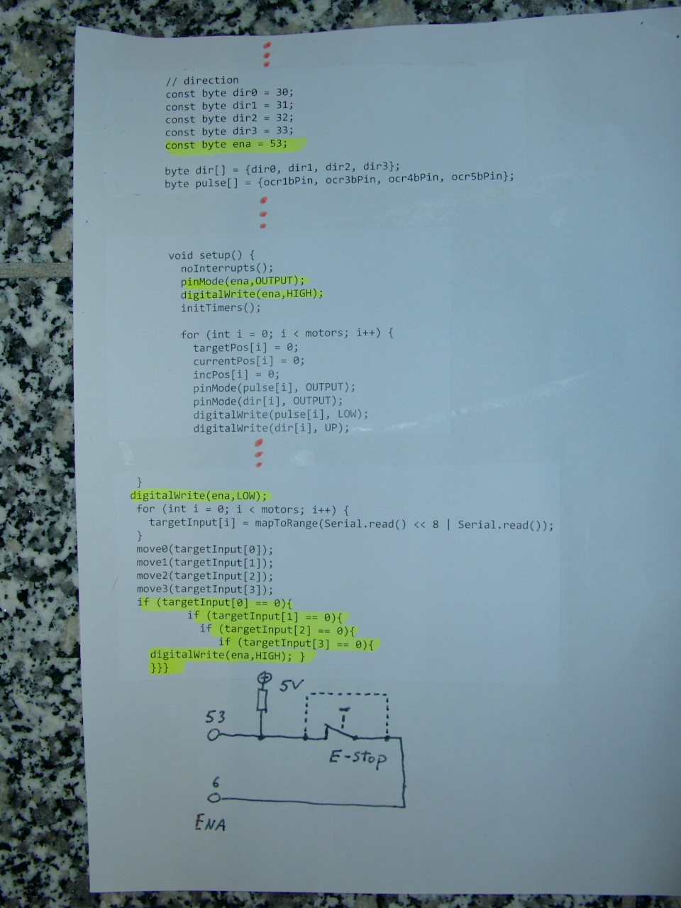

    I can get the enable pin to work... I follow your schematic, PN003 = 0, but nothing happen with a basic digitalwrite high then low :

  4. wingert
    wingert Active Member
    Aug 10, 2020
    129
    738Coins
    +100 / 0 / -0
    4DOF
    the e-stop signal should be static, holding the output pin high until FlyPT sends data and the arduino recognized the start mark it switch to low.

    I agree with that @wingert , but my test code seems to be unable to enable the driver :/

    Hi @Rolo F, from my understanding of it is that is what it is designed to do as, go from its parked position to home position which is the center of the 100 mm actuator travel. I have only just finished reading the thread because I'm planning on using the code in my design and not actually used it yet or looked into the code but I would say that is where you would have to modify to achieve what yor wanting to do, just my two bobs worth.

    I guess I should change the arduino code... but I dont underatand about coding... but I could follow instructions :)
    For now what I do... connect Flypt, and just then power up the servo...

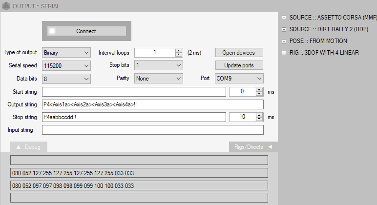

    1. STROKE_LIMIT 150 is enough, considering you also configured your AASD15-A controller parameters as stated in the README
    2. You should be able to use start and stop position for this but unfortunately I cannot test this being away from my rig. Instead of <Axis1a><Axis2a><Axis3a><Axis4a> you should send zero (4 times) for stop and 32768(4 times) for start position. Remember to start with "P4" and end with "!!" There may be other ways to tell FlyPT your starting position but I can't verify now.

    Try using stop position as above, with something like: P4<0><0><0><0>!!
    I'm hoping that's the way to tell FlyPT to send 0 position as I cannot currently test this.
    Note that because of the end dead zones (the Arduino code will protect the actuator by not going all the way to the end), you may still feel a bit of a 'drop' to physical zero, but it should be very little.

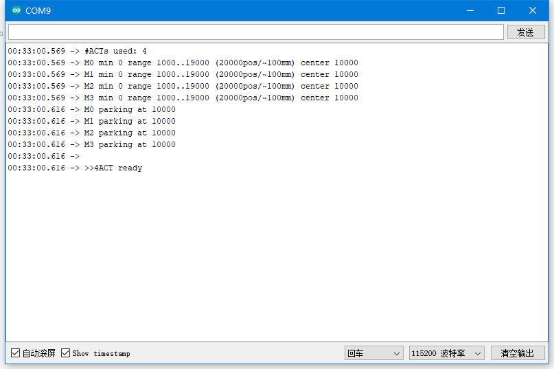

    added changes to the development branch to allow using command Ph<0><0><0><0>!!
    https://github.com/ehmotion/eh-msc-4dof/tree/dev/eh-msc-4dof_v2
    this command uses 'homing' speed to drive the actuator to the requested position.
    give it a try and let me know if it works as expected.
    careful if you made other changes to your code, like stroke length!!
    use this only for STOP sequence.

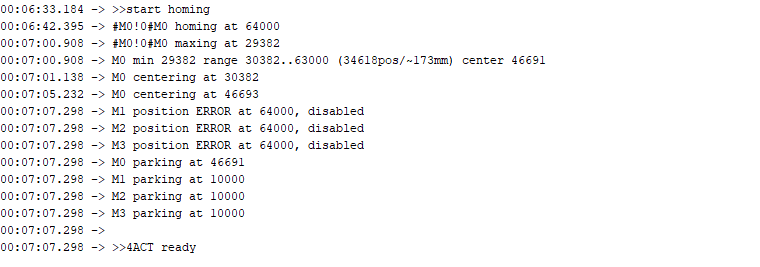

  15. zhai1987
    zhai1987 Member
    Sep 7, 2021
    96
    320Coins
    +11 / 0 / -0
    2DOF, 3DOF, AC motor
    Brother, set, very fast return 20mm

    make sure you deploy the correct code from the 'dev' branch.
    it works fine on my side and you can test it from Arduino IDE Serial Monitor but be careful if you're not using the 10uF capacitor on reset since Arduino IDE will reinit the board when you open the Serial Monitor.
    use the following commands, with "No line ending"
    -go towards end point
    Phzzzzzzzz!!
    -go towards zero point
    Ph########!!
    -go towards the middle point
    Ph????????!!
    using P4 instead of Ph should have the same effect but uses fastest speed.
