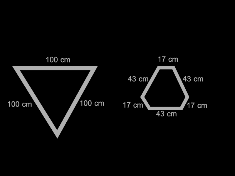

    That 6dof looks very compact.:thumbs what is its dimensions?
  3. fuad
    fuad New Member
    Sep 9, 2017
    25
    kuwait
    23Coins
    +11 / 0 / -0
    @Fluke find attached picture. the rig is done i will post more pictures soon. im testing and configuring it.

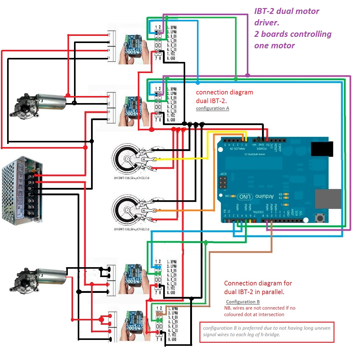

  4. absyfadhel1
    absyfadhel1 Active Member
    Oct 19, 2017
    347
    bahrain
    556Coins
    +37 / 0 / -0
  5. Gadget999
    2,026
    12,353Coins
    +498 / 11 / -0
    just connect the + - and signal wires together so they produce half the current each
  6. absyfadhel1
    Oct 19, 2017
    347
    bahrain
    556Coins
    +37 / 0 / -0
    sorry i did not get it , is this picture the same?
  7. Gadget999
    2,026
    12,353Coins
    +498 / 11 / -0
    That should work ok

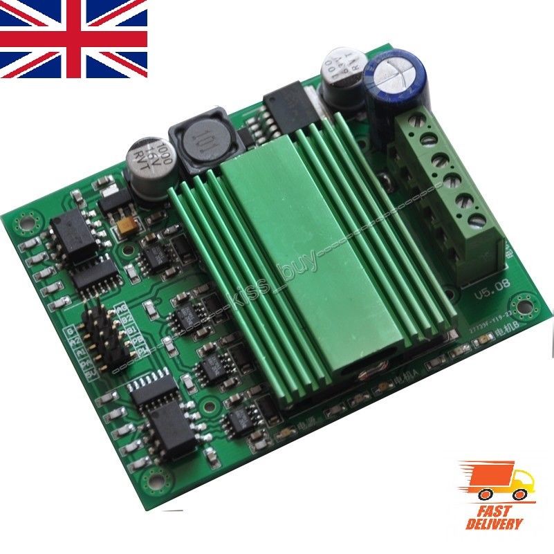

    is there any powerful board to replace it with ibt-2?
  9. Gadget999
    2,026
    12,353Coins
    +498 / 11 / -0

  11. Gadget999
    2,026
    12,353Coins
    +498 / 11 / -0
    yes - it can drive 2 motors - it uses pwm and direction pins same as ibt-2
  12. absyfadhel1
    Oct 19, 2017
    347
    bahrain
    556Coins
    +37 / 0 / -0
    what is the board name so i can order it from amazon?, becuase my ibt-2 cut the power from the motor

  14. Gadget999
    2,026
    12,353Coins
    +498 / 11 / -0
    yes - that looks like it
  15. absyfadhel1
    Oct 19, 2017
    347
    bahrain
    556Coins
    +37 / 0 / -0
    great, sorry for annoying, you think this driver could run 2x 12v 300w motor? , becuase my ibt-2 cut the power from the motor when there is force while the motor can take force via direct cable to psu? , so you think this driver will make it work?
  16. Gadget999
    2,026
    12,353Coins
    +498 / 11 / -0
    yes - it can handle 100a continuous and 200a momentarily
  17. Billel
    Billel Member
    Mar 29, 2022
    37
    195Coins
    T
    the wiring on the bottom motor is wrong, the positive and negative wires of the motor should go to each of the two IBT2 (in the picture, the positive goes to 2 pins of one IBT2, and the negative goes to 2 pins of the other IBT2)
