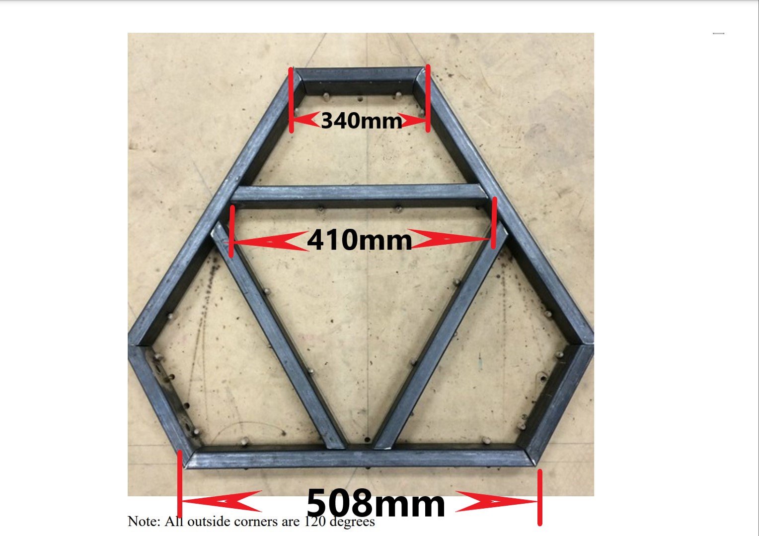

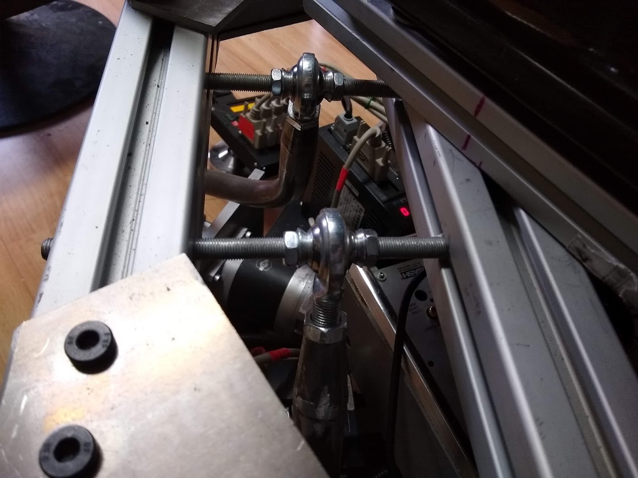

    Hi. Looks like you’ve got it working nicely. I see you changed the upper platform from steel to aluminium sections. Was that just to do with weight and how has that worked for you? Thx

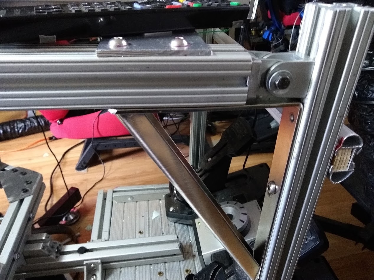

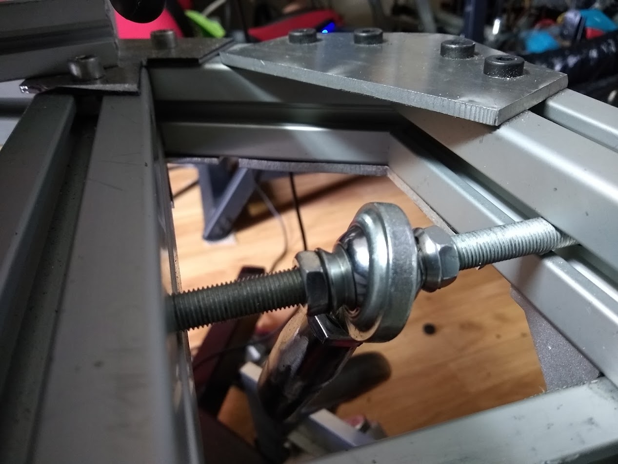

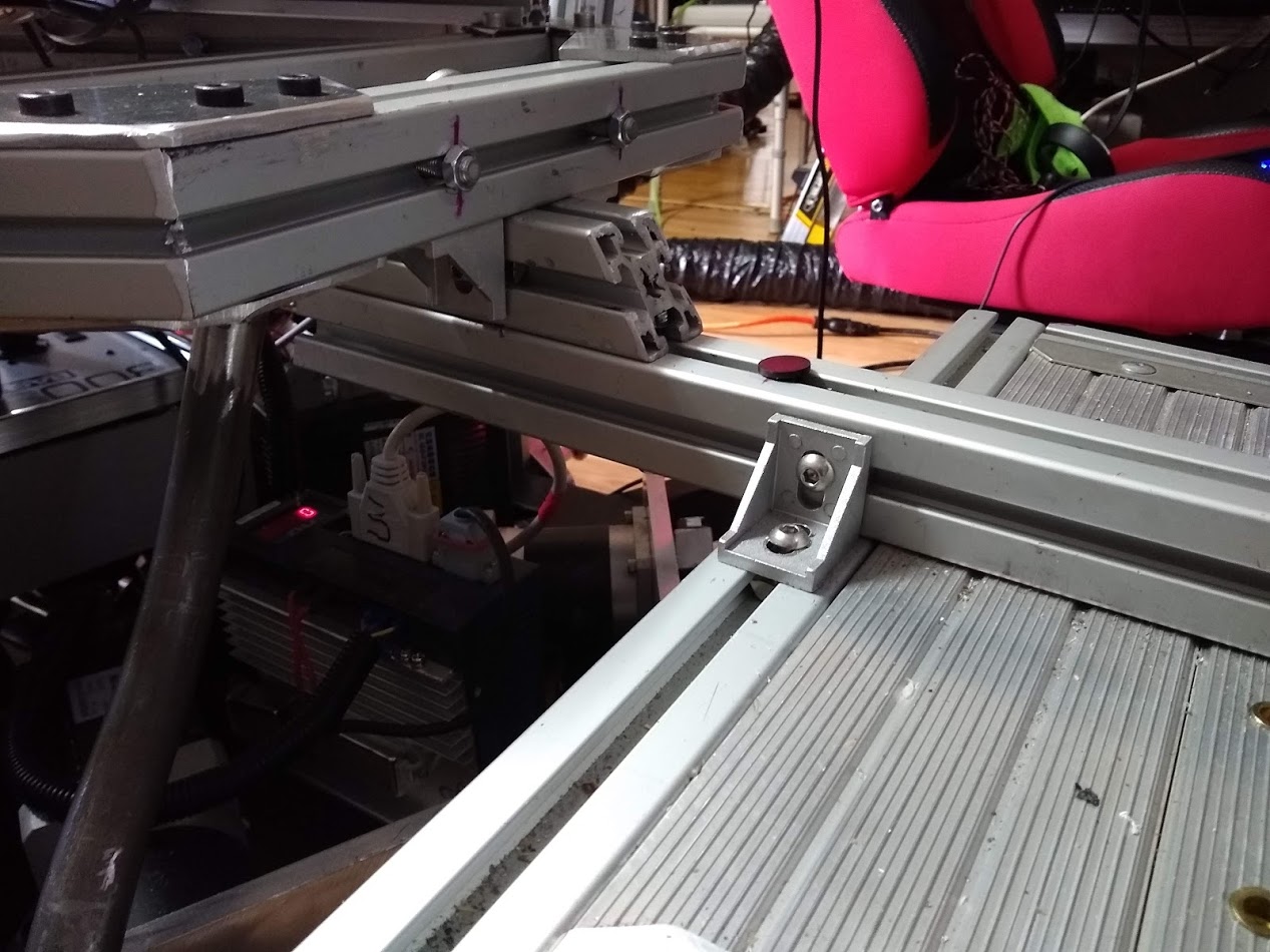

    @sallerding It has worked out really well. I do not know if you are familiar with Grigorys' 6DOF thread but that was the one that got me interested in the basic design. He had mentioned that it was important to keep the weight down on the platform. I cannot weld Aluminum and having a shop do it is very expensive. So I bought a 4meter length of 40mm 80/20 extrusion. I was unable to find a source of 60 deg corner brackets and just cut those you see from aluminum plate (plates are on the top and bottom)
    The platform is held together with a lot of bolts and is extremely stiff. The design also allows the connection point of the Hiem Joints to be adjusted by about 100mm.
    The picture of the steel platform is not mine but borrowed from a sim forum that appears to have been abandoned. Here is a link to that forum.
    It is a bit dated but then in todays world 2 years ago is ancient history !
    I did try to contact the author of the build but he never replied.
    https://motionsim.freeforums.net/thread/176/dof-step-diy-project-blueprints

    Thx. Yes I can see from the number of bolts that it looks pretty solid without much movement. Novel way of connecting the universal joints also. I take it it has undergone human trials (not just rabbit trials :)) and the aluminium holds up under human weight and under reasonable stress. Do you have the dimensions of the upper platform you can provide? Thx again
  5. T R Para
    T R Para i make stuff up
    Oct 18, 2018
    385
    Cincinnati, Oh
    2,444Coins
    +357 / 3 / -0
    AC motor, 6DOF
    @sallerding Yes it is very solid. I weigh just over 100kg and no problems. The 40mm extrusions are probably over kill. There are only 3 different sized pieces to the platform x 3 so the measurements are pretty simple. All the pieces were cut on a 12" powered Miter saw with a metal cutting blade set at 30deg. I threw in a bunch of other pictures. (I like pics):think

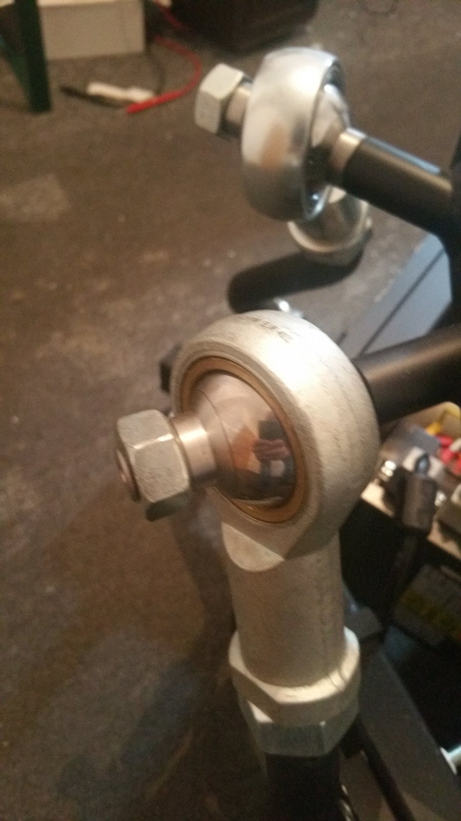

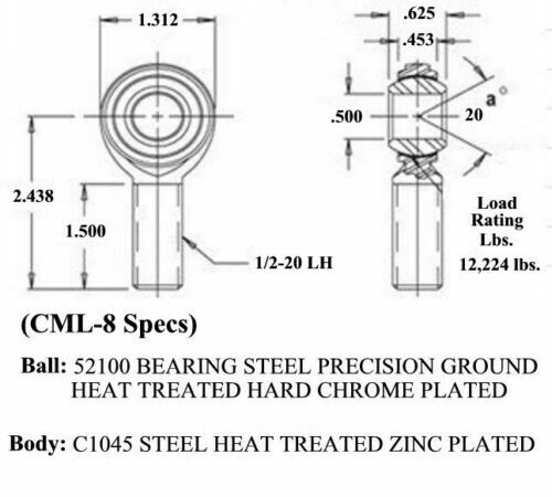

    very cool i had similar adapters milled so that i got more range in the ball joint
    i use m24 balljoint really oversized but i got a large angle and i can move now all position without
    mechanical limits.

    WoW those are pretty massive. I bought mine off E-bay and they are only 13mm (1/2") and still cost me $200 USD for a set of 6.

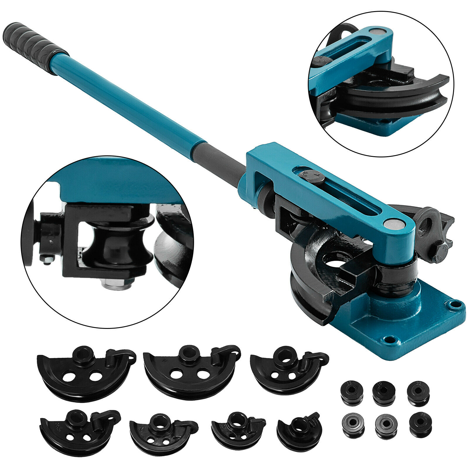

    But the best part was watching me bend the pushrod tubes. I bought one of the $130 USD Chinese benders off Ebay and it was very hard to bend the 25mm steel tubes. But I got through it OK.:blush

    Do you think it would be a good idea to build the bottom frame out of aluminum extrusion (4040 or maybe 40-4080?), similar to how you build the top frame (where seat mounts)? Or would welded steel be the better choice

    @xeg1101 I built the lower assemble out of steel because I could weld it myself. As it turned out it was a good choice. The extra weight makes for a stable base. You do not want this thing moving around on you.:):):)
    A base made from extrusions would work also. The cost will be much higher as all the connecting fittings will be expensive.
    The choice for the aluminum top deck was because I had already purchased the 4040 extrusion. You could do it in steel and it would be fine. Some guys commented on the fact that the less mass you have to move around the better.
    @sallerding Here in the US we have to buy in imperial measurements. So the tubing was 1" od by >.065" wall cold rolled steel. It was amazing how difficult it was to bend with my Chinese Ebay tubing bender. Had I chosen a thicker wall tube I would've never bent it. It would of had to be done at a fabricating shop.
    The tubing I used is plenty strong.
