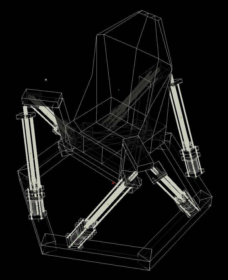

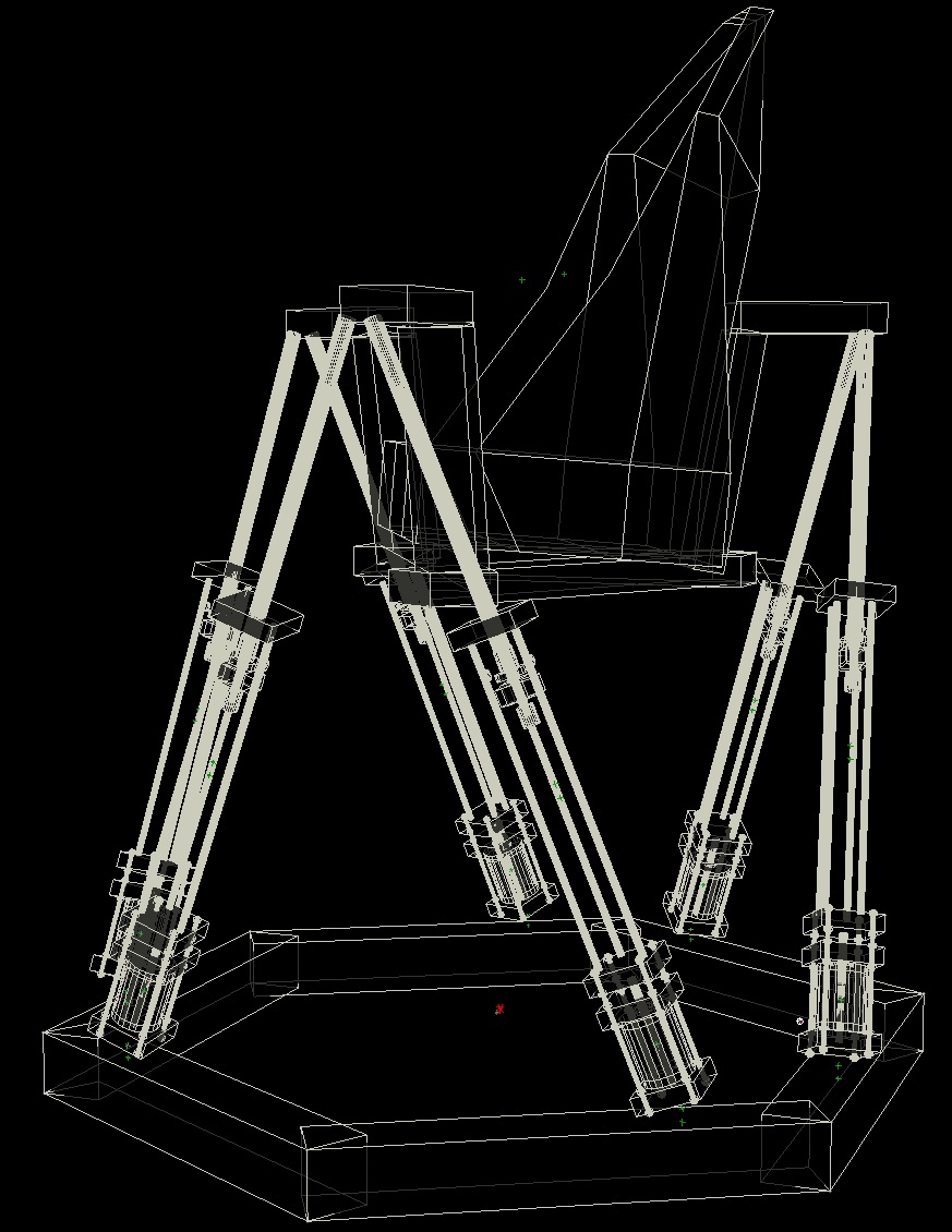

    I settle down for a smaller base, with a slightly inverted actuators.
    If the actuator could do 400 mm of travelling (will probably be a lot less) the highest position would go at 175 cm approximately.
    A metal support for the seat looks like a better option than wood. Will see what we can do. Still to be develop.

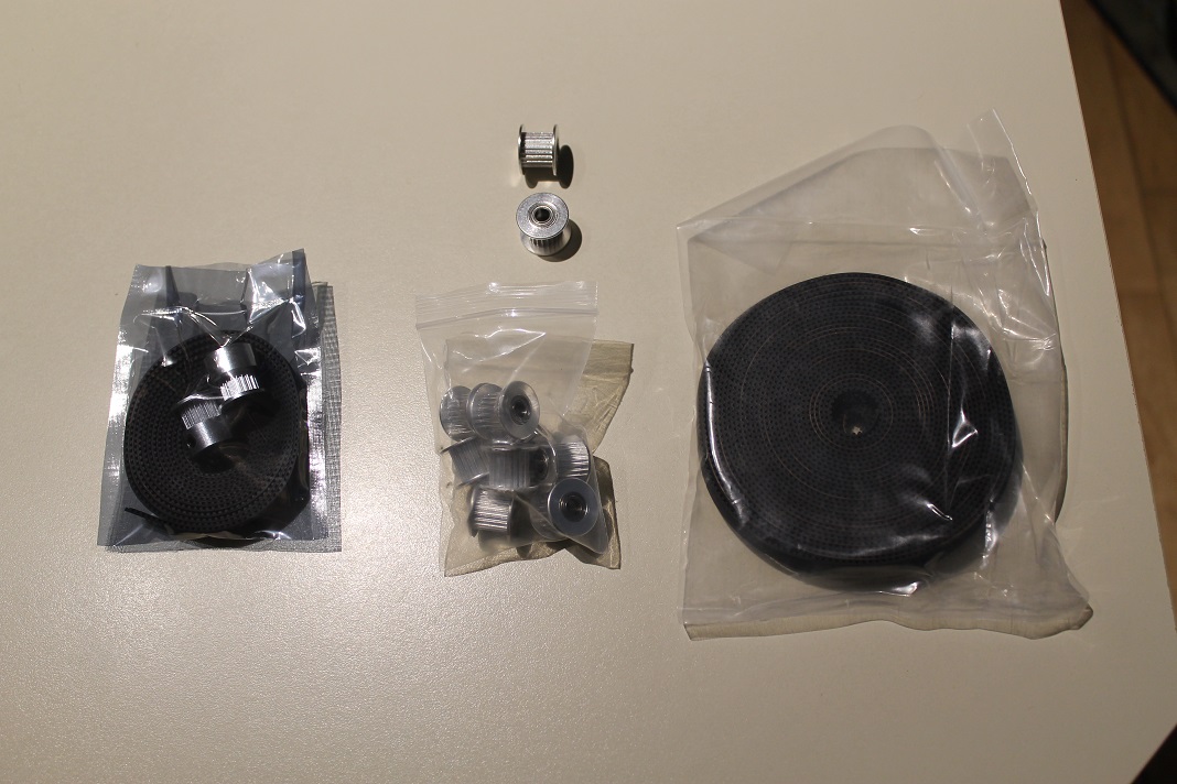

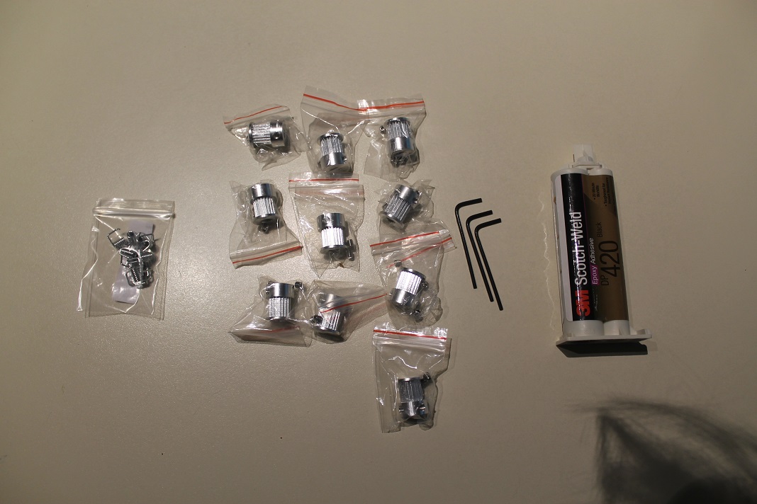

    Yeah, weekend gifts!
    In the small one, 25 mm adapters directly from England. It appears its the only place in the world to have those. Every things around here is imperial.
    But they fit. I wish they would have been a bit tighter, but they should do.
    Fortunately, I could also gather a few things from around here.

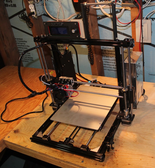

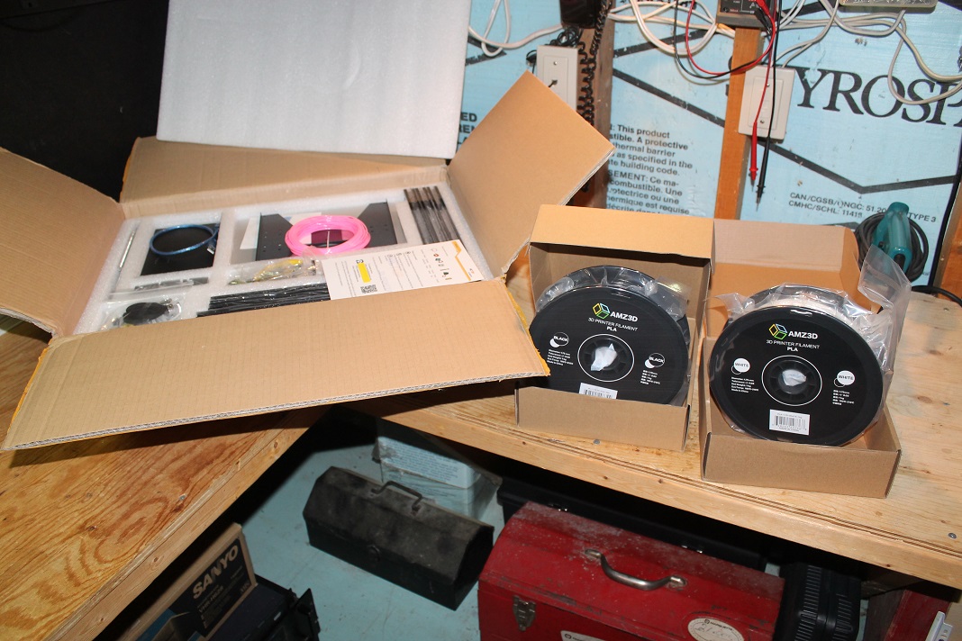

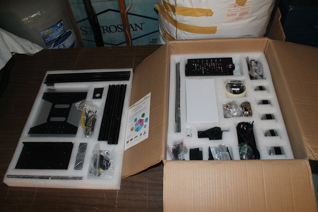

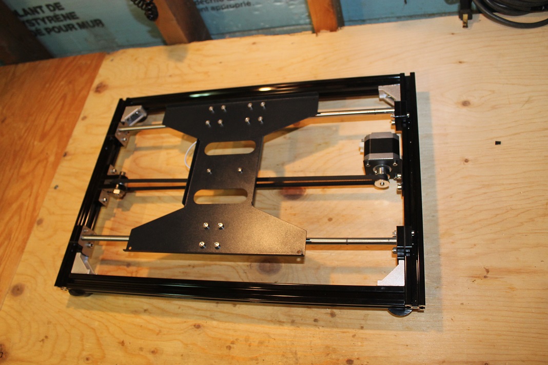

    This is what I received this week:
    [No Picture]
    It feels strange. Can't be Christmas every week I guess. Well, it's fathers day anyway this weekend and I had plenty of work to put my 3D printer together. And you know what, it's done!
    Almost... Unfortunately, I'm still missing the strap that I screw up. They say it's shipped, but they don't say when I'll receive it.
    I was able to test the movements of the z and y axis. It's stepper motor, but, it feel like controlling dc motor actuators.
    It did not catch fire. That's always a good sign.
    • Like Like x 5

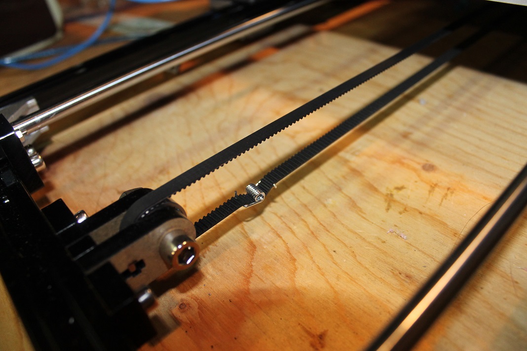

    I knew I was not on the naughty list... Yet. The Uline catalog is not really related to this build, but I received it none the less, and is always nice to look at.

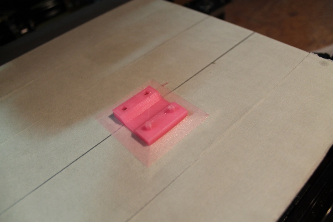

    My strap! And a bigger one for the actuator. Unfortunately, I am still missing the gear for the potentiometer.

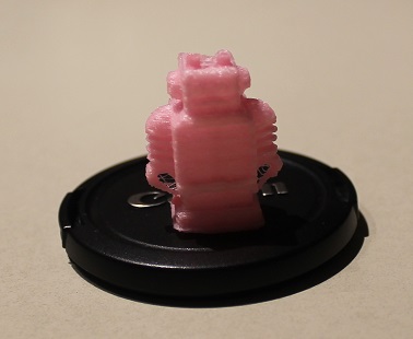

    So now, I have a working 3D printer. My first print did not turned out too bad.
    Ok, it is quite small. But you have to start somewhere.
    It is our National Celebration this weekend. Don't know if I'll do much on my build.

    I did not even noticed that there is a printing section to the Forum. Will check it out for sure. I don't want to go too deep into 3d printing yet, because I know myself, and if I do, I will neglect my 6dof building. I just want to make decent print for now, so I can make parts for my simulator. There is so many hacks for the printer.
    Still, breaking my rule right away, what do you mean by Slicer? I am not yet fluent in the 3D printing vocabulary.
  13. Nick Moxley
    17,057Coins
    +2,507 / 30 / -2
    a "Slicer" would be the program that takes a .Stl and makes it printer ready. Some are more cumbersome than other's, some take For EVER to render the slice, and some cost legit $$$. but you know, just lmk eh. ;) ;)

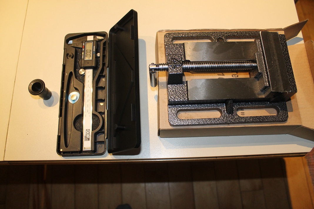

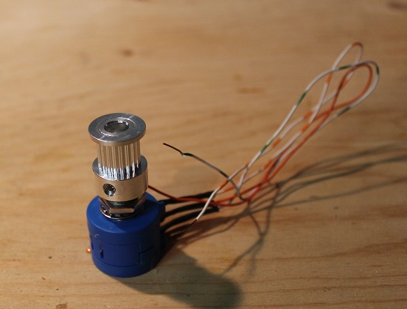

    The gear for my potentiometer. The only missing part now to get a full working actuator prototype would be the v shaped wheel. On your right, the precious epoxy to keep it all together. The spring are belt 'tentionner' for my 3D printer. I know that they are not recommended that much, as they may introduce other problems, but until I can print proper part for it, they will do.
    This is not from mail, but from local store. Still, they are directly related to this build. Trying to get mot precision in my life, I got myself a caliper. The little part is a plastic piece that is 22mm in diameter, I thought it could be useful and bought one piece to test. The vice-grip is an accessory for a future tool... More to come on this. :)
    I should be working on all of this tonight, but I am tired. I when to an ANNIHILATOR show last night and pass my bed time big time. I'm getting old for that type of stuff. But it was great.

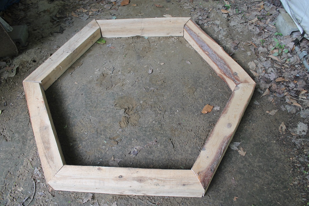

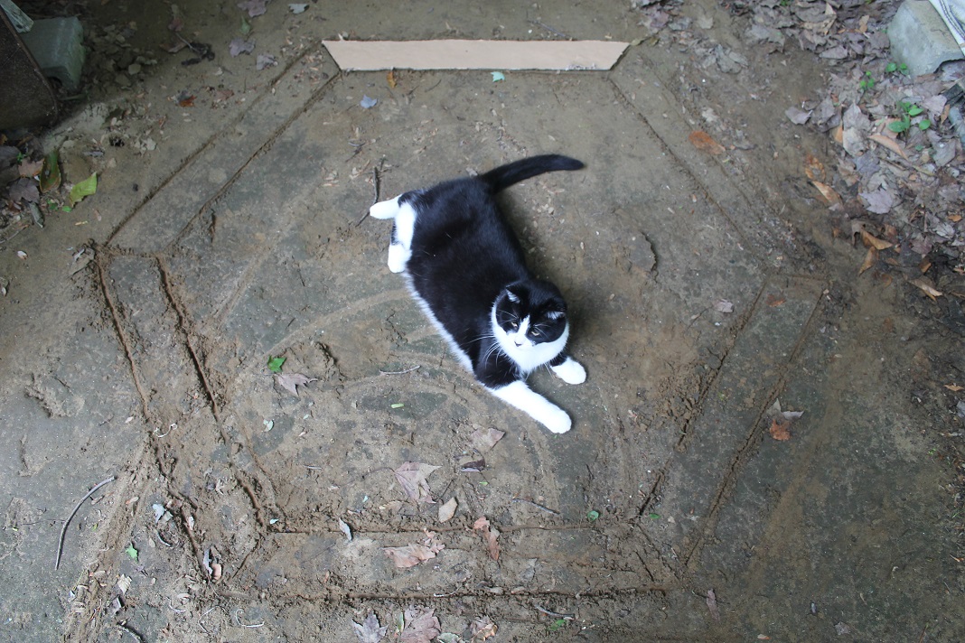

    This morning, I got up early and when outside to check out my measurements of the base. I did a crude cut out made of cardboard and trace it to the ground. Again, precision is... Absent. But it makes sens and it should be right. The cat is there for size reference. :)
    Why didn't I cut it right away? MOSQUITOES!

    Cute cat, it looks like it wants to claim the title of project supervisor :grin

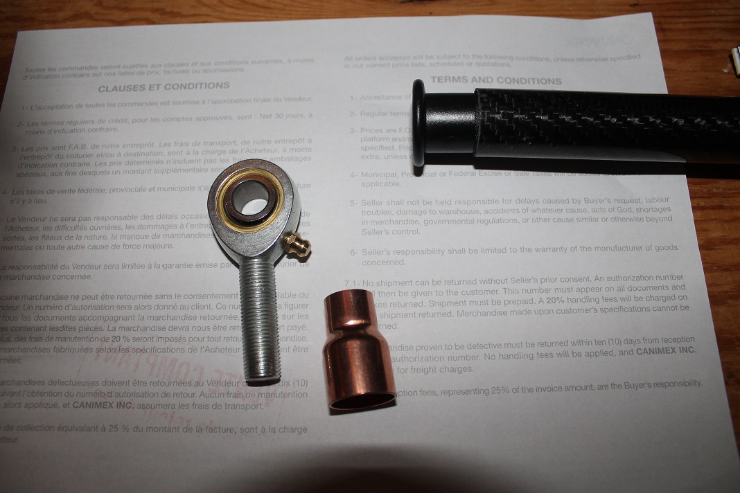

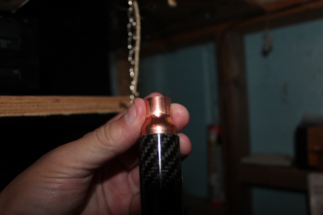

    I have found one part in a foundry around that I bought to test. Its threaded rod is a bit short and I don't have the nut that goes with it. I am not sure it is the right solution for me. The plastic tube do fit in the carbon tube. Not sure if I will use it, and for what, but it is a possible option.

    And my cat boss told me it was time to go outside, the mosquitoes were gone. This is a great example of my wood cutting skill. I think I'll make the platform out of steal. :)
