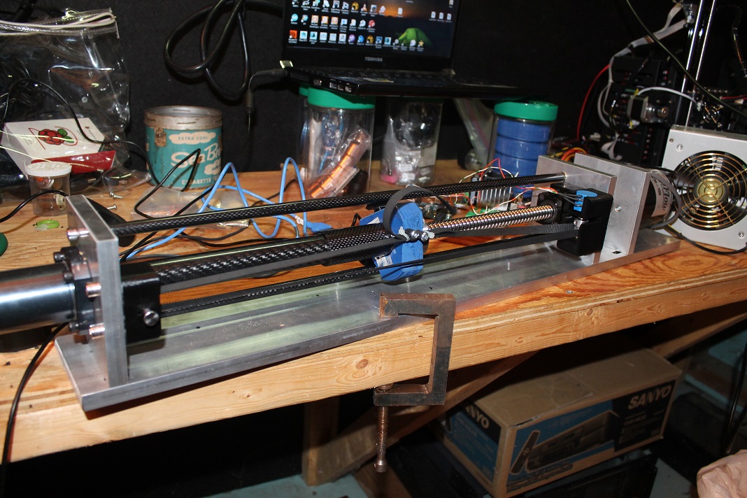

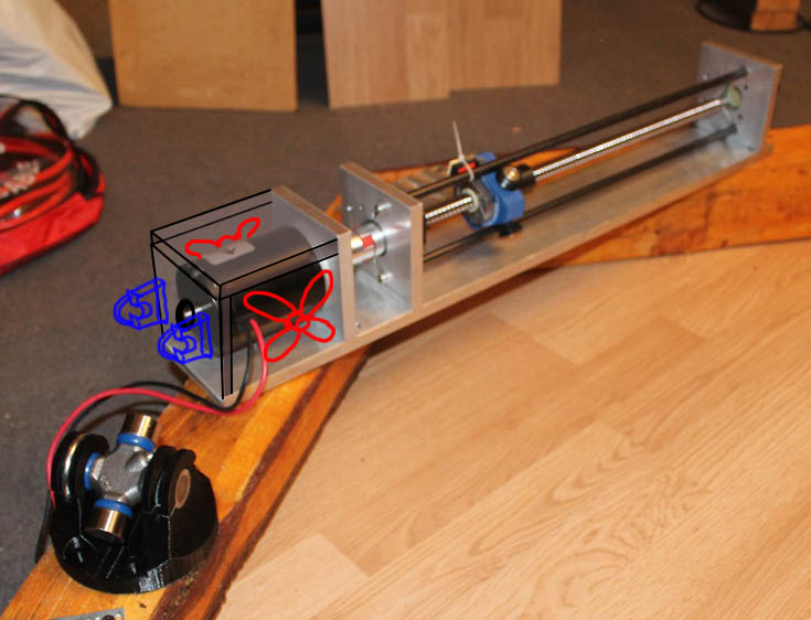

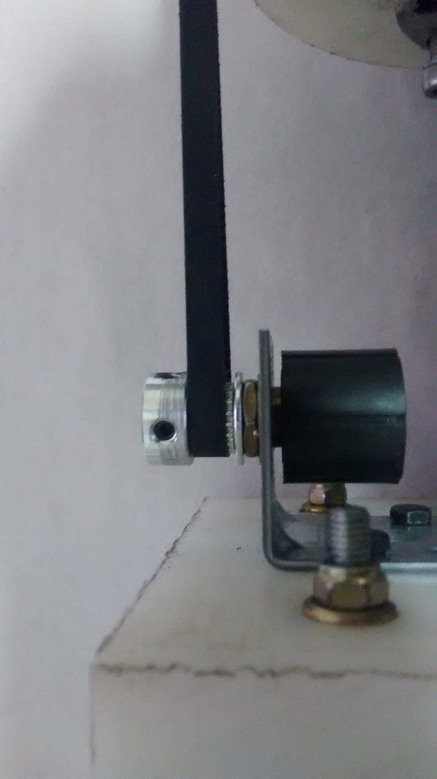

    I was sure that the 10 turns of the potentiometer would not cover the full traverse of the actuator. Now, I am not so sure it would not. I will take this in consideration for the next design. Still, I don't want to put stress over the pot shaft and still have a well bend strap. That is a nice design challenge.
    I don't think I could use the screw holes on the motor for full support because they are really small. I would obtain tiny rod out of it. But, you gave me a great idea. It started by adding a back plate attached to the structure screwed also to the motor for more solidity. Then, why not attach another plate on the other side just the length of the motor? A box around the motor. The end of the actuator would now be strong, ready for almost any type of attachment, at a reasonable cost. I could attach fan on each side to ventilate the motor. I think I finally found the right way to go about it. Thanks for the inspiration.

    500mm travel of the shaft, 2mm pitch belt and 40 tooth pulley yields almost 7 turns on the pot. You still have 3 turns extra.

    Exactly, I'm using the pot directly attached and I don't have any problem, also, the pulley was lathed so it can fit over the pot screwable part to lower the lever force over the shaft. You have a 3d printer so you can do a custom part to lower the stress over the shaft.

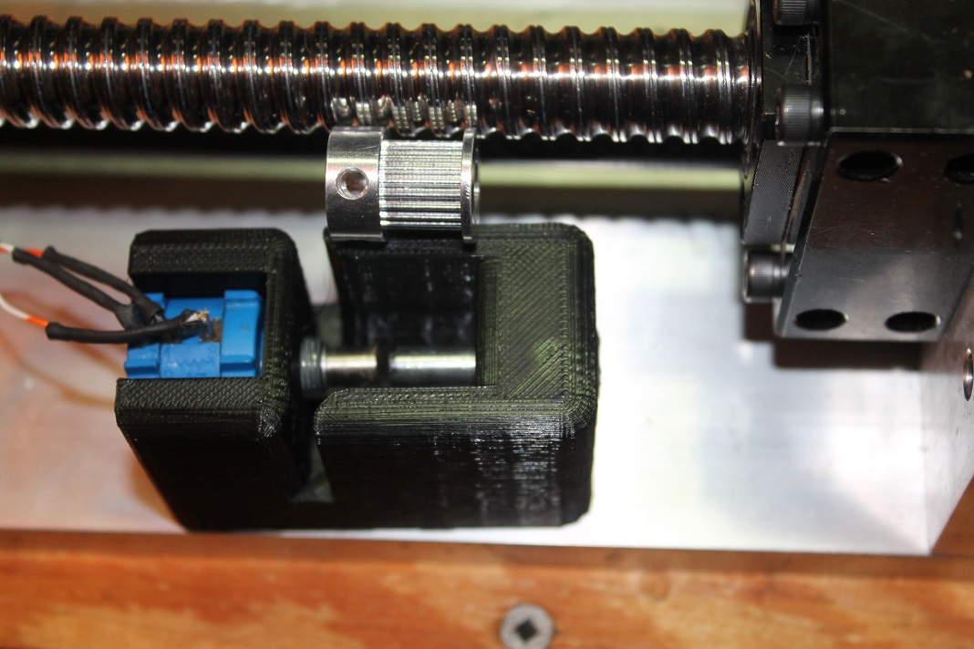

    I don't have the pulley with me, but from my picture and the one from @mariano68, I count about 10 tooth on one side. So I figure they are 20 tooth pulley. But, I don't have a full 500mm travel of the shaft. So, I should be fine.
    The plan is make a part that support the pulley just before the fixing screw, and attache the pot on the other side.

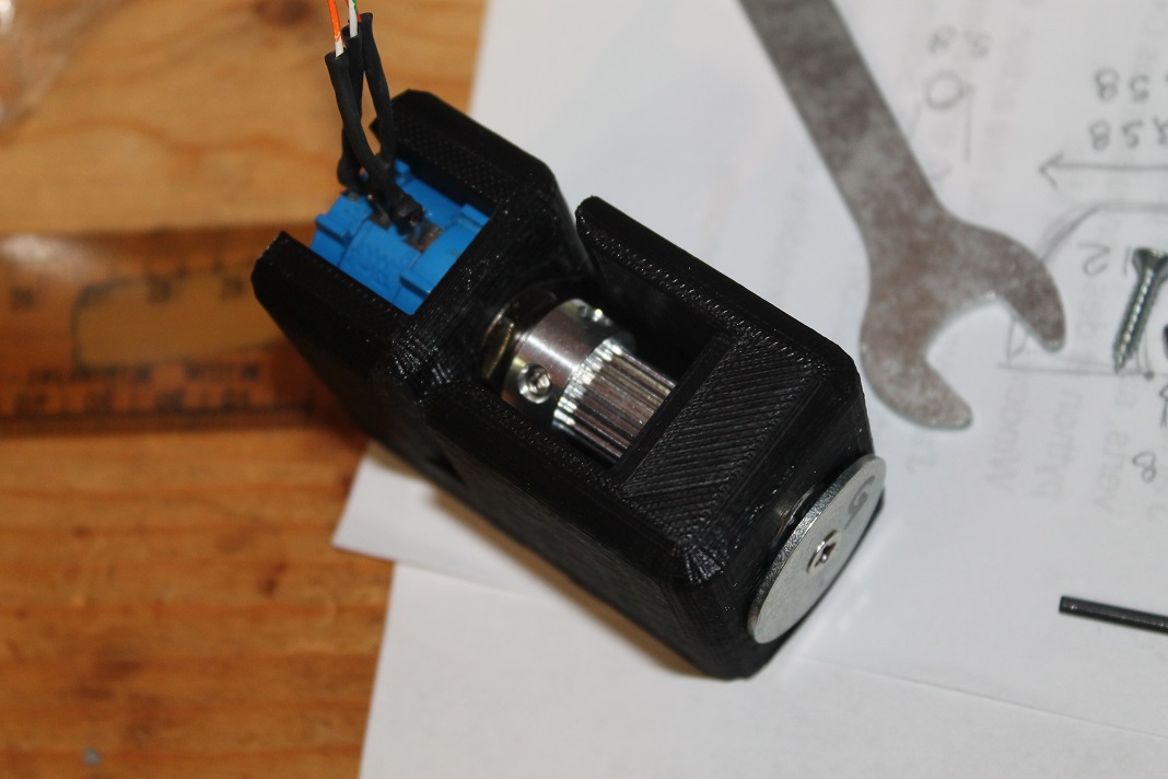

    So, here is the design. Most of the stress should be on the bolt and much less on the potentiometer.
    It was not easy to fit it in, but with fortunate tools, I was able to build it up.
    Then, fitted into the actuator. I did not bother much with the straps orientation and how far it could go.
    I just wanted to see it work. I'm holding it up because nothing is glued and there was a lot of vibrations.

    Awesome design. It was exaclty was I was planning to do. However, now I want to test a quadrature encoder instead of the potentiometer.

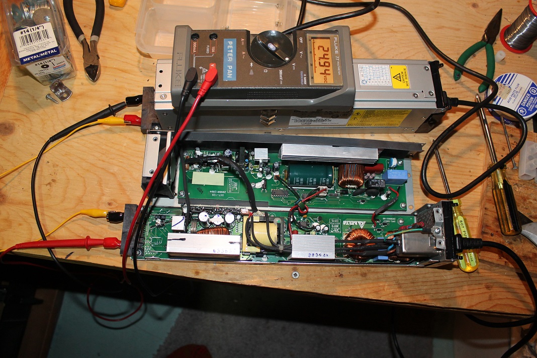

    Indeed, after cutting 2 jumper in one of the PSU, I could get 24v. Yeah!

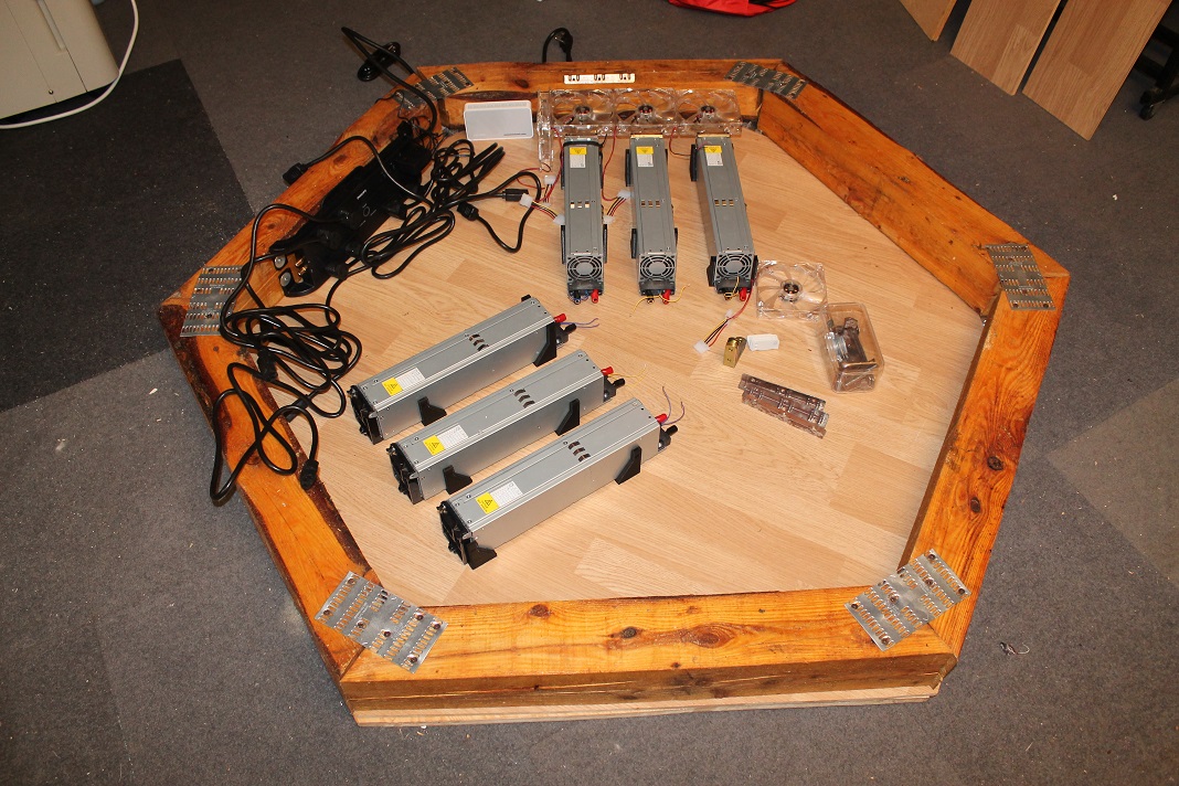

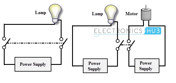

    Question! If someone is listening.
    How do you guys set up a kill switch with PSU? I tried to use the back connections to kill the PSU. They work on individual PSU, but I cannot connect them in series or parallel to kill 2 or more PSU in one go.
    How can it be done? Any ideas?

    you would need to use a double pole switch so that you are physically switching two separate circuits. The lamp would be power supply 1 and the motor would be power supply 2, in this configuration they are still isolated so it will work. as for what connections would need to be made, you would have to figure that out in the pin out of your power supply.
    more information on switches here
    https://www.electronicshub.org/switches/
    Most emergency stops already allow for switching two isolated circuits or additional contacts can be added to accomplish this.
    Or if you are switching even more supplies (or additional equipment) you would move to relays and then a single switch could control an infinite amount of individual circuits. In my case everything is setup on relays and when I hit the e-stop it turns off all of the relays in turn killing everything that I deemed to be dangerous. This is more complicated because it requires an additional control circuit, but worth it in my opinion to have a single switch turn off everything.

    Yeah, maybe I could have used a switch with multiple connectors to turn off my PSU, but I have 6 of them. Anyway, my first plan was bad from the start as they take 2 seconds to shut down. In a dangerous situation, 2 seconds is a long time.
    So, like you said, I went the relay route. But I had not much idea how strong they needed to be. So I asked @SeatTime what he used. You can see the start of a great conversation here: SeatTimes 6DOF DC build Really, informative.
    I'll be using six 70A relay driven by 12V. This 12V will be provided by another relay, driven by 5V. This 5V will pass by all the limit switches, the panic button and probably 3 other relays, each driven by my arduinos. This will ensure that every system are okay to go before powering the motors, and stop them if anythings triggers. At least, this is how I plan to do it. Waiting for the parts.
