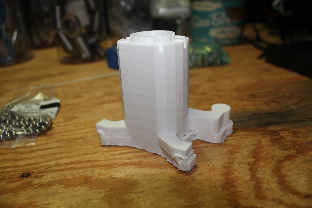

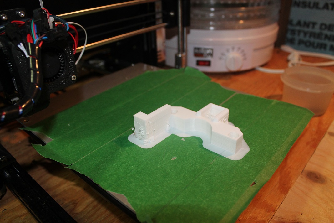

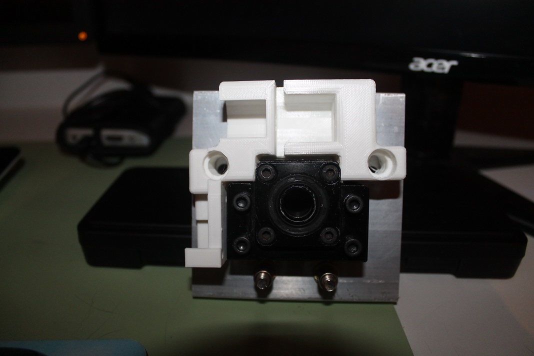

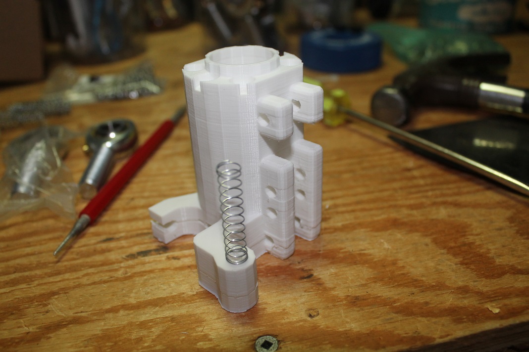

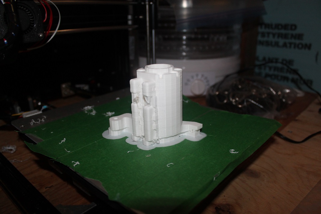

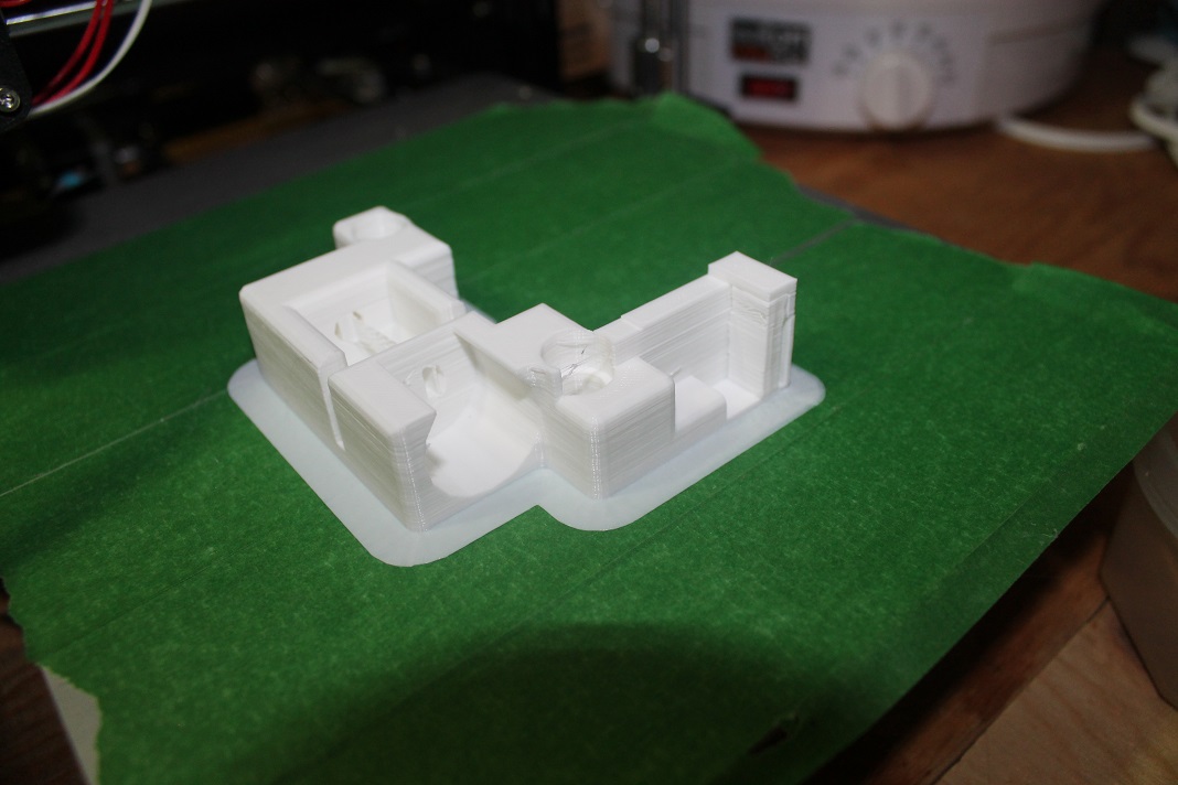

    I have new parts! They are the end parts of the actuator where to screw the joint. They are nice, they fit right in and my build cost went up 100$. As far as I know, they worth every penny.
    Also, I finally got back to designing the potentiometer support with the added limit switch. Why was it so long. I was scared I could not do it, and for a reason. It is quite complicated (well, it was for me).
    My first time using support for bridge structure. Quite intriguing.
    Scary to remove, but not that hard.
    But of course, I made it too tight and nothing fits.
    Even with some cut away, I could not make it fit. It has to be redone. I was quite discouraged.
    At least, the switch part was working, even if it needed a bit more clearance for the connectors.
    So, it was back to the drawing virtual table. I was sure I had to start it all over, but no. I could make the adjustments and add some strength to it (so i think). I is printing right now. I'll see in a few hours if I am still discouraged. :)

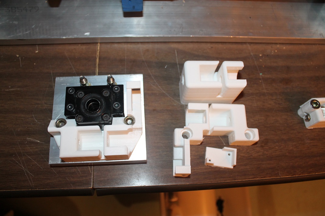

  7. Pierre Lalancette
    Dec 11, 2016
    1,012
    Tech Artist
    Quebec, Canada
    8,052Coins
    +947 / 6 / -0
    3DOF, DC motor, Arduino, 6DOF

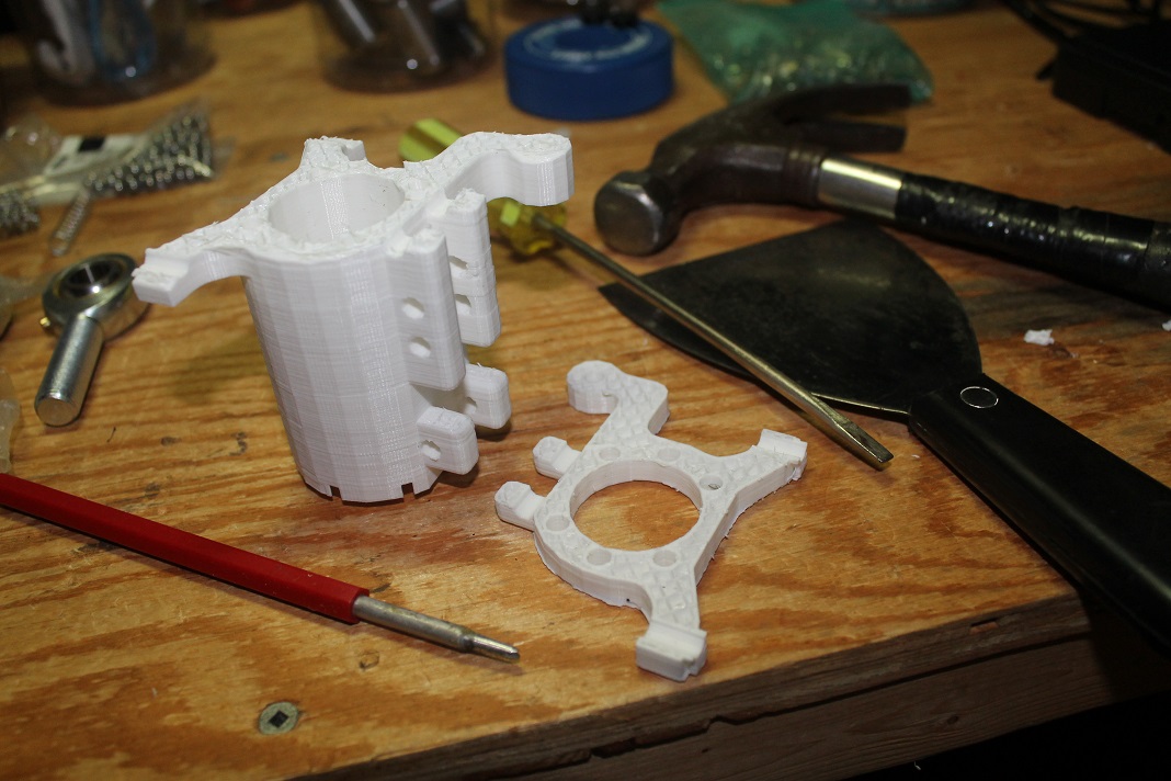

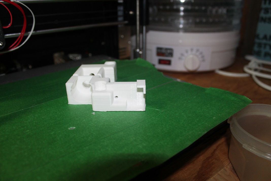

    Wow! Am I happy?
    I was able to get it right the second time around (if you don't count all the tests I did for each individual parts). It is tight, but it fits.
    As usual, I put the walk of shame beside the finished product. But I should say the path of experience.

    The top part. Still needs some adjustment here and there, but I am getting good at it.
    Now I need to design the middle part, to replace my puck... That I still thing is a great idea... But I've been recommended to change... Social pressure...

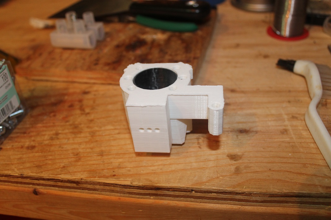

    One of my middle part of my Actuator is printing...
    But since it was not good enough today to go to the water park, we wondered around town today. Look what I found in a pawn shop, waiting all that time for me.
    I am a lucky son of a beautiful mother.

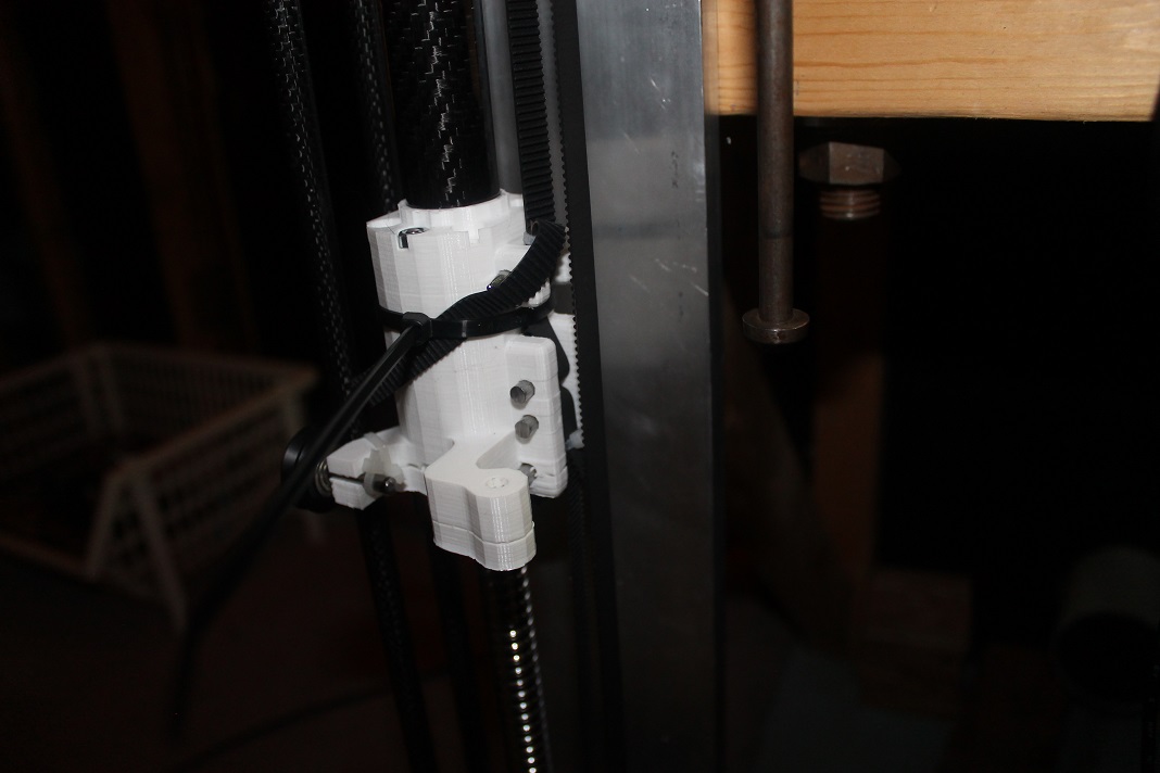

    Thanks Noorbeast, This is probably how I find it back, after many wondering around the site.

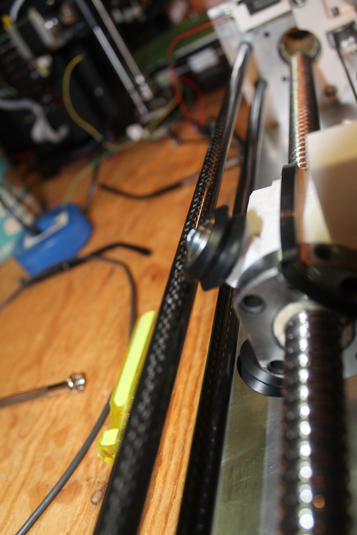

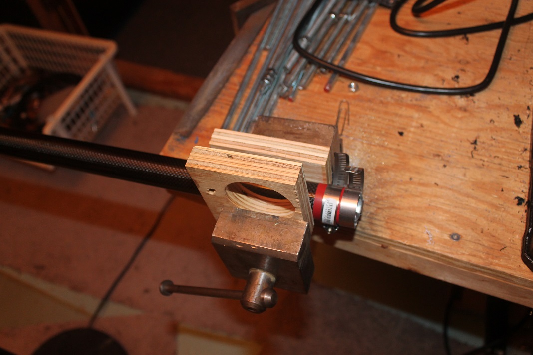

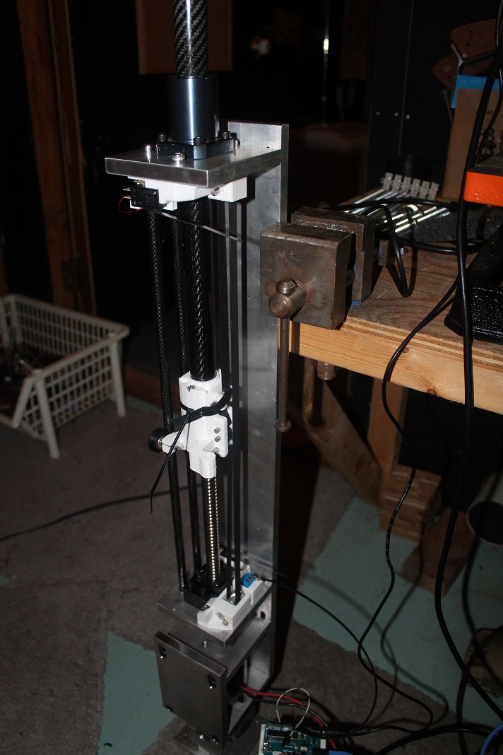

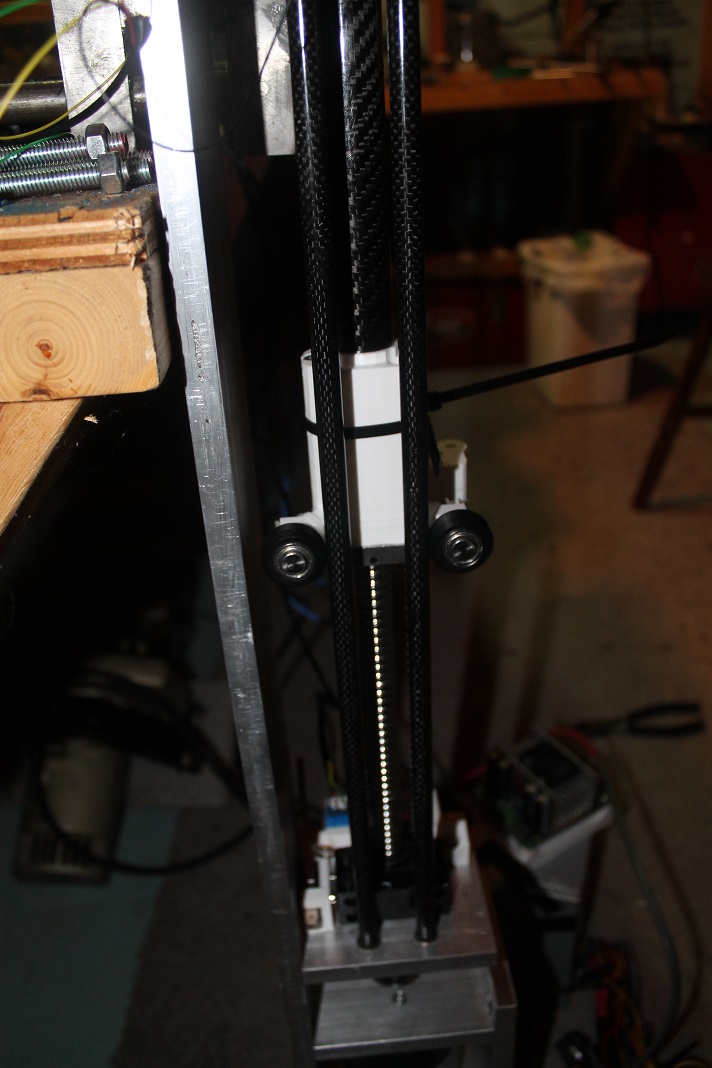

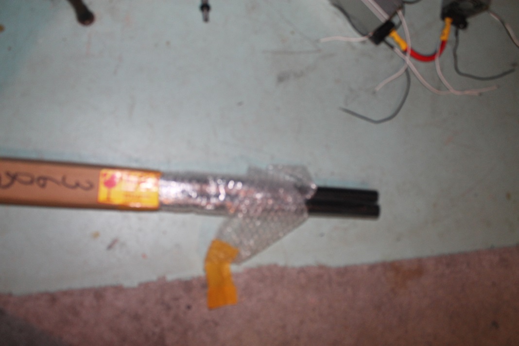

    I cut my cabon tube. I'm better at it and I know how to do it more straight. Warning, I read somewhere that carbon tube powder is highly dangerous. Don't breath it.
    It fitted perfectly into my part. But this is when I found out I was way off in my measurements. Not enough support, the part will need to be longer. Redesign, again.
    Still, I made the setup so I could make it moves. Windows made me wait more than 3 hours for an update. :confused:
    My v-weel attachement are way of, they need a better design too.
    Using the attaches for the strap cracked my part. Redesign.
    For the bottom part, the limit switch is on the wrong side. Will have to redesign.
    The top part is on the right side, but how it is hold in place need to be more compact. It was already called for a correction in the design.
    Here it is in action. There is a lot of vibration, but the carbon tube is way to long and it attached poorly. But, I could see it in action. The weight is unknown. The motor is driven by a simple computer power supply at 12 Volts. The final will be drive at 24 Volt. It did not break a sweat.

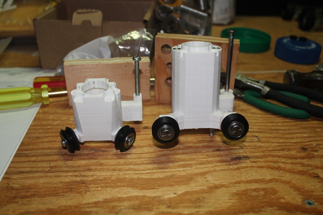

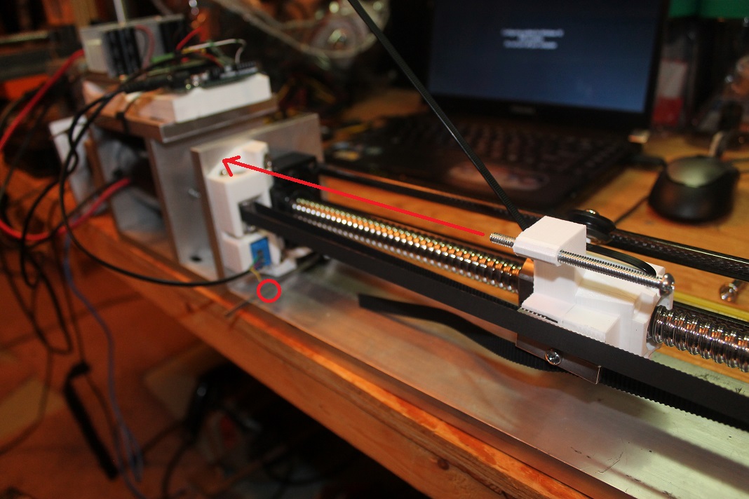

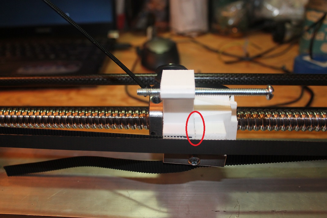

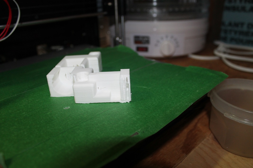

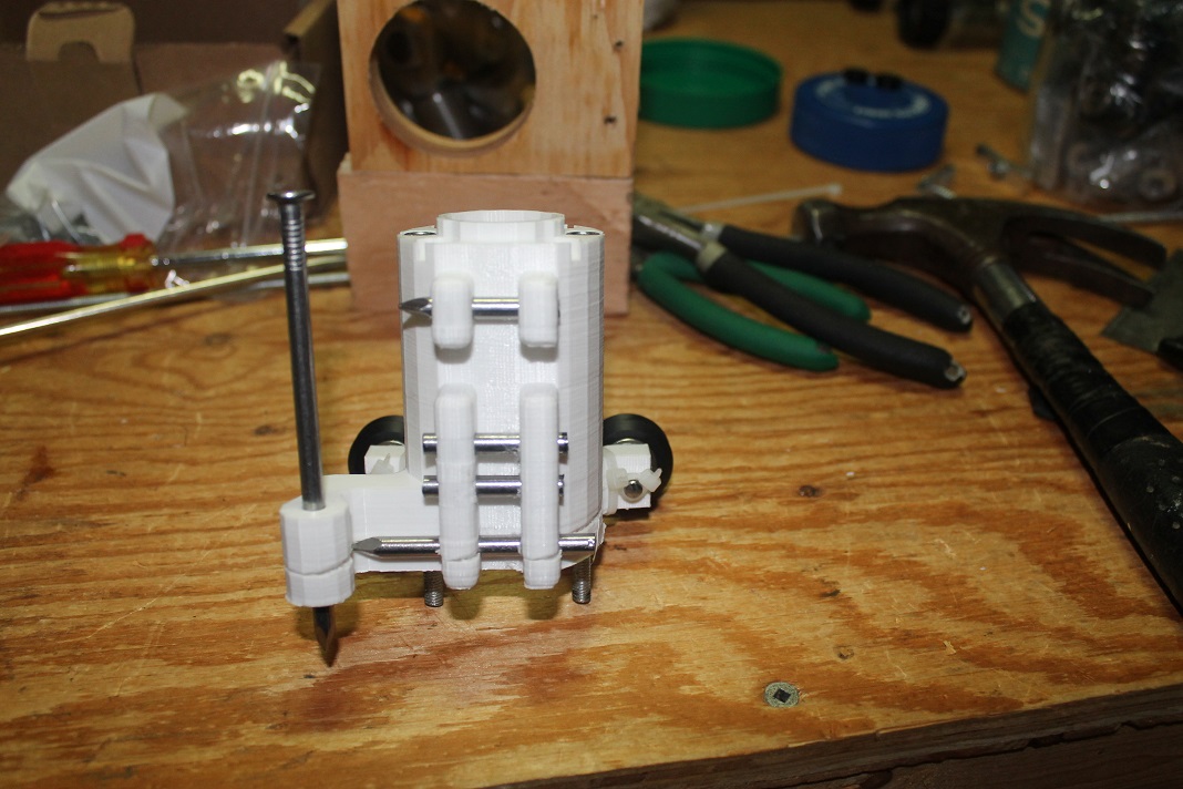

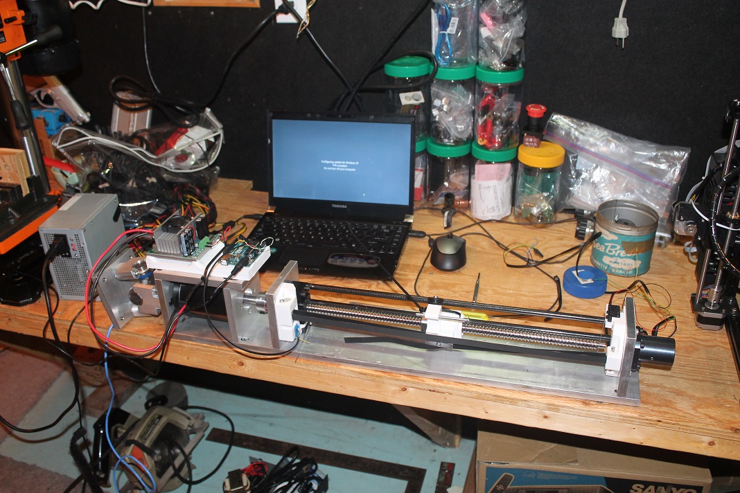

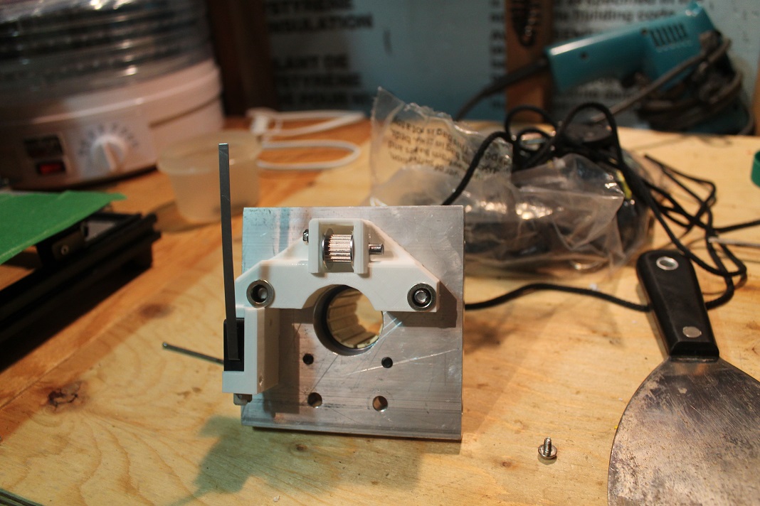

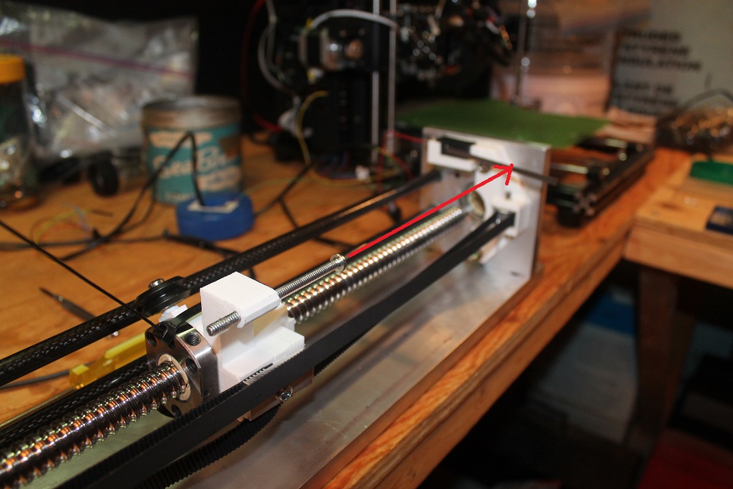

    I have not done much on my build this week, due to incredible weather outside, but...

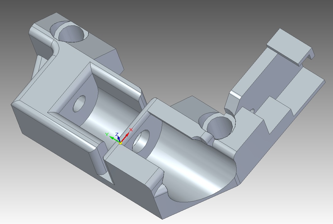

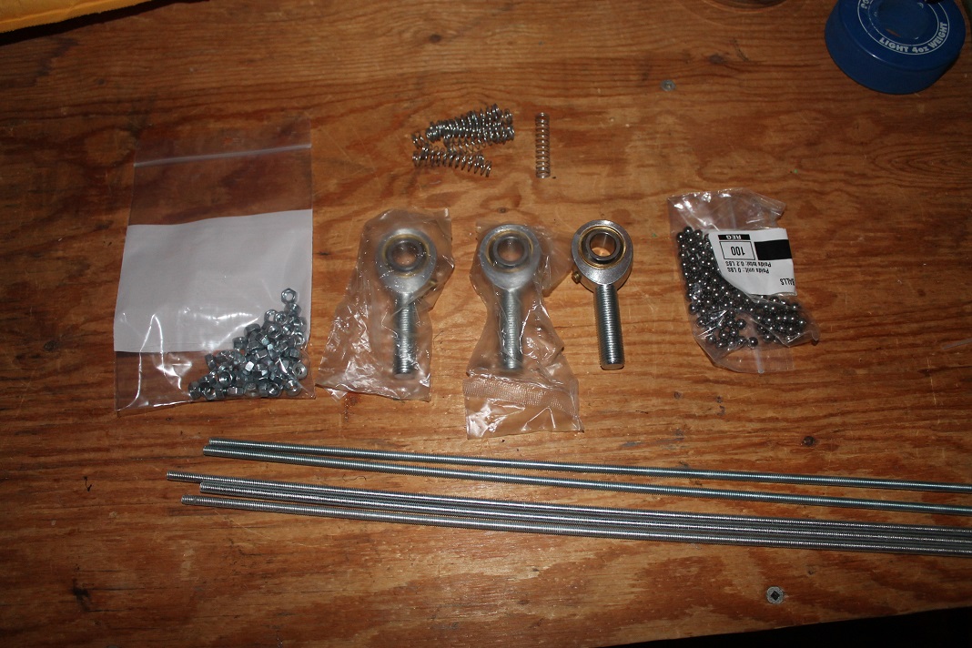

    Last week, I have redone the design of the ball screw part of the actuator and printed it. But my Solidedge desing was warning me about something, but I could not any problem. I decided to print anyway. Result: a sudden jump in the print.
    But it appended only once. I decide to break it and fix it for test. I know what went wrong and I can correct the design later.

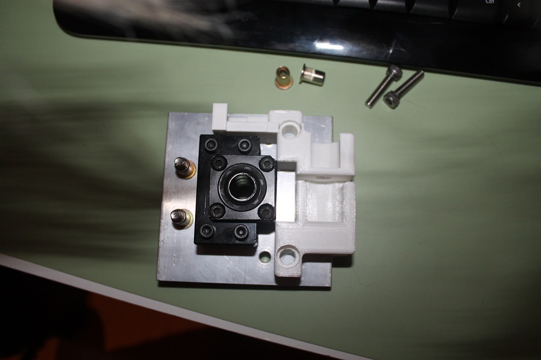

    I had bought rod and nuts, since no screw were long enough for my piece. The springs are for the limit switches and the bearing ball for a test. I also bought the 3 helm joints that I will need later... much later...
    It worked. You can see were I will use the spring with a rod to activate the limit switch. How I will use nails to attach the strap in the middle and pass it over other nails and tie everything up with tie-wraps. The v-wheel works great now against the carbon tubes. They are much stronger than the old model.
    Installed to test. Worked great, even though nothing is fixed permanently.

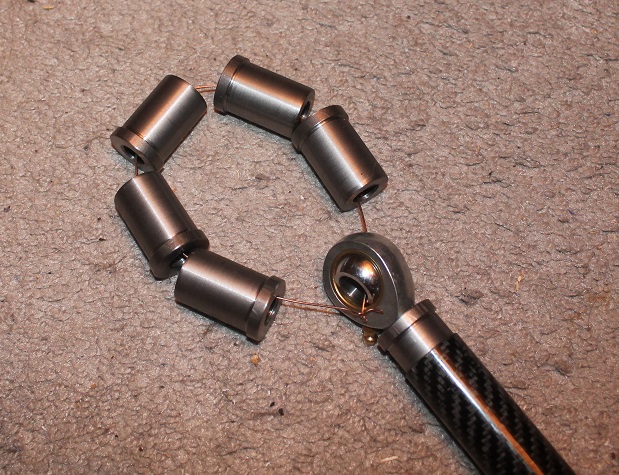

    Got 2 new carbon tube because I was not sure to do all 6 500mm actuators with only 4 1m tubes.
    What could be in those boxes?
    My 5 other Ingus bearing (ouch$$$) and a grey pla roll with a orange pla roll. Reading other thread, I would have probably tested eSun PETG. But at the same time, I had next to no trouble with my amz3d pla so far. If it's not broken, don't fix it.
