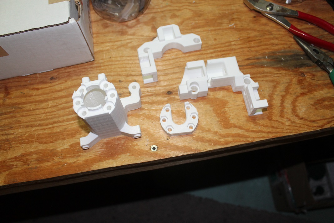

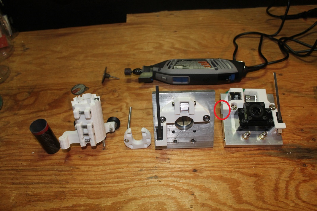

    Its been a long time since the last update.
    First, there was the vacation. A week of quad, than a weekend of boat. You see, all those thing we try to simulate are actually really fun in real life.
    I only find time to redesign and print parts of my actuator. Of course, I did a lot of mistakes and retakes.
    During that time, my printer bed connector melted down and I had to re-solder it somehow. By miracle, I succeeded. I'm trying to get a new part from Hictop before my repair breaks also.
    And I had all the parts ready to go. So I thought...
    Because I did not notice that one of my part was going beyond the boundaries and it would give me even more troubles. It was also design way to tight. More on that later.
    At least, I got myself a new Dremell tool. I looked at all the nails that I had to cut, and I did not want to do them with a simple saw. But the real boost I got from it was to how easy it was now to cut a carbon tube. Made me happy.
    Tonight, I tried to assemble my actuator. This is when hell break loose.
    - I could not open my acetone can. The child proof cap turned out to be a adult proof cap. I ended up destroying it and putting my acetone in a glass jar.
    - I use my epoxy to assemble my carbone tubes. Looked at the video on how to do it right and started. My balance did not seam precise enough. When I pushed at the end of the tube, it twisted and came out the wrong side. I made a real mess. My mix did not look right at all. I tried anyway. Putting my tubes together, I did even more of a mess, putting epoxy into the screw holes. Tried to clean it up. Did a mess. I will let it dry this week, to probably find out next week it did not stick at all.

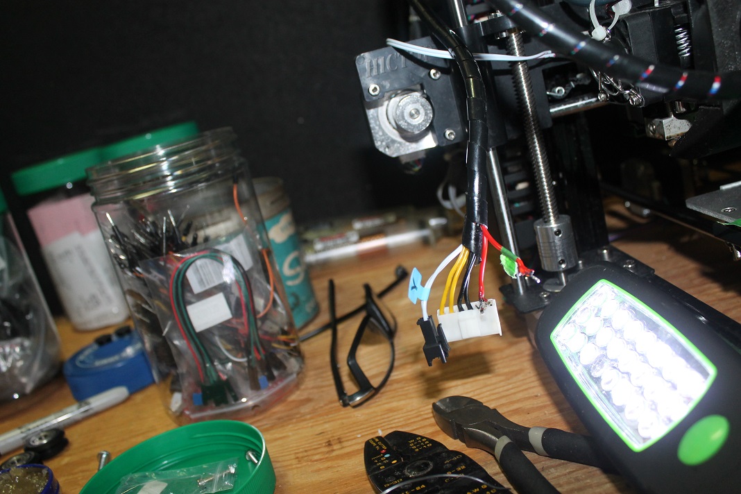

    - Not giving up, I decide to solder the pot and the limit switches temporary and assembles the parts.
    - The parts of the pot was way too tight. I couldn't make it fit on the actuator. Even after buffing it with the Dremell. Trying to make it fit, my actuator felt on the ground. Nothing broken, but such a scare. That is when the pot soldered wire gave all up.
    I try not to be superstitious, see signs everywhere telling me what to do and not to do. But this night, I gave up. Not because the Universe is telling me to stop, but because after 3 hours of nothing, I was so pissed.

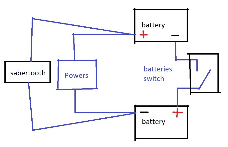

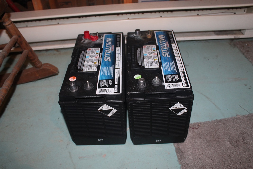

    Look what I've got yesterday.
    I have three question about those bad boys:
    1. Should I put anything under the batteries, in case of an acid spill? If so, what should I put?
    2. I have the intention of wiring the batteries as such, with the switch to remove them from the circuit if needed. Any recommendation against this way?
    3. My friend, who provided me the batteries, told me I had to bring them down regularly and charge them back to keep them alive. Like having a light connected to the batteries that I could turn on to make them work once in a while. For those who are using batteries with sabertooths, are you doing anything special to keep your battery system in good shape?
    The mess I did while gluing the actuator turn out better then expected. But that's for an other update, when the actuator will be assembled and working.
  7. SilentChill
    2,653
    20,660Coins
    +3,593 / 34 / -0
    1. That's how I have mine wired up pretty much except I only have 1 battery.
    2.My battery is just sat on the wooden base and it has never leaked any liquid yet
    3. I just let my PSU's charge the battery and its been fine now for over a year I have not done anything special with it at all
  8. SeatTime
    2,572
    +2,854 / 40 / -0
    Most quality marine or other deep cycle batteries use a substrate and no loose fluid as such, therefore it is not possible for them to leak. I use mine in conjunction with a solar array to power a portion of my house when not being used for the sim. I have a power supply available to charge them, but have never used it. Sim powered by the sun.. very green :).

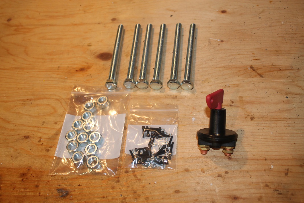

    Thanks guys, this is exactly what I was hopping to ear. Don't do anything, don't make any effort and all your problems will be solved anyway. Okay, I still need to connect it, but it is low maintenance, and that's what I like.
    Because of my bathroom, I get extra time at home. I spend some of it to get part that I cannot get on weekend. I have means to attach the actuator to any structure, some m3 screws for the limit switches and a kill switch rated at 300Amps. I took some big nuts, but that's not what I want.

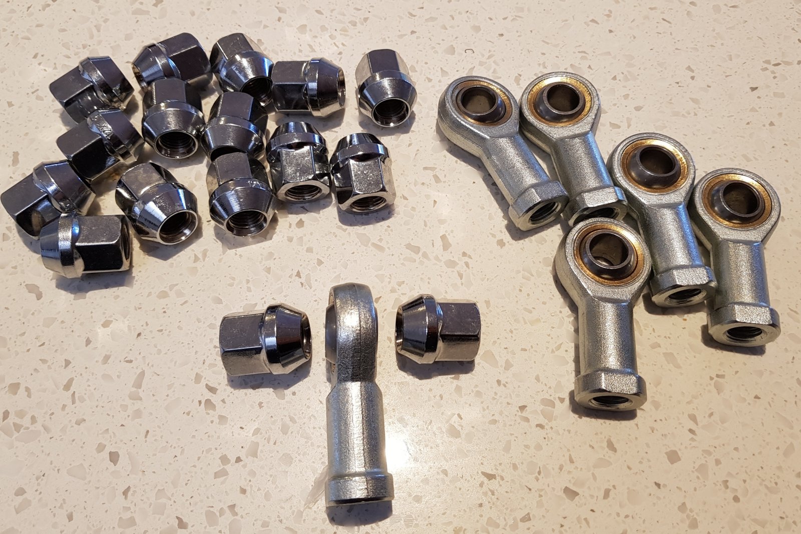

    This is what I want! I found that picture in the thread of @SixDegreesOfFlight . How do you call those nuts and how can I get them? My trusted nuts and screws store had no idea what I was talking about.

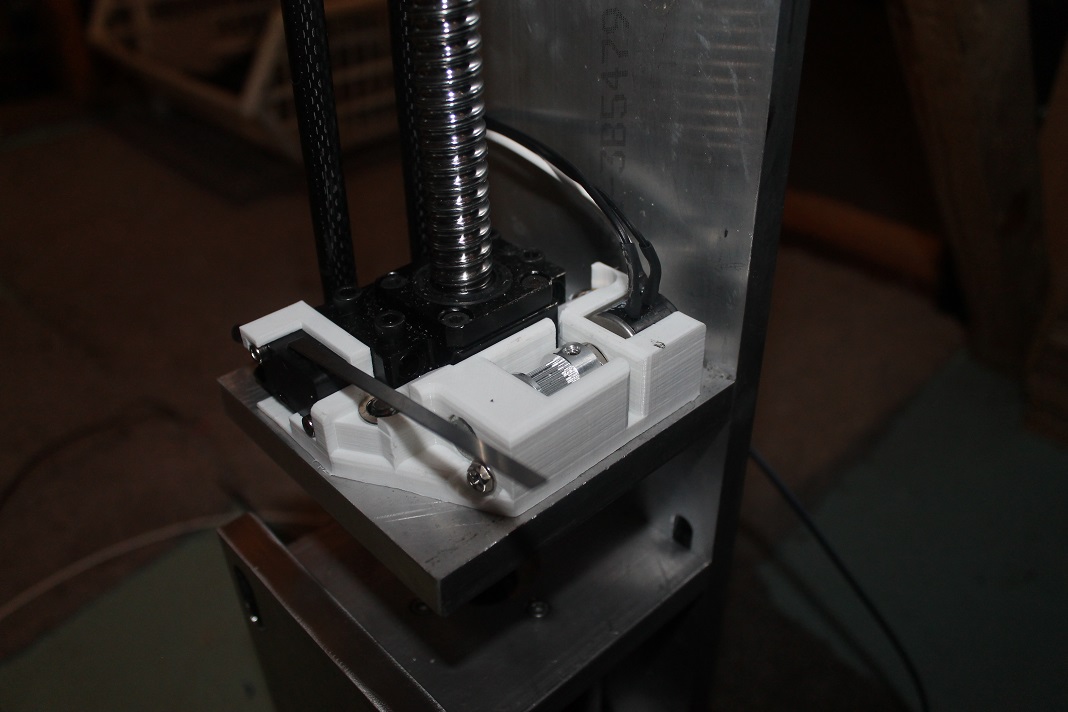

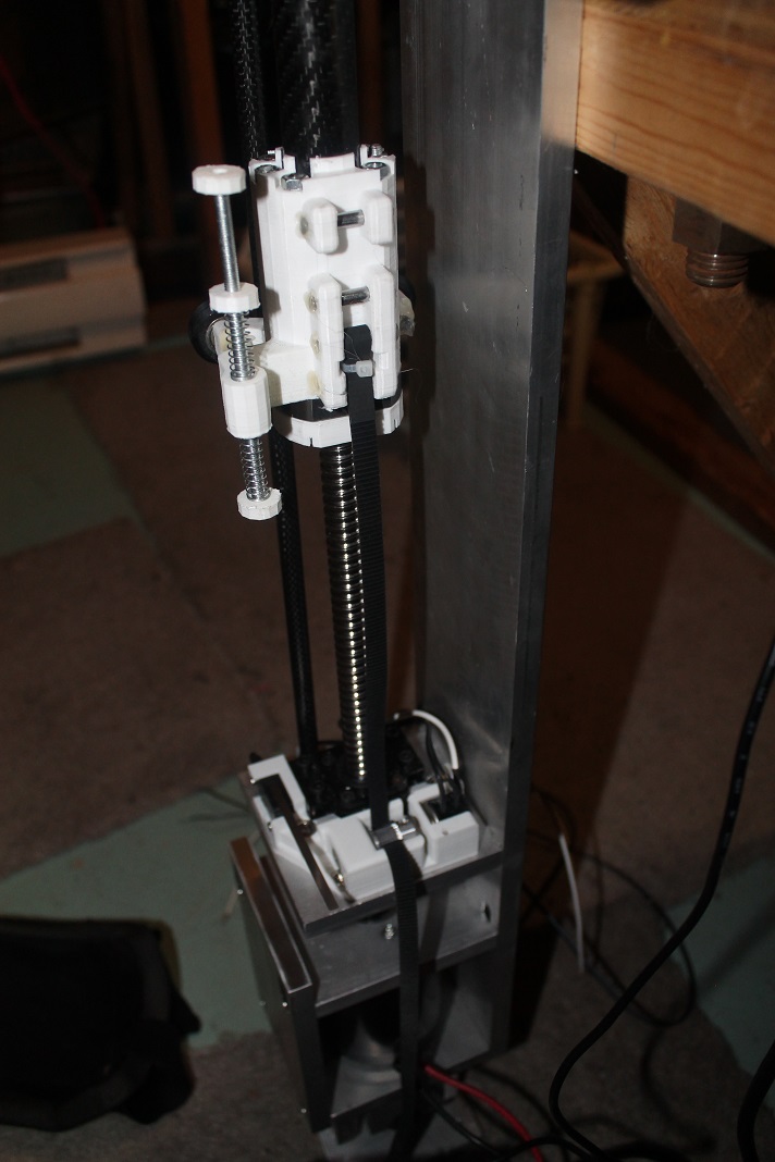

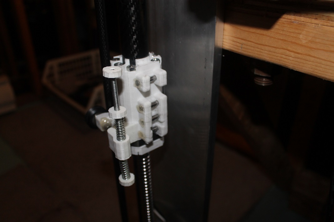

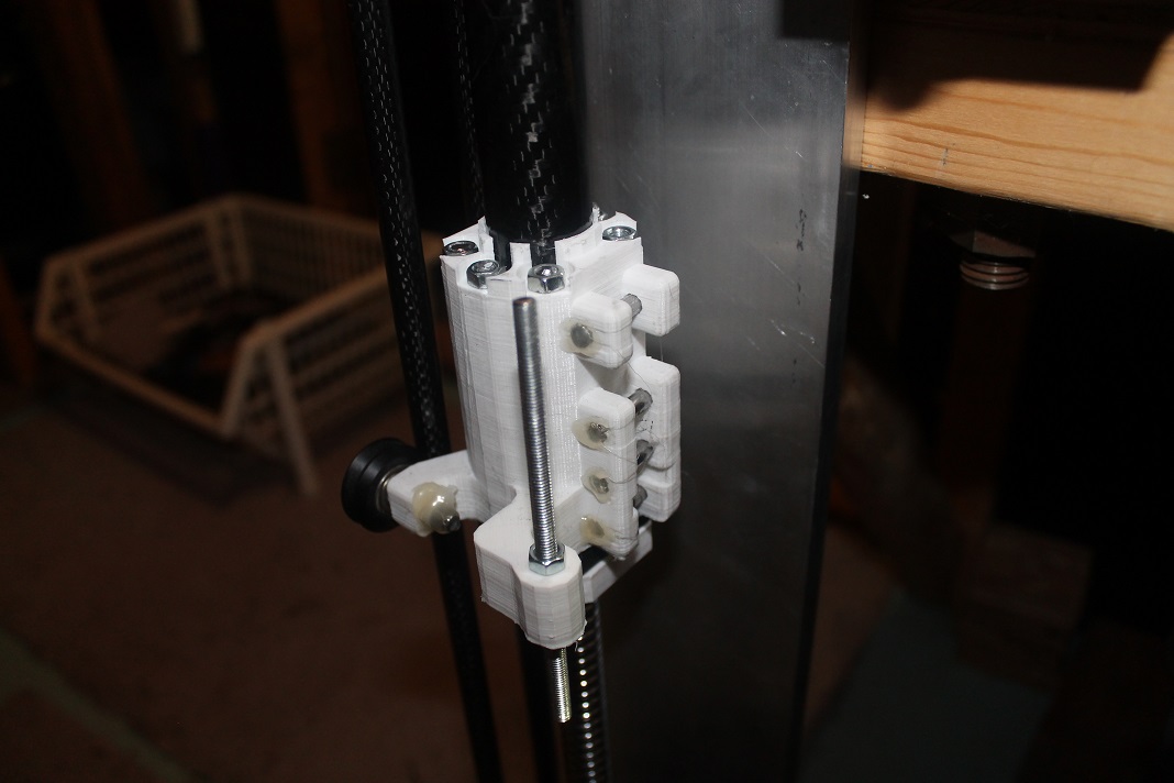

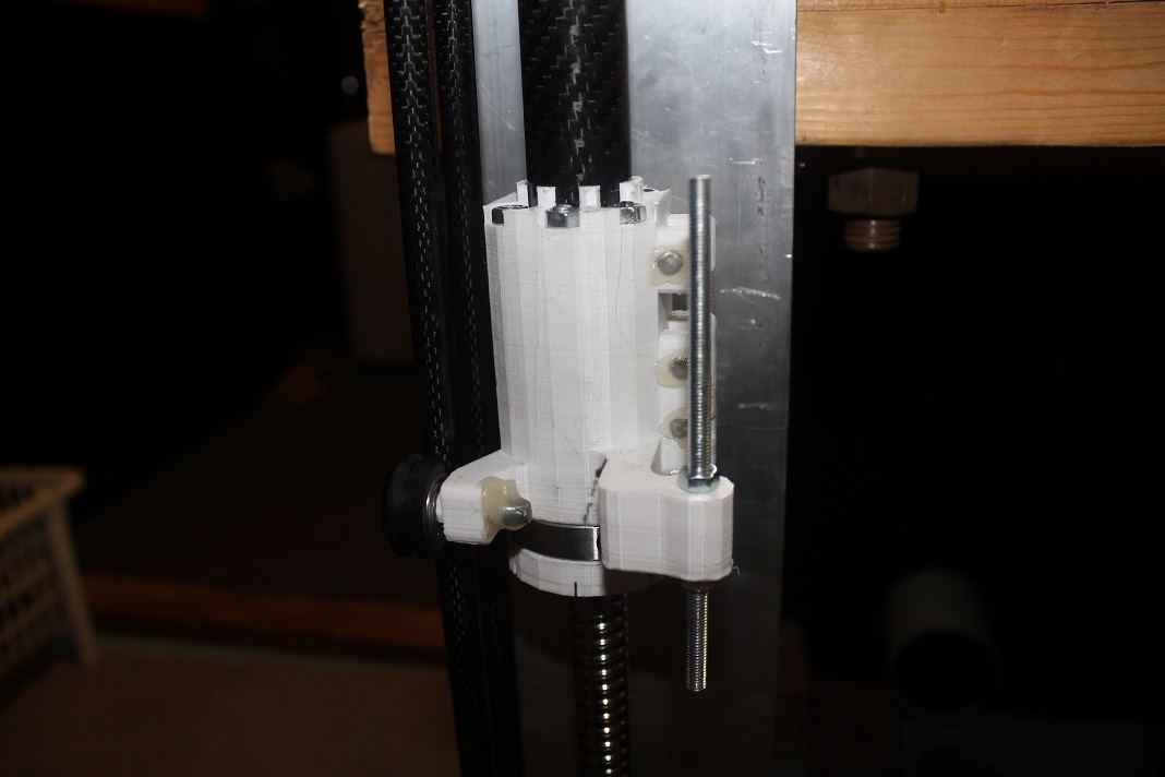

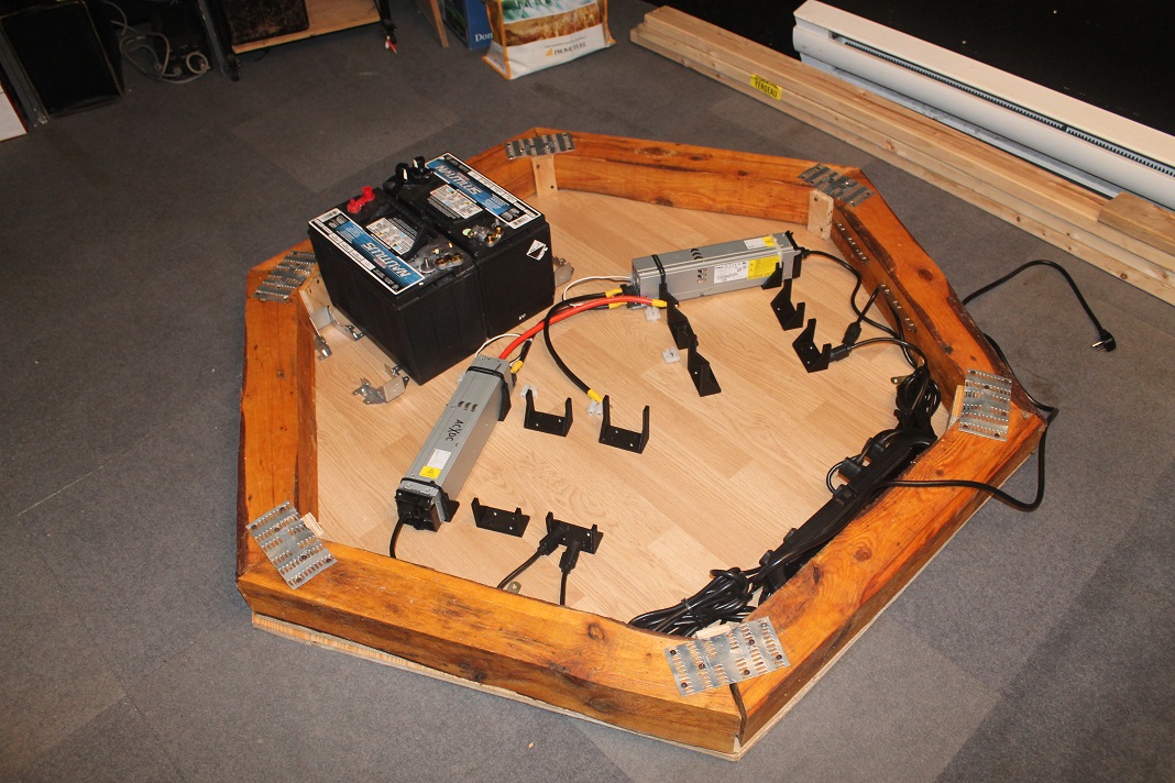

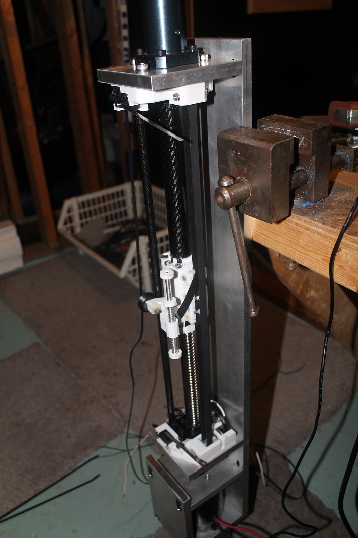

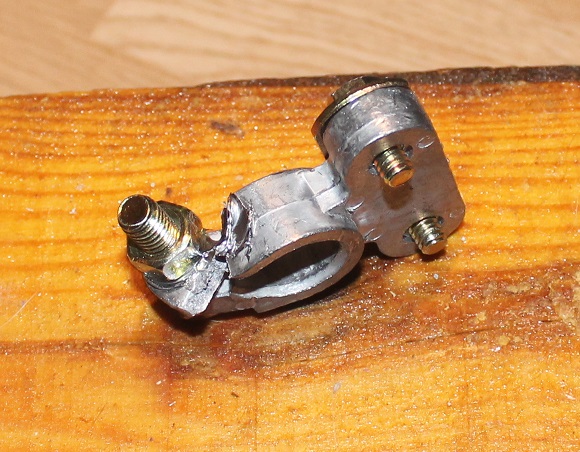

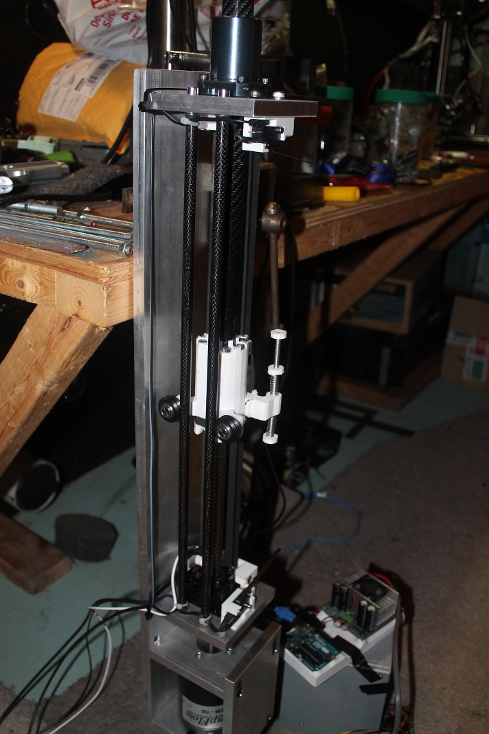

    Today, I worked on the power supply.
    I bought connectors for the battery pole, and I broke one. It did not seems to fit well on the battery's pole and I screw it really hard. Turned out that those thing are really soft. It is better to use a hammer and hammer a perfect fit out of them. Fortunately, I only needed 2 even I bought 4 of these. I hammered an other one on the smaller negative pole, and if worked fine.

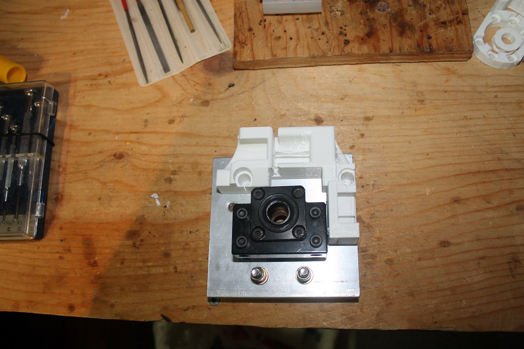

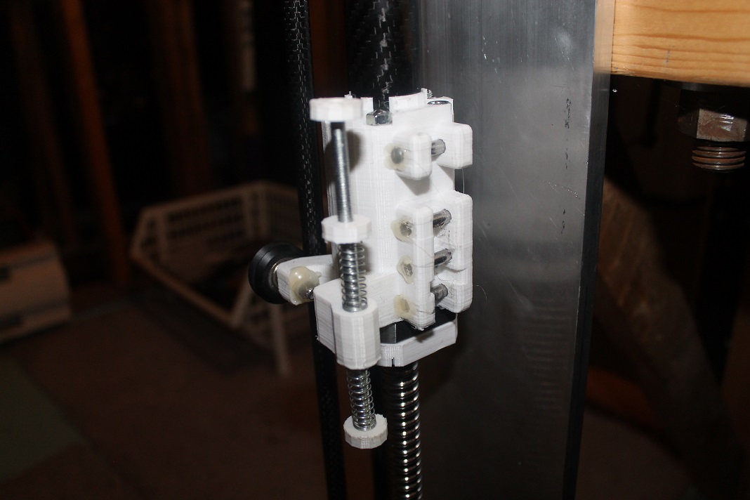

    I only had time to fit one set of psu with the battery. All worked fine. I wanted to put the batteries in the middle, but they are so big, they may interfere with the actuator near them. I will probably move them on the side like in this picture.
    The actuator are coming along too. The epoxy I did turned out working pretty fine and I had a glued actuator shaft. The carbon tubes were not at the right place and it did not fit all the way. I was about to give it up when I thought at my new Dremmel tool. With it, I could buff away the blocking parts in a cloud of carbon dust. Probably really unhealthy . Anyway, it worked! The new potentiometer holder part now fits easily.
    Now I need to set up the limit switches with my relays. Should be a lot of fun. And I am still looking for the name of those v-shaped nuts!
  11. SeatTime
    2,572
    +2,854 / 40 / -0
    Just for everyone's info, the positive/negative posts on those batteries are normally a different size and you need to purchase a 'set' to suit. Also - IMO always wear the proper PPE - overalls, gloves, respirator and have a vacuum cleaner handy when sanding/filing/cutting carbon fibre. + don't hammer stuff onto these batteries ...

    Try wheel nuts at an automotive spare parts store or wreckers, alternately you can also use nyloc nuts as they usually have a chanfer on them.

    Listen to the advises of @SeatTime ! Do as I say and not as I do! Seriously, be safe.
    Thanks @OZHEAT , "wheel nuts" seems to be the right name. I am now looking for those.
  14. BlazinH
    BlazinH Well-Known Member
    Oct 19, 2013
    2,145
    Oklahoma City, USA
    16,703Coins
    +1,840 / 32 / -1
    They are also refered to as lug nuts in the usa.
