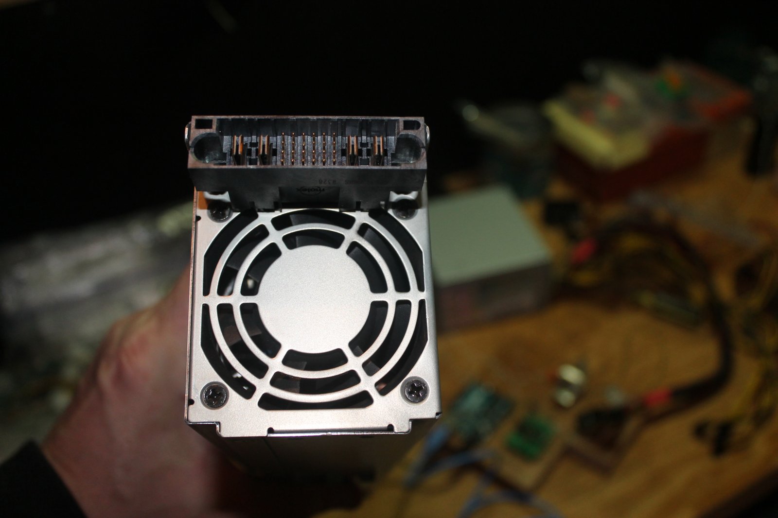

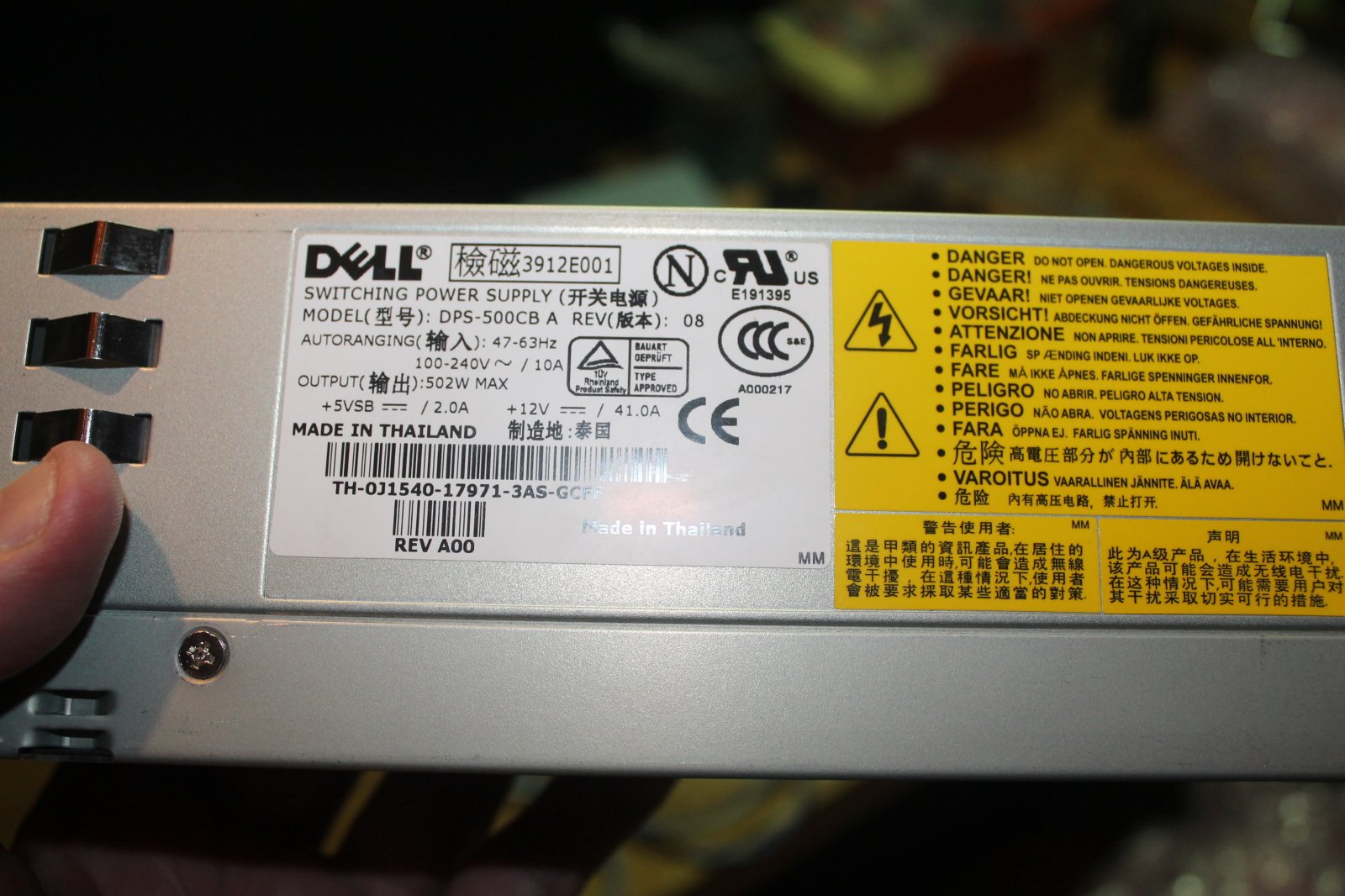

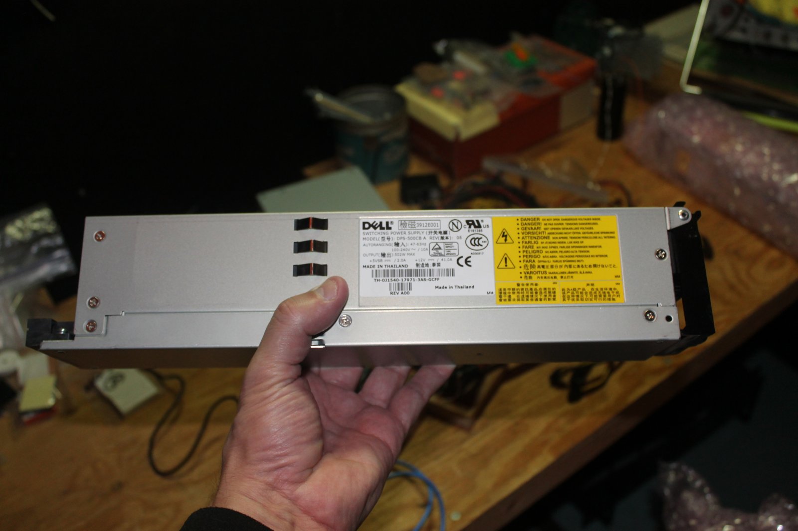

    It is Christmas again! It`s been a long time.
    I received my Dell 2650. I am surprise how small those things are.
    502 W max. Choose your language for the warning.
    Oh! Great! How am I suppose to connect to those?

    Those dont appear to be dell 2650 as shown below. but rather dps 500cba Or another version of the dsp-600pb's...just a little less power.
    If you want it "switched" add a switch between the 3 turn on Pins. You'll also want to do the fan trick to quite down the fan.

    Pin out for your PSU's
    The pins in the center are 6 across, and 4 down. we will start at the top left and go down, A, B,C,D, and go across 1,2,3,4,5.6
    Short A5 to B5
    and
    C4 to D4
    You will hear a rely kick, and the fans start, then have ~ 12.4 vdc between the pin heavy clips on the left, and the other two on the far right of the connector.

    This is what is says on my order:
    Dell Poweredge 2650 Server 502W Redundant Power Supply DDS-500CB TH-00H694/J1540
    Oh, well. As long as they work. Thanks for all the wiring advices. They are my references now. I had seen a picture from wannabeflyer2 using similar devices in series to get 24V, so I figured out it could be used as such. But, I'm glad to have a confirmation.

    Interesting. I was doing my research at the same time and find this video that gives different pinout. But, I am pretty sure there is more than one way to start those things:
    It says to connect all together A6, B5 and C4
    I will probably test both, to see if I can start a fire.

    I tested my power supplies. At first, they didn`t work at all with the wiring I was told. Until I found out I was holding them upside down. They worked fine after that.
