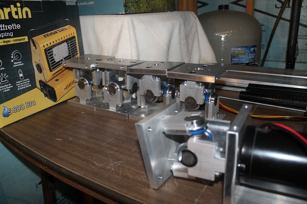

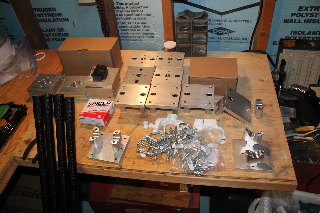

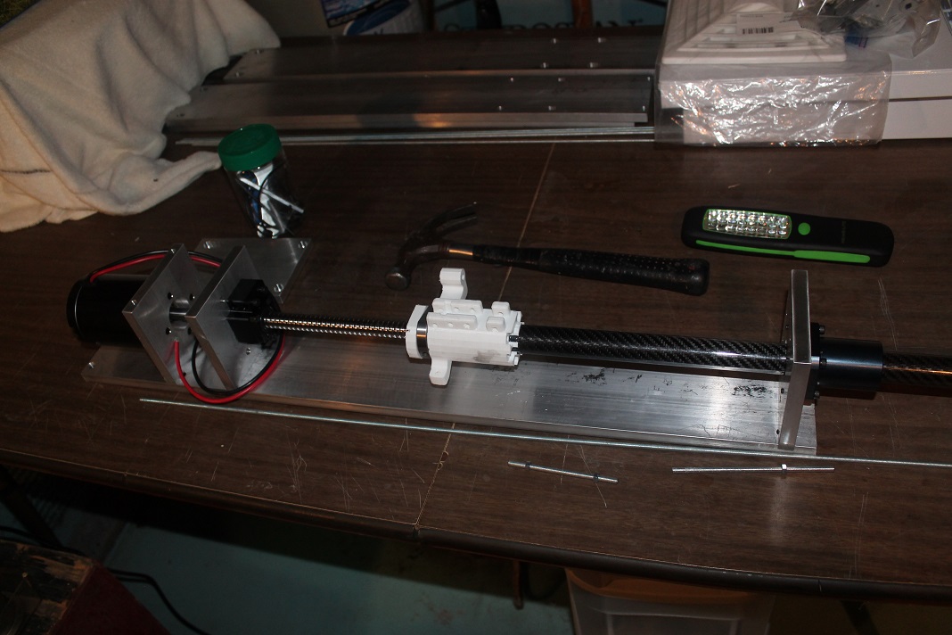

    And for the actuators, the production pipeline has started.
    Those are my giant legos.

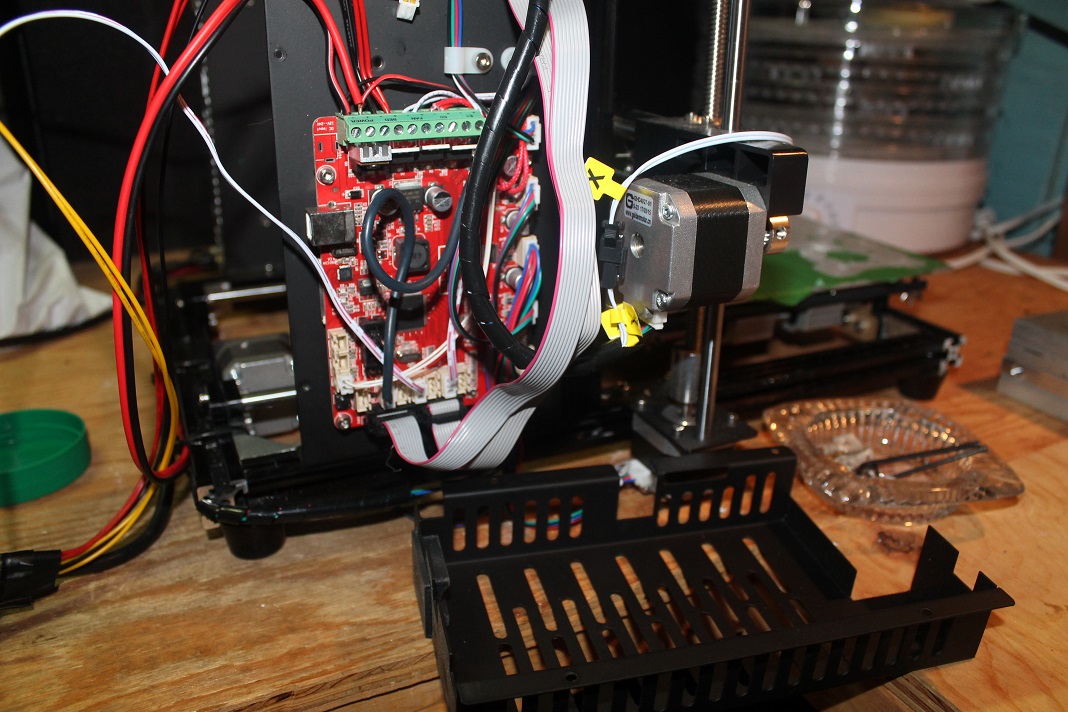

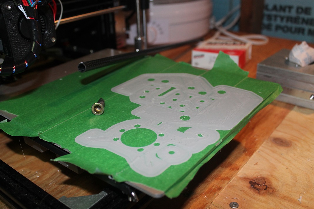

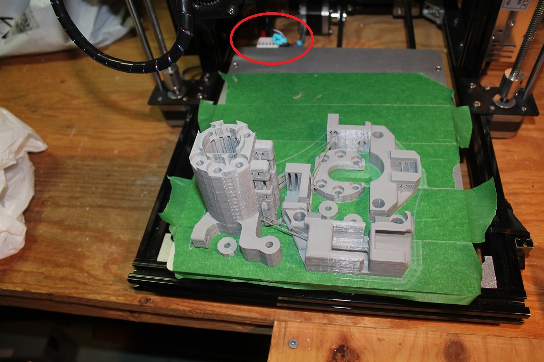

    This is where I tried to print a third actuator pieces assemble all at once, and my printer cable failed on me. Also, I put to much epoxy in one of the carbon tube, and I had to pull out the insert that was totally blocked. Luckily, with a little brutal force, it came out without destroying my tube.
    Also, I had my printer replacement cables. Word of advice, experience, whatever... You better like to get your hands dirty if you want to go into 3d printing. This is still the far west, like internet in the 90.
    Et voila! Working like new! The gauge of those wire were way bigger on the new ones. It will endure a lot more stress and current. I never did a print with so much used space and for a full 24h. All went beautifully, and my fourth one is about to finish as I write.
    Then, the rest is a matter of repetition. I'm still missing my corrected parts that went back to the mechanical shop. Just a week transformed to a month.

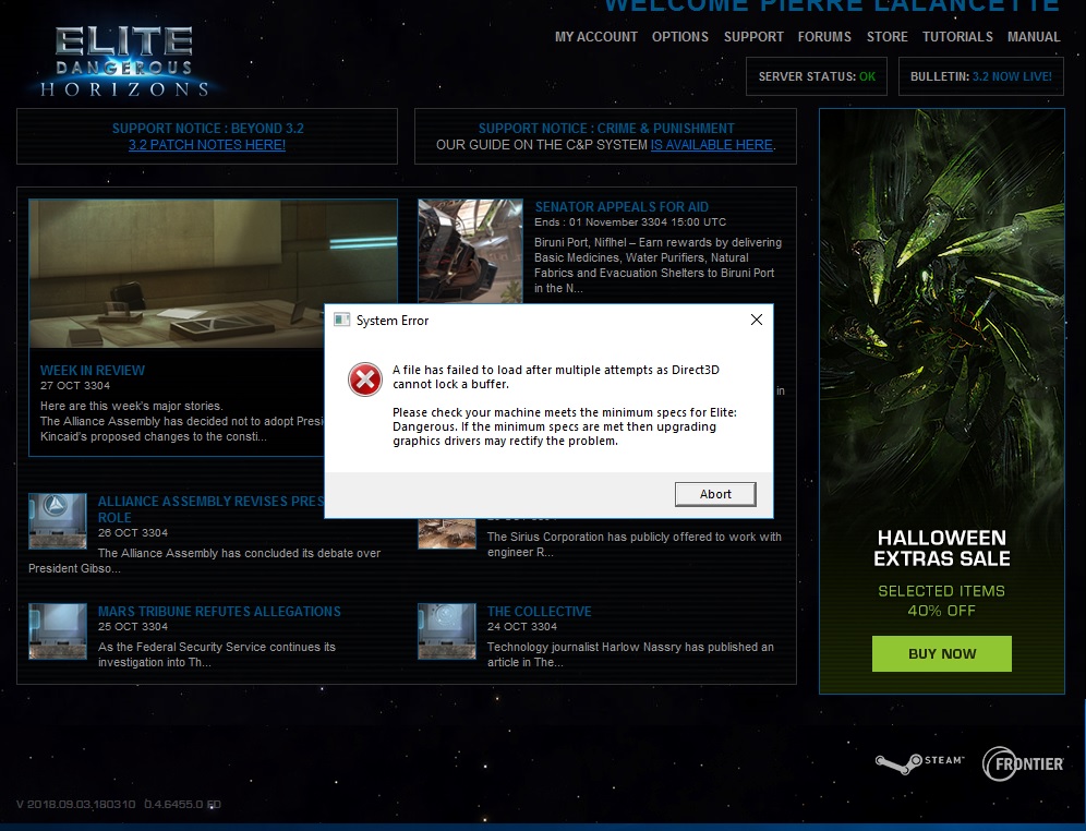

    Okay, since I hear that the no where to find RTX2080ti is not providing the expected result, I settle down for a GTX1080ti that was available. That was my reason to buy this brand, this one, is was at the reach of my hand and it was the last one. In the picture, the cat is there for size references.
    When it got installed, the first VR game that I wanted to try was Elite Dangerous. I have not played it for months since I spend all my free time on my build (and Netflix). What did I get when I started it?
    Great! It turned out that Elite Dangerous has some problem with high end cards. I've tested many things so far that people were saying in forums, but nothing worked. People says they are crashing during the game. I've never been able to start it with the GTX1080ti. My other games run just fine. I'm discussing with Frontier about it, but it does not look good so far.

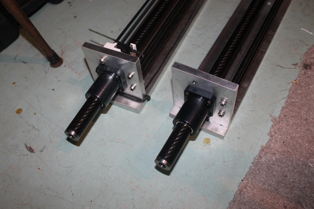

    And I got my parts back!

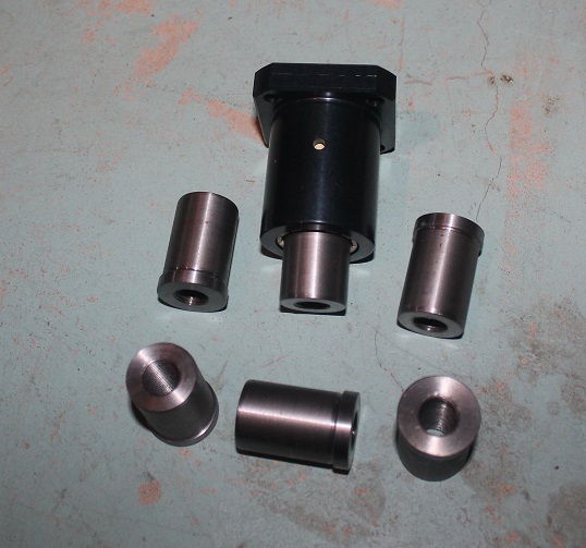

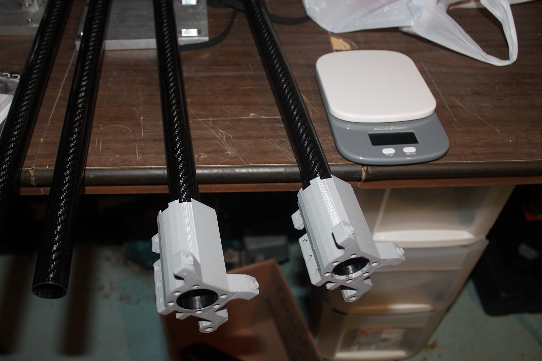

    I cut my tube at 60mm out of the bushing (The NEW Standard!) and I stuck them with epoxy. Now we wait for them to be dry.
    Again, I did a mess with the glue. My balance is not precise enough for that type of work. I really need a better system. I stuck the 2 other printed parts that were ready, and stuck my 4 other parts at the other end. Only to remember that those tube were not cut the right length yet. I hurried up to take them of and remove all the expensive epoxy I used to trow it in the basket. So stupid.

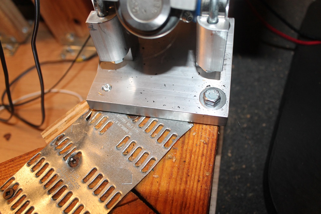

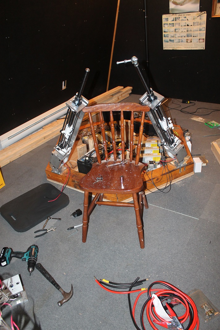

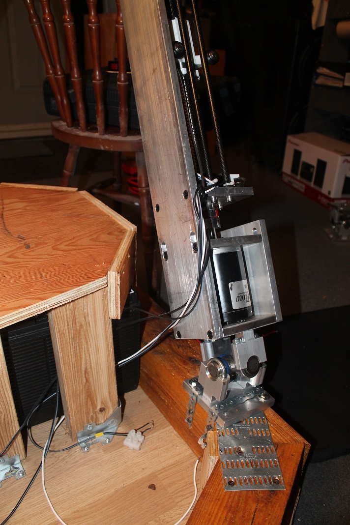

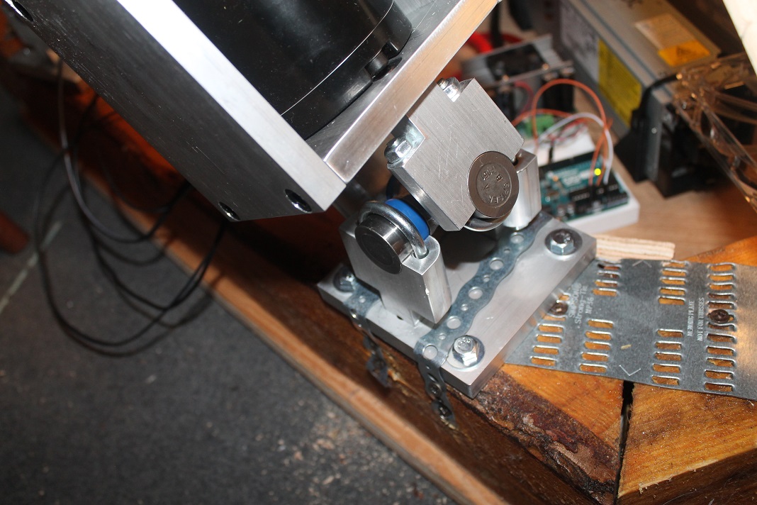

    Some gotcha that I got. I have my second actuator and I could not make it work with the SMC3 tool. The tool was hanging and I had to kill it. After a while, I think I found that I had to use specific USB on my laptop so they are fast enough to drive the actuator. After that, I had no more problem.

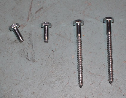

    Fixing my actuator, I tried to force the screw into the wood. Bad Idea, 2 of them broke into the wood. I had to move everything aside a bit.
    I drilled the holes properly and fix the screw. Since they were a bit on the side, I added some support. I don't know if it helps, but it shouldn't hurt. That's when the screw under the motor got loose. Fortunately, I could unscrew those on the side, turn the bottom a bit and do the fix. I remember now why I don't really like mechanics.

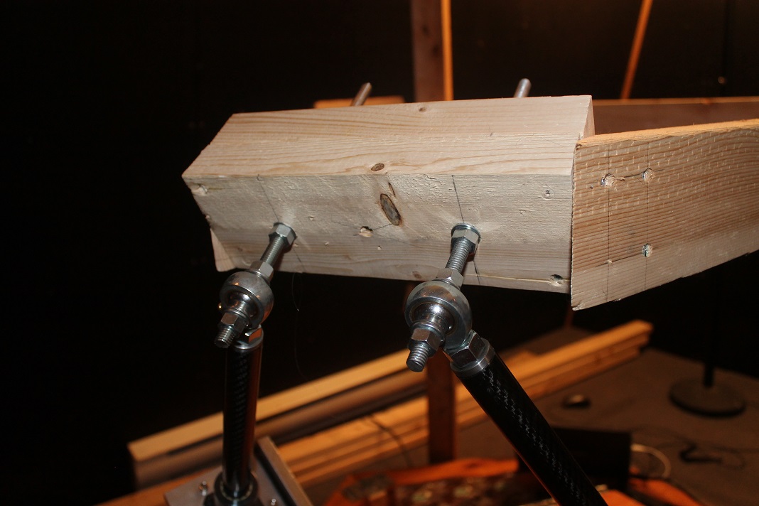

    I was trying to figure out how to attach the actuator to the platform. Not easy to do on your own. I wonder how you people can do it so rapidly. I still need to attach the other actuator, bu my drill just passed out, after almost 25 years of loyal services.
    I think my platform is too big right now. Will have to rework it a bit.

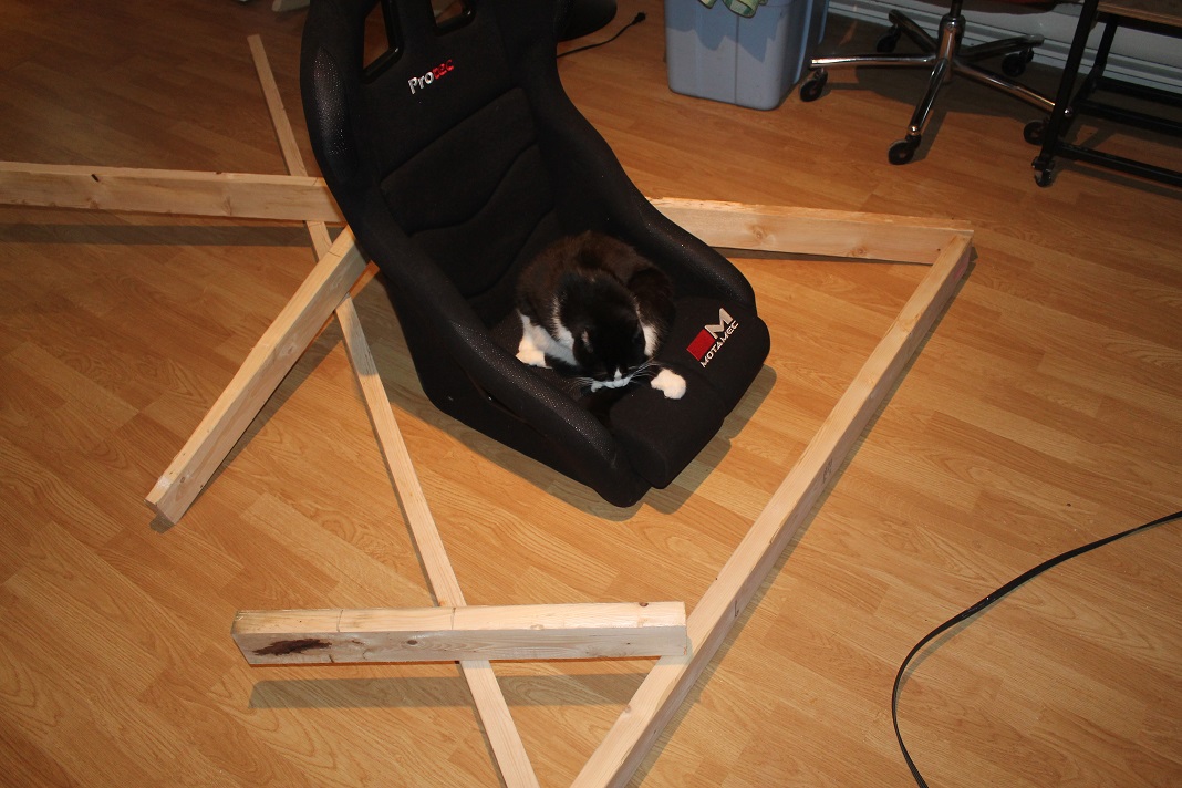

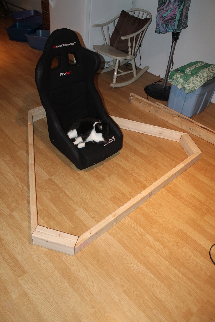

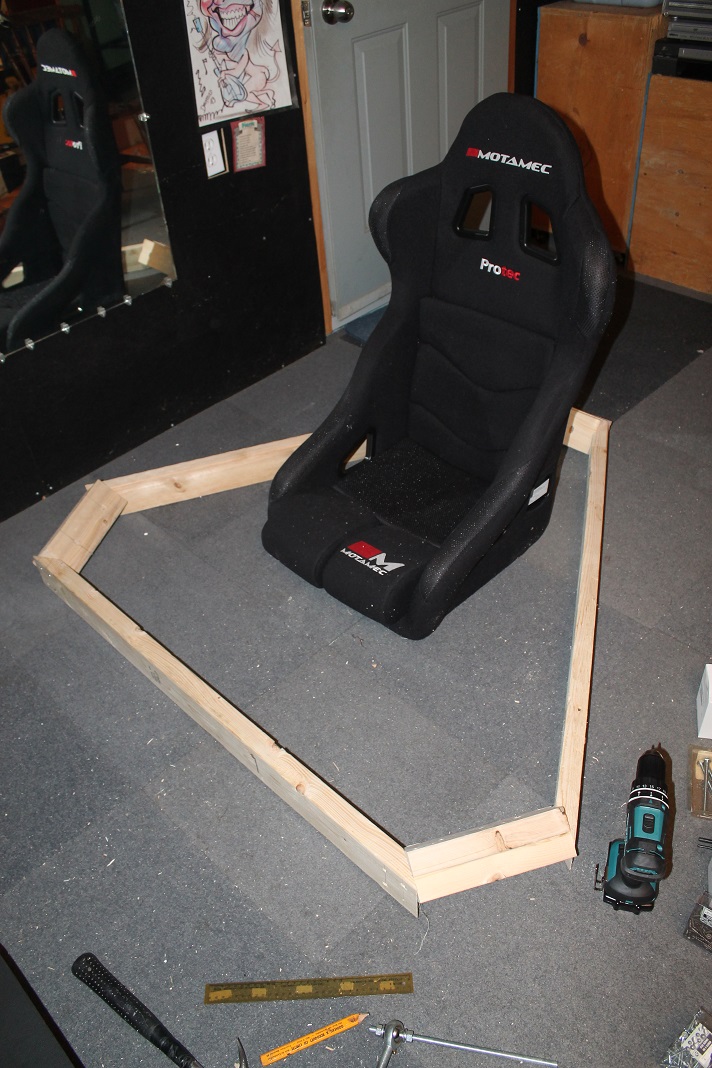

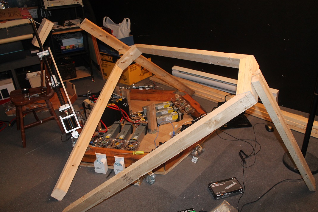

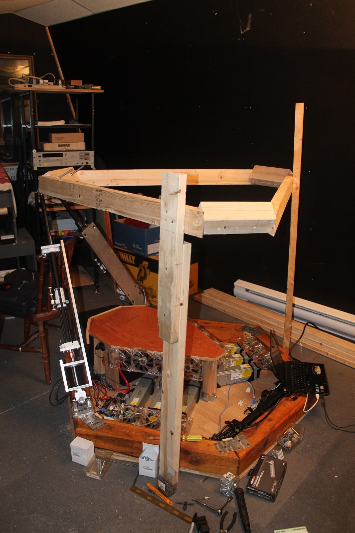

    Those who are following my posts should know by now that I don't really want to build a 6 dof. It is only an excuse to buy fancy new tools and brag about it. So, when my Makita drill die after ONLY 25 YEARS of bashing and severe treatments (They don't make tools like they used to), it was time to get myself a replacement.
    Now, assembling pieces of woods together is a breeze. I made the platform significantly smaller. I now need to figure out how to attache the seat to it. But, I'm not there yet.
    The anchor system for my actuator is no good. I broke another screw. Probably because it got stuck in the metal part, and one is loose because it is too close from the side of the wood beam. I need to add more holes. Time to see if I can drill those aluminium bases. For now, I'll just add some reinforcements and it will do. I just want to work out some placements and measures.

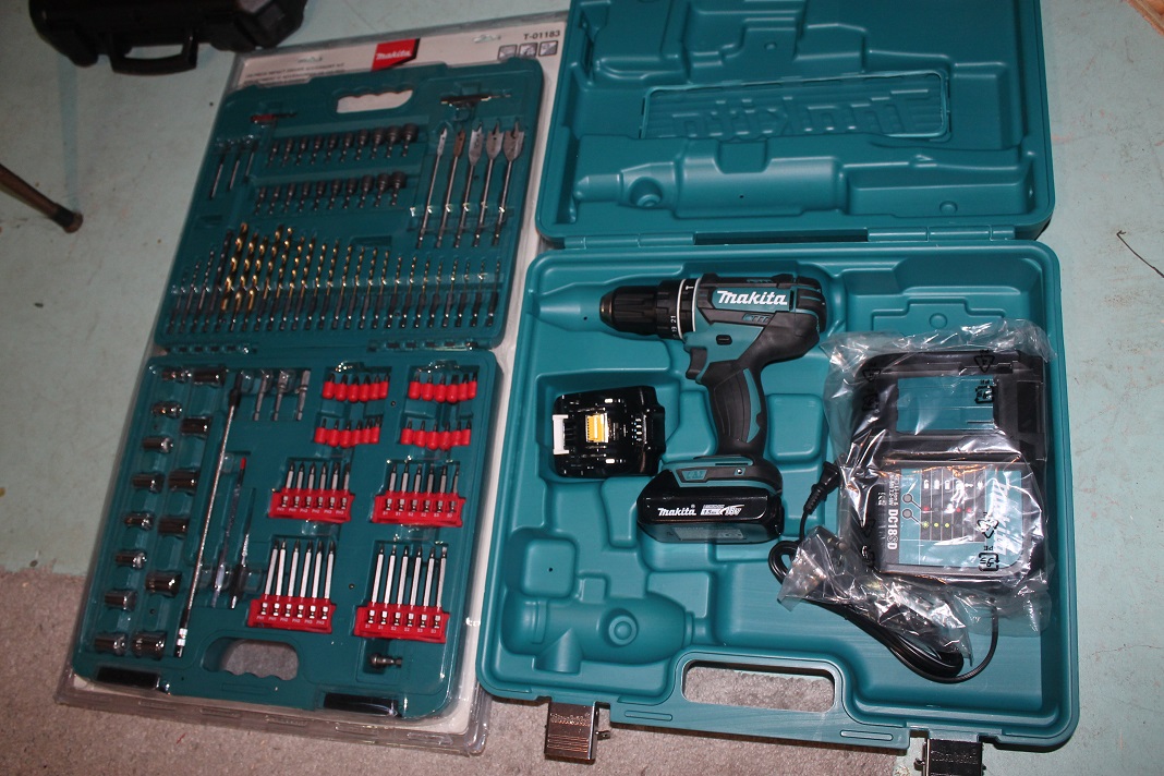

    With my chair in use, I can no longer site on my ass all day and do nothing.
    Now, what tool could I buy?
    • Funny Funny x 2

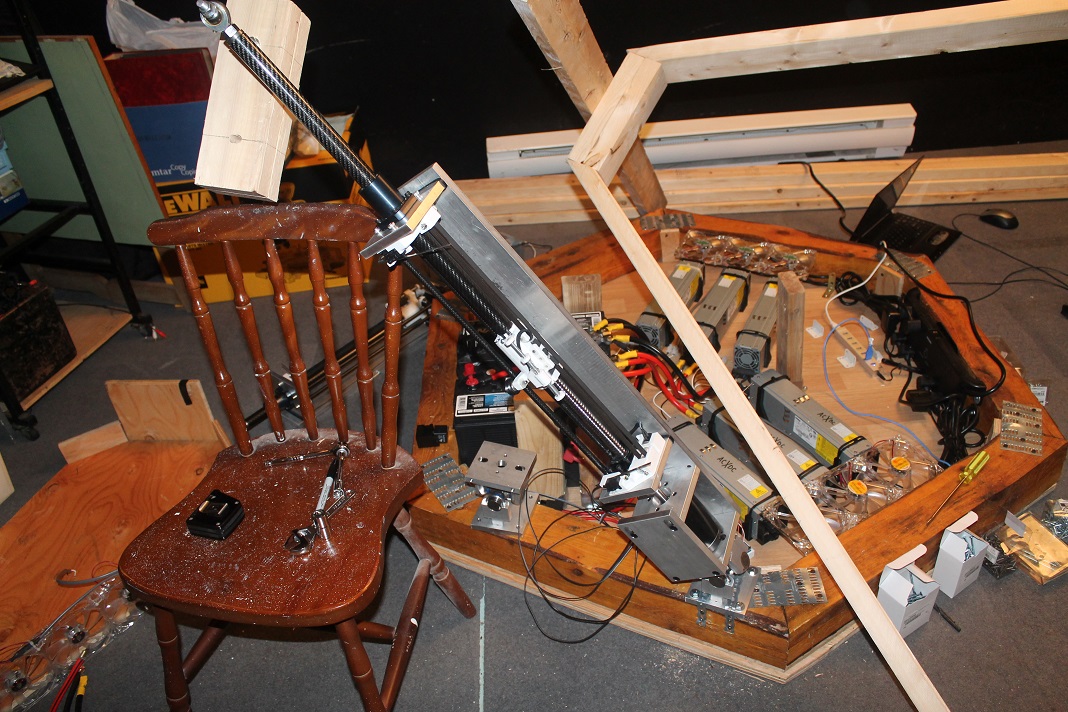

    Thanks. Yes, keeping a good attitude and not taking everything too seriously helps a lot. Otherwise, those projects can drain a lot of things: Time, energy and money. The important is to keep them fun.

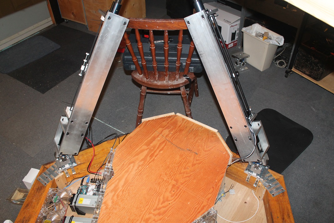

    Back to the project, this is what is will look like at about the middle of the actuator. At about 44 inchs (112 cm) from the ground. The platform can hold by itself, but I leave the chair for safety.
    The clearance for the batteries looks okay. There is still possibility to give it even more space, but I'll go with this for now.
    The inclination looks good. About 40 to 45 degrees.
    From the inside. This is the first time I get the feeling: Man, I can actually pull this off!

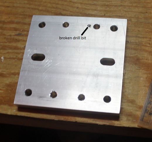

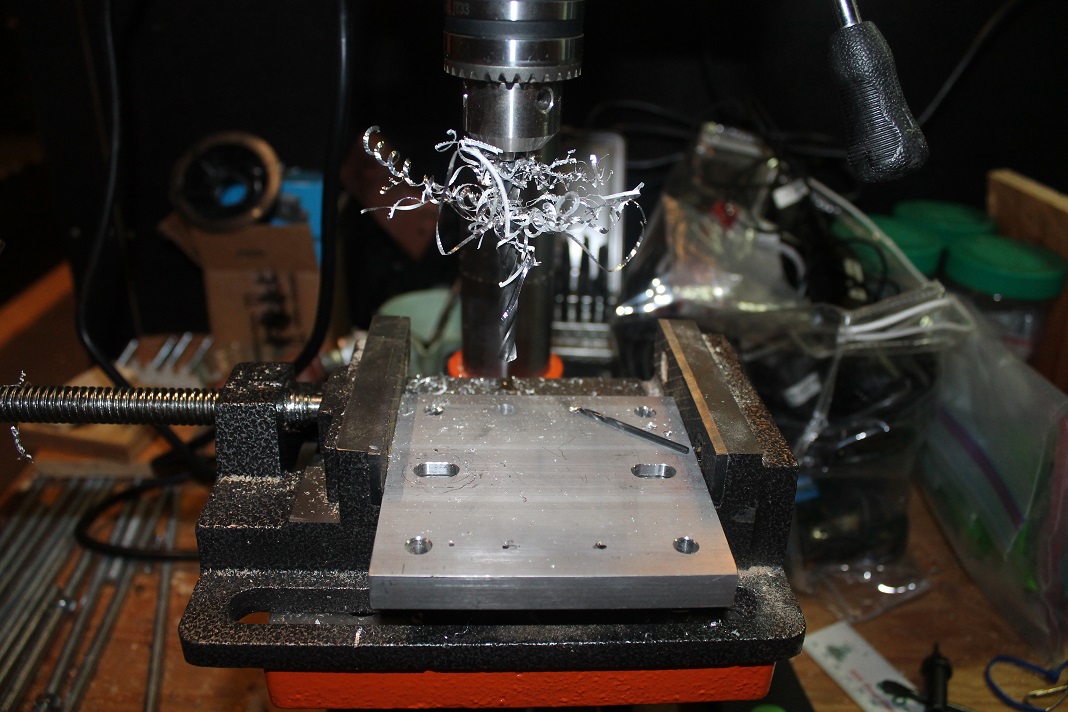

    I tried to drill a little guide hole in the aluminium and I broke the bit inside. So, screw it and I went for the full size hole. It turn out my drill can handle aluminium with ease (shameless brag).
    I should have no more problem with the fixation of the actuators. And I started to put lock tight on the screws at the assembly.

    You really do not need those massive coach screws holding your actuators down. I have 1 inch screws holding mine down
  19. Pierre Lalancette
    Dec 11, 2016
    1,012
    Tech Artist
    Quebec, Canada
    8,052Coins
    +947 / 6 / -0
    3DOF, DC motor, Arduino, 6DOF
    Hum... This is intriguing. It is true that most of the force is going down. I could shorten my screws.
    Damn, I just bought 24 of those. Straight to the miscellaneous pile,. And I'll need to buy others. Oh well.
