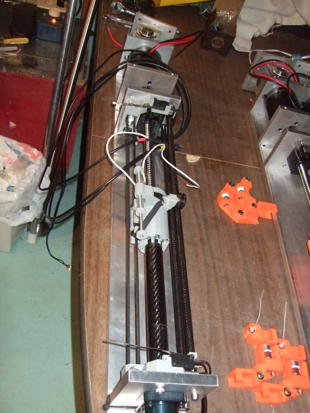

    I have a third actuator up and running. Because of the noise, if I test it with motion, it gets too close of the limits and the noise trigger the reverse motor. Thanks to my limit switches, it ended at the other end of the actuator. But if I keep it a square input signal, the actuator runs just fine, as the noise do not reach the limits. But the centre idle is quite jerky.

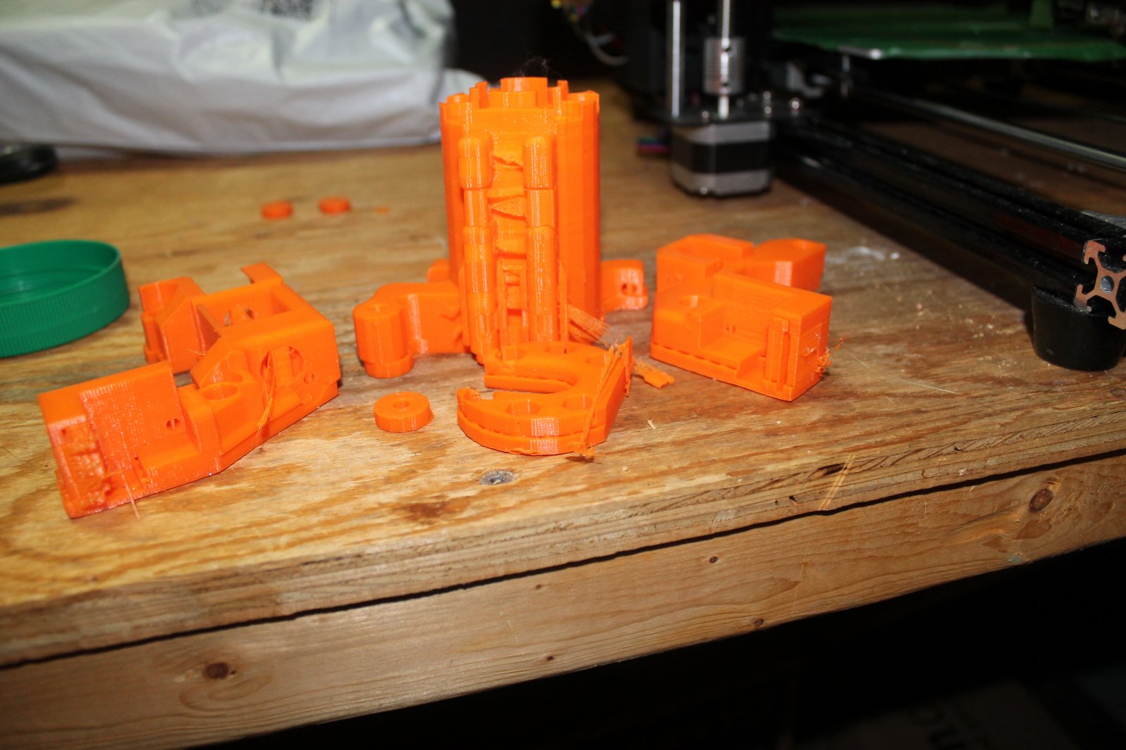

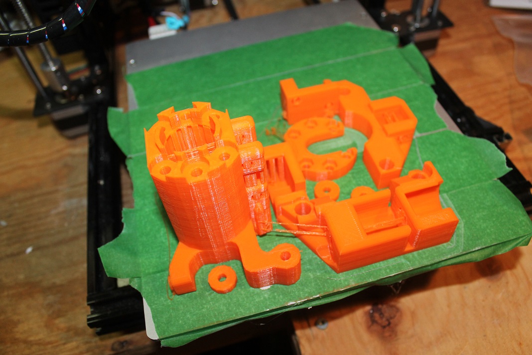

    I have prints others set of parts. One is just fine, the other add a skew right at the beginning. They went straight to recuperation. I printed them all back, but this time, one by one.

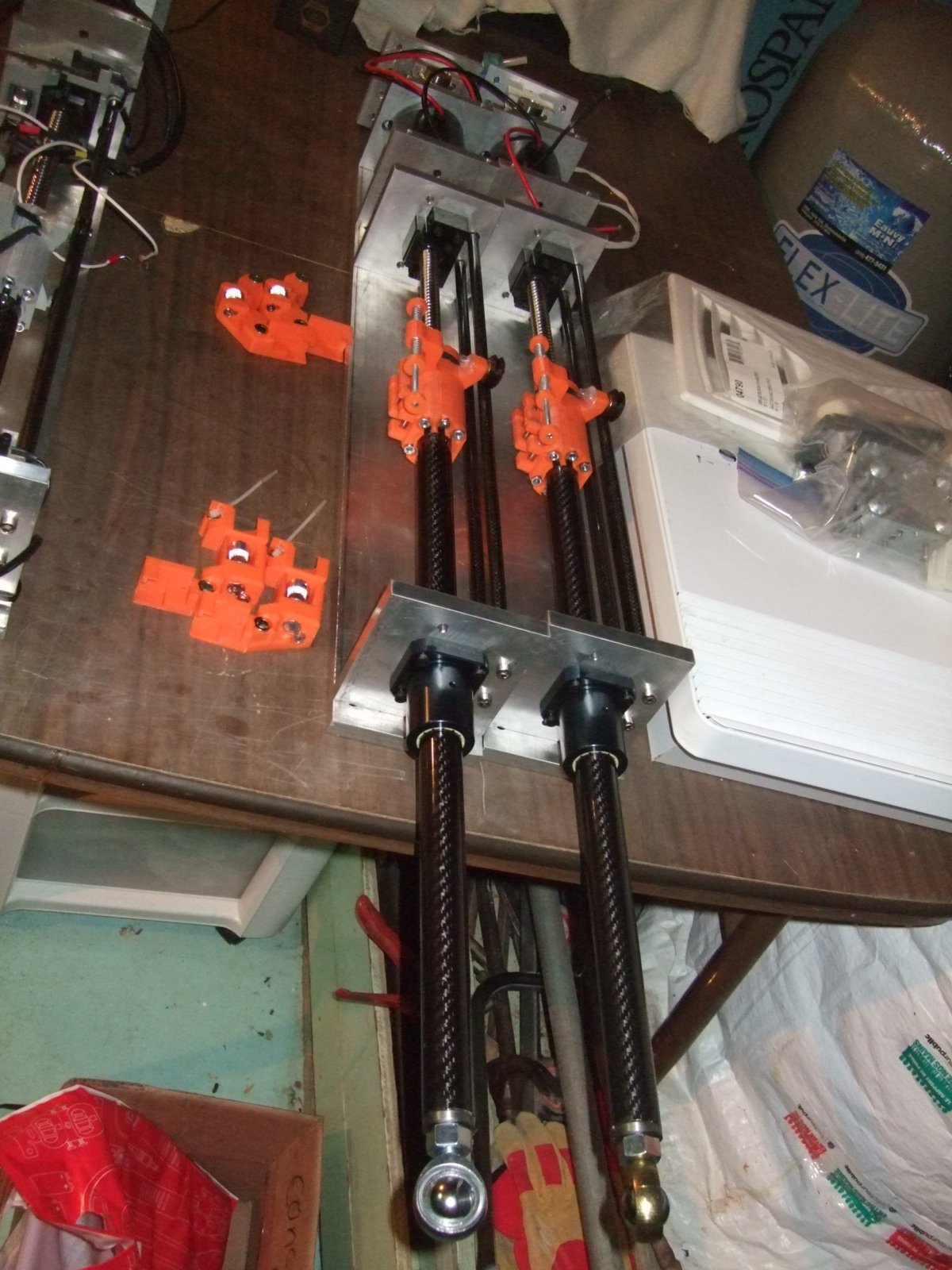

    The three other actuators are in production. I have stick all the remaining parts. I should not have to touch at epoxy glue for this rig anymore, and I did not make a mess! I'm a big boy now!

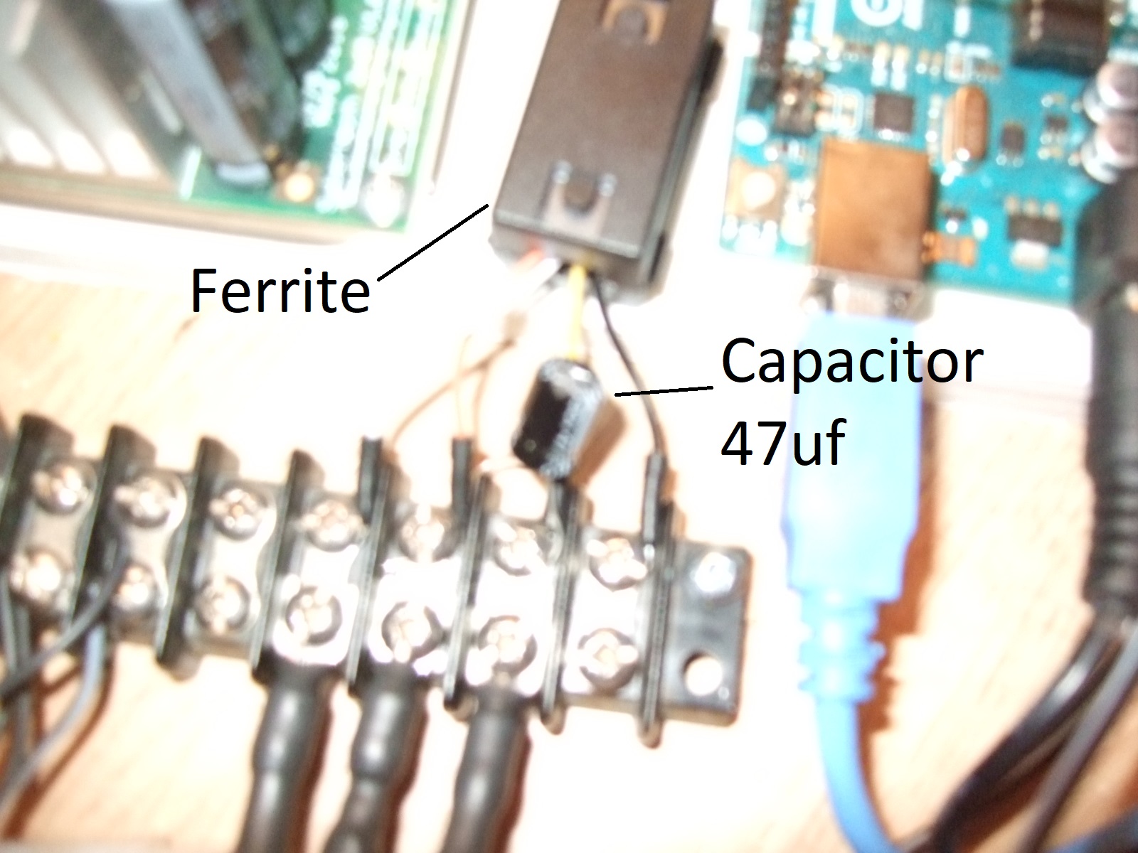

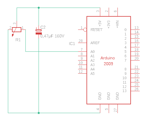

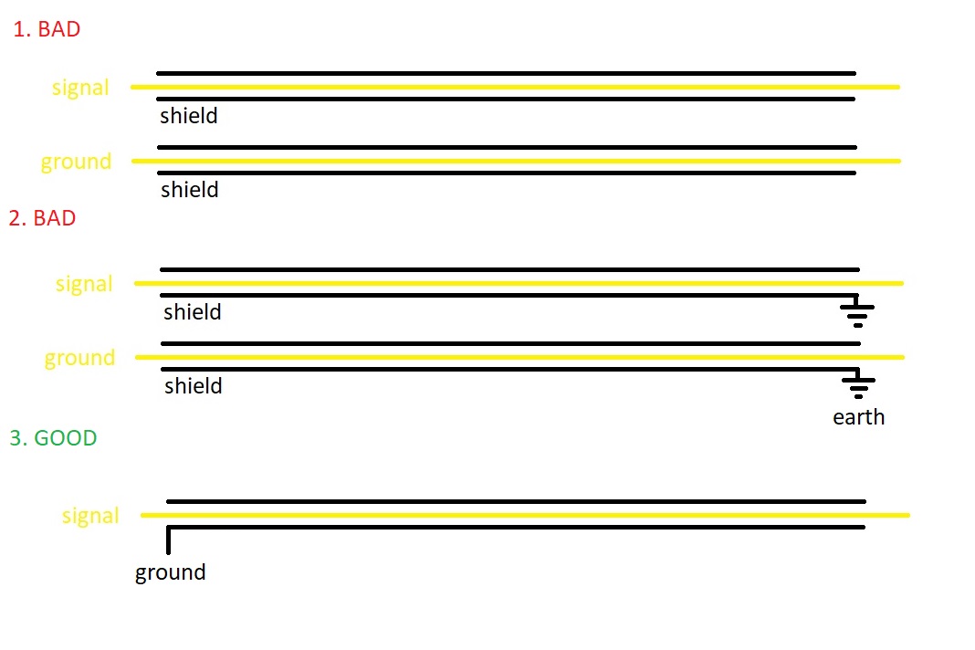

    Hello everyone.
    Like in @Vitalius thread, I had a problem of noise with my potentiometer's signal. The wires were getting long, they were passing through high voltage wires and my signal was picking up noise to the point it was triggering my limit setting if it got too close. So, like him, I got myself coaxial cables to shield my signal. But what is the better way to setup the wires? I tried 3 methods: No shield attached, shield to the earth, shield to the ground.
    The best way is the simplest, of course, but I had to spend hours just to try the others, just to know (I should have search the internet instead). The 2 others were acting like noise antenna. It was terrible.
    Only when I put every shields to the ground that I finally got a stable signal.
    I also add ferrites and a 47uf capacitor. I cannot say they had a real impact to the stability of the signal. (sorry for the out of focus picture)
    I also cut one of my finger. Nothing life threatening, but there was BLOOD! If you don't need your knife anymore, don't keep it in your hand. Put it on the stool.
    Now that I know how to stabilise my signal, I will be able to finish the electronic part of my actuator and keep on assembling them.

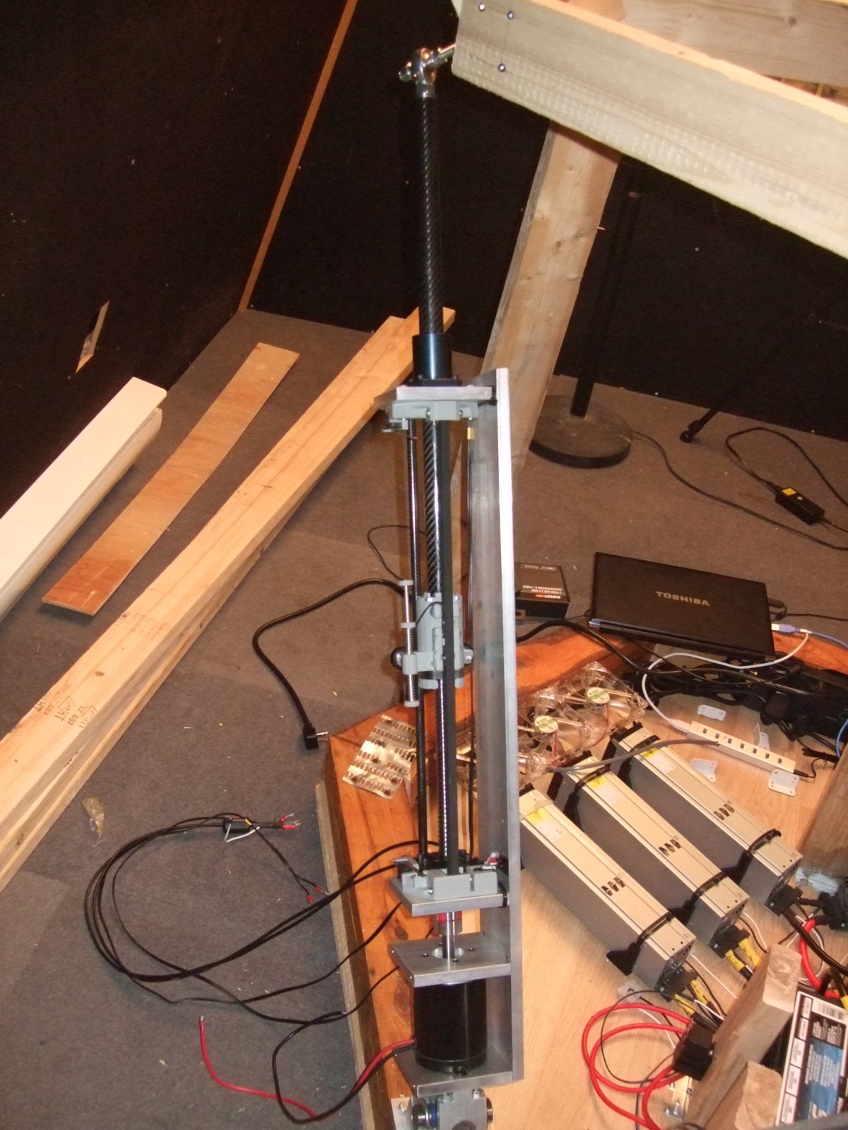

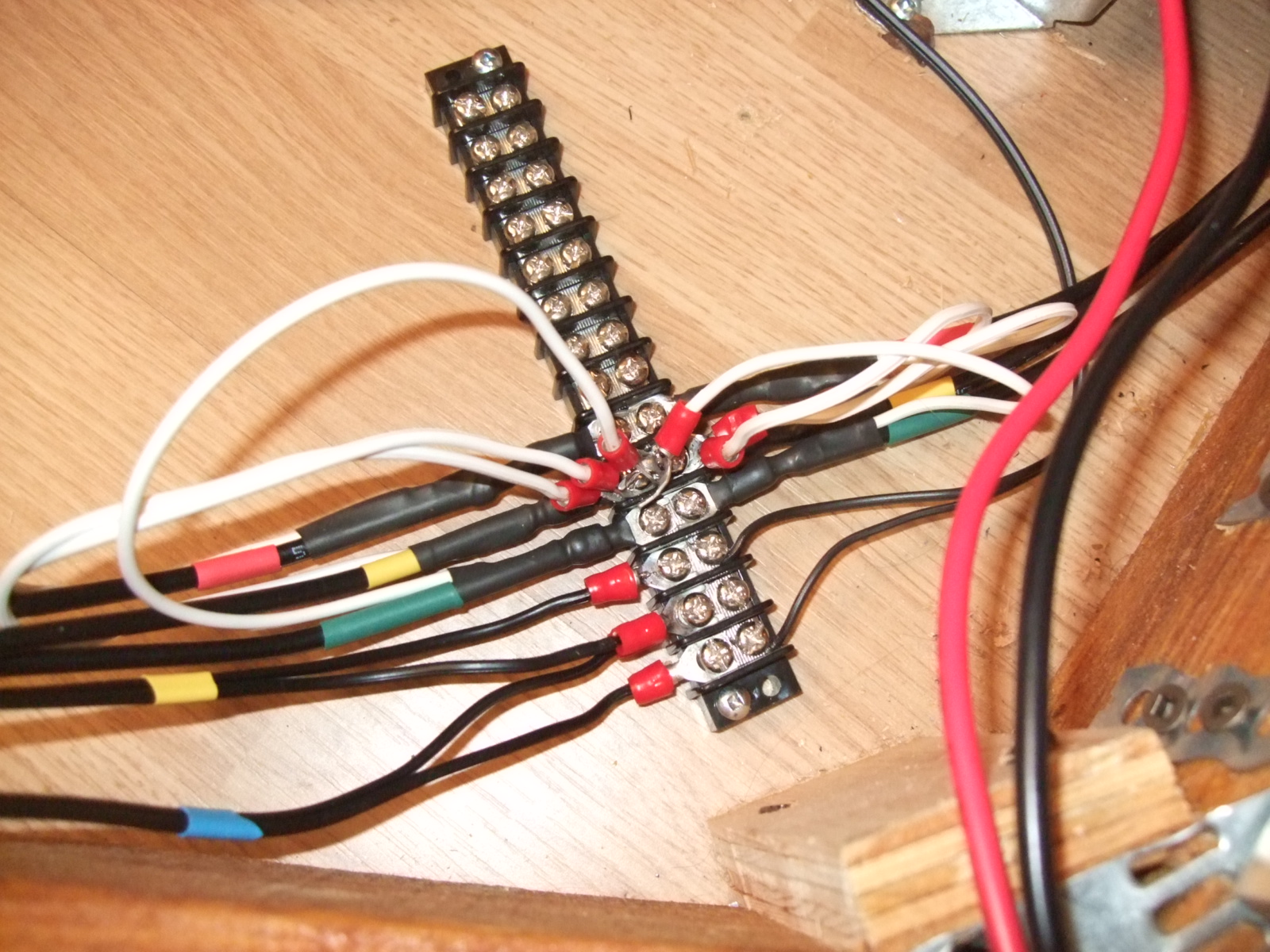

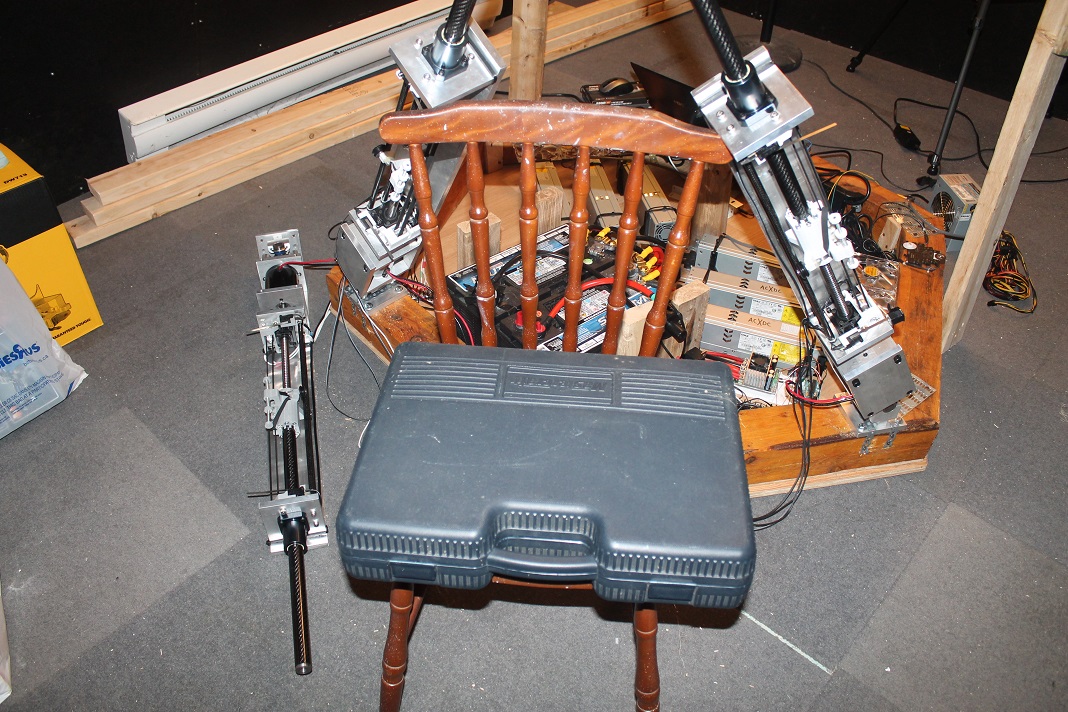

    I have a new actuator rightly wired and tested.
    It is well fixed too.
    The other Gray one needs its potentiometer rewired the right way.
    So are the White ones, and there bases need to be drilled.
    The Orange ones are missing their electronics altogether, but they are assemble.
    The rig doesn't need the chair anymore to stand on its own.
    The coaxial cables seem to have stabilise the noise. Looking forward to see them all working together.

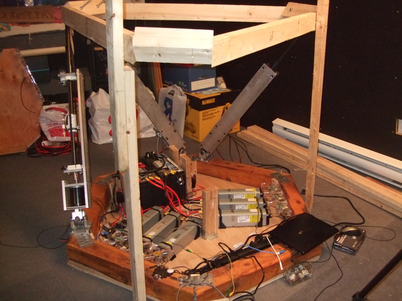

  9. Pierre Lalancette
    Dec 11, 2016
    1,010
    Tech Artist
    Quebec, Canada
    8,050Coins
    +946 / 6 / -0
    3DOF, DC motor, Arduino, 6DOF

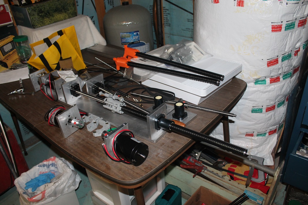

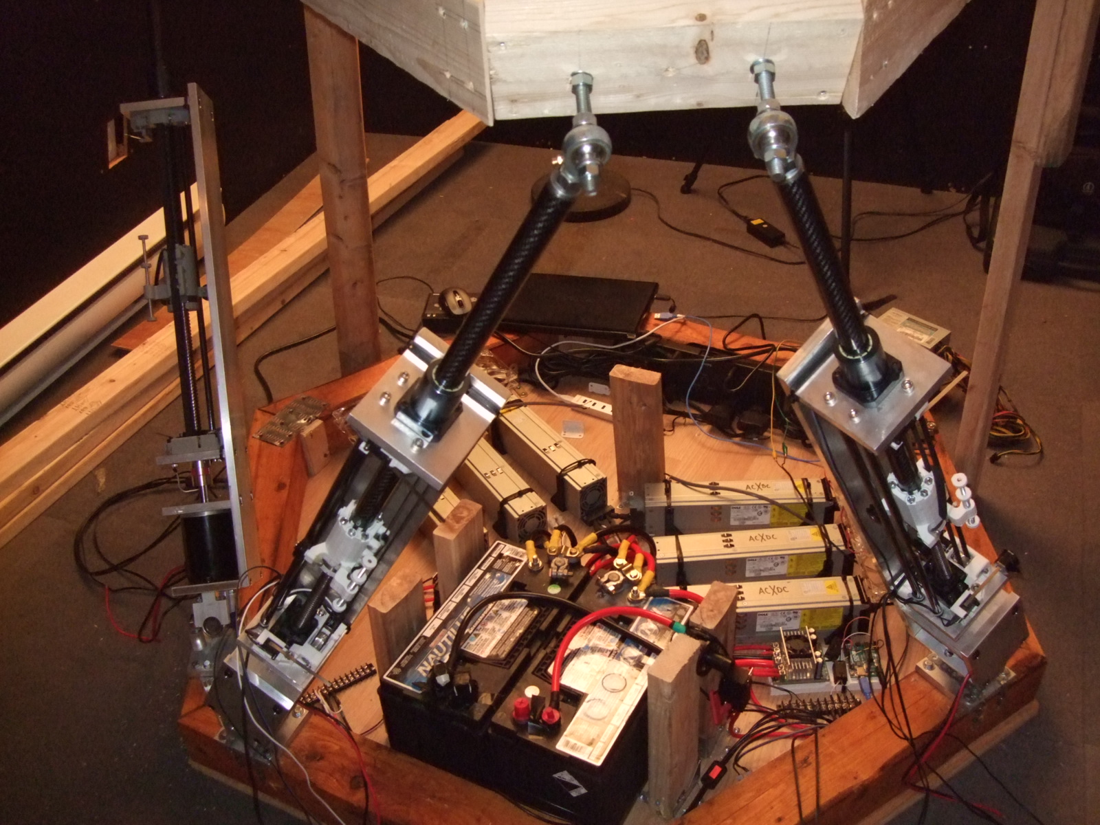

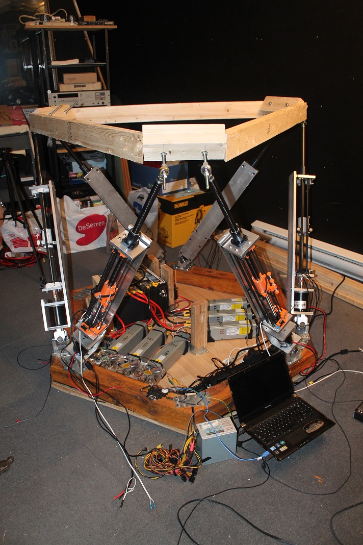

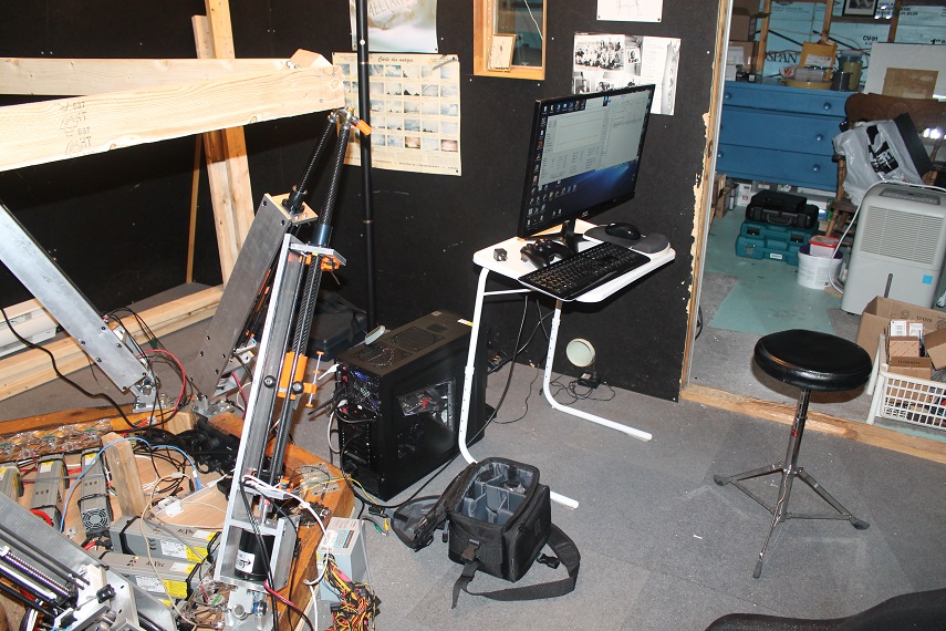

    If you look at the first post of this thread, you will see that I started it December 18th of 2016. That means almost 2 years ago. Its been a hell of a ride.
    Back then, I knew nothing (still do).
    Now, I think a picture sums it up.
    I still have to redo the potentiometer wiring on 2 of the actuators and fix their bases properly, but isn't it a beauty. Not working, but a beauty.
    My to do list is still quite enormous, but the feeling of a major milestone been passed upon fulls me with joy. And now, it's rock solid stable.
    Also, today, I ordered my 2 missing Arduinos and 2 others Sabertooths. One Sabertooth is back order. Let's hope it won't be too long.

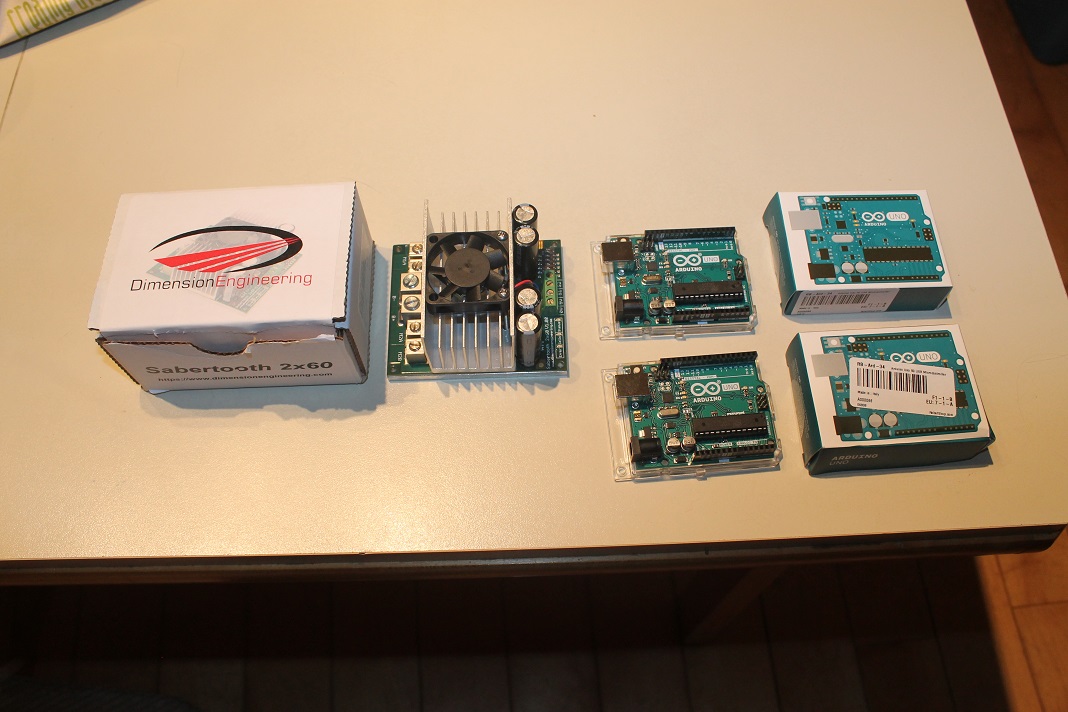

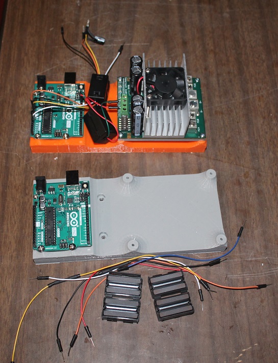

    It's that time of the year! It's Christmas. Oh! Wait! It IS actually Christmas time!
    What could be inside?
    Oh! Oh! Oh! Stuff pretty expensive. Still missing one Sabertooth (expected in January) and the Arduino comes with a nice base now. Forgot to order the Arduino Power Supply. I know, they are powered by the USB, but I prefer full power supply.
    Could not use the base of the Arduino, as my prints did not take it into account. One is ready to be incorporated to the base.
    But during that time, I also rewired my two white actuators. They work and this is a video of those 2 working under the game Life For Speed (or is it Speed For Life?). I have no idea how they are configured. I was just happy to see them move. I wish I was out of the picture, but space is limited. Still in my pyj. The actuator worked fine with the game until my game froze up for a second and came back while I was hitting the wall. Follows the big actuator's moves, the limit break, and the reverse motor until it hits the limit switch.
    For those who are starting out and think limit switch are not a necessity, I pity you.
    I have a question now for the SMC3 and Arduino's Guru. To set the SMC3 script into the 2 others Arduino's, I have to set them to Port 4 and 5 (the first one is 3), and you do this via the configuration file that I don't have a clue where to find yet, right?

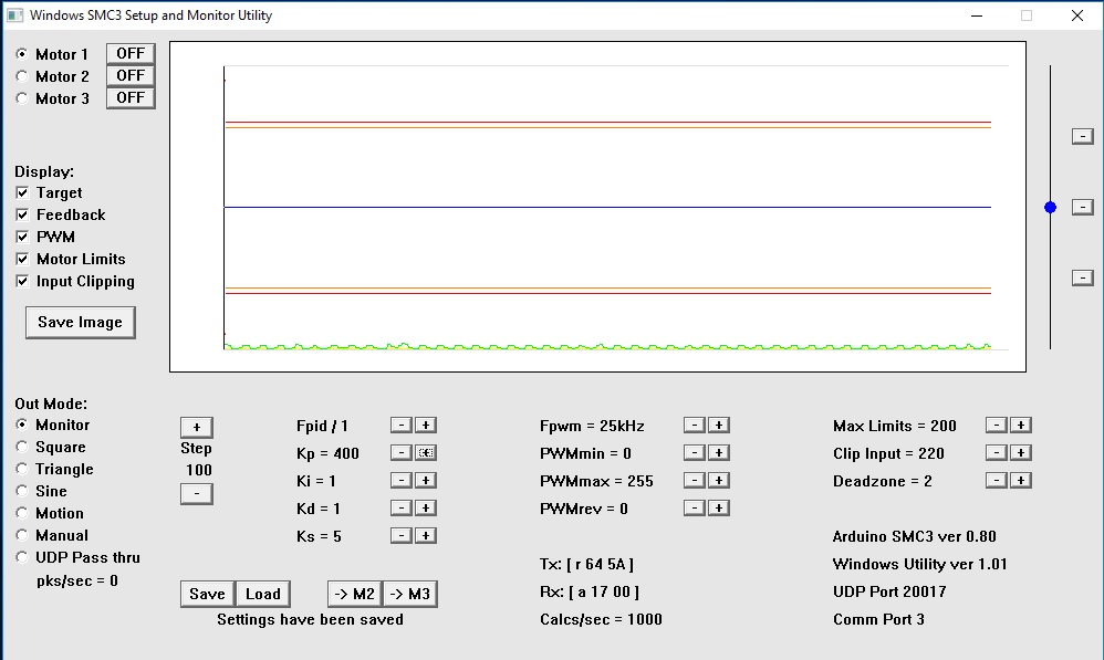

    Yes I am. I set up my four actuator with the same values. They moved, they where following the signal properly. But they were not under load.
    Am I using the right values? I have no idea. It looks something like this:
    I found that one of the motor had a Kp of 420 instead of 400 (corrected now), but beside that, they are all the same.
  15. SilentChill
    2,645
    20,604Coins
    +3,570 / 34 / -0
    Change your FPID to 3 or 4
    And put your KS back to 1
    And take your dead zone off

    Second, I change the setting in SMC3 tool utility. The improvement was HUGE! Thanks a lot @SilentChill .
