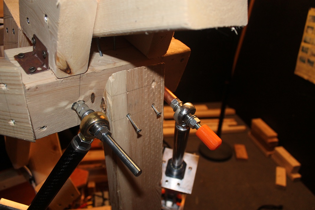

    First thing I did was to shorten the support rod.

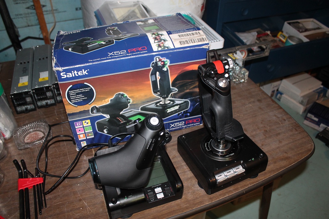

    I got lucky last week as I saw this Saitek to sell for 75 buck. I thought it was the same x52 that I had, like the picture of the on the selling site, but it turn out to be the x52 pro. Not bad. I told myself, I'm gonna install this this weekend. Man, little did I know all I had to do to calibrate the rig.
    I was testing my rig and I did a couple of run, just using the controller. I must say that I don't really know what I should look for as what are the most realistic sensation on the rig. I guess it would be easier to do it with VR, but my VR was not set up and we are waiting for some friends over. I'll set it later.

    Yay !! Nice work dude. Do you have the filter on as it seems very lazy ?
    Those shortened connectors look loads better :)

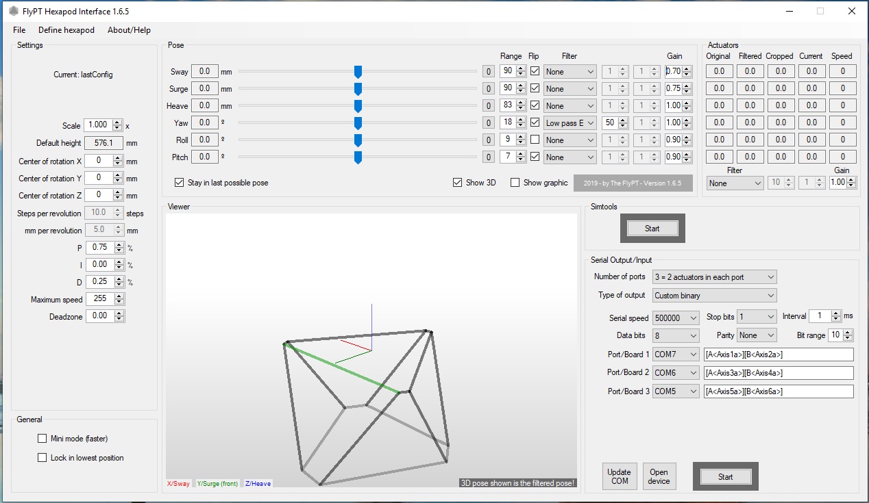

    You were right! I missed the filter that is applied on all actuators at once. I even remembered reading about you having the same problem.
    When I removed it... Yeah, baby!:D
    At last, the calibration turn out good. It can be improved (it can ALWAYS be), but I am so happy now.

    I have dial down the motion on my rig. With the gain and range of Hexapod Interface, it was almost fun to do. Still, setting those rig is quite a challenge. There is so many little adjustment here and there, it's overwhelming at first. Also, I have worked so hard to get the most out of those actuators, I had to fight the alpha male in me who did not want to turn down the power (My rig is bigger than yours!). But it was so much better. I've turned it down quite a lot, even too much. But, judging by the number of time I lost control and hit a wall, it's better this way for now.
    Only a 10 to 15 minutes rid today, and it was enough.
    I solved my yaw problem by adding a low pass filter to it. I did not find another way.

    If you was a bit sick with assetto corsa be careful with No limit 2 !! because it was the same for me , after 3 or 4 rides it was enough for me !
    --No limit2: you must put at the game set up ( ( --telemetry)).https://www.xsimulator.net/community/faq/no-limits-2-v2-2-and-higher-how-to-activate-telemetry.198/
    - With the *Define Hexapod* some range was a little bit over for my set up ( Rig) like : Yaw , Roll and Pitch , all was at 25 and when I did manuel pose , all of them down about 17-18 (1 inch near from the limit switch ) ... for all the rest it seem ok !
    - Other problem I have is , when I put the filter (Low pass..) I can`t see diference between Actuator Original and filtered , I don't know what I do not correctly!!
    - For the Menu *Settings* ( Current: last config), If I did all ajustement with SMC3 , can I change those with this menu or is just for Pmvcda rig Menu ? and if yes ... what I can change with center rotation x,y,z ?
    and for the end .. I have the same problem then you ... too much power ...(My rig is bigger than yours!):grin

    It's better to have more power than not enough. But we have to be smart enough to tone it down to the right value (With great power comes great destruction).
    Thanks for the info on No Limit2, I haven seen that one at all.
    On the picture above, you can see that I put a Low Pass Filter on the Yaw at the value of 50. It worked great for me. Nothing else to do.
    For the menu setting, I don't think we can change the P.I.D. when connected to Simtool. If I remember well, they are grayed out when we press Simtools Start. I only adjust them with SMC3. I think they are use for other configuration, like Pmvcda rig.
    The Center of rotation is the position of the center of rotation (Doh!). If you change them, you will see the red/green/blue gizmo move, and the rotation forces will move around this new position. I bring it down and a bit back to fit my seat position at the height of my as... Hips.
