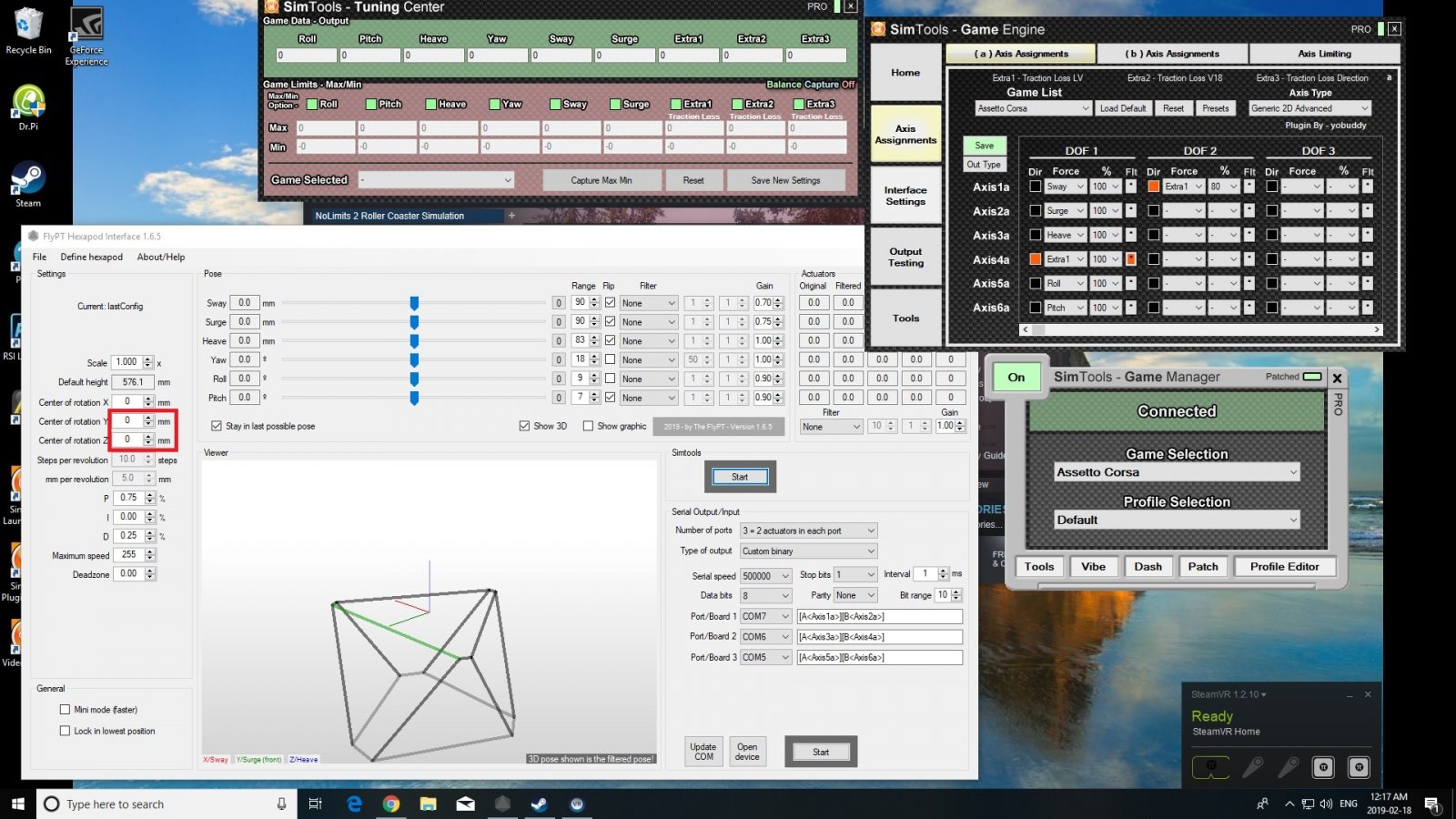

    The PID adjustments in the interface, where just for my rig.
    I calculate speed on the PC, not on the boards.
    SMC calculates PID on the boards.
    That's the reason it's disabled for modes different from FlyPT.
    Filters...
    You can apply filters in the pose components and in the actuators output.
    For example, in LFS I want to make heave smoother, because I think it's to harsh, I apply a low pass filter to heave.
    When I calculate the actuators position, it's for the filtered pose.
    After calculating the actuators position, I can then apply a filter to the actuators.
    Resuming, if I apply a filter on the actuators, it's almost like applying a filter to all pose components.
    While filters in the pose are specific for those components, like heave.
    If you think the rig is moving to much and are afraid of breaking it, make a low pass filter on the actuators, with a low value. It softens the rig.
    What the graphics show, is the actuators only, not pose. So you can't see the result of applying the filter to the pose (the new version to be released of the interface has also graphics for pose components).
    The graphics also show in blue, the current position received from the boards, but that's only for the FlyPT rig. Same with speed in red.
    I should remove it from the interface, but I thought that leaving it there, could help understand PID values.
    Also, from last version, it's already possible to send speed and receive position on custom serial besides the FlyPT rig.
    But I have to make an example Arduino code to show how to implement it in the boards

    We have two kinds of ranges.
    -Actuator range:
    That's the distance the actuator goes up or down, from it's middle.
    Imagine your actuator has 600 mm total range.
    In the interface, range should be half that value if you set middle of the actuator at 300 mm.
    Range would be 300 mm up or 300 mm down.
    You can say that middle is 200 mm in the same actuator and then you would have to set range to 200 mm, because you only have 200 mm to go down while you have 400 to go up.
    You have to use the lowest one.
    We should use the middle to allow equal range up and down and the most possible amplitude of movements in all directions and rotations of the rig.
    The actuator range is set on the window with the rig dimensions.
    Now, if in the above 300 mm range we activate the limit switches at 300 mm, it will make the rig stop in case of the SMC3. So you should use something like 280 mm, giving 20 mm gap.
    With this the actuator will work on that range (280 mm) and won't activate the limit switches, unless something went wrong with pots, mechanically or an excessive load.
    Actuator range is the absolute limit of the rig. When I send the rig down to lowest position, I request the actuators to go to the lowest range, in this case that would be -300 mm (or-280 mm with the gap).
    -Pose ranges:
    Pose ranges affect the components of the pose.
    Let's say, I keep my actuators with 280 mm range.
    And I set heave range to 100 mm.
    What I'm making is saying that heave can only go up 100 mm or down 100 mm.
    You can also say that heave range is 1000 mm.
    But then you have the actuator range that limits movement and you receive the message out of limits.
    The position where we have heave=0 mm is calculated by the rig dimensions and the middle of the actuator.
    In the interface, there's a default height value. That value is the vertical distance from the bottom joints to the top joints when the actuators are at the middle range (it's just for info, not editable).
    It changes if you change the middle of the actuators or the general dimensions, not the ranges.
    But why don't we use big ranges in the poses?
    Imagine we use 300 mm range in heave and 45º in roll. We would reach actuators limits really fast , receiving the out of limits message.
    The out of limits message is saying to you that the pose you want is impossible to produce with the rig dimensions you specified.
    You must understand that those ranges are proportional to the values in Simtools tuning center.
    Again for heave: If you have -10 to 10 value in Simtools tuning center for heave and 100 mm range in the interface, the values will be mapped.
    Zero in Simttols will be zero in the interface. -10 in Simtools will be -100 mm in the interface and so on...
    And scale?
    Well, scale is to achieve a correlation between the value displayed in the interface and the real movement.
    The interface doesn't know the relation between the pot's read and distance travelled in the actuator. It depends on pots and pulleys.
    So the interface needs a value to convert and apply a scale on the final output.
    To get that value, put scale=1 and heave range=100.
    Move heave to zero and measure height from floor to a reference point in the top structure of the rig.
    Now move heave to maximum value (the 100 mm) and measure again.
    Calculate the difference between the two.
    For example:
    With heave=0, height=820 mm
    With heave=100, height=1030 mm
    Difference is 1030-820=210 mm
    Instead of 100 mm it travelled 210 mm.
    So scale should be 100/210=0.477
    It should work like that. If different then there's something wrong. Or I might be forgetting something...

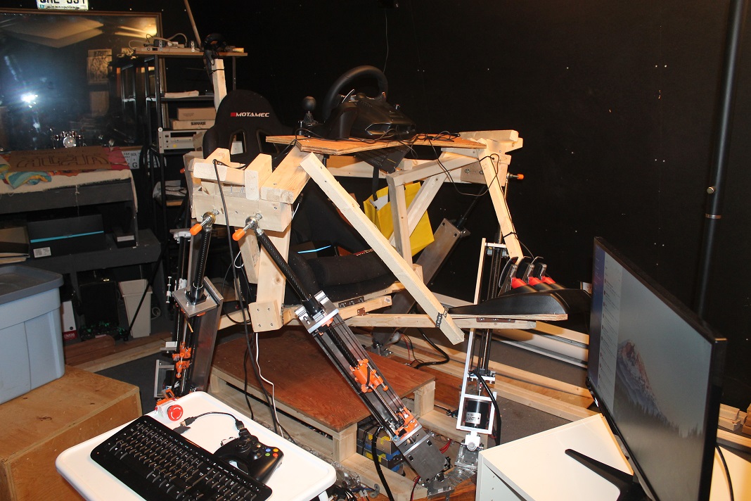

    Not much of a update, but still.
    I removed the yaw in my force as recommended by @yobuddy . It felt really different and I even reverse the extra force 1. But I forgot to set my center of force to fit my seat position. Did not have much time to test this weekend. My forces are still quite low. Its was good, because the number of time I hit the wall at an impressive speed, I would have destroy something. Still so much to calibrate.

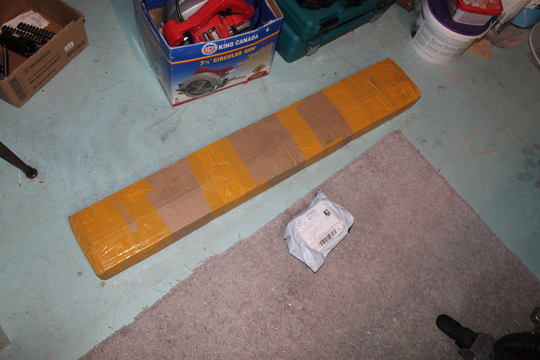

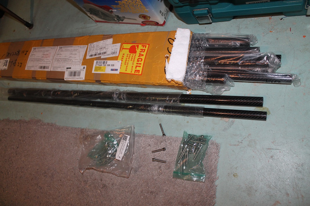

    Last week I got a package.

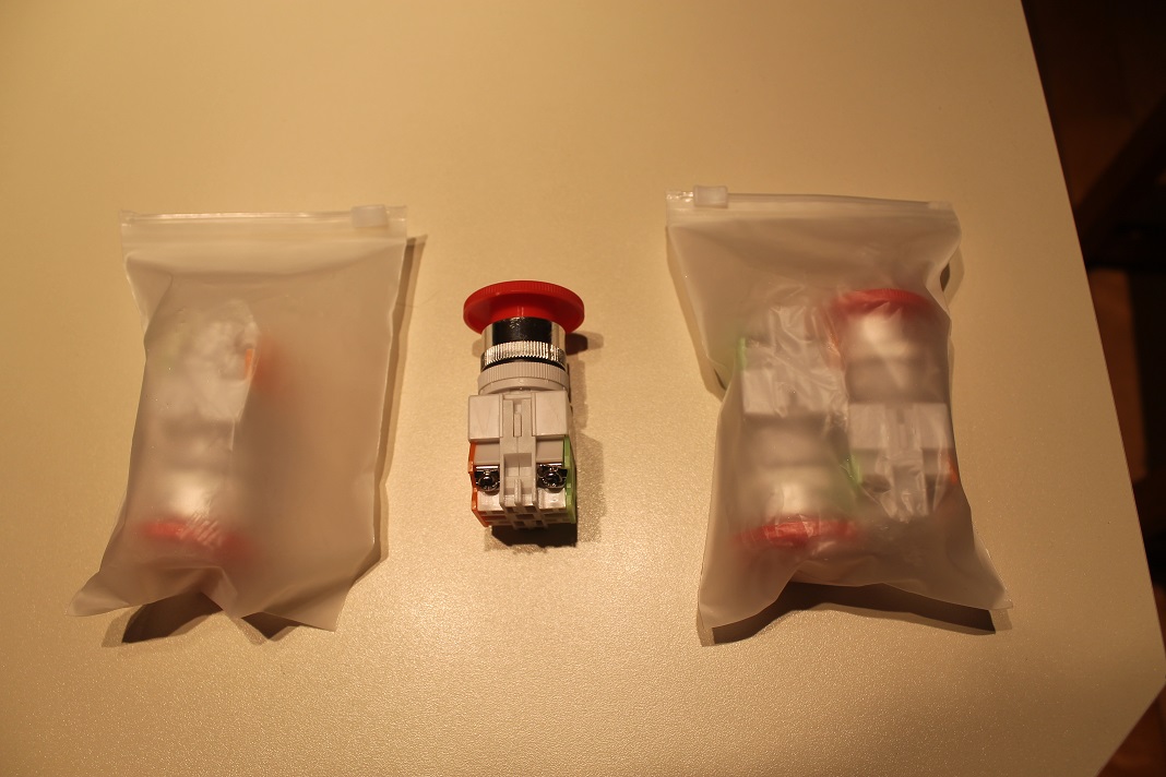

    It was panic buttons. The one I get from my local supplier were pretty bad. I got better one.

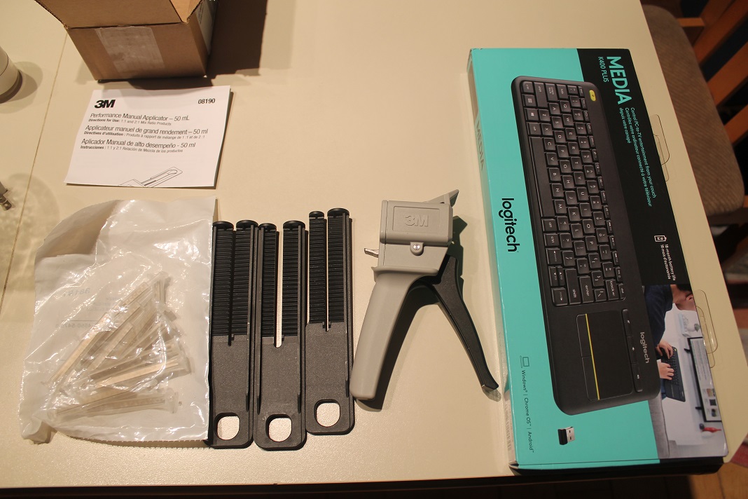

    This week, I got 2 packages.

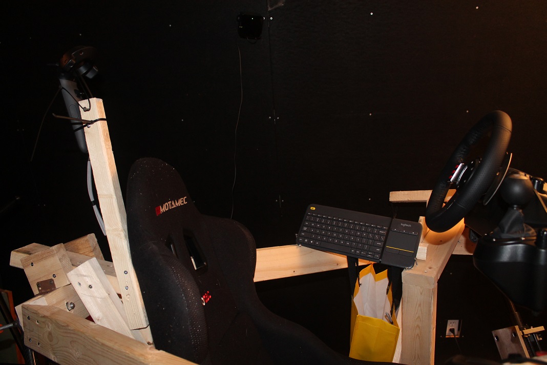

    One is a keyboard with a tracking pad, so I never get one my rig without a keyboard and a mouse. The other one is a tool to mix 3M epoxy tubes. No more mess with a scale.
    So I set it up on the rig. You can also see the tracker set for motion cancellation over the seat. It works like a charm with madzman plugin for steamVR. I did not feel dizzy.
    The final result so far.

    Hi , I am to set up my keyboard at the same place because the screen of computer will be this side and I ‘m coming the other side of the rig , panic button will be on the right side .
    Q- the tracker motion cancellation must be over the head ?
  9. Pierre Lalancette
    Dec 11, 2016
    1,012
    Tech Artist
    Quebec, Canada
    8,052Coins
    +947 / 6 / -0
    3DOF, DC motor, Arduino, 6DOF
    @Flymen The tracker must be seen by the 2 Vive's lighthouse. Because a rig is a living thing that shakes all over the place, the closer it is from the head, the less vibration you get from the rest of the rig. But it can be anywhere, as long as it is on the moving rig and that it tracks properly.

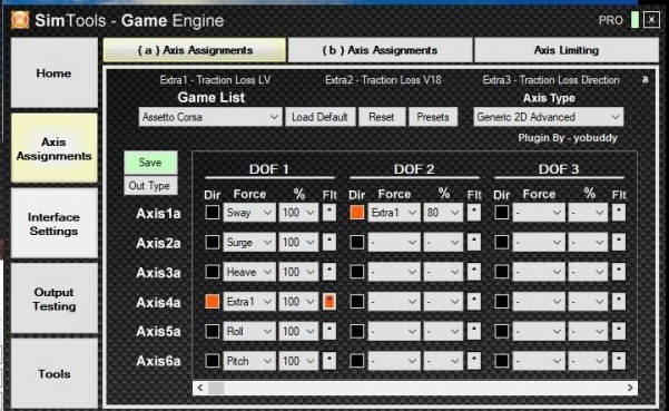

    To all Simtools gurus, I have many questions to ask.
    First, I just want to say that I checked the Simtools forum and I found many tutorials, but not direct answer to my question. Also, I checked the manual, that gave me some clues, but no definitive answer.
    Axis / DOF:
    I know it is different from the traditional way to do it since I'm using Hexapod Interface, but I would like to know a few things. According to @pmvcda , the first force must be Sway. Okay, then we assign the other forces to the other axis and they are bind to it, right? Now what about the DOF2? Does the force applied to the DOF2 is applied only when the first DOF1 is applied? Like in the example below, does the Extra1 is applied at 80% only when the Sway is applied at 100%?
    Let's go round:
    I would like to know if it's possible to have the Yaw be applied and turn around, and I'm not even talking about the -180 to 180 swap. I mean, being at 0 degree and turn 20 degrees right. Having the rig turn the corresponding amount for 20 degrees and slowly going back to the center, ready to do the same from 20 degrees to 40 degrees. I understood that it was the washout that was doing that. I never was able to reproduce that behavior with my rig. Again, using Hexapod may provide different results than a traditional forces calibration.
    Now, the -180 to 180 swap. Is it possible to switch from one to the other without a violent kick? I'm thinking flight simulation that I didn't even try to set yet.
    Washout:
    Can someone explain to me what Washout in Filter is suppose to do? I thought it was bringing back the rig to center position after every turn. It doesn't for me. If my Yaw is at 180 degrees, my rig will turn 100% that force and stay there. It won't slowly come back to zero. No matter the values I try.
    Maybe I need to set the forces like we used to do to see if I can do those thing that way.

    The FlyPT Interface needs to receive the pose components:
    Sway
    Surge
    Heave
    The way I do it, is to receive it through the axis.
    So to use it with the FlyPT interface, I made my own convention, where the order should be:
    Sway is sent through Axis1a
    Surge is sent through Axis2a
    Heave in Axis3a
    Yaw in Axis4a
    Roll in Axis5a
    and pitch in Axsis6a.
    So, anything you send through Axis2a, for the FlyPT Interface is just surge.
    But you can play with that.
    Instead of just sending sway, you can send some of the other DOF.
    For example, when braking:
    I want surge to make the seat go back and simulate a braking force. You fell your back going away from the seat.
    If I add a bit of pitch (the car diving while braking) in surge, putting it in DOF2, I'm increasing the surge result. So if I'm going downhill, I can get more surge effect braking compared to when I'm going uphill.
    You can mix it however you want. But! If the plugin is "good" (gets good data from the game in the correct way and game physics are good), it shouldn't be necessary to make this.
    The output from the game should handle all this by itself.
    The %, is the amount of the force that you want to add to the resulting axis.
    For example in the above case, if I have:
    Surge=20 with 100%
    Pitch=10 with 20%
    The result is 1.0*20 + 0.2*10 = 22
    So Axis2a/surge for the FlyPT interface gets a value of 22%
    Now imagine that the output from simtools allows a maximum value of 20. Then the output is only 20.
    That's why, without the FlyPT Interface, when you mix DOF, you should not go over 100% in the sum of all DOF for that axis.
    Well, you can, because you wont get all the DOF at maximum at the same time, but 100% maximum is the safe value.
    It's similar to the clip in ffb wheels.
    Resuming, all DOF are added in the selected percentage for each one, to calculate the result of the axis.

    OK, after some tests... You are right, the behaviour is strange or I'm also loosing something here.
    What I read:
    Gain is how much of the new value received is used to affect the result
    Return is how fast you go back to zero
    I tested using Axis4a with Yaw only at 100% in LFS.
    With gain=100 and return=0.
    Yaw moves and it doesn't return to zero. But it doesn't jump from side to side also, it stays at maximum range.
    With gain=0 and return=100.
    Yaw still moves, and it doesn't return to zero.
    Yaw also jumps from side to side over the limits.
    I though yaw should not move in this case.
    With gain=50 and return=50
    Yaw moves, and doesn't jump from side to side.
    Return works, if you are in stand still and the value is constant.
    As soon as you are moving, return doesn't work.

    I think the problem is that Simtools receives updates to yaw constantly.
    Return works only if there are no updates to yaw.
    As soon as you have an update, it asks for that value again.
    It seems the return is not enough for the amount updated.
    What can we do?
    I don't know. :(
    You solved it with a filter, but it's not enough, because if you are going in the same direction, let's say 20º in a long straight, the filter is closer and closer to the 20º reaching the value at some time. When you turn again, the problem is there already.
    I might be wrong, but there's something that doesn't work as it should here.
    I have to take a better look and see what I can do.
    Maybe @yobuddy could explain better the it works, because I might be loosing something here.

    Christmas again!
    Yes, the skill saw is part of it, as it was given to me. My brother in law is moving from house to apartment. He got rid of many tools. Also, if you look at the box at the far left, you can see parts of a future 2dof. But that's another thread.
    Carbon fiber tubes. 25 x 22 x 1000 mm and 22 x 19 x 1000 mm. 10 of the first, 2 of the other. The smaller one will be used to connect the bigger one. The goal? Build a new platform. For those who says: "That's a good idea, I should do the same." Let me tell you that this costed me $520 CAD in carbon, and I want to by more after the Chinese holiday (plates), not to mention more than $200 CAD in glue and accessories. The screws are 6mm for the wheel and pedal fixation. We are not well suited in metric providers around here.
    I totally lost track of the budget of that thing. I see it more like an ongoing experimentation for me. An expensive, frustrating, but so fun, hobby.

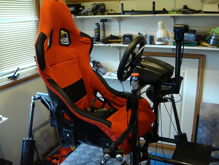

    Carbon Fiber is so expensive. My motivation is that picture from SeatTime. It shows that a carbon fiber platform can be simple. He warned me that getting in and out of that thing was a challenge. I have to think about that.
    Aluminum was considered, but my manual skill ruled it out. Wood is fine for tight budget and experimentation.
