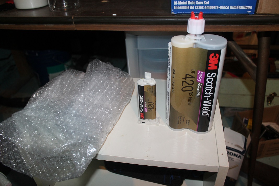

    Christmas again. Big boxes... I don't remember ordering something that big. I know there should be glue tubes.
    And I forgot the damn autofocus again. I remove it when doing videos.
    And then I opened the boxes. Boys, did I screw up big time? You see, I was expecting this:
    So, I ordered 3 of hem, and I got this.
    Three of those! I kept 2 wrapped. Man, what am I gonna do with all that? Seriously, they were about the same price. I did not check the quantity. My new dispenser is useless with those. Oh, man! My days of messing with glues are not over yet. :confused:

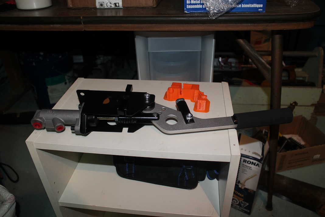

    The other box is a cheap hand break that I will convert for the rig. I did not expect it so soon. Still waiting for electronic parts. And I have to find back the tutorial about it. Behind, is the printed replacement part for my skipping strap actuator.
    It was not an easy change, but all went good. At least, I did not screw that one up.

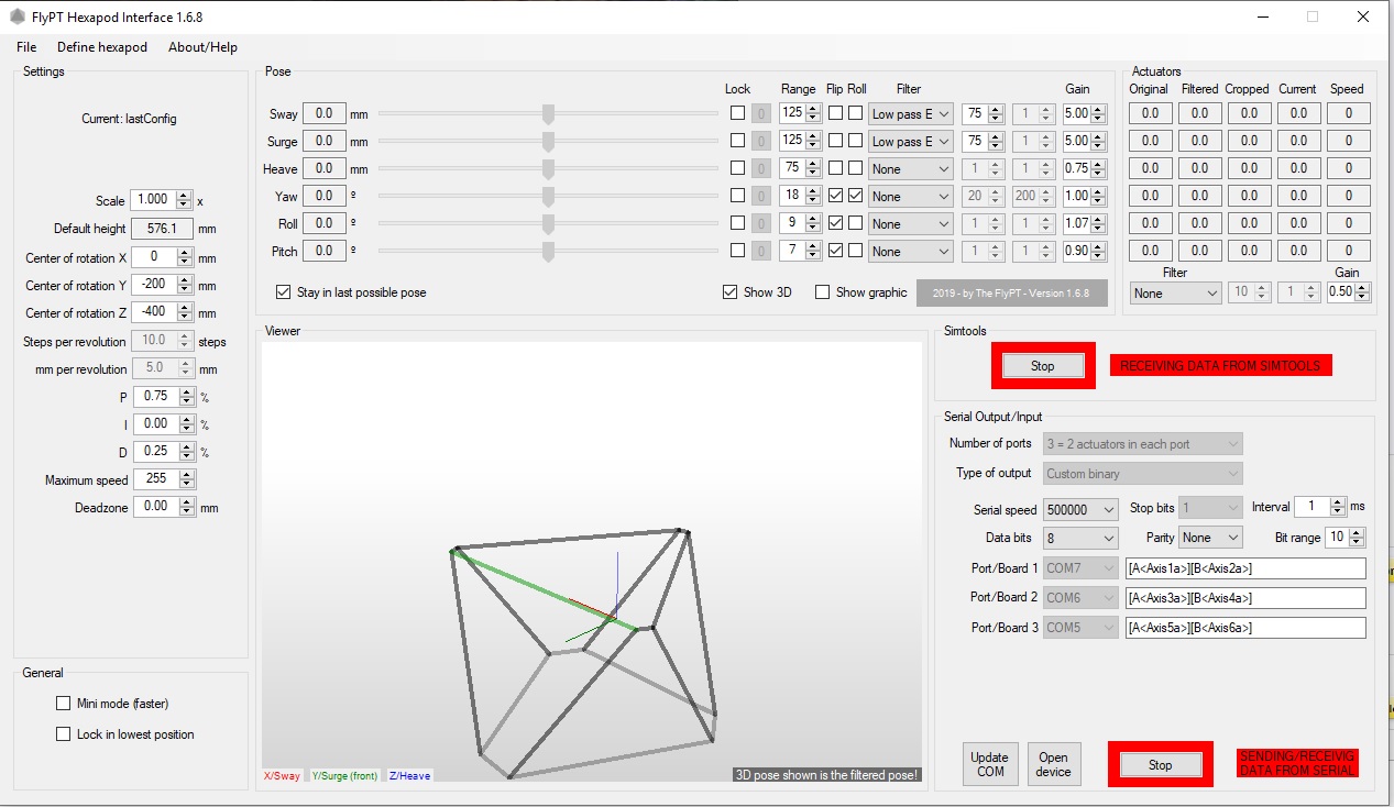

    I did an other run at Asseto Corsa with my new setting. I'm experimenting with filters. It's not bad. Heave was really good. But I am missing power. It's true that the main gain is only at 0.5. I will try it a bit stronger.
    But I am sick, as my girlfriend. The runs will be short.
    Next will be to set up everything for Elite Dangerous.

    whats the epoxy for?
  5. Pierre Lalancette
    Dec 11, 2016
    1,012
    Tech Artist
    Quebec, Canada
    8,052Coins
    +947 / 6 / -0
    3DOF, DC motor, Arduino, 6DOF
    A future platform made out of carbon fiber tubes..

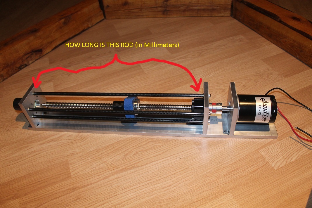

    i decided to go DIY linear actuator, following wannabeflyer and sixdegreesofflight.... im start to order parts.. but i see they have used 20x60.. six degrees order 1000mm length. looks like he had to have them cut.. im trying to find the length.. i edited a photo of yours.. can you please tell me how long? from wannabeflyer's photo, i guess estimate 500mm.. but i just want to be sure!

    Thanks, I guess if you are talking to me. Cause I never consider that I had done a tutorial. I just shared my continuous adventure in the 6dof construction (and now calibration).
    It is a 500 mm 8-10 mm carbon tube. I ordered them like that. I think the like might still be on the first post. But if you want to have insert (for m6 screw), you better use 12-10 tubes. My insert had to be modified by a professional metal milling to fit, because the exterior size is about 9 mm.

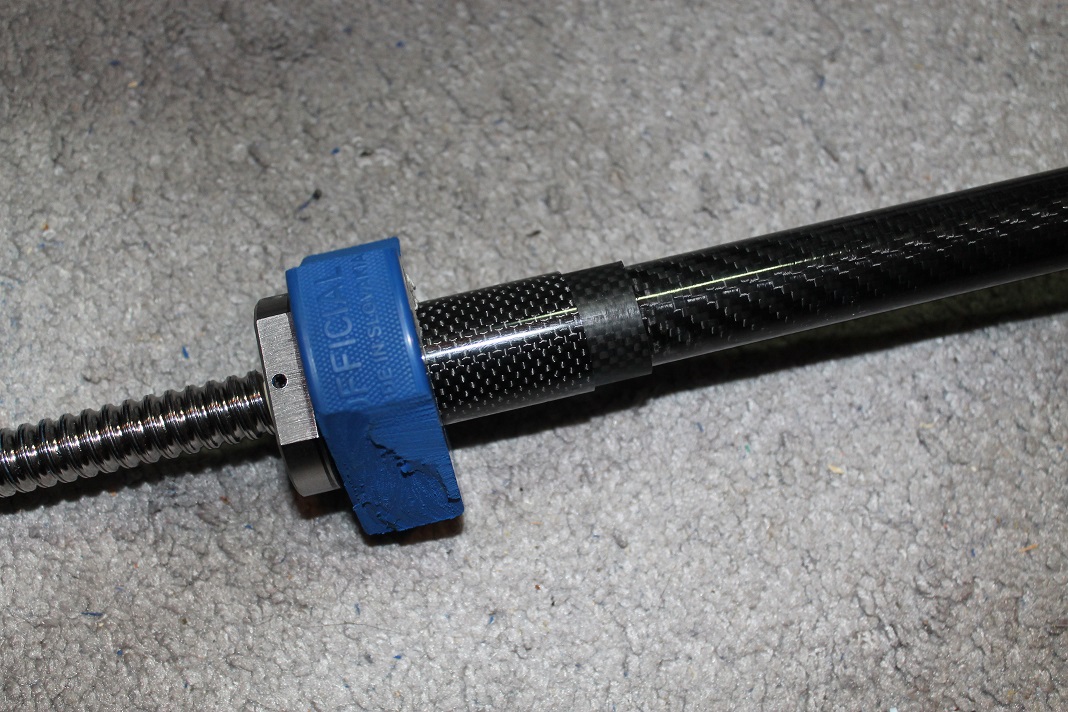

    i was going to order the carbon tubes
    i noticed everyone had went for 25mm OD and 23mm ID..
    i was thinking of going for 20mm ID for strength...
    but how do you attach the tube ?
    the ball screw part says it has a 28mm diameter. i was following your post #160 with the hocky puck..lol i still couldnt tell how you solve the attaching the carbon tube to the ball screw...
    but do you think ill have problems with a 25mmOD and 20mm ID tube?

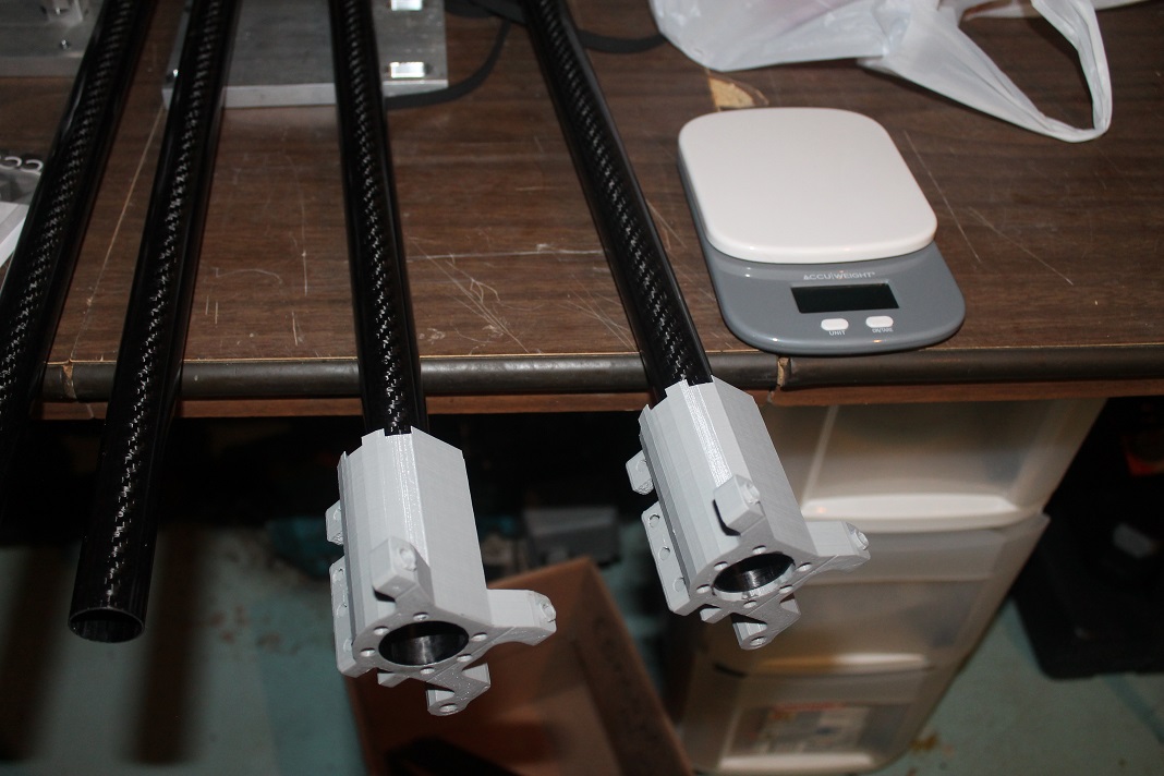

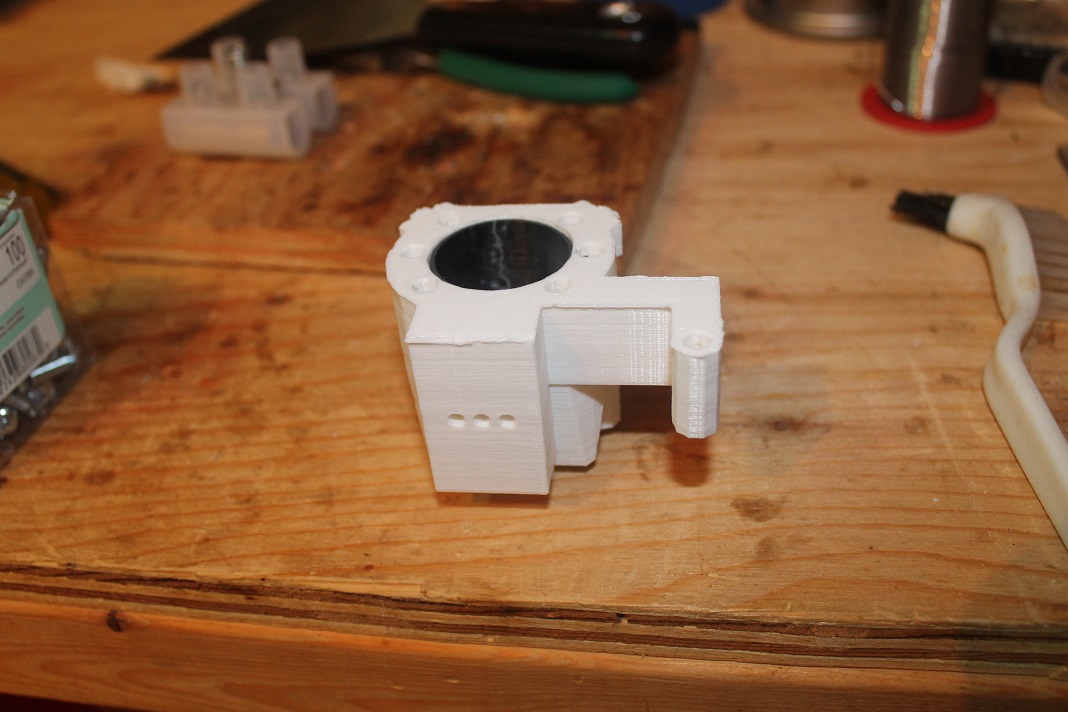

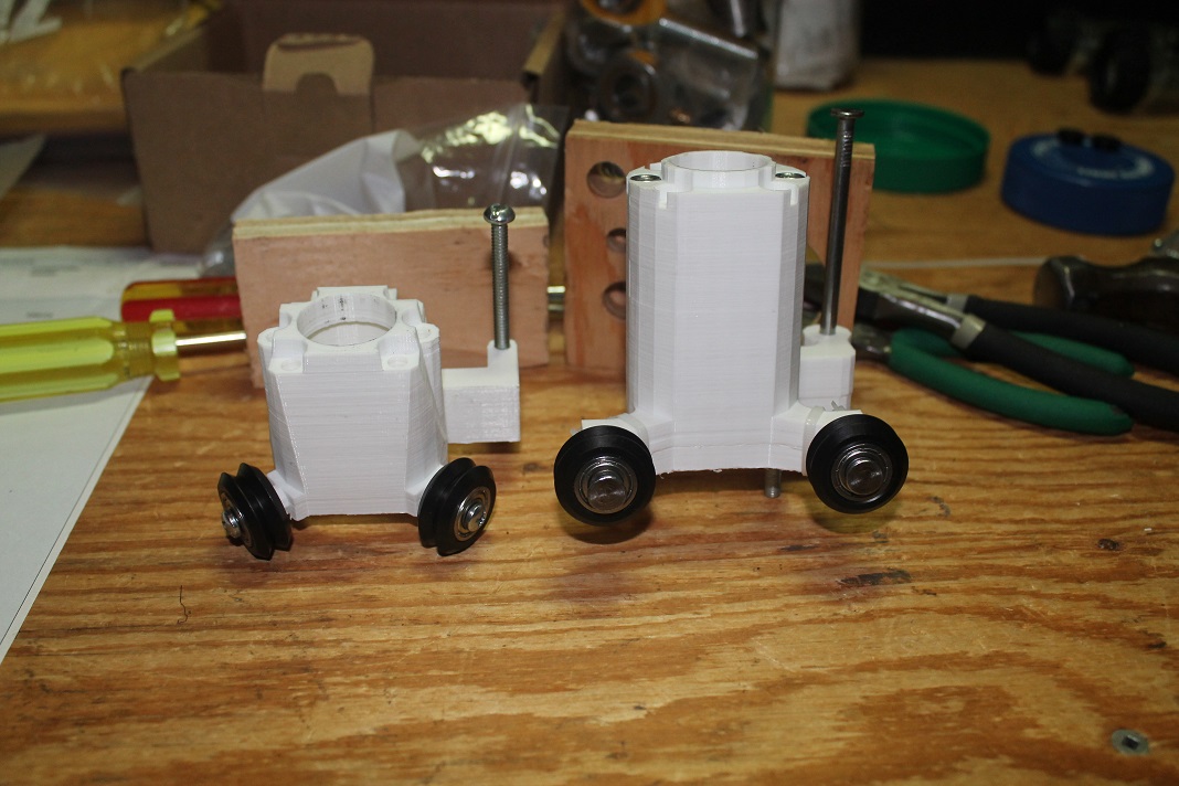

    I don't think you'll have a problem with the 25-20. The way to attach it was to glue it to a printed part. This was my first try. You can see the tube inside the parts. I made it bigger so I could glue the other size tube. Then, you can see the 6 holes on each side to attache it to the ball screw. I run a little rode all the way through the part to make it stronger. This is how I did it.
    6 DOF from scratch
    Final part.
    6 DOF from scratch

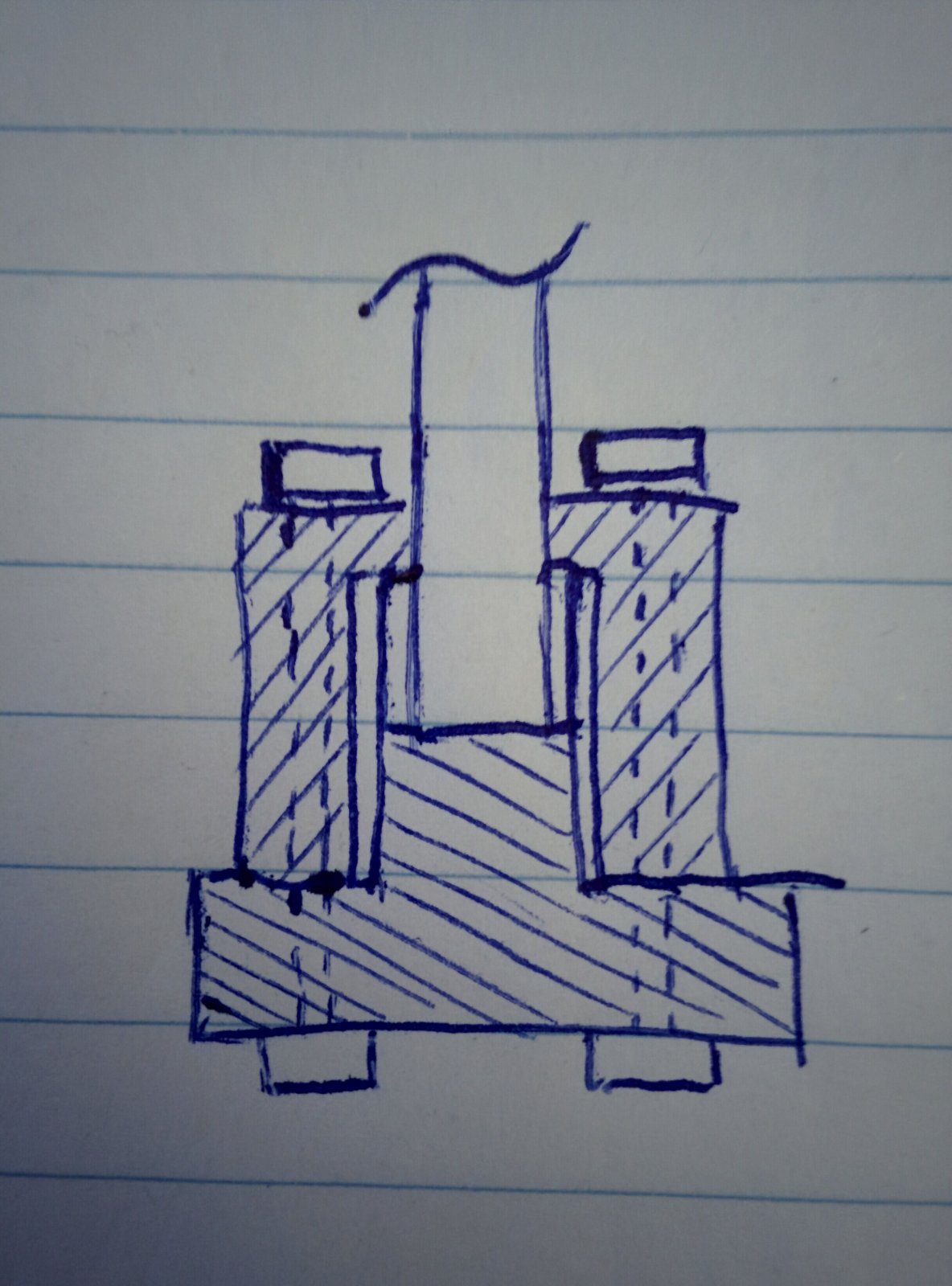

    I would not call it genius, but it woks. Like I said before, I put the 28-25 into the 30-28, but not all the way through, since we need space to insert the ball screw later (size 28 mm). Then, the 25-23 into the 28-25. All fit and align nicely and force the main shaft to stay straight. There is no puck anymore (R.I.P.).
    In my printed part, I've made the hole for the size of the bigger tube (size 30) and left a little edge at the top (size 25) that only let the 25-23 tube pass. It's plastic, so the little edge is not strong at all. This is why the screws pass all the way through the plastic part and the nuts over that little edge to give it strengh and keep everything in place. I glue the plastic over the carbon tube for extra support, and the rods also pass in the ball srew. This is how I hold it all together. I hope I did not make my explaination too complex. It's hard to describe in words.
    In the last picture, you can see that one of my 30-28 tube is a bit too short. But it was not enought to jeopardize the structure.

    how high is your adapter?
    i assume thats why you have the epoxy...
    i wish there was a mechanical way to fasten the carbon tube to the ball sleeve.
    looks like epoxy is the most feasible way to connect, but i worry there is not enough surface area to make a tight bond.
    i sort of wished i went the 30mm OD/28mm ID x 500mm tube route..
    i like how you made the wheel guides. im still thinking about how to attach. do you plan to share ur 3d print? :) :)
    would be great if there was an aluminum structure like your adapter!

    My 3d prints are not here. I'll do it this weekend. I basically use the lenght of the ball screw we attache to, double it up, so the main shaft has the same amount of support.
    I made a little drawing that tries to show the lateral cut of this setup. I omited the little U part that goes under the ball screw.
    Hope it helps.

    no it is clear. thank you so much. so basically 40mm (ball screw) plus 40mm (500mm tube) equals 80mm is your epoxy adhesion surface area...
    im debating to use the epoxy solution or go 30mm aluminum tube and weld..
