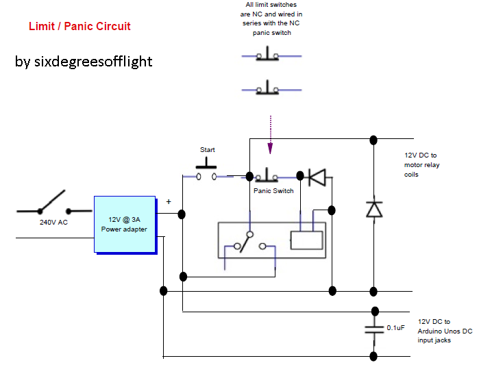

    If a limit switch is hit, all motors are stop. The relays are working if all limit switches and panic buttons are not trigger. It's a big close circuit. Trigger one and all are stopped.

    i havent gotten that far about the safety cut off circuit, i saw from sixdegreesofflight about his lesson on the safety citrcuit. i assume once panic and switch is tripped, it cuts off the power to relays that supply power to motors, my pre-research question would be, what happens during the activation safety cuircuit? it is by means of self latching circuit like sixdegreesofflight? (im wondering if anything needed to be triggered or wired to the arduino...)

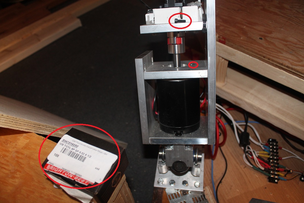

    i am also planning to use the ampflow motors.. im just curious if you actually connect the (4x) 8-32 bolts on the top of the E30-150, and if you also (4x) 6-32 bolts on the bottom of the motor...
    i find it hard to believe all the forces are being held down by such small size bolts! (if share how long the 8-32 bolts that you fasten your E30-150 to your 1/2" aluminum plate.. would be helpful)

    I was wandering at first if I had an order to turn everything on. I ended up not caring about it at all. Sometimes, the arduinos get lost and I have to reset everything.
    But mainly, a 5v is driven in the closed circuit of limit switches and panic buttons. In that circuit, there is also a relay.
    That relay provide the 12v to 6 others relays.
    Thoses relays provide the power to the motors.
    Nothing monitors the arduinos.
    The motors are only attached by the 4 screws at the top. I do not have the length right now. I had make the hole in the bottom part, but my mechanical friend did not bother to attach them. So, neither did I.

    Hi Guys , I can vouch for @Sixdegreesofflights latching circuit , it has saved my test actuator a bucket load of times while im trying to get to grios with various controller Options.
    as mentioned my setup uses the 6 relays to disable all motors but not power to Sabertooths . inertia with these actuators is the thing that i find reduces overall actuator travel, as limit switches tend to be placed far enough away to minimise hard ballscrew collisions with actuator frame but far enough apart to give maximum travel . so in my instance i may have 380mm mecanical travel but this will drop down to maybe 300mm usable to give me what i call an overrun buffer at the top and bottom of movement rage
    i keep saying this . but bears repeating , these actuator are fast and powerful and can destroy themselves and our bits LOL quickly without safety cut of features in the system .
    Software limits help, but from experience another level of safety does not hurt . especially whilst learning about the system were building

    @hannibal This is the screw that holds my motors: 8x32 1/2"

  12. SeatTime
    2,572
    +2,854 / 40 / -0
    I have a row of momentary bypass switches in the cockpit for this exact situation.

  15. SeatTime
    2,572
    +2,854 / 40 / -0
    Nope, but it is not that complex - I have a high power relay and upper and lower limit switch for each actuator. The momentary push button just bypass the bottom limit switch while it is being pressed to enable the actuator to drive off the limit and back to station - even with me sitting in it :). Does not happen very often and it beats doing it by hand ...

  17. SeatTime
    2,572
    +2,854 / 40 / -0
    No, it is totally related to the power provided to the actuators motors from the drivers. It is just a switch that momentarily bypasses the bottom limit switch. Everything else remains the same.
