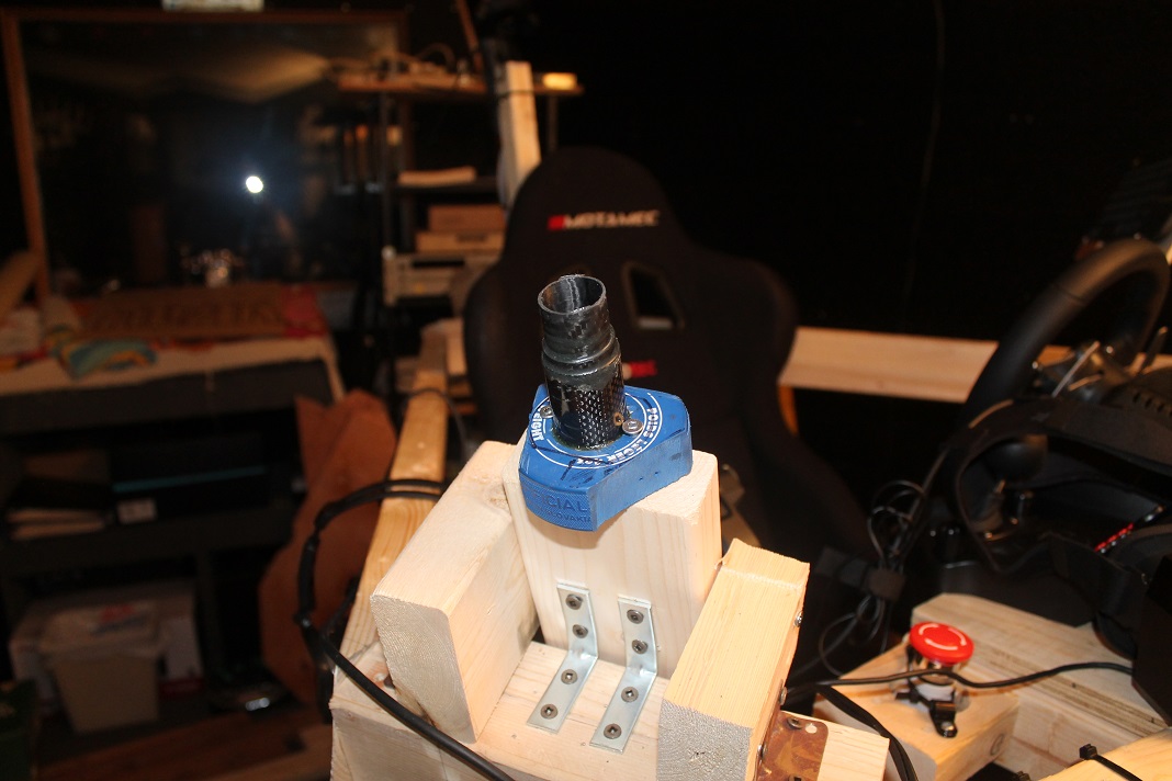

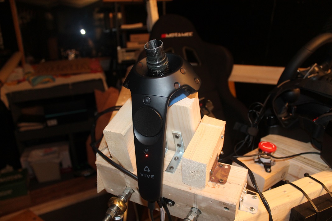

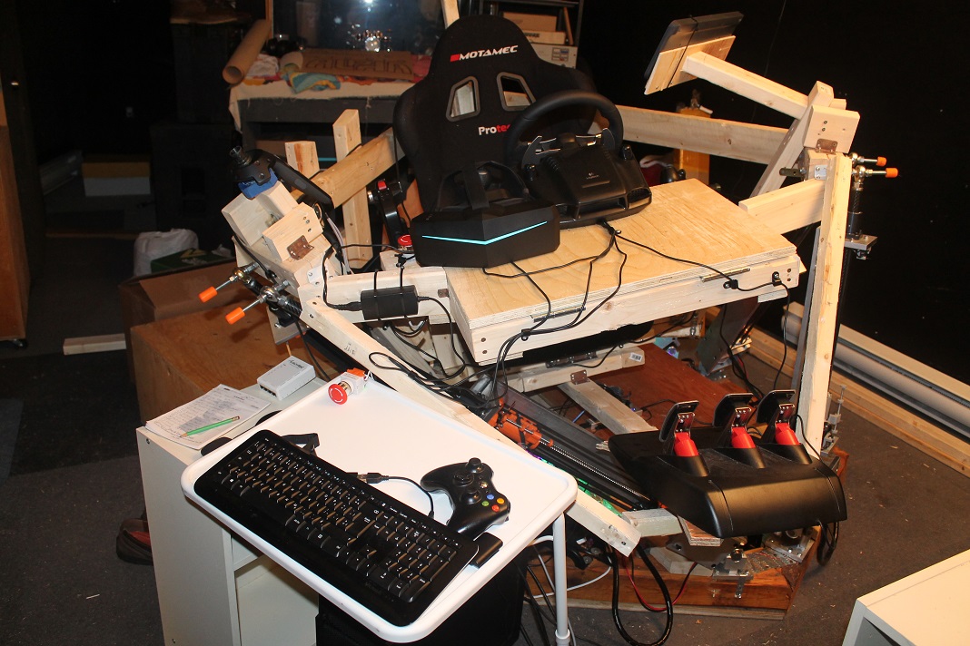

    Today, I had obligation at my home town, so I have extra time on my sim.
    But first thing first, I found a use to my puck with carbon tubes.
    It makes a great Vive controller holder.
    Also, I made 2 run today.
    The first one, is an not calibrated one, that turned out to be disastrous.
    The second one as a basic calibration. It's really soft but was quite fun. Unfortunately, my back told me it was enough. You can see that I'm doing the basic fight tutorial, and I get kill like a noob at my first try.
    I could feel a bit of drift from VR when my rig was moving, but not serious enough to ruin the experience.

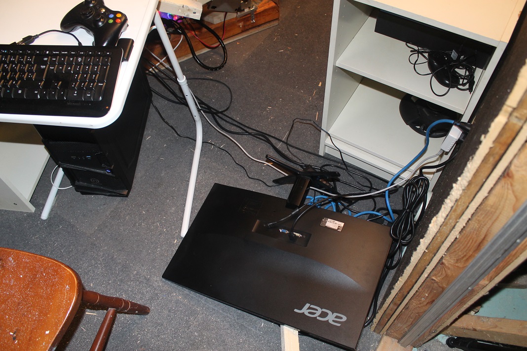

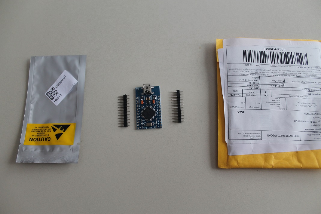

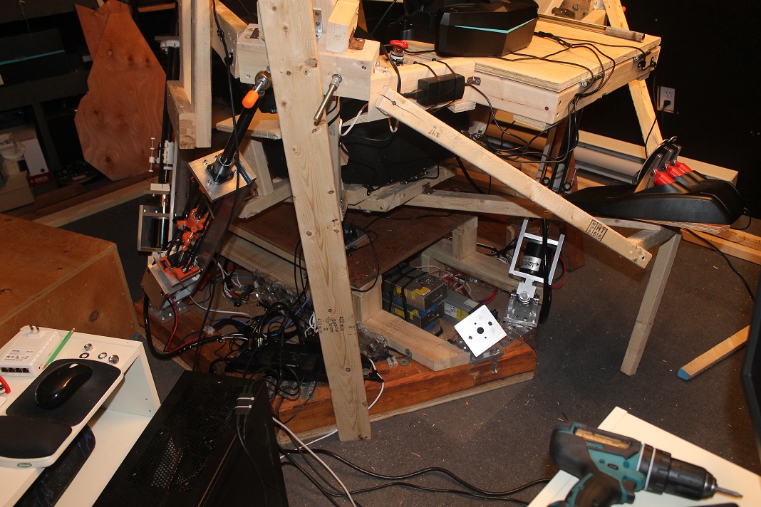

    Last week, I had another present from Santa Post.
    It turned out to be the mini arduino needed to setup my handbrake. I may wait for this one to build a lighter platform before adding more stuff on this one, since I don't control it much yet.
    The link to the tutorial so I don't loose it (as usual).

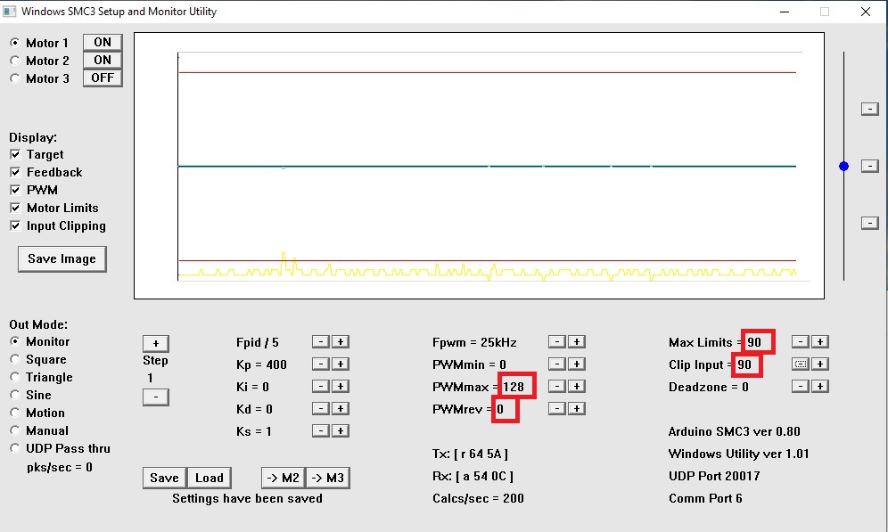

    Another thing I did last week, is to set up my SCM3 as I think I should. No certitude (as usual). First, I got my actuator near the limit switch.
    Then adjusted SMC3 to stop the motor if it goes to that point. For me, the value of 90 was the sweet spot. I also removed the reverse power as it was pushing my actuator the other way to the end every time it got lost, but it kept on doing it even after. So, I might as well put it back. But the main thing, is that I slowed down my motor by half.
    Okay, I know it can give me wrong result if the motors are not fast enough. But I won't be worrying... less be worrying about destroying my rig. I can always push it more later.

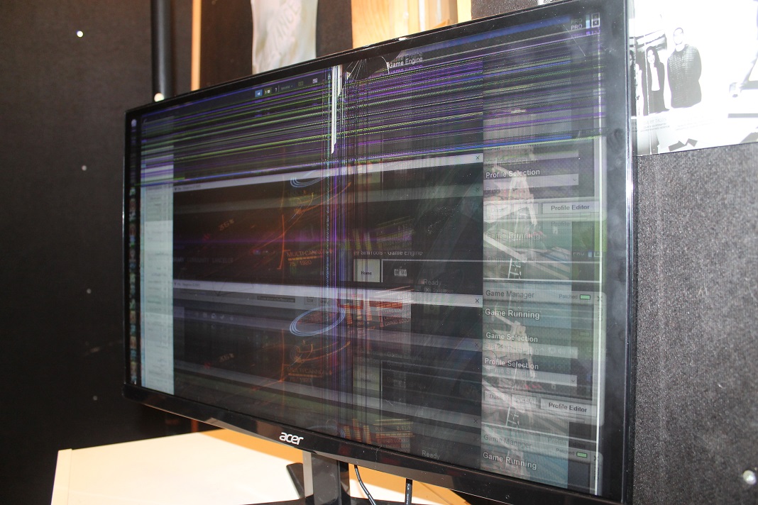

    Talking about pushing it too far. I added more range to my actuator in Hexapod. Two things happened. One, is that I got to the limit switches and all when down. I hit my litte table, but luckily, my computer was far enough. Man, it was a pain to put it back up.
    But, my monitor (the second thing) was not so lucky. I forgot to push it back far enough and it was pushed to the ground. I did not notice it until I got out of VR.
    And now it looks like this. It's never fun to break a perfectly working piece of your equipment, but, let see it this way: Nobody got hurt. It only money (me still crying) and it can easily be replace (while I still cry).
    Luckily, I had another one laying around not doing much. So I replaced it with ease. I made sure it was far enough this time from the rig.
    If I had knew, I may had wait before buying new headphone. But that's the beauty of it. You never know what's going to happen.

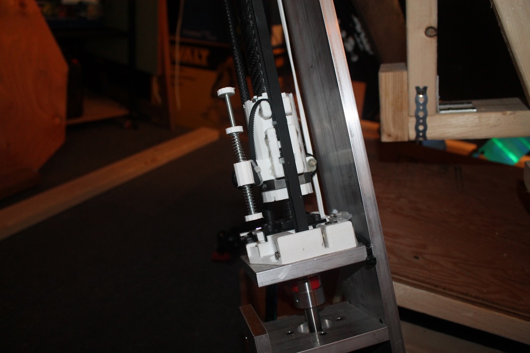

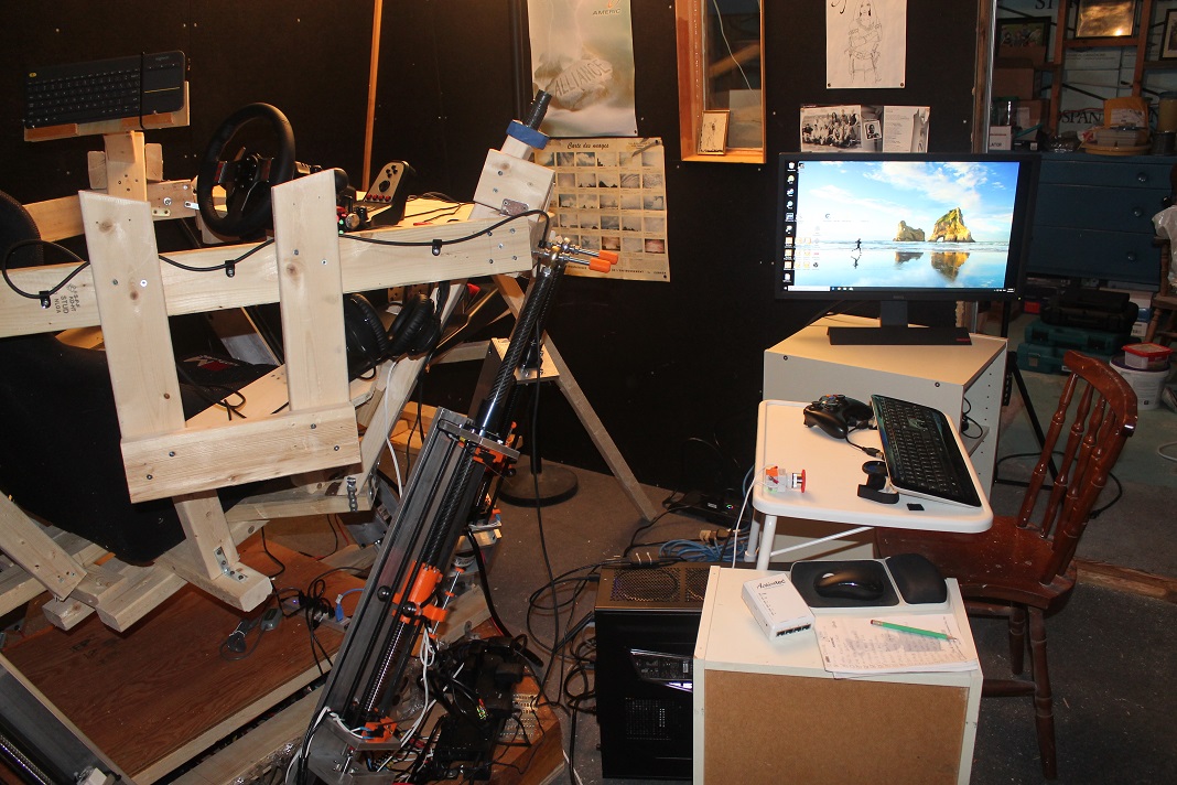

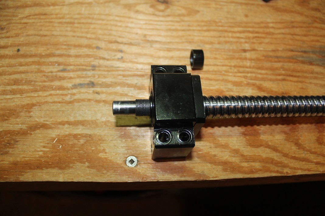

    3D print can be tricky too. It took me a few months to get it to a working state, which halted my rig construction, which got me in a high state of frustration at the time. But it was a necessary evil, and now I'm glad to have it as a tool.
    Also, just like you @hannibal I have a problem with the spacer in my balljoint holder (how do you call that part again?). So...
    I broke it again:
    That thing must wake up in me some sort of masochism because it keeps on giving me troubles, and I come back to it every times.
    The screw stripped again, because it does not have enough to screw on.
    This is when I though about the spacer problem that @hannibal had with his 1605 ball screw. I checked out if I had those spacers. Indeed, I do. So I went to my mechanical friend to get advice. Luckily, he took the time to tell me that those space where dust guard and on the side of the ball joint, it was not a necessity. He even told me that mine was loose and not doing a really good job. So, he advise me to remove it altogether on that side and add 2 screws on the other side.
    Now, my problem is that I don't have those extra screws. Should I order them and leave my sim down for now? Remove all spacers and run the rig on only one screw? Where do I get those?
    Back to the never ending asking yourself what should I do now?

    Just found and ordered the lock nuts.

    it was called a bearing block..
    i debated on removing the spacer to get alot more shaft for the couple to clamp on , but i left it in because i felt that the spacer allows the screw to sit on the inner ring of the bearing, in a manner that isolates the screw from the bearing to avoid premature main bearing failure... along with that, i felt the combination of the two spacers and two bearings inside the bearing block gives more line up for the screw (less wobble).. but that is just my theory..
    i have feeling that locknuts not going to cut it.. those nuts have a setscrew on it.
    i feel that after getting more shaft by removing the 9mm spacer and installing a 7mm spacer instead, not only gave me more plum coupler clamping surface area, but also more thread for the nut to screw on. but i think that setscrew locks in the nut, along with the plum coupler butt against the nut prevents it from slipping out..

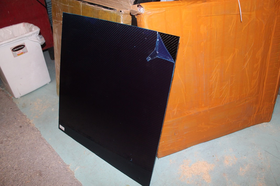

    Anyway, this is why I feel like Chrismas:

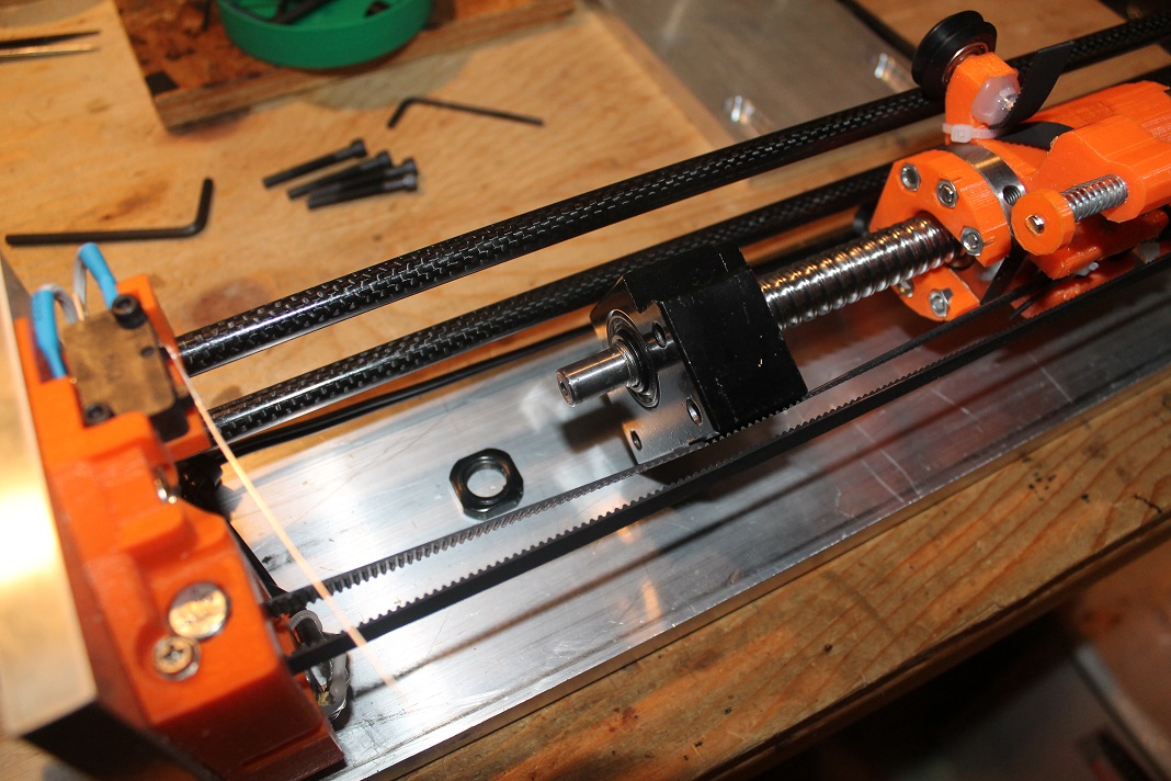

    My carbon fiber plates. Those are so thin they feel like glass. I want to use those to reinforce my structure. But I have no idea how to cut them, how I will assemble them. Man, I am asking myself so much questions, I feel like I'm going back to when I was building my rig for the first time. For now, I will keep on with the wood structure until I learn a little bit more about carbon fiber. I have 10 of those, at 75$ CAD a piece. I let you do the math.
    But since I did not received my locking screws, my wood rig is still down, leaving me with not much to do. So, I print parts that will be needed to provide a little more space for the coupler, because the end rod goes way deeper in it without the dust protecting spacer. Now, there is almost no space between the motor rod and the 1605 rod.

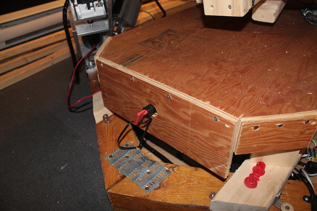

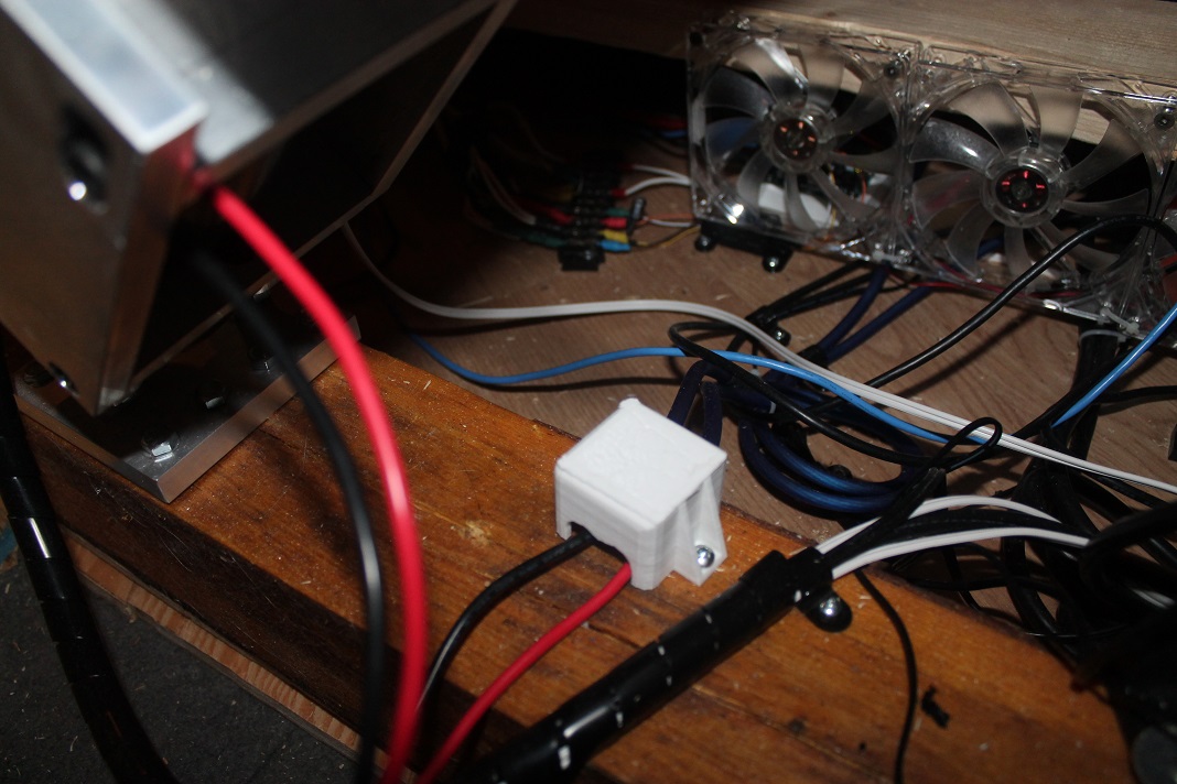

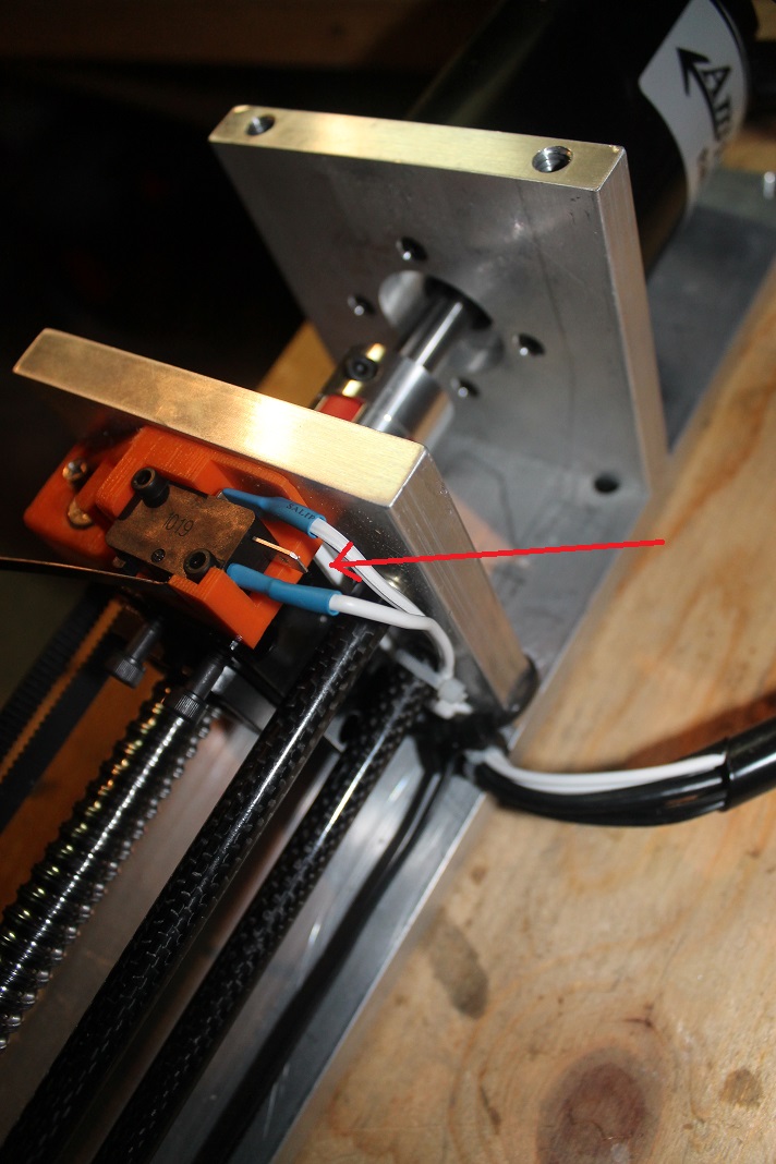

    Also, I printing part to protect against the hi power connectors that are used for the motor. Security above all!
    And I'm doing things I never had the time to do properly, like fixing my kill switch.

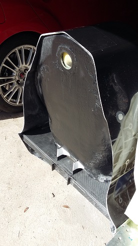

    @SeatTime should be able to give you some hints how to cut carbon fibre stuff. As far as I remember, he even has the equipment for building such material himself.

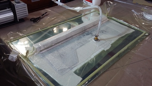

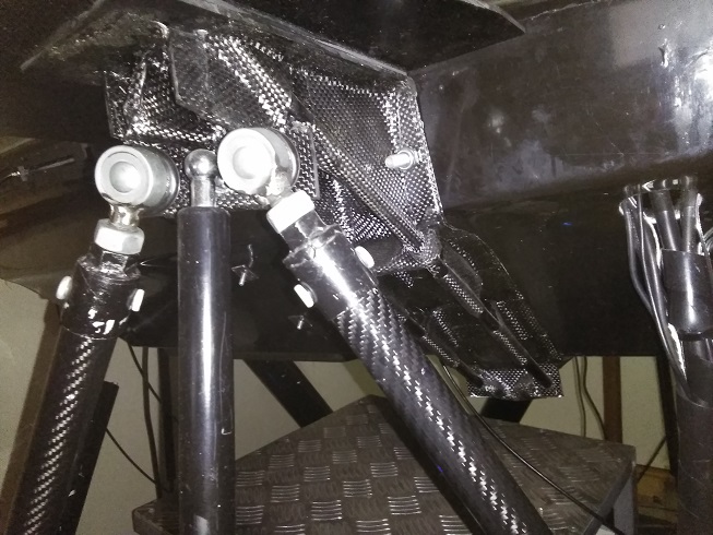

  15. SeatTime
    2,572
    +2,854 / 40 / -0

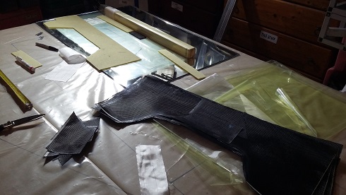

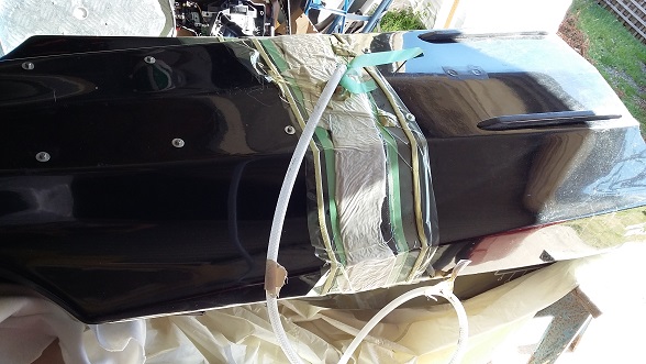

    I would not know were to start....Working with Carbon Fibre can be a bit of a art form, with allot of specialist consumables and hardware required. Note: the complexity of the parts just to build the cradle for my latest sim (see below). It can all turn into a wet noddle if you don't know what you are doing. Of course not impossible for a newbe, as there is allot of information available on the net, but the required learning curve is great and you will likely make allot of mistakes in the beginning. Depending on the requirement, you often need to play a balancing act of special foam core and carbon fibre cloth and rods, all molded/cured under a high vacuum. They do run courses for this stuff. Why so much carbon plate, what does you design look like?
    With carbon rod/plate and more cloth added and bonded. Lots of forces need to be managed here in a motion sim.

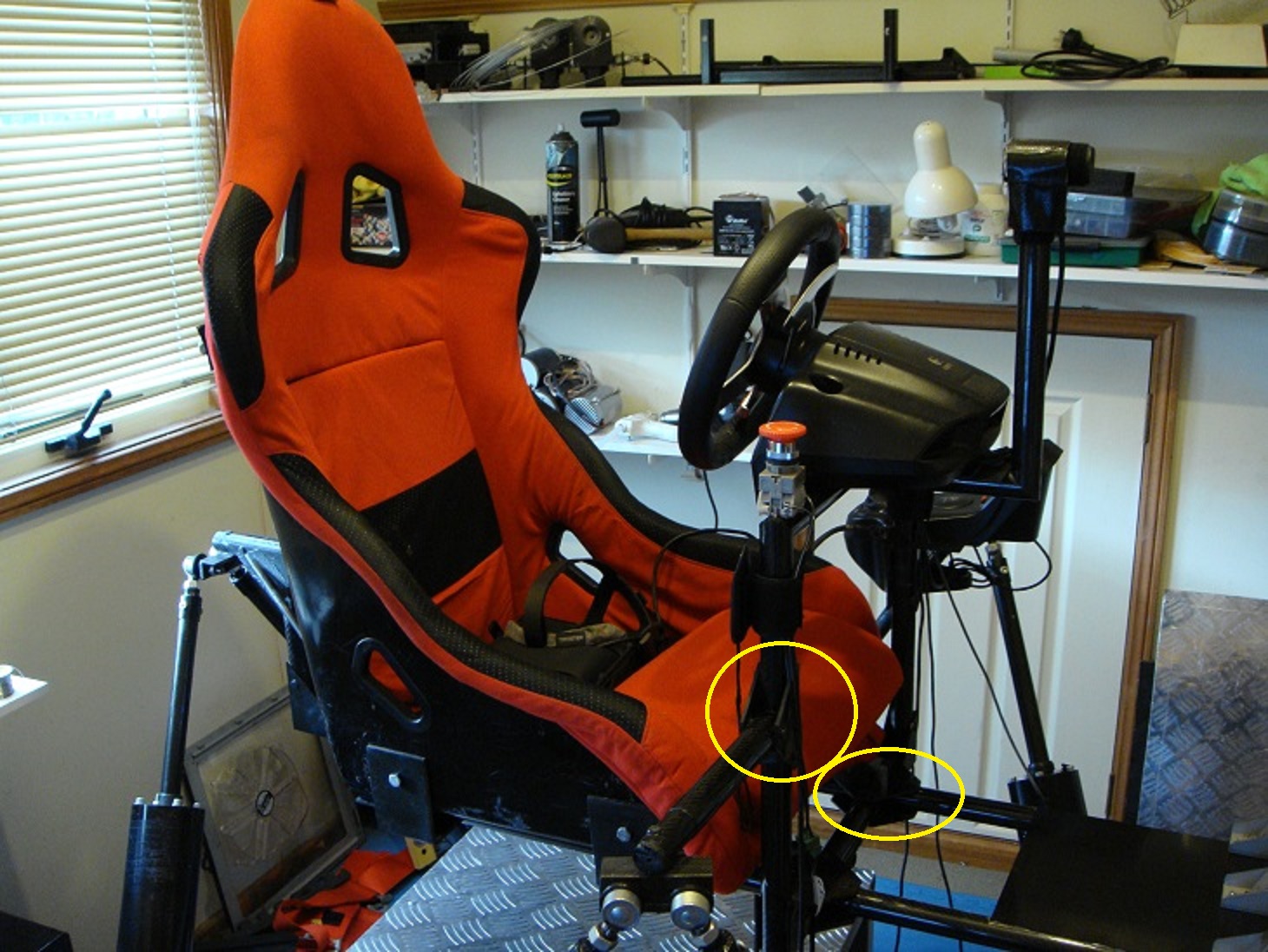

  16. Pierre Lalancette
    Dec 11, 2016
    1,012
    Tech Artist
    Quebec, Canada
    8,052Coins
    +947 / 6 / -0
    3DOF, DC motor, Arduino, 6DOF
    Thanks.
    I have not intention in making part out of carbon sheets. I want to make a structure out of tube and assemble them by making corners out of my plates. A bit like you did here:
    I also want to use some of them to make platform for joystick and wheel. This is why I ordered so many of them. Maybe it's my first mistake to have so many...
    They are 3mm. I don't know if they are strong enough to make the corners. I wonder what tool should I use to cut them. Do I keep it simple or do I experiment like crazy?
    I did not ask any question before because I did not want to abuse your knowledge before trying to get some info from the net.
    I have no intention in deep carbon fiber manufacturing. All should be made out of tubes and plates.

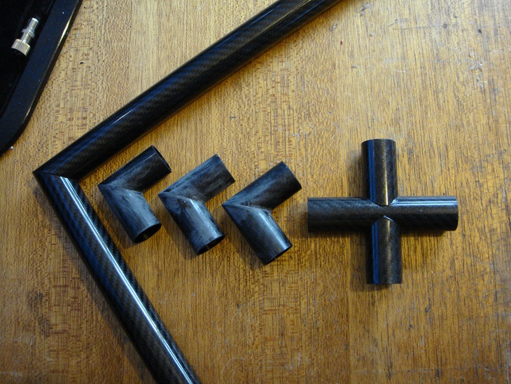

  17. SeatTime
    2,572
    +2,854 / 40 / -0
    I mainly use a angle grinder with a thin cutting disk for stainless steel - don't forget your PPE!!. With my full carbon rig I first made connectors that slid into the larger tubes - note the connectors were carbon fibre filled.
    Once I had the basic shape built,
    then started to re-enforce all joints with 3mm plate which were 'pinned'/bonded with 10mm carbon rod.
    Also later added 10mm carbon rod bonded into 12mm tubes at strategic spots to make the whole thing more ridged (best seen in this video).
    There were also some bespoked items made out of moulded carbon that were used to connect the actuators and seat etc. The rig without the seat, steering wheel etc was super light at around 2Kg.
