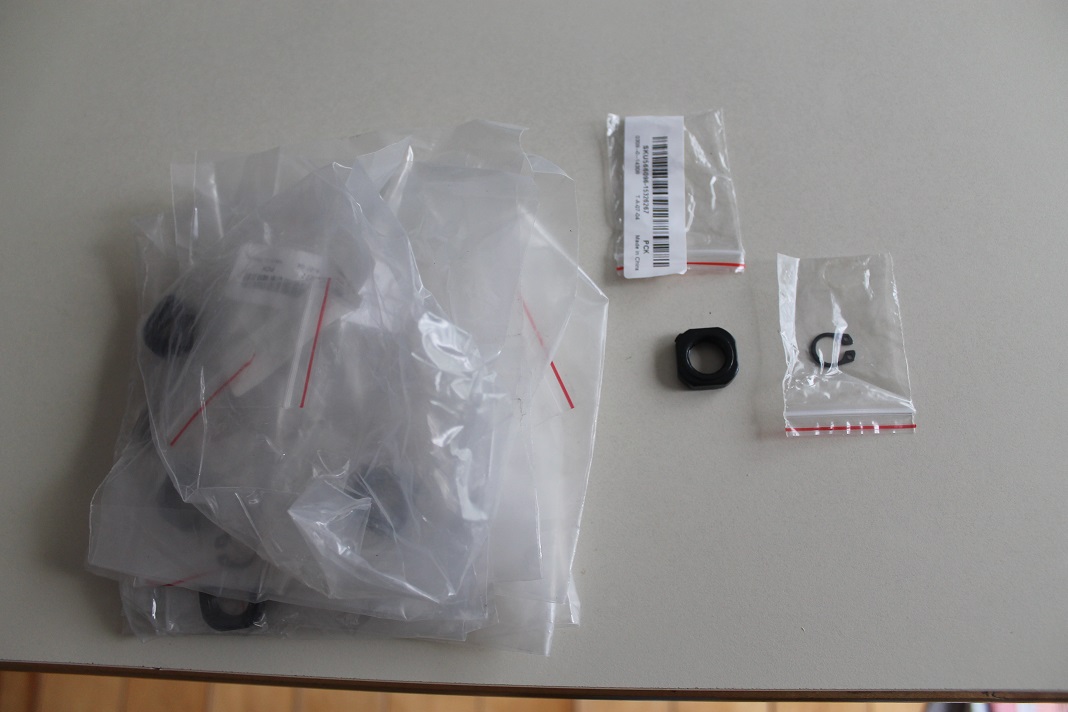

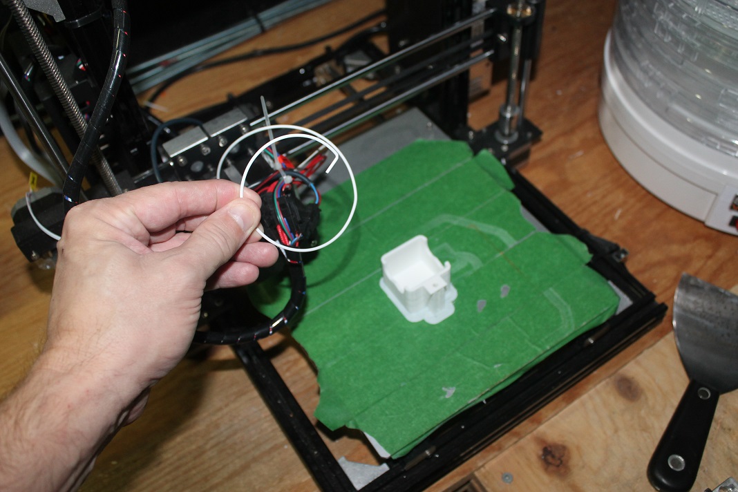

    Well, you are in it @Fiberop . :)
    28 pages of it.
    I have put most of the things I used in the first post of this thread. It's already 2 years old, so, many things have changed since.
    There is no specific plans and measures, just all the experimentation, errors and trials with some victories once in a while.
    Let me give you a hint on what type of update you will find in if you go back a few posts behind.
    It usually start with some goodies coming from Santa post office.
    This is only to build some suspense, some excitement! The tension is at its maximum and nobody can bare the wait anymore. We have to know what's inside.
    Lock nuts! Now we know. But that's not all. I reveal what I used them for.
    I used them to correct the holding part of the ball joint screw bar (refer to earlier post to know what was the problem). Now, everything should hold in place.
    Now, I add something trivial, to loosen up the atmosphere. Like that when my last motor connector finished printing, I had only about 20 cm left of pla. My god, what a trivial incident!
    And to finish the post, I try to go with a bang! Something unexpected. Making people wanting more and lure them to come back. The cliff hanger method.
    Something like:
    I got fire last Friday. They abolished my job and I am unemployed now.
    So, no more going far away on the week, until I find something else.
    This is why I can correct 2 of my 6 actuators on a Monday evening.

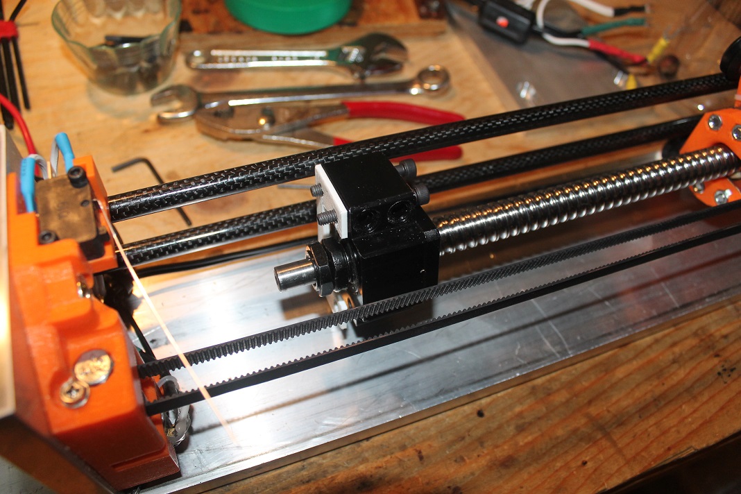

    Hi @Pierre Lalancette not telling you guys how to suck eggs as they say , but one thing I picked up on recently, Even Though it means i'll have to pull all my actuators apart as preventative measure.
    I noticed was the 4mm Grub screw that was fitted to the square Ball-screw locking nut was missing !!!. seems ya gotta use some sort of thread locking Compound to secure it .. on my test actuator I was wondering why all of a sudden there was a lot of Axial play through the ball-screw assembly .. so when I checked, I found that screw was now missing grrrrr ..
    Luckily I had a spare But Now it means Checking all the others to make sure that (a) they are still Tight , and (b) i'll need to refit them anyway this time with Thread locking Compound of some sort .. this titbit of info might save someone some grief but just mentioned as a lesson learnt by me .. :)

    @wannabeaflyer2 : I'm not sure we are talking about the same lock screw, but I got myself rid of the dust spacer guard at the top of the bk12 part and push my rod way deeper, so I could put 2 nut screw instead of only one at the edge of the thread. Now, all my 6 actuators are lock and secure (with some blue lock tight) and the rig is back up and running. See it here:

    owe man, i was going to put thread locker on the nut / 1605 screw threads.. thanks for confirming this!!
