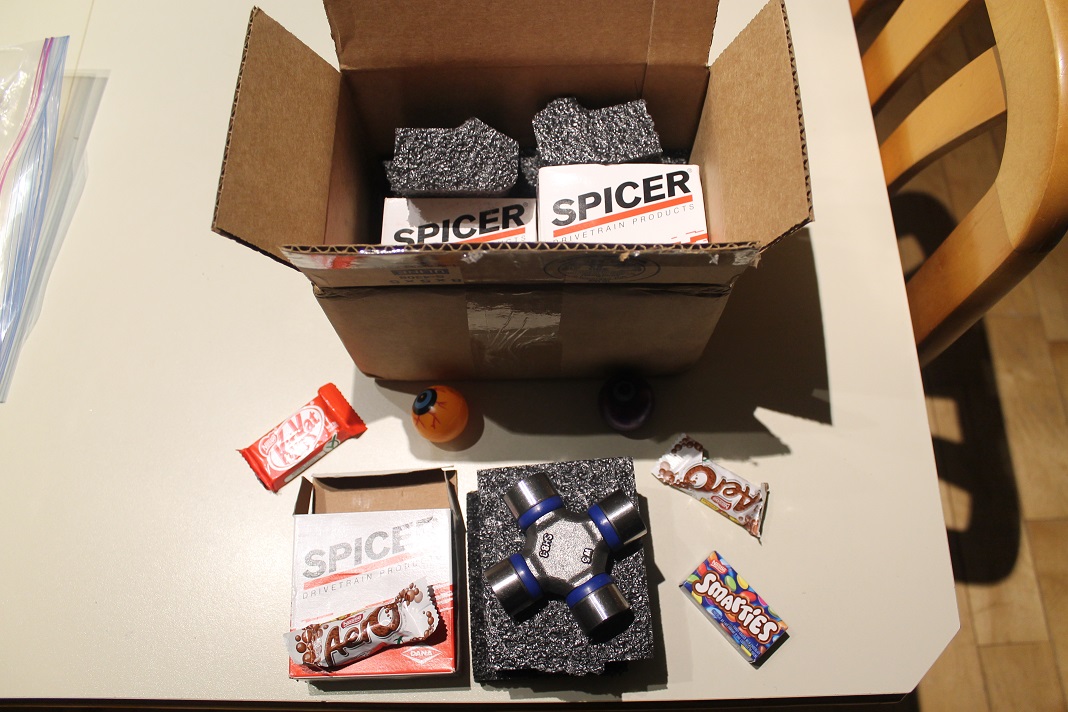

    @Pierre Lalancette, can you give us more info on the U-joints and U-bolts (dimensions, where you got them)?
    I'm going for the same design to avoid soldering / welding on the base of the actuators.
  4. llluis
    Mar 30, 2017
    164
    Quebec
    1,632Coins
    +103 / 1 / -0
    Found the info on the first page! Thanks :)

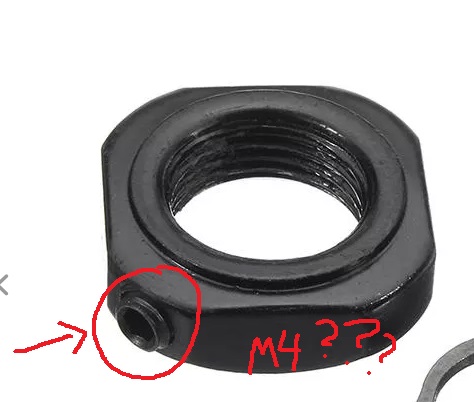

    hey @Pierre Lalancette do you know the size of the setscrew / grubscrews? i like to order additional grubscrews and try to drill and tap the nut so it has two grubscrews instead of one... i took existing and used micrometer.. looks like i assume a M4 x 5mm size grub screw... maybe @wannabeaflyer2 you know the size of the grubscrew for the screw nut so i can order?

    the nut is M12.. but the setscrew is M4 (i think).. i just wanted to confirm with you.

    The Allen key says 2 mm and the screw diameter is 3.9 mm. So, I guess it's a m4 indeed.

    Hi @hannibal Pierre has already beat me to it and I agree its an M4 Set screw / Grub screw (depending on Country terminology ) . been on Holiday so now back to business here again :) But not sure if that 12mm nut is hardened or not if that's the case it may be difficult to Drill and tap the existing part as pictured above ( but don't quote me on that as im not in the man cave)

    I have always also applied 'locktight'' to the nuts thread.

    i was going to try to add a second grubscrew and also threadlocker liquid.. i havent tried to drill it yet, so i will find out the hard way.. but if the threads stripped from @Pierre Lalancette 's experience, maybe the nut is not so hardened...

    I used the blue one, because that's the one I had. No scientific reason.
    Since I use 2 nuts, I had no issue (yet).

    When in doubt use blue first because red could end up being permanent.
