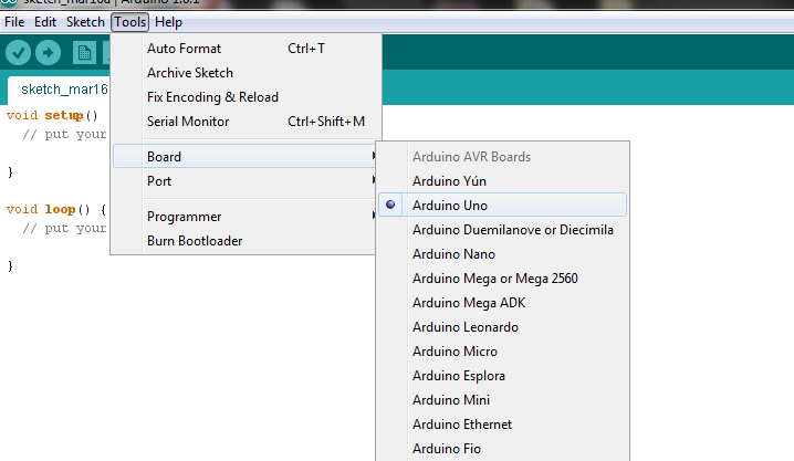

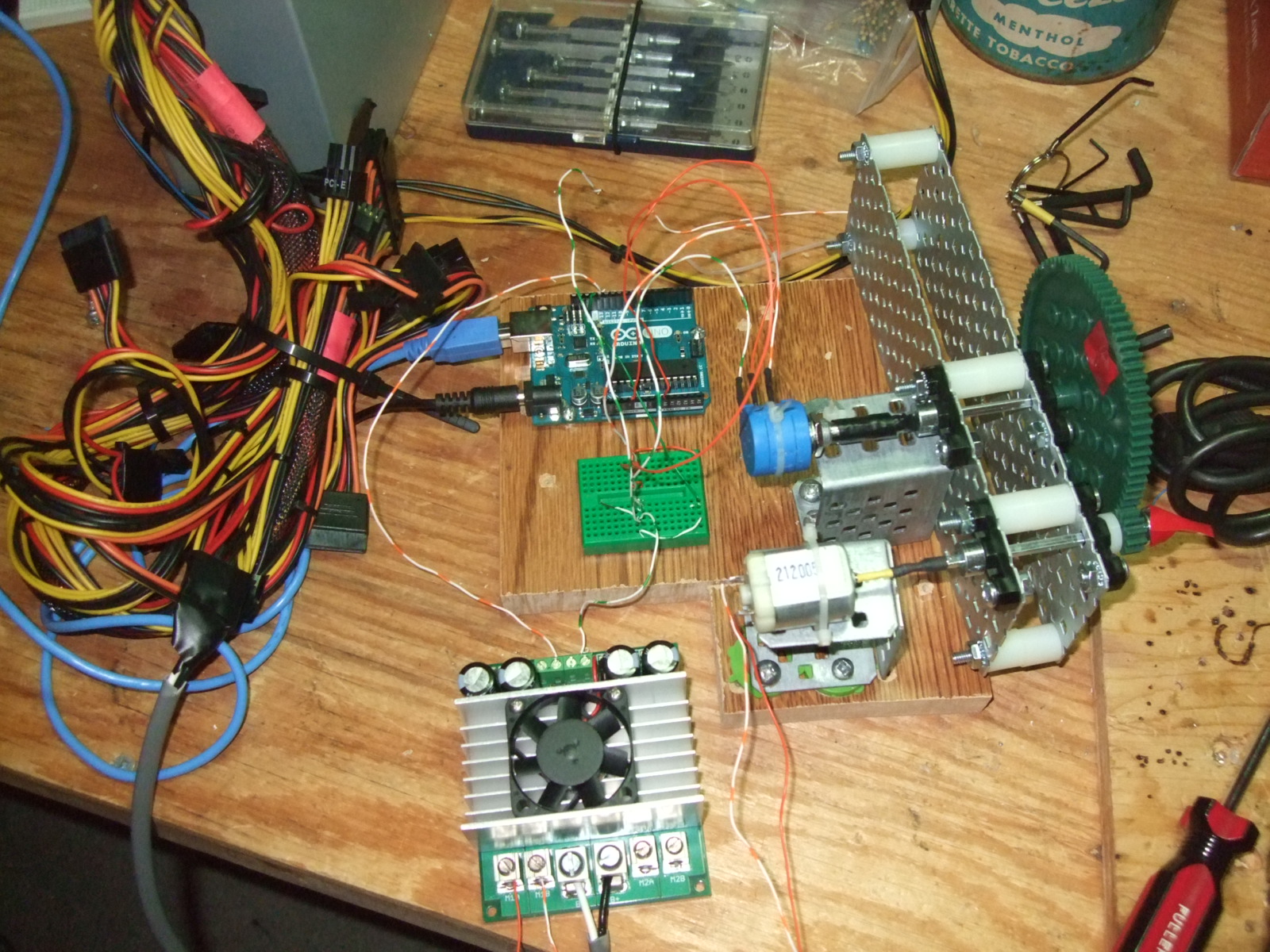

    Hello everyone.
    I tried to make some movement with a small motor connected to some gears and a 10 turns 10k pot. I tried to make it move with SMC3 driver for my arduino Uno. I did the tutorial, followed the steps. The Arduino seems to be connected as it flashed all the way. The sabertooth 2x60 turns it fan on power up and stopped it every times. When following the SMC3 tutorial`s 25 points, I got stuck on 2 of them:
    SMC3-SPS Sabertooth Packet Serial PID motor driver w/SoftStart
    Point 8: Make sure you choose Uno or Mega and to set the comport number.
    Where can I make sure it use Uno?
    Point 16: Click the ON/OFF button for motor 1 to ON.
    It does not stay at ON. It switch right back to OFF. Probably the serial time out. So I tried to set it off by connecting pin 11 to ground. Did not change a thing. I am stuck there, with no movement.
    My second attempt was to use XPID_simtool_3.13. With some help and a few change, I could get it to compile and send it to my Arduino Uno. I made the wiring and try to communicate with it using sim tool. But since there is not much indication on how to use it, it turn out a complete failure. Not even some led flashing on my Arduino during axis manipulations. Even less any motor action.
    I tested my motor at the end, in case. Still working.
    I did sense some small move in the motor once ore twice with SMC3 at start up. But nothing controlled.

    see the following pics to change borad and port in the arduino IDE
    SMC3 has a feature that disables motor when they are out their limits.pot has to be inside the limit zone to be enabled again otherwise they will remain off

    Ok, in the Arduino program. I was searching in the sketche. It was set correctly.
    Out of the pot jurisdiction. It does make sense. Will check this weekend. I had set it to the middle (5 turns out of 10). There must be a place to set the pot's value and if it is linear or logarithmic?

    the only file you have to change com port is in the SMC3Utils.ini
    as far as i know we don't have to change anything in the sketch for the pots and i don't think there is a need for logarithmic pots as we want linear feedback.

    It hit me when I was looking at other potentiometer. The pin out is not always the same. All diagram shows the output coming from the center. It was not the same for my pot. Now, I can make it move smc3 utility software.
    I tried with simtool, but it did not work. It's late. I will look into it later.

    I finally got it working with Simtool. I had forgotten to put the Output-Type to Binary. It works great. It is so fun to see the motor follow my bad driving in Live For Speed.
