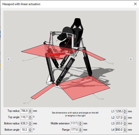

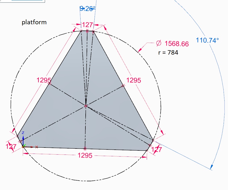

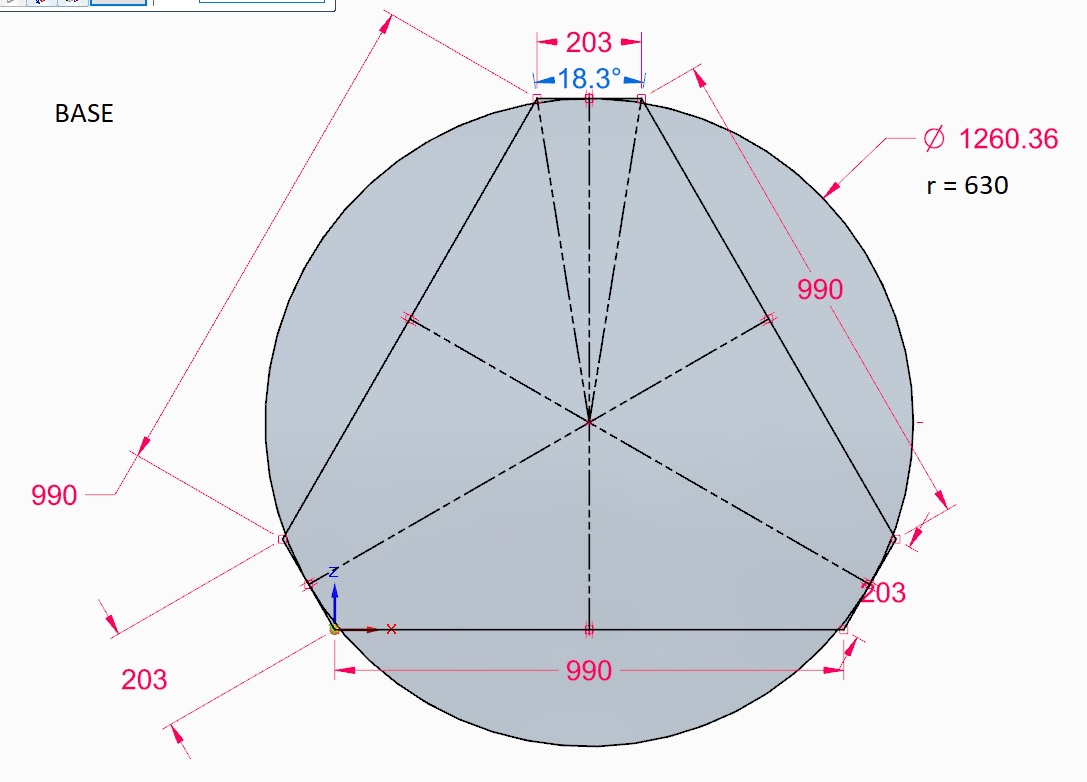

    Saving for future references.

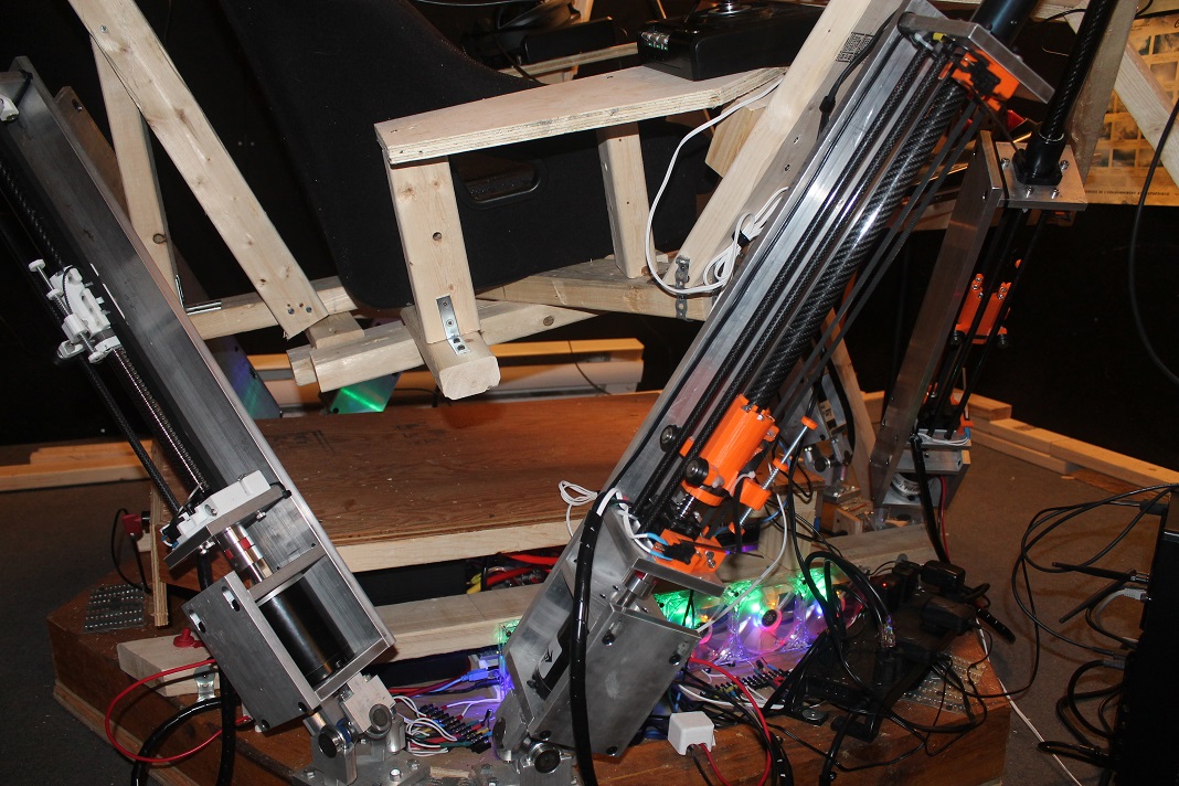

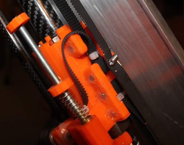

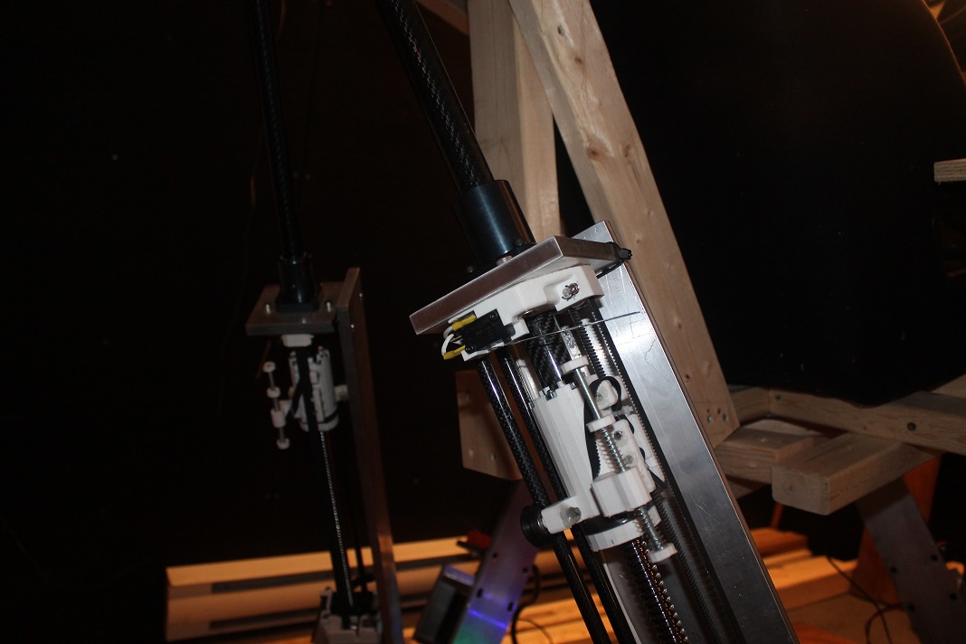

    I think I am asking too much from my actuators. Every times I use my rig, one of the actuator is skipping steps from the potentiometer strap and getting off center. After 3 hours of Elite Dangerous, one of my actuator slide this away from its center.
    No need to say that I hit a limit switch. Every times, one of the 4 front actuators gets badly synchronized. The ones that has most of the weight.
    Either my rig is too heavy (not me) or I'm asking too strong movements (or both). My carbon fiber platform it starting to be a must.

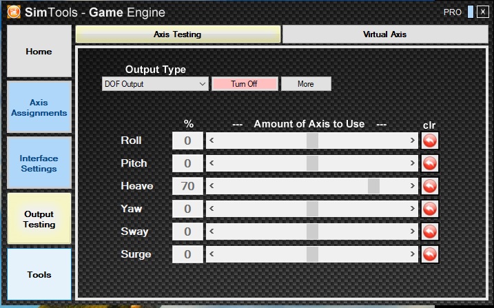

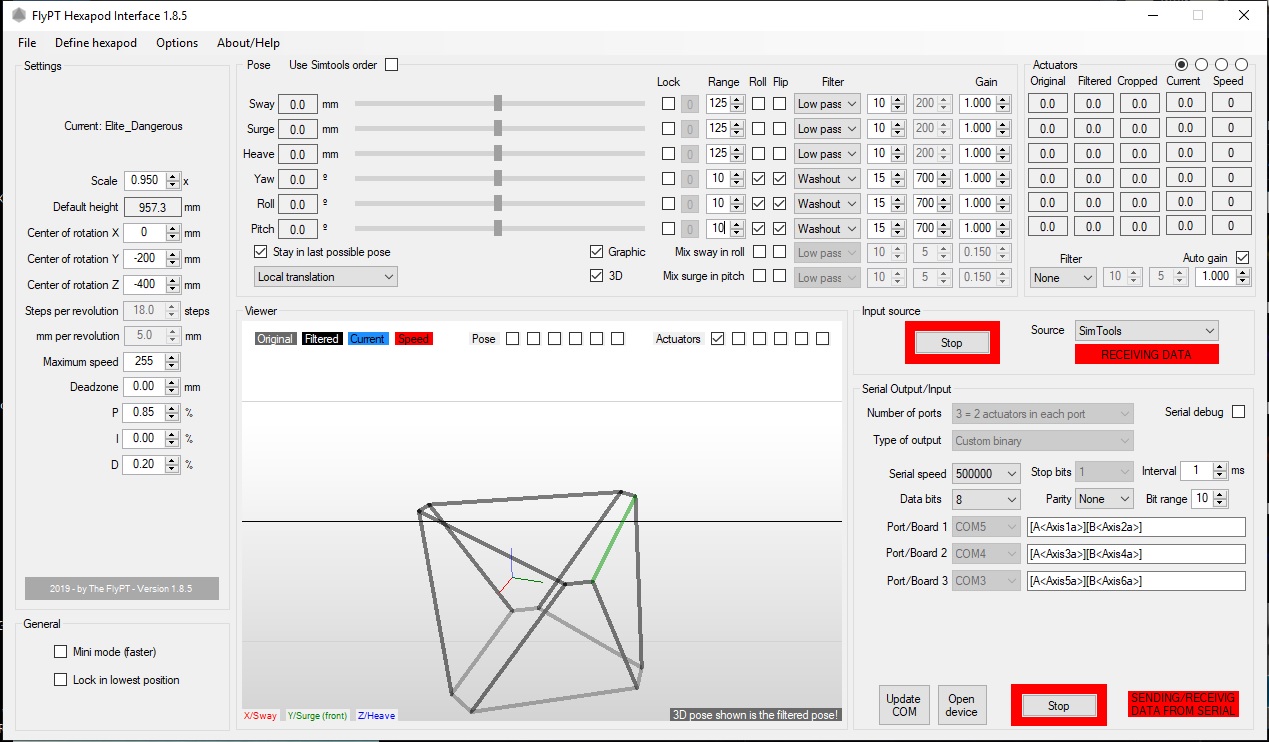

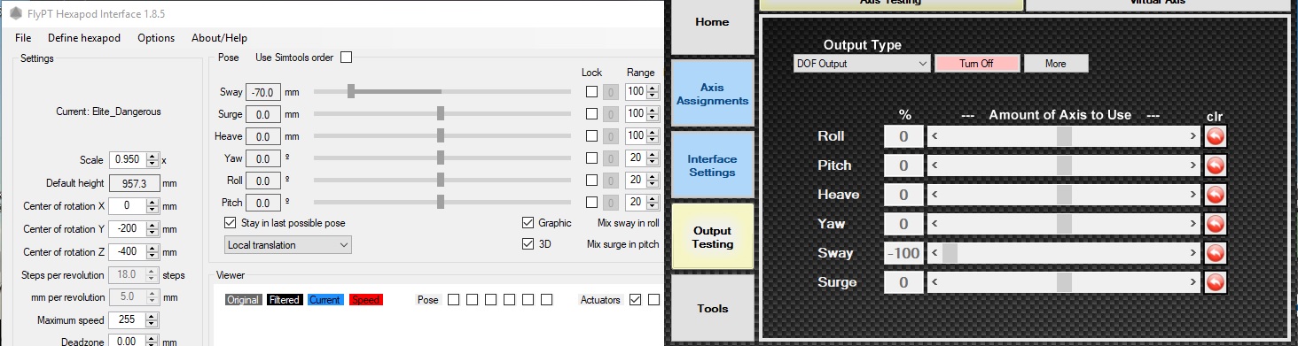

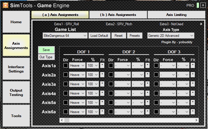

    Since I spend the last few months on calibration of my rig, I would like to share what I think I've learned, so people may benefit from it, or tell me how wrong I am. Of course, it applies only if you have a linear 6dof working with Simtools and Hexapod Interface.
    So I start from the beginning, Simtools.
    The thing that I had no idea how to calibrate was the Axis Limiting. After giving it some thought and loosing a bit or gray hair, I came up with something.
    First, I put them all back to 100%.
    After, I connected Simtools directly to my rig, no middle man.
    Then, I gave a heave forces of 100% to every axis. Giving a 100% heave force to each actuator.

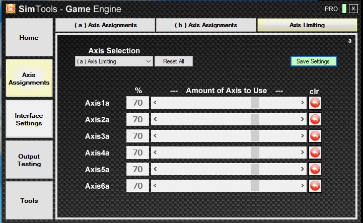

    So, when I push the heave for in Simtools, I know how far I can push it before it touches one of the limit switch.
    For my rig, it was about 70% of the heave force.
    So, I put all my Axis Liming to 70%. That way, Simtools remap the 100% of the force to the 70% of my actuator range.
    After that, a 100% heave was almost touching my limit switch.
    And the forces accordingly.

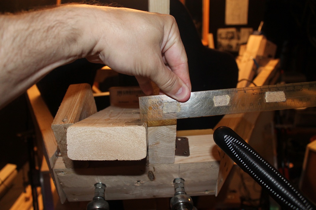

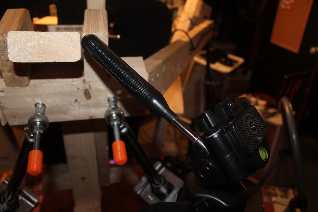

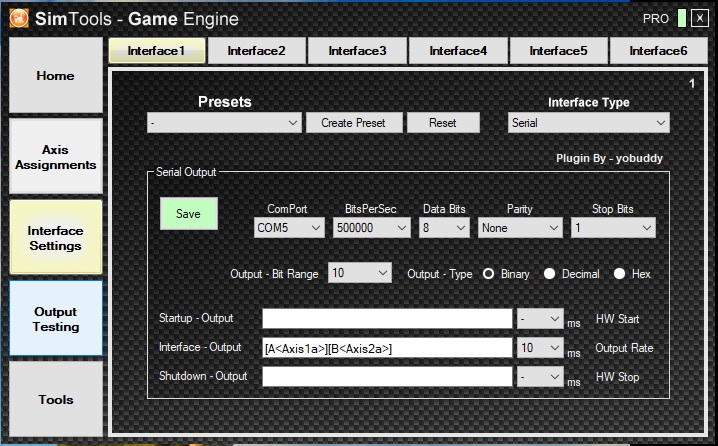

    With a sway forces at 0, I put an object (my camera stand) near a part where I will be able to measure the distance it moves.
    Make sure sway in Hexapode has no filters, that the main output is at 1 (with no filters), the Scale at 1 (okay, my scale is a 0.95, but I will explain it later) and chose a range (for me, 100mm). So, when I give a 100% sway in Simtools, it is remapping it to 70% of the Limiting Axis, giving me 70mm of distance in Hexapod.
    Then, I can measure and compare to the distance my rig traveled. It's not clear on the picture, but the distance was above the 70mm. This is why I change the Scale in Hexapod to 0.95 and get the proper 70mm of distance.

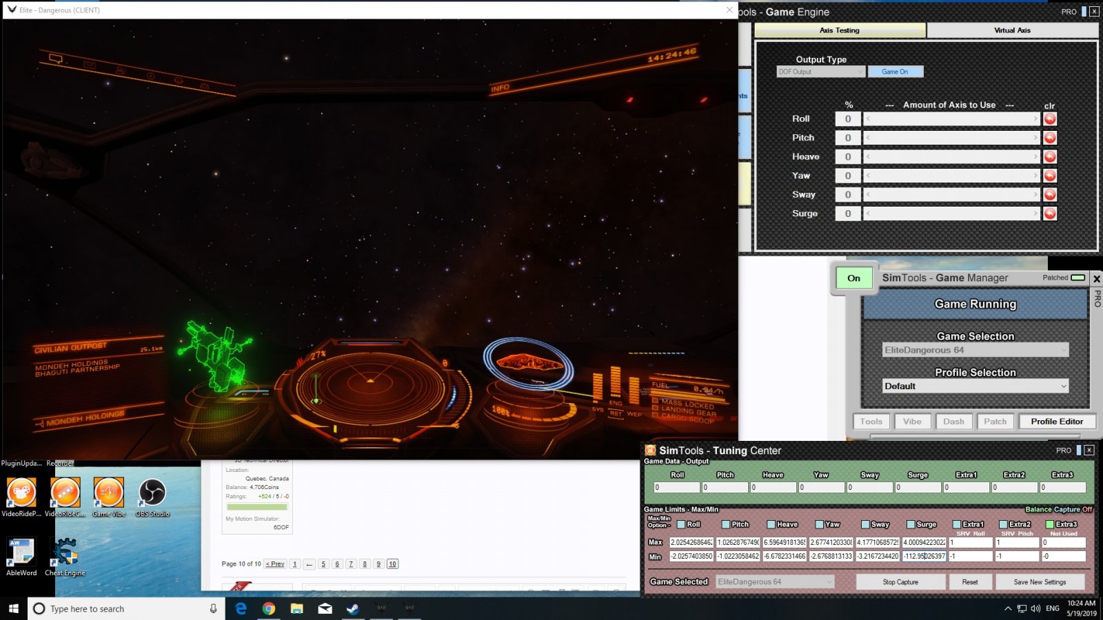

    Then I set up Hexapod for a test drive. I found out that for me, Elite was working best with Low Pass to slow down linear movement and Washout to rotations.
    Starting the game, I put up the Tuning Center, I press Capture Max Min and put the forces I want to monitor in blue. Then, I do crazy things in the game to get all forces max min. Notice the -112 in the Surge. Probably when I was using the SRV. I corrected it before saving all.
    Then I play the game, adjusting what I think feels the best.
    Hope it helps and it's the right way to do it.

    Could be, but I doubt. My straps are already quite bend. I'm even afraid that it might be too much tension on the gear, giving them hard time to turn, making the strap skip. But I suspect the weight of rig a lot more, since only the front actuators gave me those kind of problem.
    Time to go carbon. (If I say it enough times, I might actually do it. Oh! look at that sofa where I can sit my ass and do nothing but eating chips and watch TV.)

    Even with my botched gearbox for my Hall pots I've never had any issue with the actuator losing position. Weight will have nothing to do with it I don't think, your belt must be too loose or something as that shouldn't happen.

    It turns out that I had a few of those laying around. They are a bit to small for those straps (they were for my printers) but they should do the job and they won't be moving. I installed one to every actuators. Even the ones at the back that were okay and were quite loose compare to the others. I plan to change the platform anyway, so, why not try and observe?

    hi @Pierre Lalancette have to say that was a very informative post, filled with great setup info , I def think it will be a reference for me when I at the moving platform stage . ( she's still in Bits in the Other room ) So Just to say Thanks for posting this info.
    @SilentChill chill beat me to suggesting that your issue may be to do with accumulated Belt slippage over time, I found the GT2 belt does that sometimes if the tension is not spot on, we try to take some of the load from the Potentiometr spindle bearing but that in turn creates Problems with incorrect tension especially where long rapid moves occur , the soloution im heading for is a separate bearing mounted Shaft to take the Load off the Pot and then use a light weight coupler to join the pot to this shaft , that way I believe we will be able to dial in max tension without transmitting that load to the Pot Shaft.. as always Just my 2 cents worth and will add a sketch /cad drawing of the pot assembly idea..
    Im actually buying AMT103 v Capacitive Sensors which will be belt driven form the motor shaft but will not need to be under the same tension as its a small closed loop belt setup ..
    But the above mentioned idea may be something to consider . great to see you having fun with your system :) keep up the good work cos were loving it

    I tested with the tension spring, running NoLimit2. After 3 run with only one with me on it, it already lost 1 cm. I have no idea why.
    I guess putting a nail one only one side of the gear is not enough and I may have to revise my potentiometer setup.
    But for now, I started the Carbon Fiber platform. I wish I could say that everything is going as plan and I made no mess with the glue, but I'm confident that... Well, I'm not. Keep on going forward anyway.

    Make a mark on your shaft and pulley (from the top) with a sharpie (permanent marker). It seems your pulley may be slipping. Don’t know if your pot has a flat side on shaft. Other than that it’s the belt skipping teeth. You can try to mark one position in the belt and pulley too.

    I know the belt is skipping teeth. Because to repare it, I simply reposition all to center (actuator and pot), and reinstall the belt. Its the reason why that escapes me. I think that my design of using a nail on one side works to release the pot from tension. But maybe its a bit bend ans the gear doesn't turn that well, offering some resistance. I'm thinking of a new system with gears, but the platform goes first.

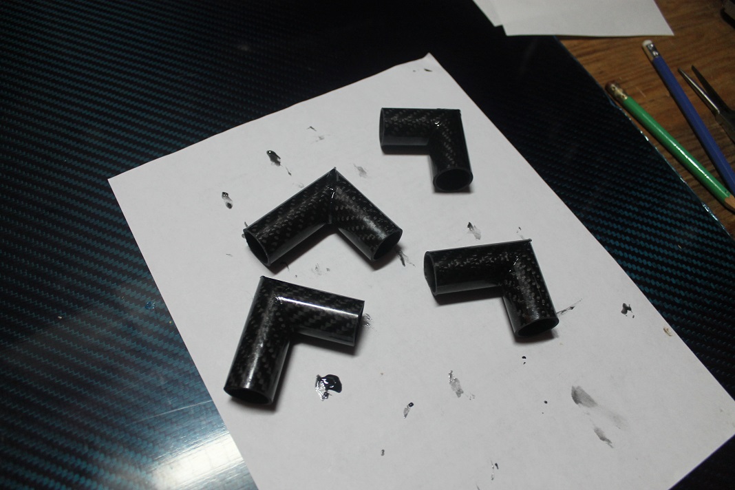

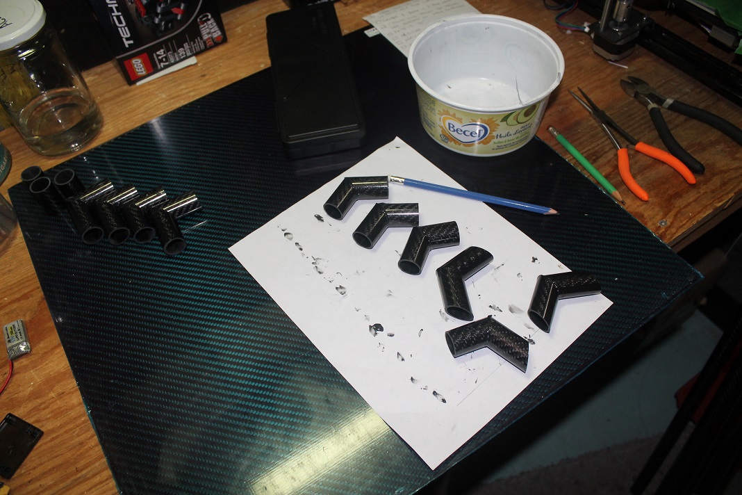

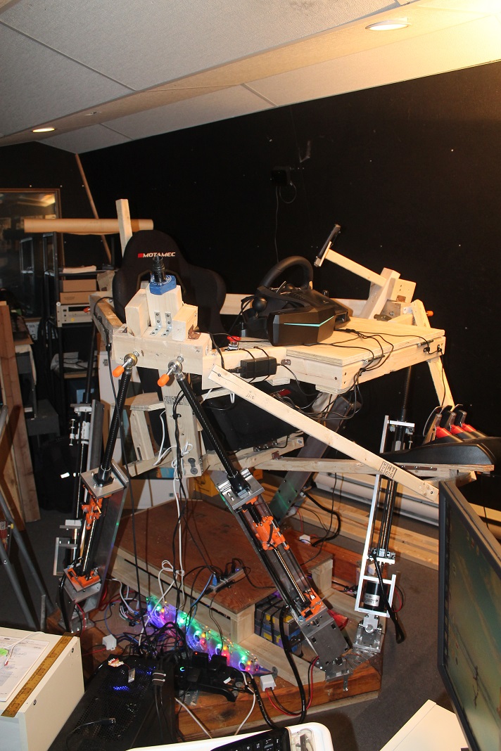

    Hi everyone. It's been a while.

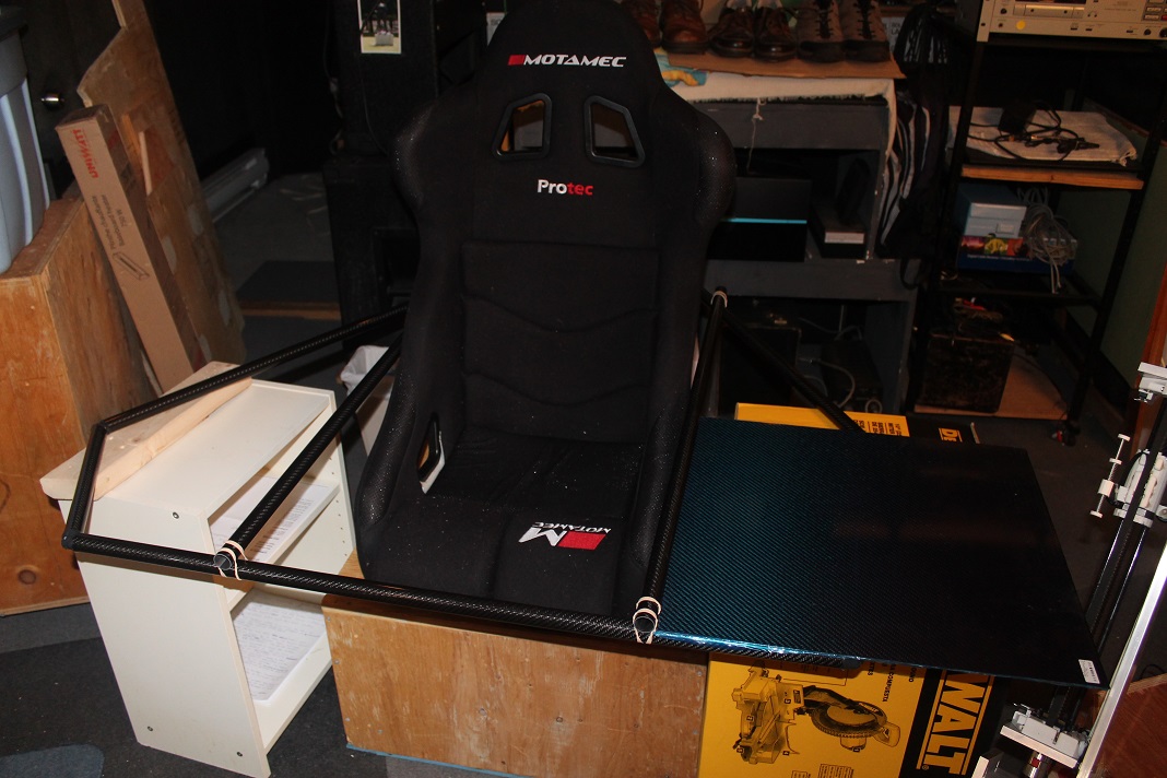

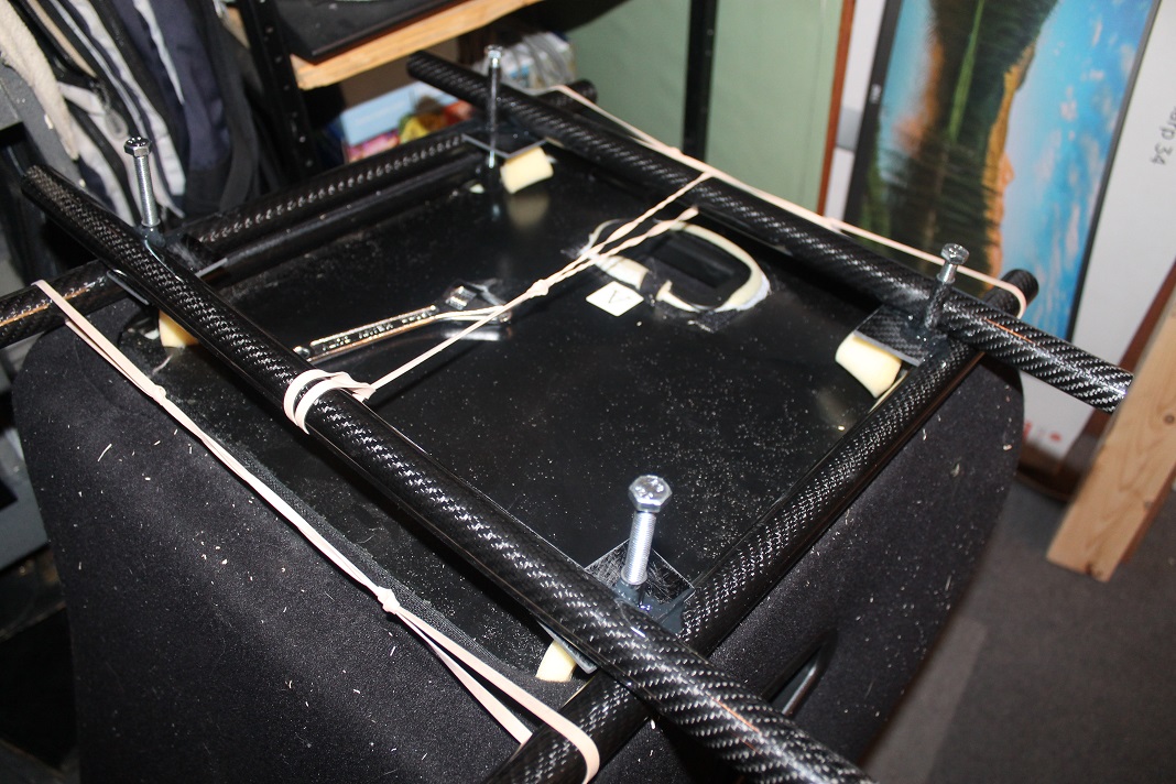

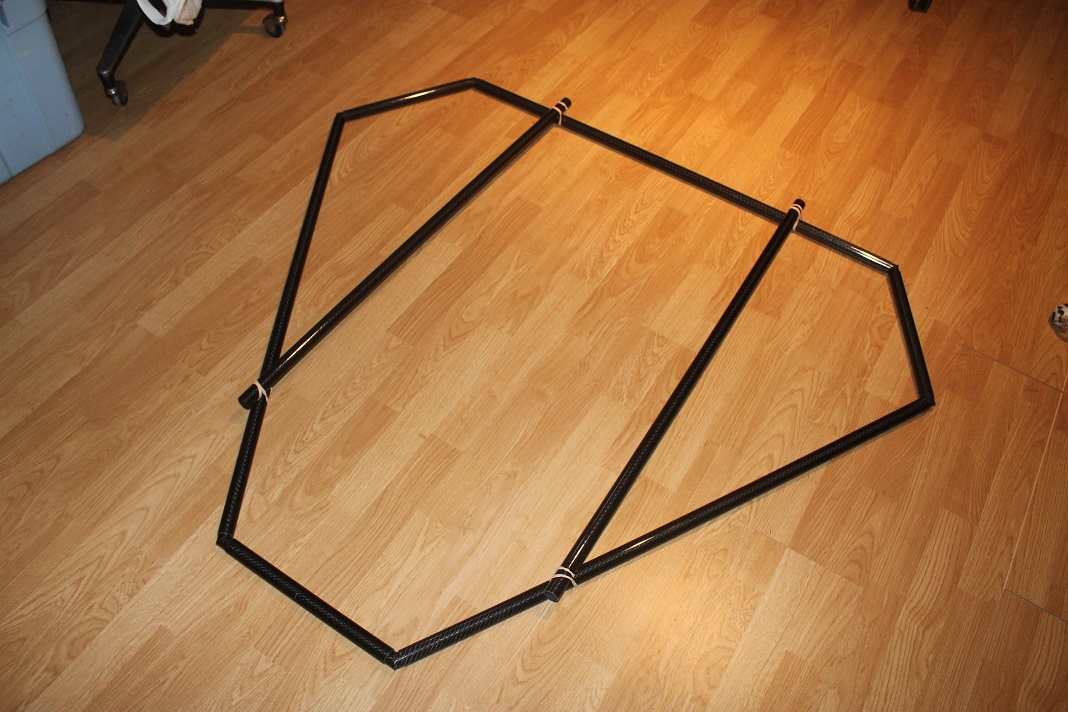

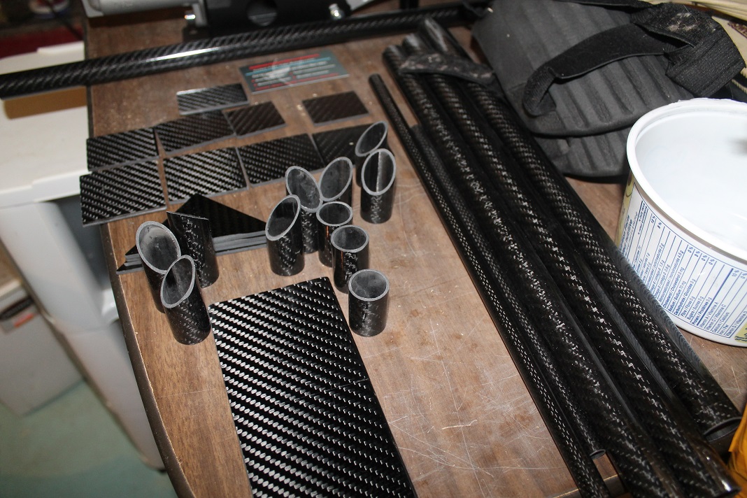

    My rig is on hold for 2 reasons. First, the seat is taken out to take the measurements for the new platform that I started. The second being that the monitor I ordered is defective and I had to return it today. It was a replacement for the monitor I took from my girlfriend and had to go back for the WII. (It's a lost argument, she wins.) I have to order a new one.
    With the nice (but ridicously cold) weather, I could set up my saw outside and replace the blade with something that can cut carbon. So I started to cut, learning what I was able to do.
    Like @SeatTime showed me, I starts with corners that wil be insert to assemble tubes.
    Even rocking those angles.
    For a nice result. Man, that thing is so light!
    The seat attachement is another story. I'm slowly finding a solution to make sure it's strong enough to hold me up in shaky situations.
    Evaluating the seat position and everything.
