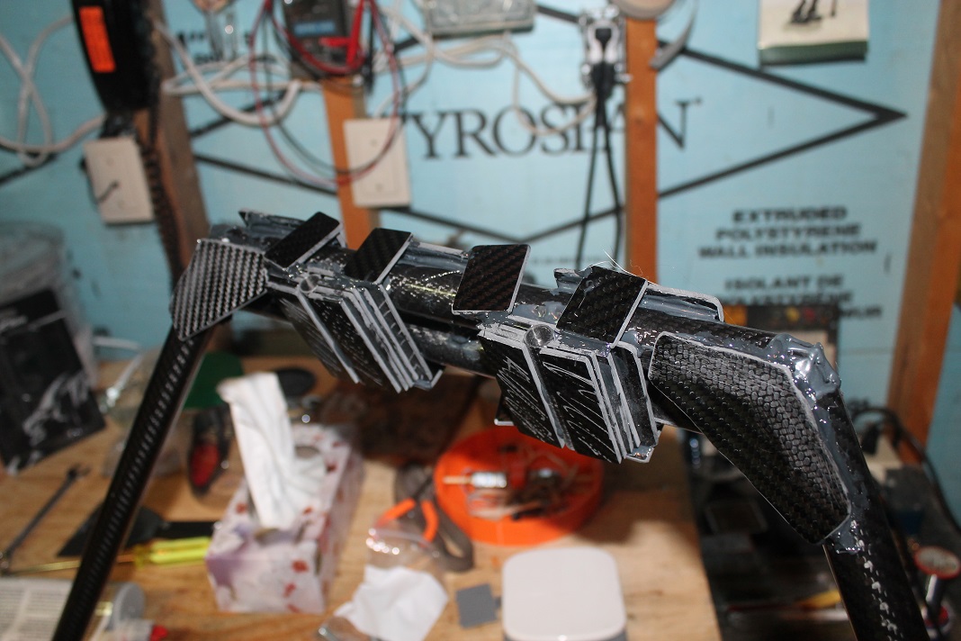

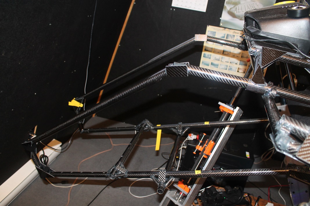

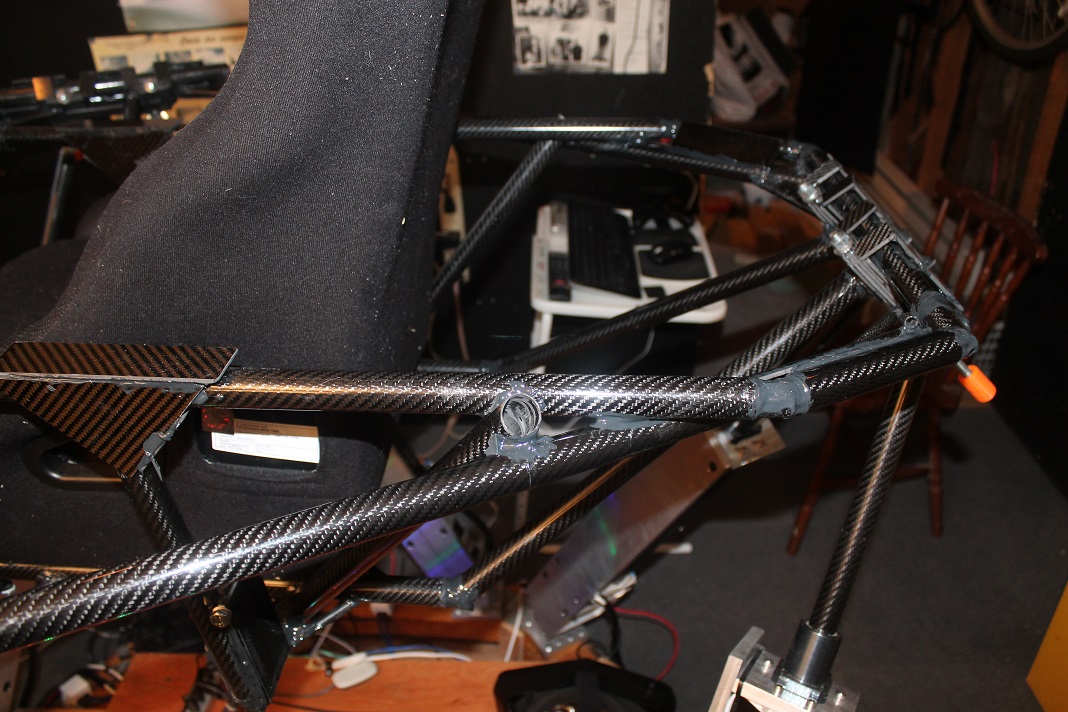

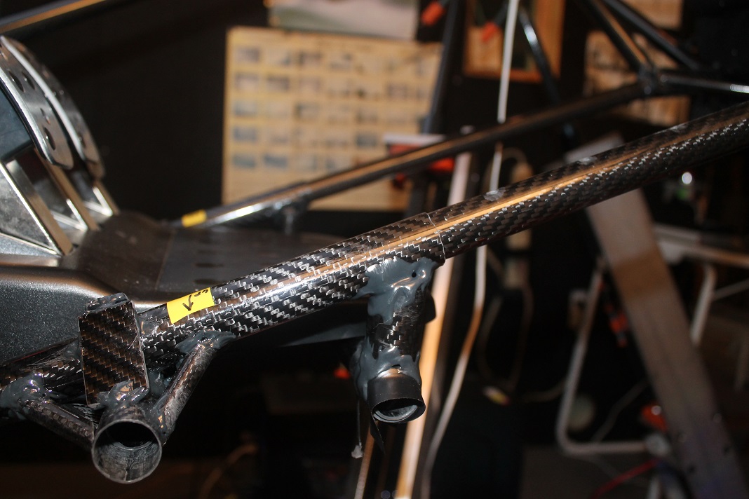

    I'm getting a bit less nervous. All seems to be coming along nicely.
    But, I haven dare to sit on it yet. There is too much reinforcements to do still.
    All is resume at design, (panic), cut, glue, wait, design, (panic), cut...
    I don't think I'll have the time to finish and test it before I go teaching at 600 km from home. It might be a while before I (try to) play a game on that thing.

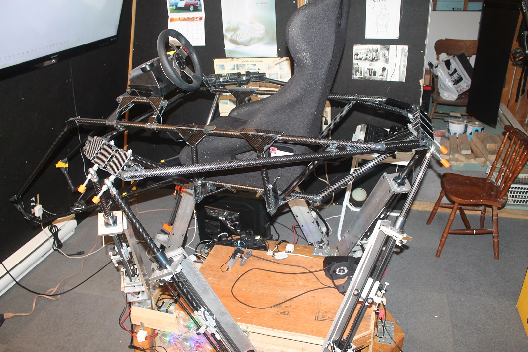

    I'm back, but not for long.
    Did you miss me? :)
    I sat on my carbon tubes platform. I made a movie of this maiden adventure in case the had to figure out how I die in my basement. Fortunately for my health, it holds out beautifully. Fortunately for your health, we almost don't see my but crack. Not a bend, not even a crack sound (pun intended), nothing. It looks and acts strong. I am pleased!
    I made another video for a closer look at the platform. Enjoy!

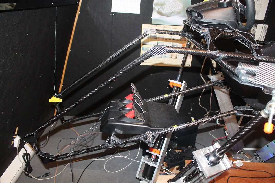

    Hi @Pierre Lalancette some really niikerce touches in this , and i like the adjustable steering and foot peddle arrangement Nice work all round -)

  8. Pierre Lalancette
    Dec 11, 2016
    1,009
    Tech Artist
    Quebec, Canada
    8,044Coins
    +945 / 6 / -0
    3DOF, DC motor, Arduino, 6DOF
    Thanks @wannabeaflyer2. Coming from a designer like you, it's quite a compliment. It's been a long time since we saw your rig in action. Stop womanising and get to work!
    I did not cranked it to 255. Something about self preservation. I also kept the values to the "don't listen to others" level. It was a nice ride and no one got shaken or hurt.
    I can almost read the sub text: "There will be blood". A video was done and no maker was hurt in its making.
    The leap of faith. The moment you tell yourself: "Here goes nothing". Luckily, it turned out good. But you can see I am not doing any sudden move. Slow, terrified and steady.
    Here is my first ride. It's so smooth compare to my wooden platform. Changes in direction are so much easier for the whole rig. Setting up the controls should be our next step. Adding the keyboard, fixing the panic button, the Pimax. All of this the next time I return... God knows when.

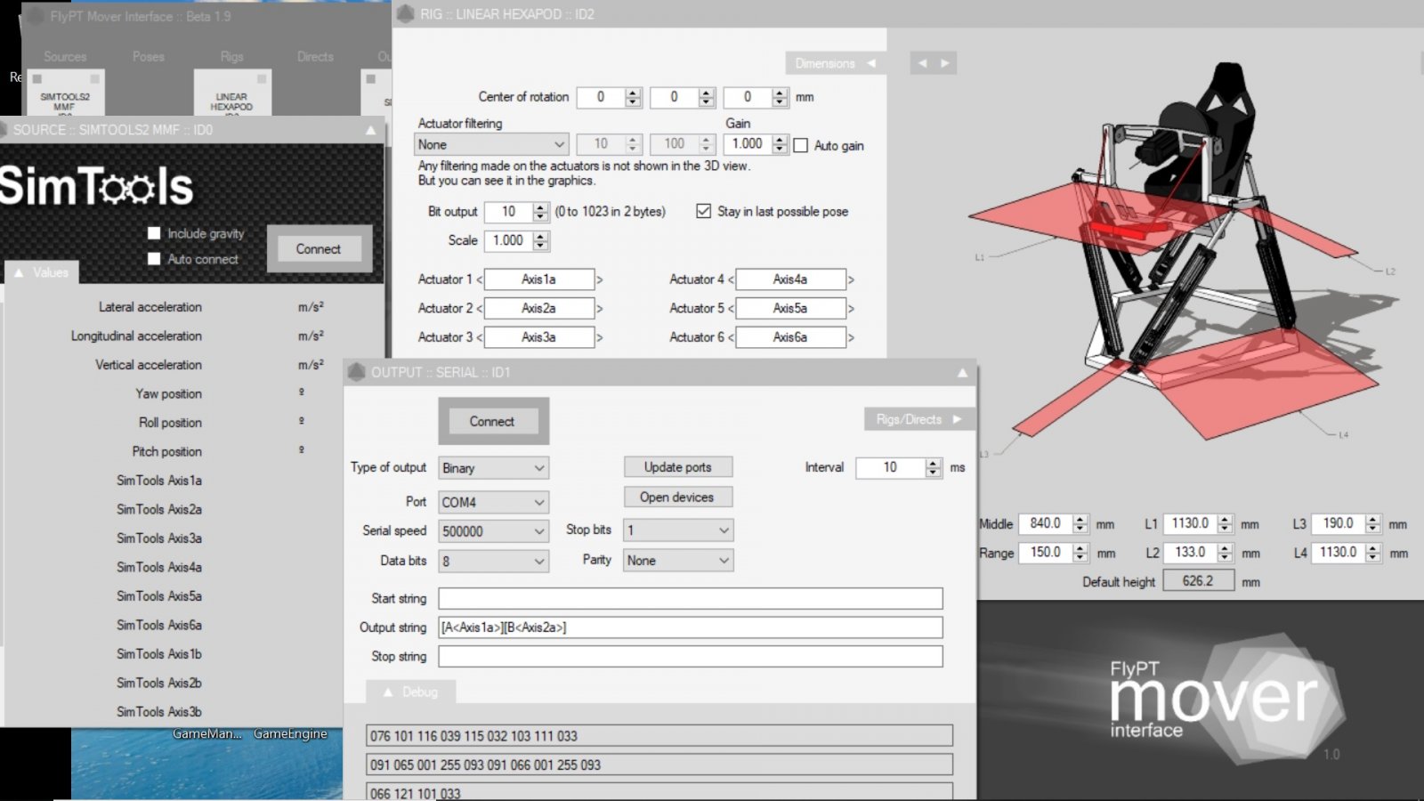

    Not doing much this weekend on my rig. Just added reinforcement on the pedals stand.
    Then I updated Simtools and tried the new @pmvcda mover app, but it did not work. At first, it was pushing my 2 test actuators to the top limit switch. Then, I updated all linear size. Now, it just does move. Version 1.9 beta and both connections turn red. I tested the old hexapod version, and all is fine. Am I missing something?

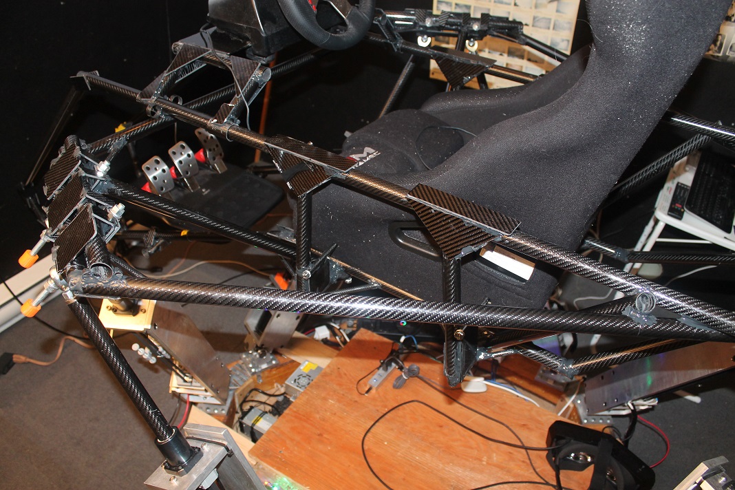

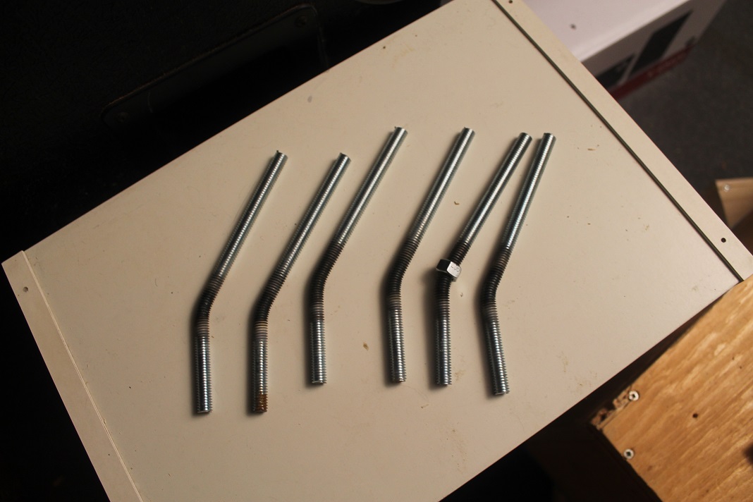

    Did a little more. I went to see my friend in his machine shop. He help me to bend my holding rods.
    So I can transform this:
    To this:
    My rig should have wider range of move now that it is in the right angle at rest position.
    The new Simtools with the old hexapod gives strange results. The rid is unstable when the car is stopped. I will have to investigate more. Calibration, calibration, calibration...

    Can you share your setup file?
    It's hard to see anything with that image.
    Meanwhile, I'm working on the new version, I hope with less bugs and way more features.

    Hey Pierre, I've not had good luck using all-thread in similar side loaded applications. It tends to crack at a tread cut if there is much bending load.
    Are you sure they are strong enough?
    I do like the carbon tube structure, though!

    Somewhere between 13000 and 15000 Canadian Dollars. I lost track of it along the way and carbon fiber is extremely expensive.
    Sorry, I can't right now. I am back at my work town, 600 km away from my rig. If you haven't got a new version before I get back, I'll send it to you.
    No, I'm not sure they are strong enough. Did not sit on it. The grade of the rod is cheap. I learned that I had to go to a special place to get better grade. But, I installed them anyway, because I don't know when I'll be able to make other ones.

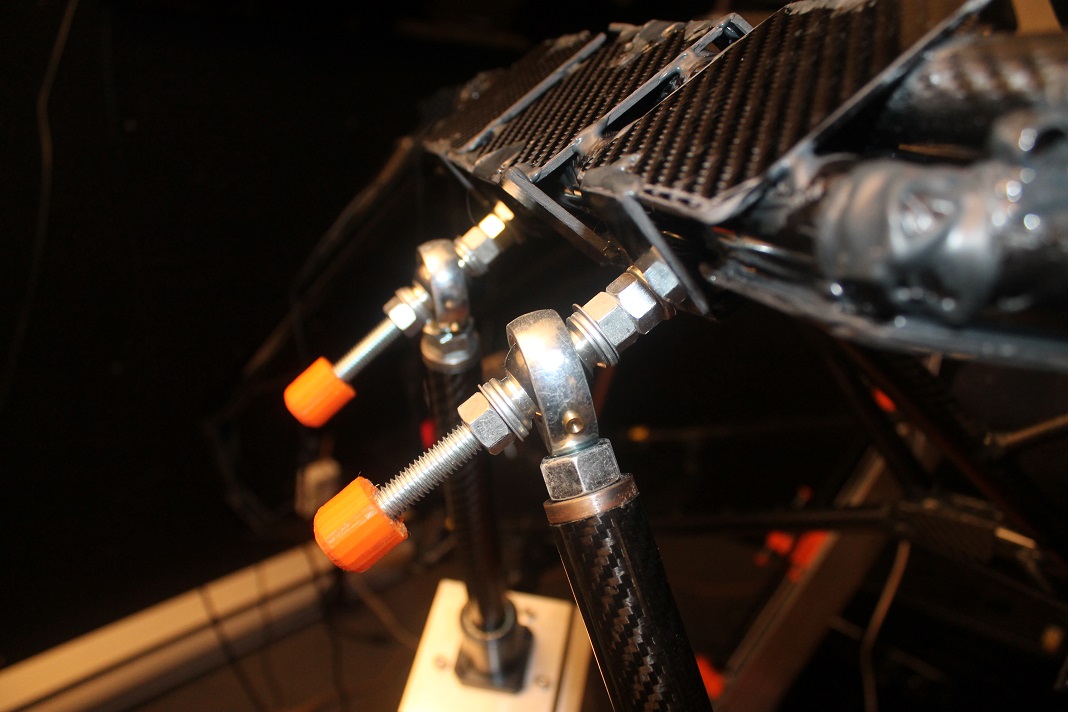

    @hannibal , I'm not sure if this answer your question from another thread, but this is how I attached my platform to the actuator.
    The threaded rod are inserted into a tube (a 12-10 mm if I remember well) and the tube is glued on its side to many plate that are themselves glued together.
    I put those tubes under the platform so the platform is pushing on them, and not pulling on them.

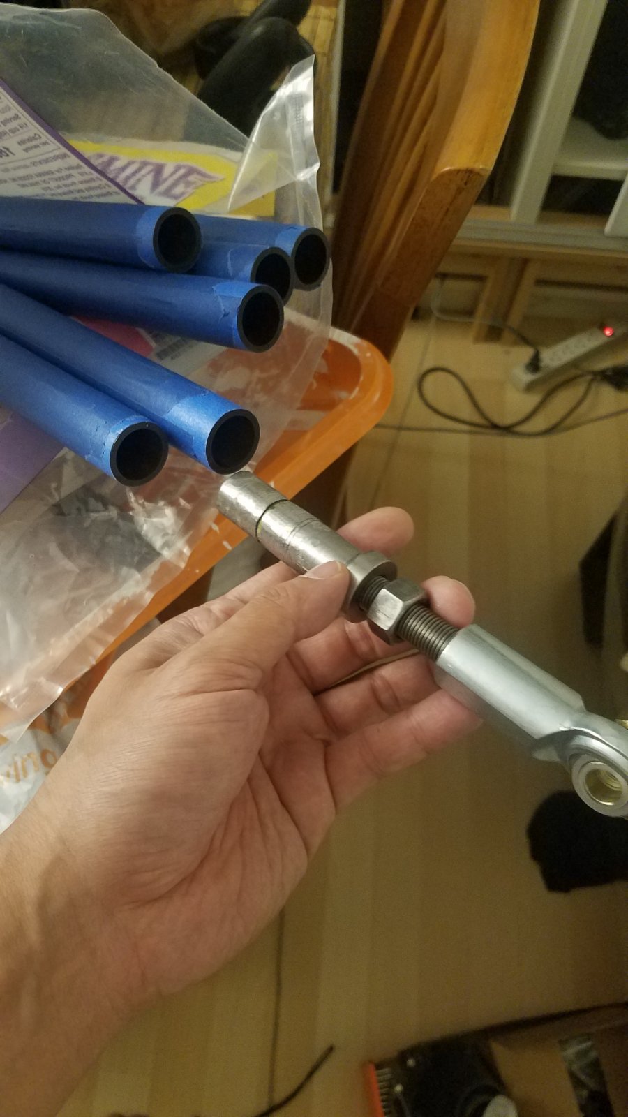

    hey pierre.
    i was refering to your work even before that.. not the top of the platform, rather the actuator themselves..
    your actuator rods ends insert look clean.. im just wondering if u had a method to apply epoxy..
    this is what im trying to attach
