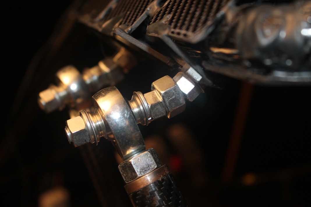

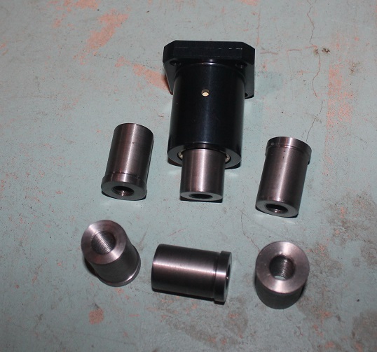

    Actually, it was quite simple. I used the same epoxy that I applied inside the tube, with a bit on the insert. Once they were joint, I just use a paper tissue to wipe the excess that was coming out, until it was all clean in the outside. That's it.
    Nothing fancy.
    When I was changing the threaded rod for the bend ones, one of the insert came out. My glue mix at the time was not that good. I had to glue it back. I did exactly like I just said. Glue, insert, wipe out the excess.
    Hope it helps.

    does gravity affect the glue?
    i was thinking to apply the glue, set my carbon fiber tubes with the insert/hiem ends upside down so that the epoxy can set toward the top instead of dripping down into the tube...

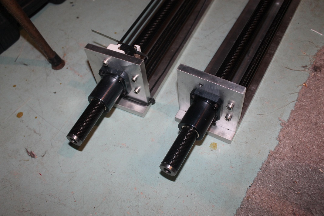

    Mine are so tight, there is no real danger of loosing the glue inside the tube. even if it did, it would not go really far. It probably stayed close enough to bond the parts.
    Putting them upside down to dry is not a bad idea.
    Old pictures of the process.

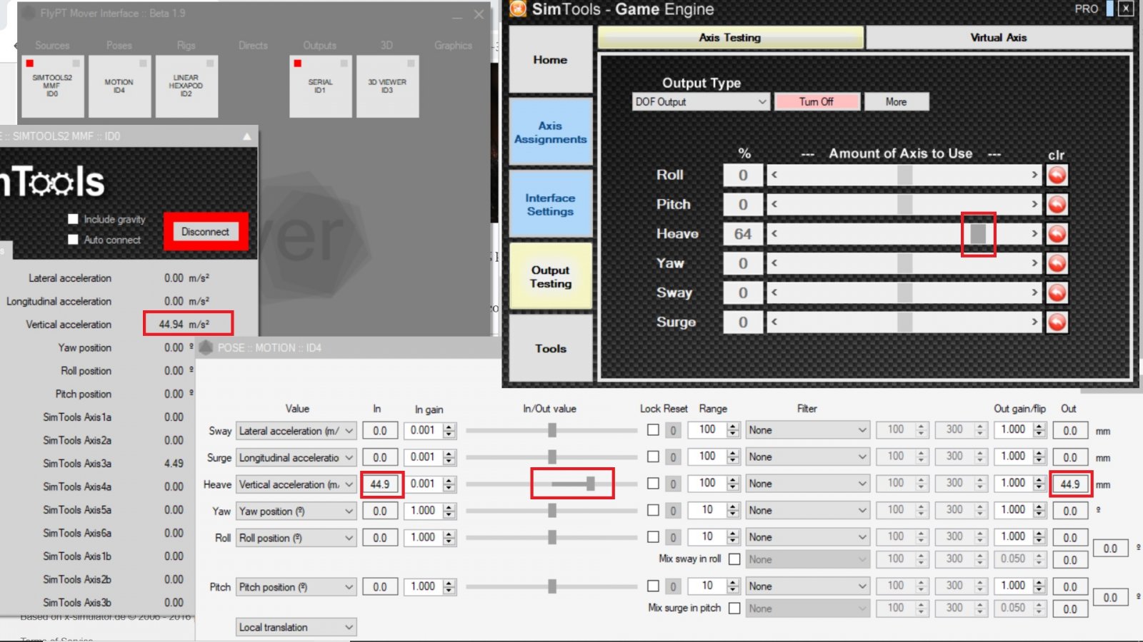

    Did one thing on my rig today.
    I added a bigger nut between the connection in the rod where it bends. It looks more solid that way.
    I also found out that one of my helm joint is not working properly, the one that gives missing steps in the strap position. I will get a new one and change it.

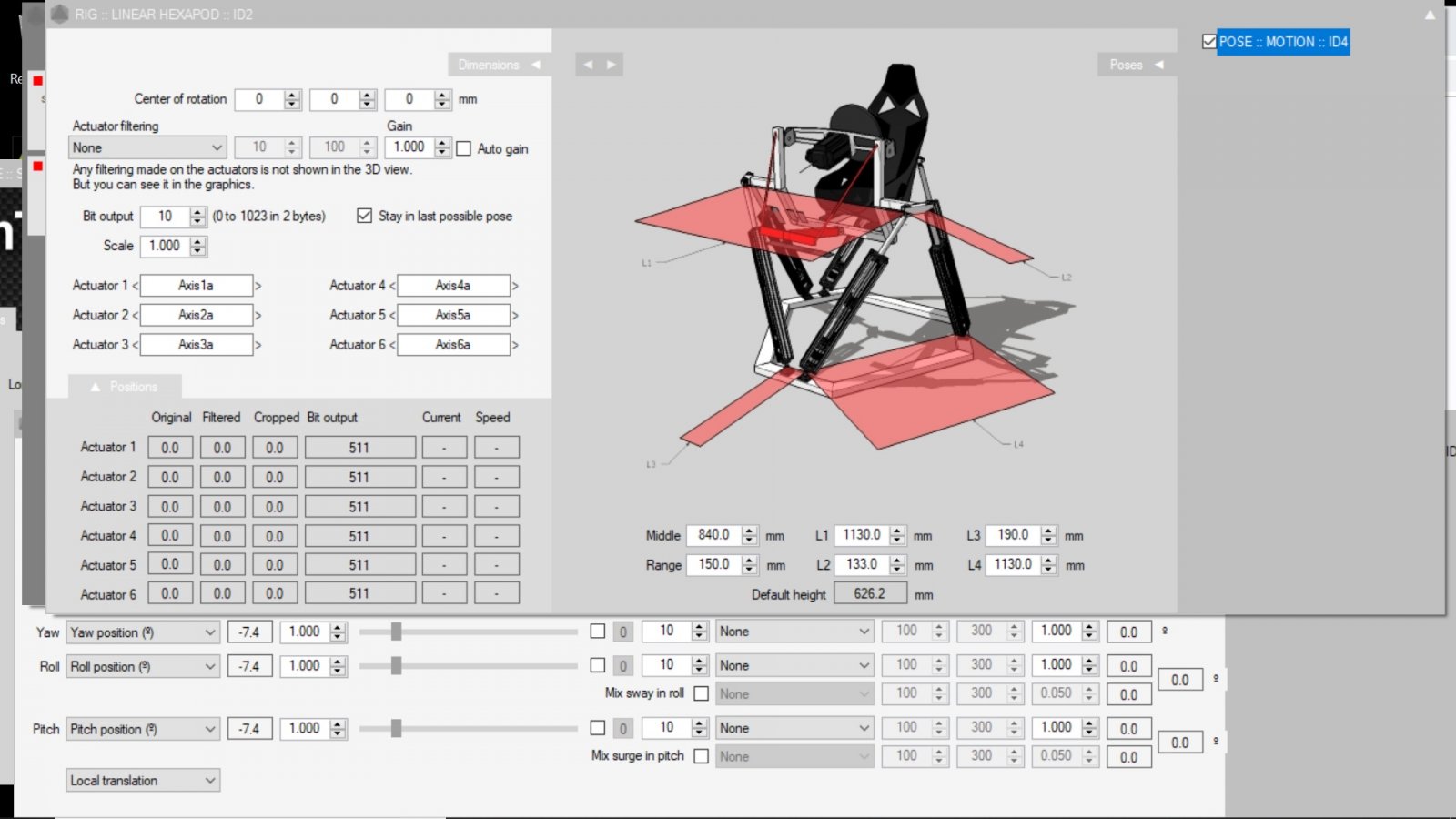

    @pmvcda , I tried to move it again. No result. Simtools connects, I see value change in motion, but none in the 3d viewer. No movement on the rig.
    Those are my connections to the arduino via usb port. I used my old setting to set up this one. No movement.
    As promise, I attach my setup file.
    I don't get what I am doing wrong.

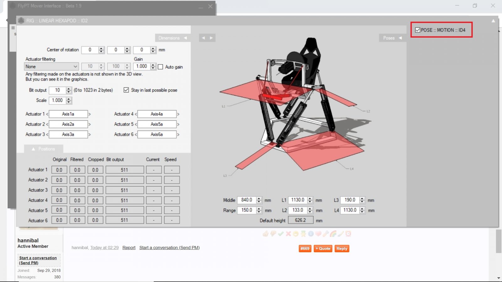

    Sorry, can't see the file right now, but go to the rig module and in the right c olumn check the pose you want to use in the rig

    Oh, man! What an hidden parameter.
    I've got movement now. Thanks a lot.
    Let's see now if I can get coordinated movements now.
  11. pmvcda
    pmvcda aka FlyPT
    Nov 3, 2010
    2,256
    Portugal
    15,806Coins
    +2,702 / 17 / -0
    In the column (right) you see all the poses you generate in Mover.
    You can select one or more. If you select more than one, the effect of the sources is added.
    So for example, you can generate a pose from the motion. Given by accelerations and so on...

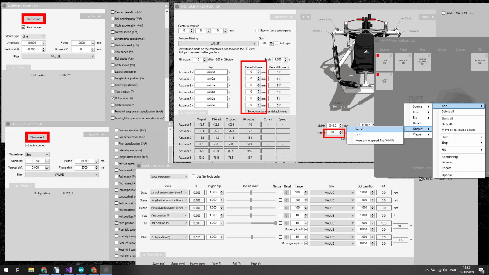

    Please start without SimTools, just for testing.
    Use the default setup I included in the zip file. It makes the rig wobble. It's good for testing.
    Just change:
    - the rig to your type of rig and dimensions
    - and the output to the output you use in SimTools
    Edit:
    And in the rig window, put a low gain to be sure you are inside limits.
    You can increase it after connecting and observing the rig behaviour.

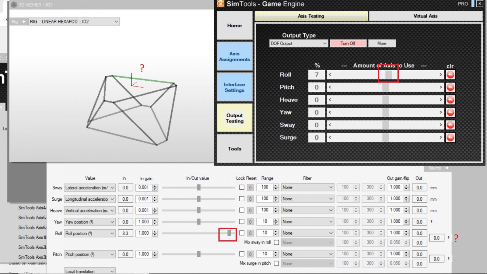

    Took me a while to figure out that in was in the Add - Source - Testing loop that I could add the source module for testing.
    I don't see any value change in the RIG, even though the values are swinging in the POSE. Is this normal?

    You are using an old version. Current is 2.5.
    I see your dimensions. I will make you a setup. Give me a minute.
    Download the last version, because they are not compatible.

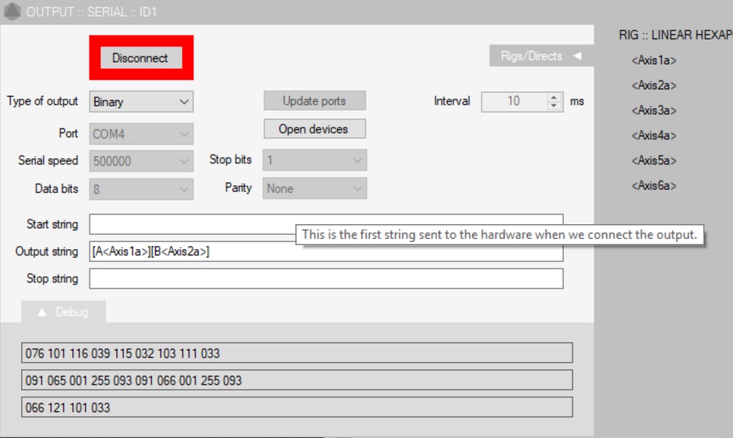

    Here's a basic setup for the new 2.5 version.
    Right click in the main window and click open to load it.
    You need to put the output string. I can't see it in your image.
    Also, instead of 150 mm range, I used 100 to stay on the safe side and avoid collisions. You can increase it later.

  19. pmvcda
    pmvcda aka FlyPT
    Nov 3, 2010
    2,256
    Portugal
    15,806Coins
    +2,702 / 17 / -0
    Another tip:
    I set range 100, as I said, you can increase it later.
    This means the actuator can go from -100 to +100.
    In the fields I marked red on the rig window, you specify where you want your rig to stop.
    If you put there the minimum range value (-100), she's going to stop at the lowest position you defined, when you stop the rig.
    When you start, she's going to move from that position to the one the game sends progressively.
    If you keep zero in those fields, the rig starts with the actuators on the middle position (zero).
