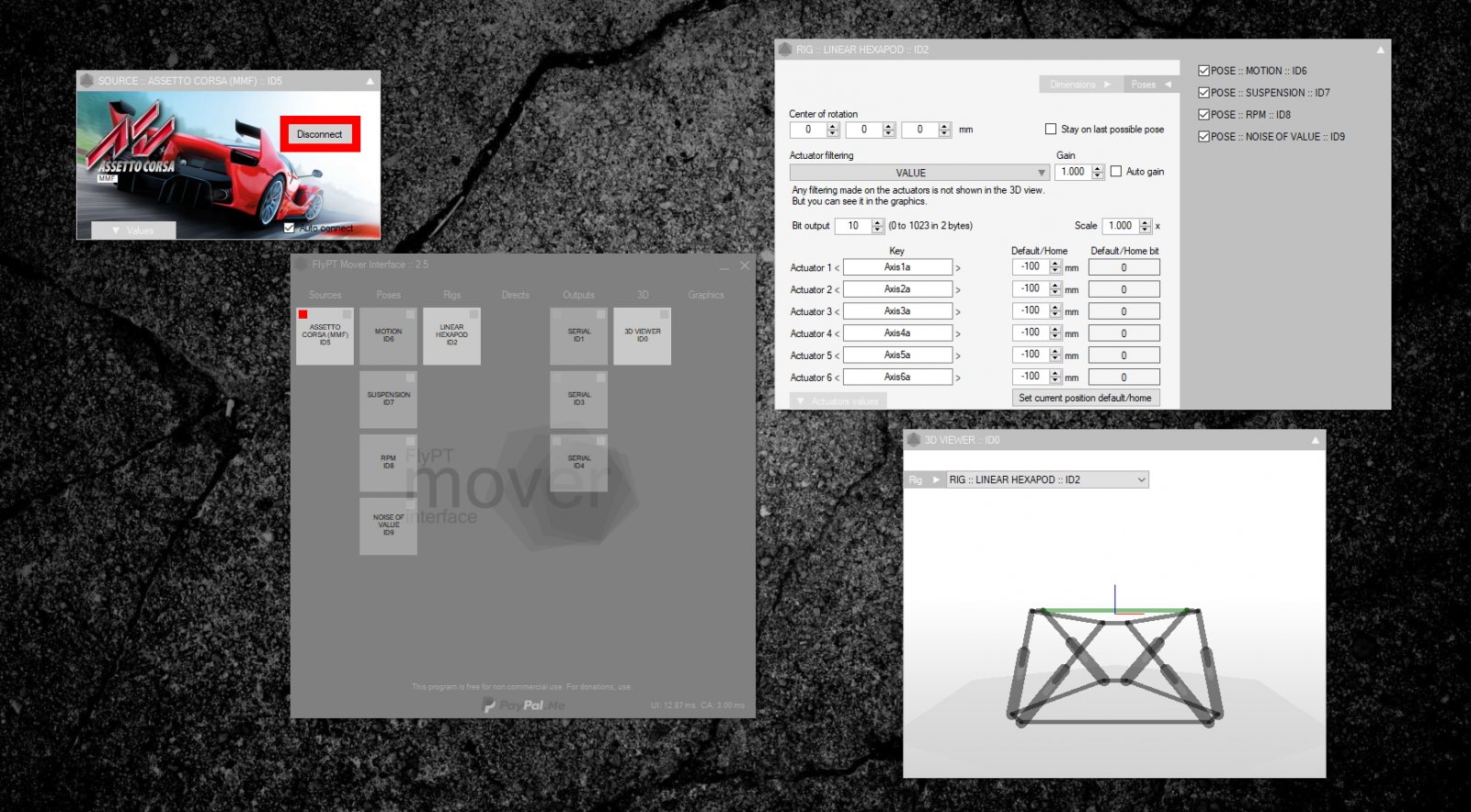

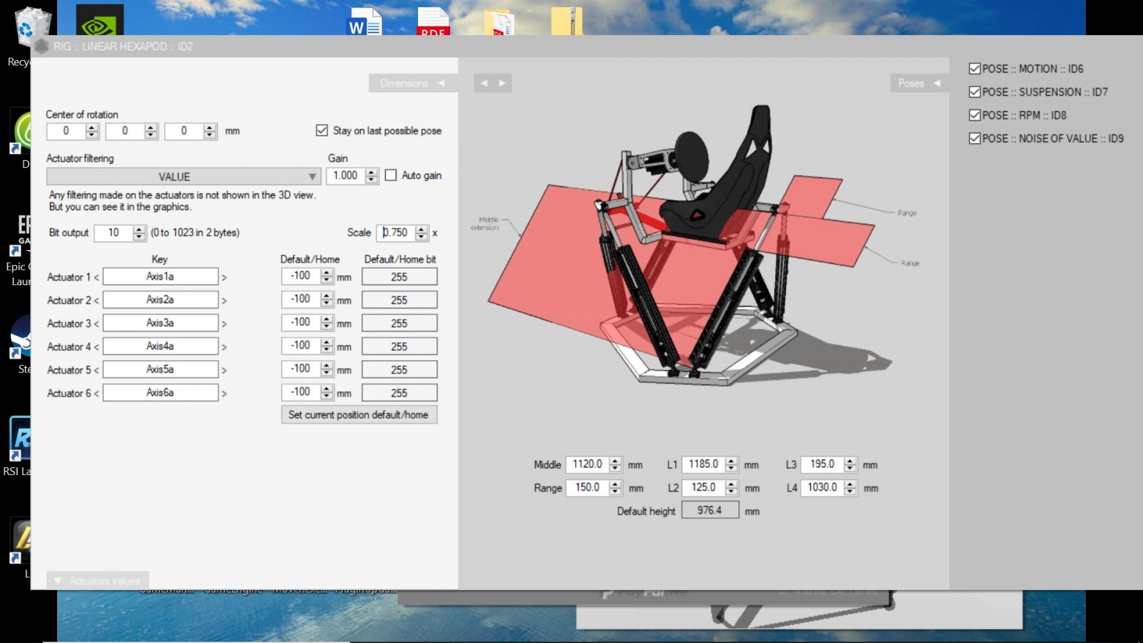

    Here it is, to start...
    Explanation follows...
  8. pmvcda
    pmvcda aka FlyPT
    Nov 3, 2010
    2,282
    Portugal
    15,962Coins
    +2,733 / 18 / -0
    So the idea here is a kind of a showcase of what you can do.
    In the image, you can see the rig module, and I checked all the poses.
    Uncheck all, keep just the rpm.
    And test.
    You should feel the rpm vibration.
    Low rpm more vibration, more rpm less vibration
    Now check just noise of value.
    The value here is speed. What this make is generate vibration when speed increases
    Now check just suspension.
    This one moves the rig just with the suspension travel of the car. Could be enough this one.
    Try also just the motion. That's the one that uses the motion cueing.
    In the end check all to feel all at the same time.
    EDIT:
    I used a range of 100 to keep the rig in the limits. Increase the value if you are sure it's safe (you where using 150).
    Also, if you fell it's to much movement, lower gains in the motion, or even better, go to the rig module and use a lower gain. Changing in the rig, affects all the info received by the rig.
    If the movements are to harsh, instead of gain, apply a EMALP(VALUE;xxxxx) filter in the actuators to make them softer. xxxxx=1 is no filter, bigger value softer and softer it get's, but also starts to lag.
    Tell me how it feels, so I can help adjusting the values. It's a personal taste at play.

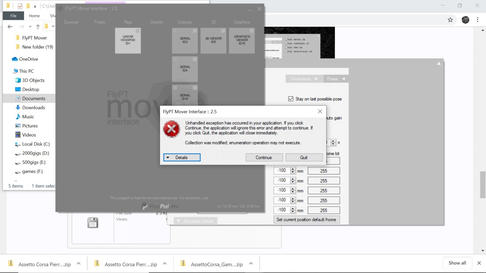

    Unfortunately, when I tried to open your file, it crashed.
    Now, every file I try to load crashes. Mover do open though.
    I will reboot my computer to see.
  10. pmvcda
    pmvcda aka FlyPT
    Nov 3, 2010
    2,282
    Portugal
    15,962Coins
    +2,733 / 18 / -0
    Sorry. That's a Mover problem...
    Old files are not compatible.
    You can try this:
    Close Mover
    Go to where you have the executable of Mover and copy the setup I sent you to the same folder.
    Delete the LastSetup.FlyPTMover that's inside the folder
    Rename the file I sent you to LastSetup.FlyPTMover
    EDIT:
    Or, just delete all modules before loading a new setup
    Don't forget to verify your COM ports, I don't know if what I used is correct.

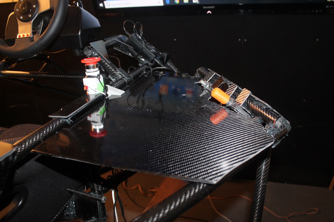

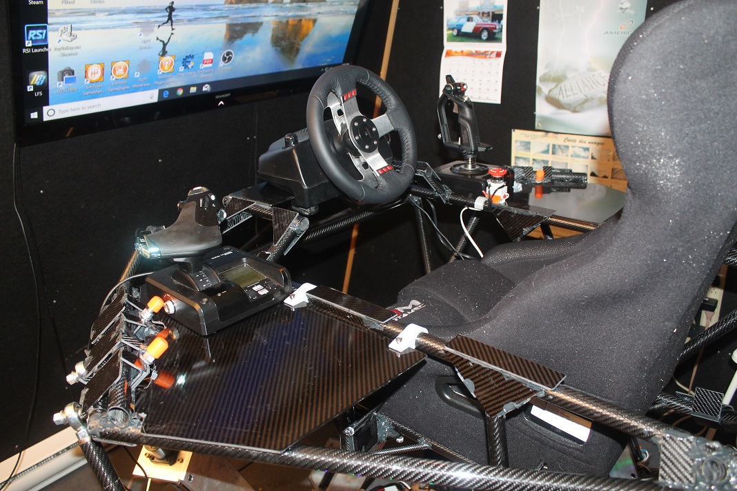

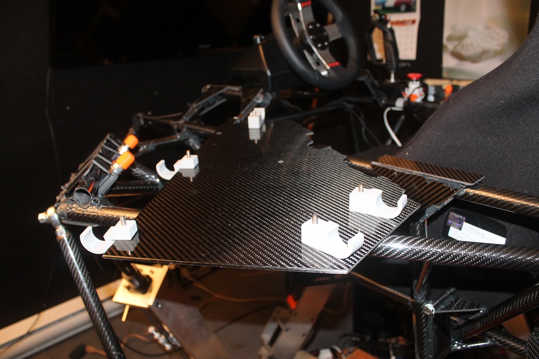

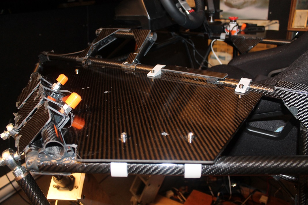

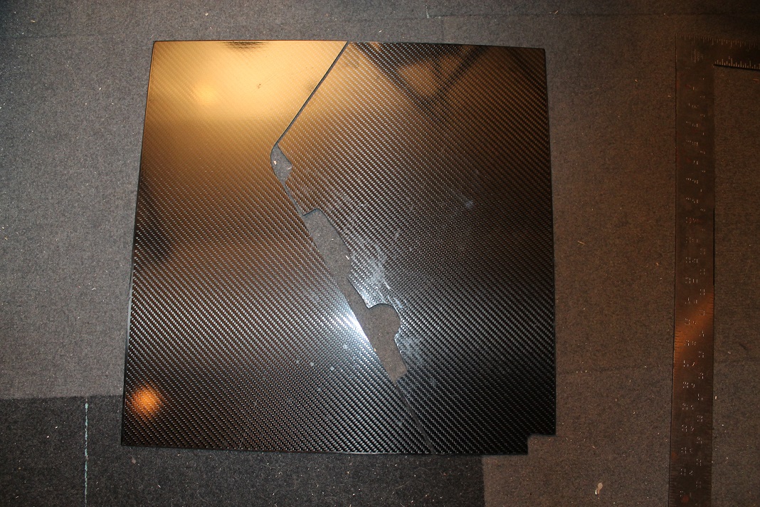

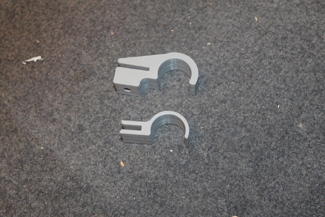

    Today, I have cut carbon plates. At first, they looked cool, but I had to make them practical. Then, they looked less cool.
    To hold those plates in place, I had the idea to do plastic brackets. After only 2 iterations, I had a good result.
    Then, I did a third design for under the plate, as my tubes are not all the same level.
    Those plate are used for the side part, holding the joysticks. They are easily removable.
    As I wrote this, the last part of the other side is printing.
    The sim start to look sexy.
    Finding the place where to put the keyboard will be a challenge.
