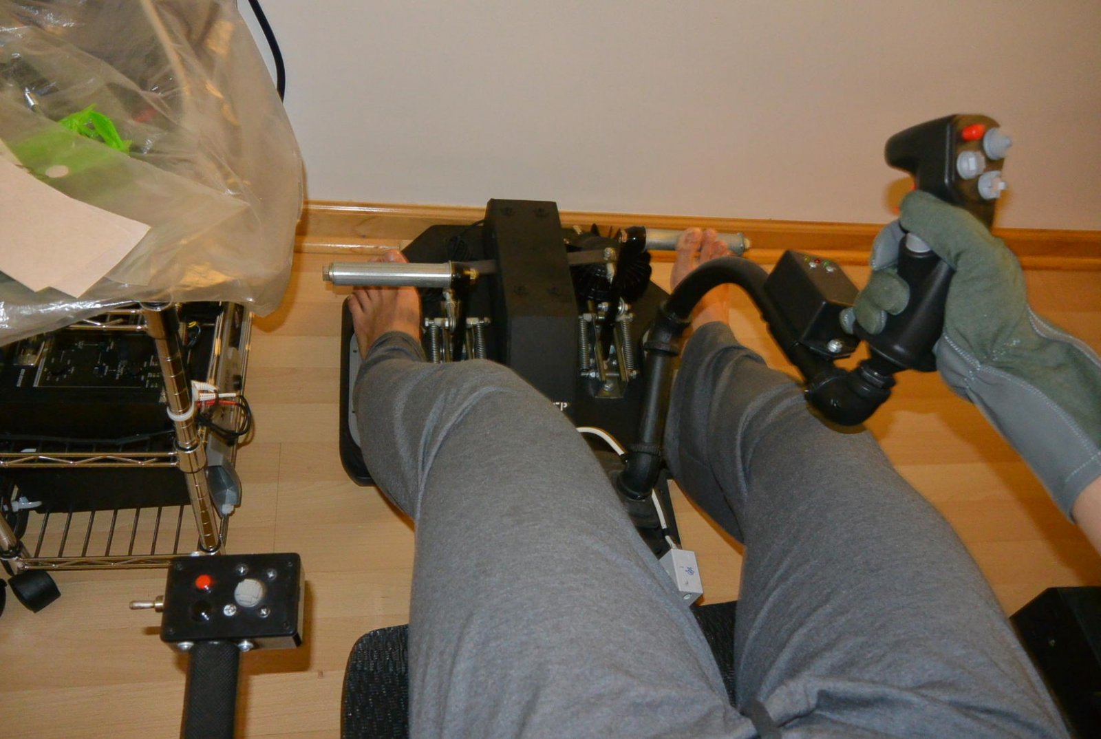

    i built non-motion sim chairs.. my first time i bought ebay racing seats.. it also cause me numbness.. gave me nerve pain until i stopped using them and threw them away, and redesigned my setup with staples office chairs, and i was ok ever since. i cant stress enough how important the egronomics are.
    right now i am banging my head on my build.
    im struggling with a design, in addition i will have to depend on friend to weld.
    but i am on to something.. base off @wannabeaflyer2 drawings, @pmvcda hexa graphic, @SilentChill 's hiem mounts, and dofreality P6 frame.. some how im going to mash them together.. to create my own top frame.. but number on on egronomics.
    i advise u to lay off sitting on your current set up.. it took me 3-4 months to recover from the nerve damage that the cheap ebay seats.. and the flaw of my design. mainly if you keep your feet elevated, so that the lip of the bucket seat doesnt dig in behind your thighs, you should be ok. now if they are.. u will need to redesign..
    good luck, stay safe.

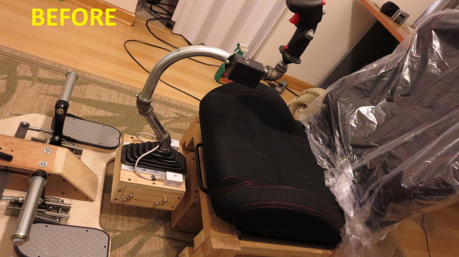

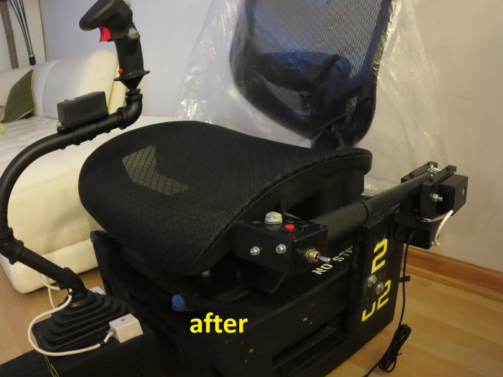

    My actual seat is a race car seat, that I got at a rebate price.
    One of my mechanical friend is quite jealous of that seat, and would like it in is race car.
    It was nice before. It's a matter of placement, that I got wrong.
    I will change it. It's just that I need to redesign something all glued. It sucks.

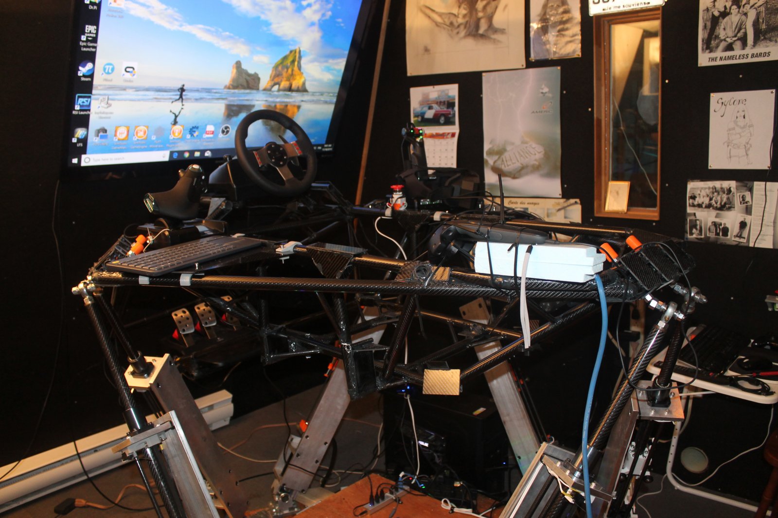

    For once, I had all the time in the world. So I decided to spend my morning by removing the seat and testing Pimax Motion Cancellation.
    The seat part was quite easy. But, some of the tube used to hold it unglued. Those were among the first I did. Maybe I did not put enough glue, or my mix was not that good at that time. Anyway, I applied more glue among my first assembly parts of my frame, just to be sure.

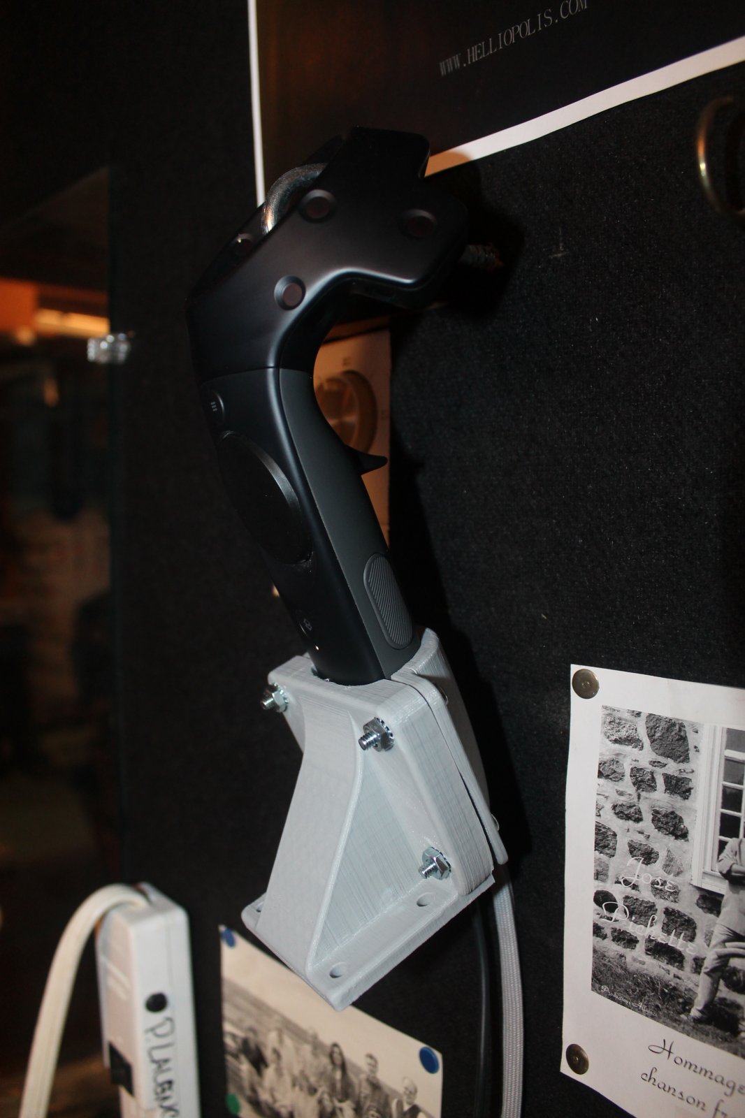

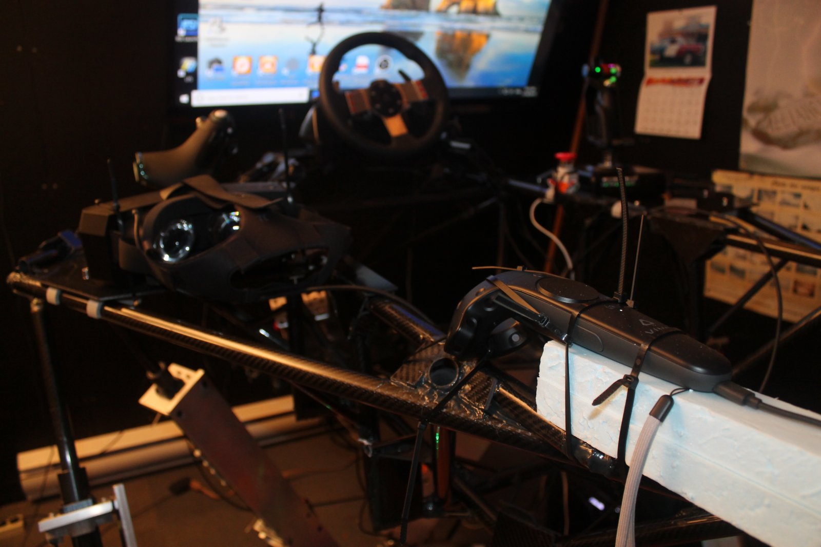

    Then, it was PiTools Motion Cancellation. I'm testing it so I can send my results back to Pimax. My controller was already attached to the rig. So I attached the headset to the rig.
    I already have a more sophisticated support for the controller printed out.
    The version of Pitools is v1.0.1.180 beta. I'm writting all that stuff down so I know what to write to Pimax. Then, I fired up Elite Dangerous and filmed it when it was completely still. Even if I am not stable with the camera, we can still see some jitters in the stability at the screen.
    Jitters with no motion compensation.
    Again, this time, with Pitools Motion Compensation. Before we go on, there is a few things I'd like to note.
    When setting a controller for motion compensation, if you turn on another controller, the motion compensation is reset. When getting into your rig is already a challenge, a reset of the motion compensation can be quite annoying.
    If the rig stay still long enough, the controller will turn off and reset the motion cancellation. When the controller is at a position hard to reach, it can be very annoying.
    A good thing is that I tested the motion cancellation with the controller plugged in and it worked. So, a permanent setup can be make to have the controller always charged, always recharging.
    We would need a setup in Pitools to set motion cancellation permanent, even if we add an new controller, tracker or headset. Also, it should keep its connection even if the controller shuts down. Even better would be to have the option to never shut down that controller.
    Even if I have the motion compensation on, we can still see the jitters at the screen.
    Jitters with the motion compensation.
    Here, I started to move the rig. As we can see, even if the headset is attached to the rig, we can see that the motion of the rig is interpreted into the movement of the head (but the head is still). Funny thing, after a few move, the jitters of the image seam to stabilize. Like Pimax needed some sort of calibration by movements.
    Elite dangerous no motion compensation.
    Here I added the Pitools Motion Cancellation and I reset the seat position. There is almost no jitters anymore. There is jerky movements of my rig, but the Elite Dangerous cockpit stay relatively stable to the screen, like it should do.
    Elite Dangerous with motion compensation.
    Last but not least, I noticed that once you have reset the seat position, it can be quite hard to do it again. The press of the button (in setting) will just not register. You have to do it in repetition until it register, once on twenty times.
    Also, rotation is still not part of the seat rolls calibration of a motion cancellation controller.
