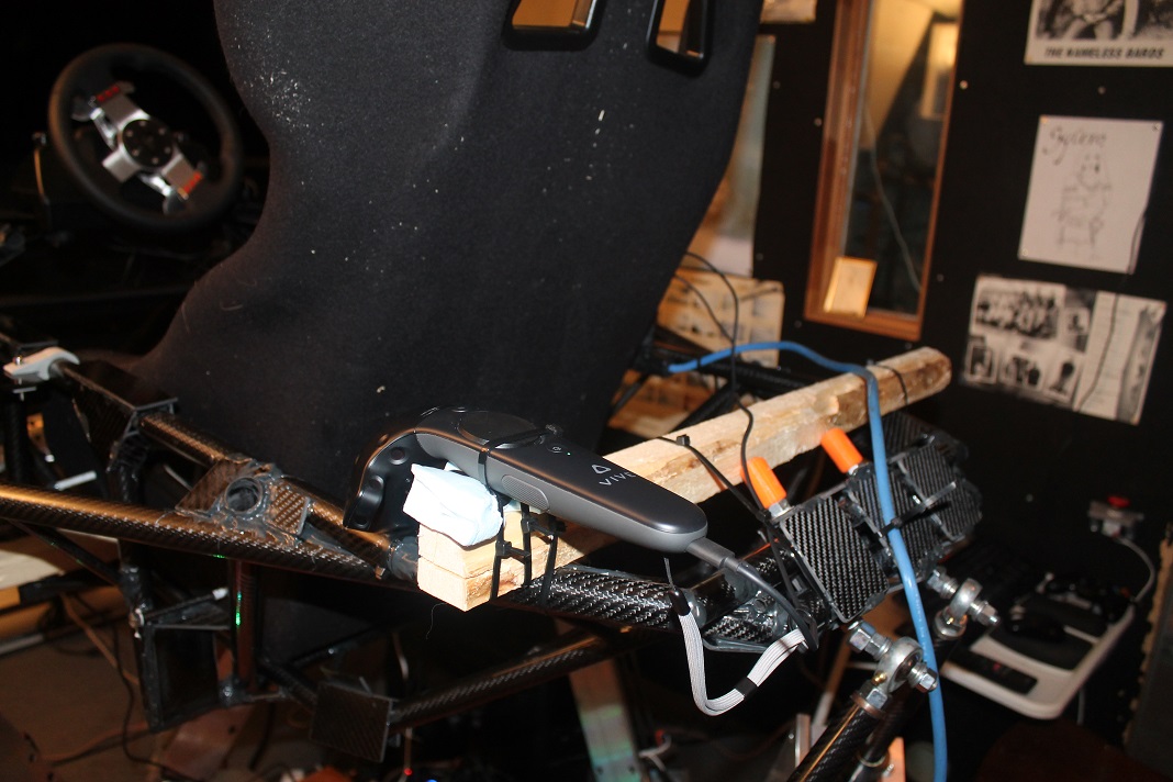

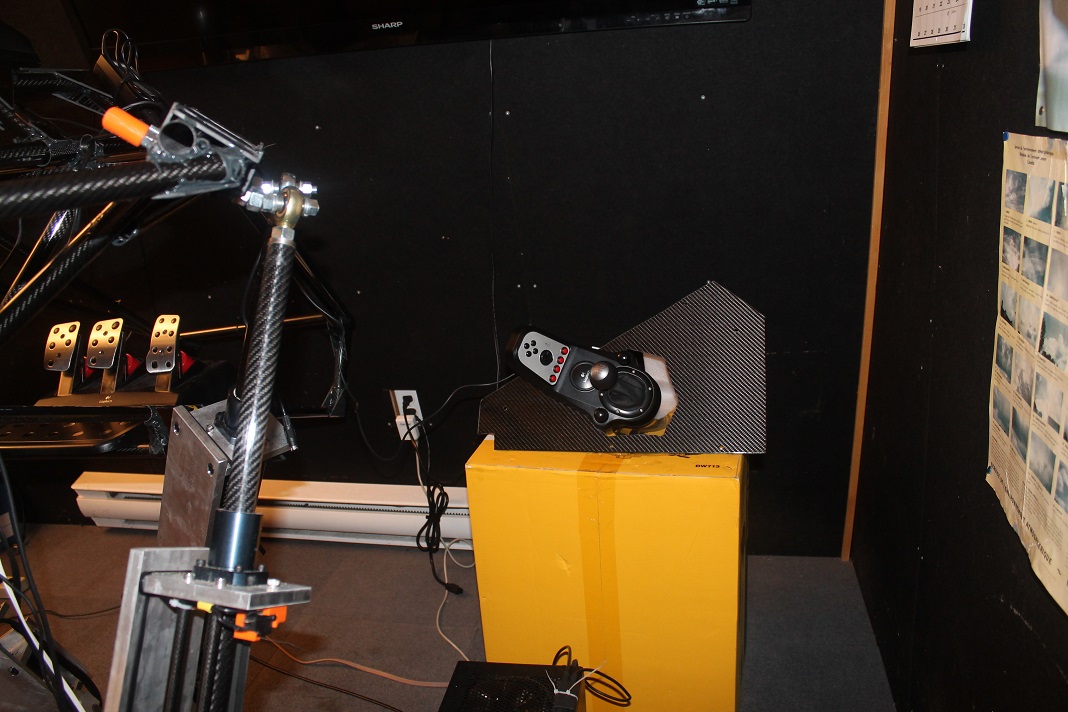

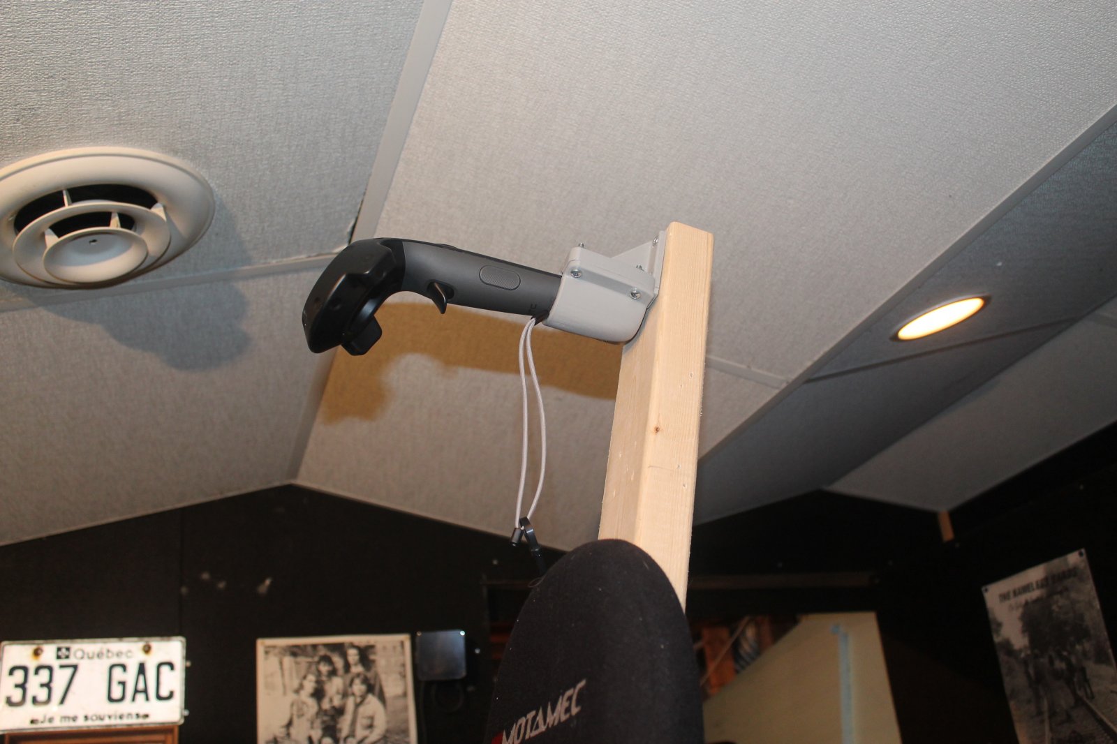

    Tried a new controller attachment today, but I could not test it yet.
    Because I could not get the rig to move with Dirt Rally (even if I could play the game), and I could net get the suspension to work with Assetto Corsa (alway at the bottom).
    It's time do change the rig image in Simtools.
    Why is calibration so hard?
    Too many software working together.

    I got Assetto Corsa running with all the stuff (suspension, movements, rmp, noise), and for a first calibration, I think it's quite good.
    I made a movie, but I did not have the time to upload it.
    Anyway, the overhead controller turned out to be shaking. I need a way to set it firmly on the body of the rig.
    I understand now what poeple say about small vibrations not working with motion cancellation.
    I was totally unable to start Dirt with motion cancellation, or rig movement.
    At least, the new seat position is comfortable. :)

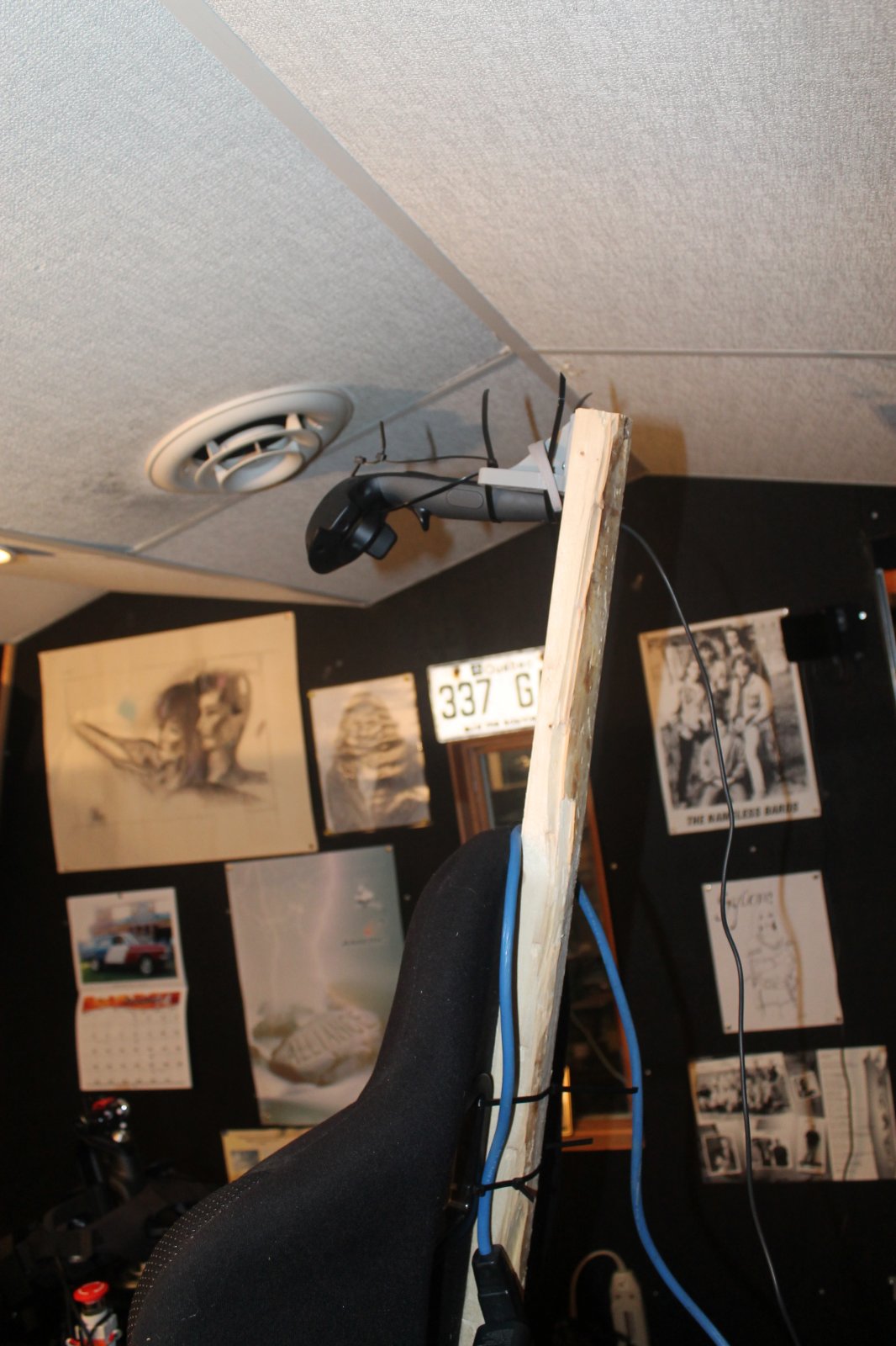

    This is the video I had no time to post. As you can see, motion cancellation has hard time with small vibration.
    So I try another position today for the motion cancellation controller. Firmly in place, it's seen by both lighthouse bases. Now, it's time to test.
    I hope it won't be to intrusive of my personal space.

    As I wrote before that got lost between two publicity, is that we tested cancellation and without.
    He preferred without, as the drifting in the image was less distracting than the vibration at high speed. We also removed the noise value from Assetto, still to reduce vibration.
    Also, the controller was not leveled, and rotation are not corrected. The horizon was too high, so we turned of the cancellation.
    Pimax needs to incorporate rotation in the seat reset, and add a adjustable filter to remove the small vibration noise.

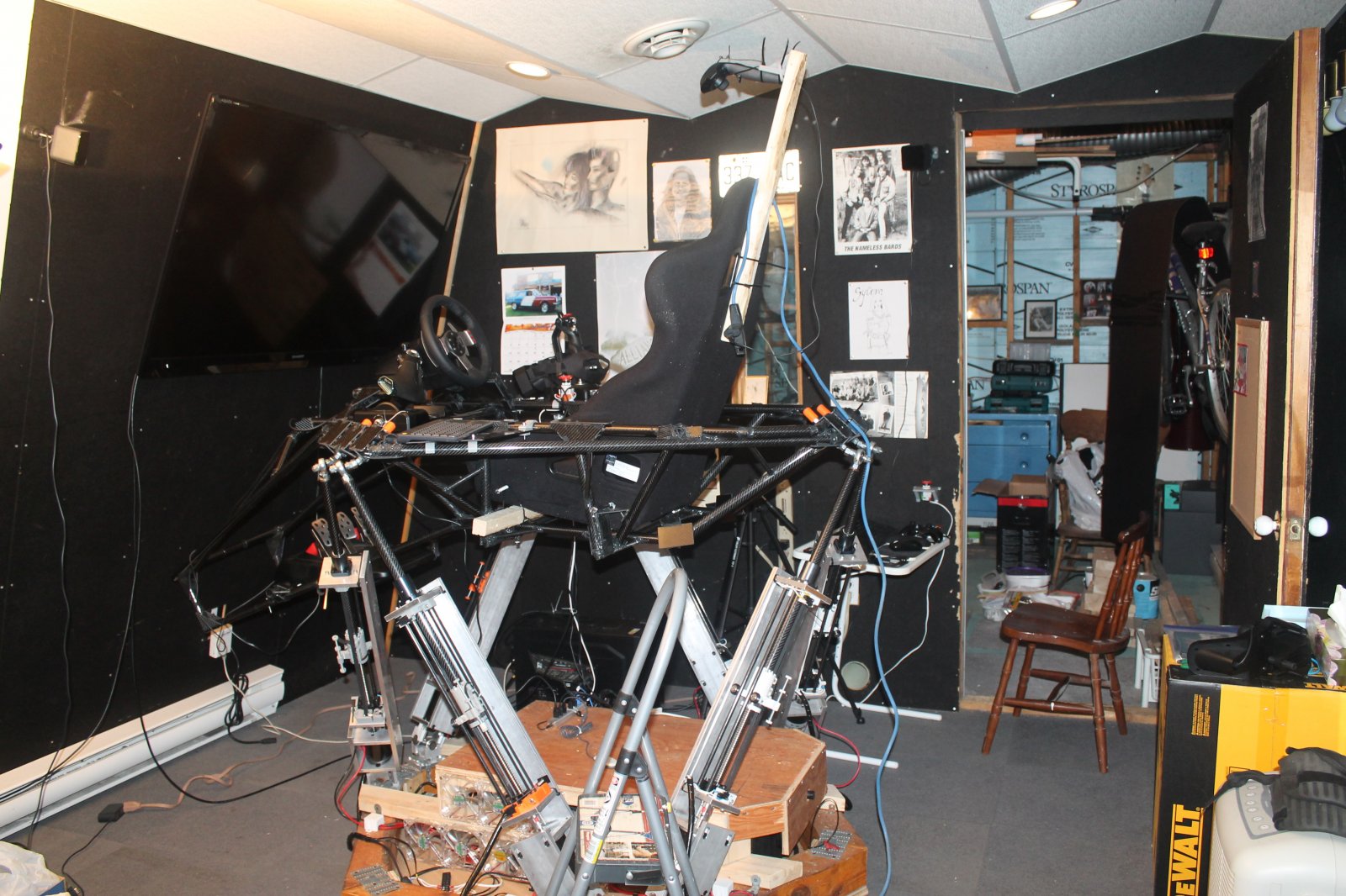

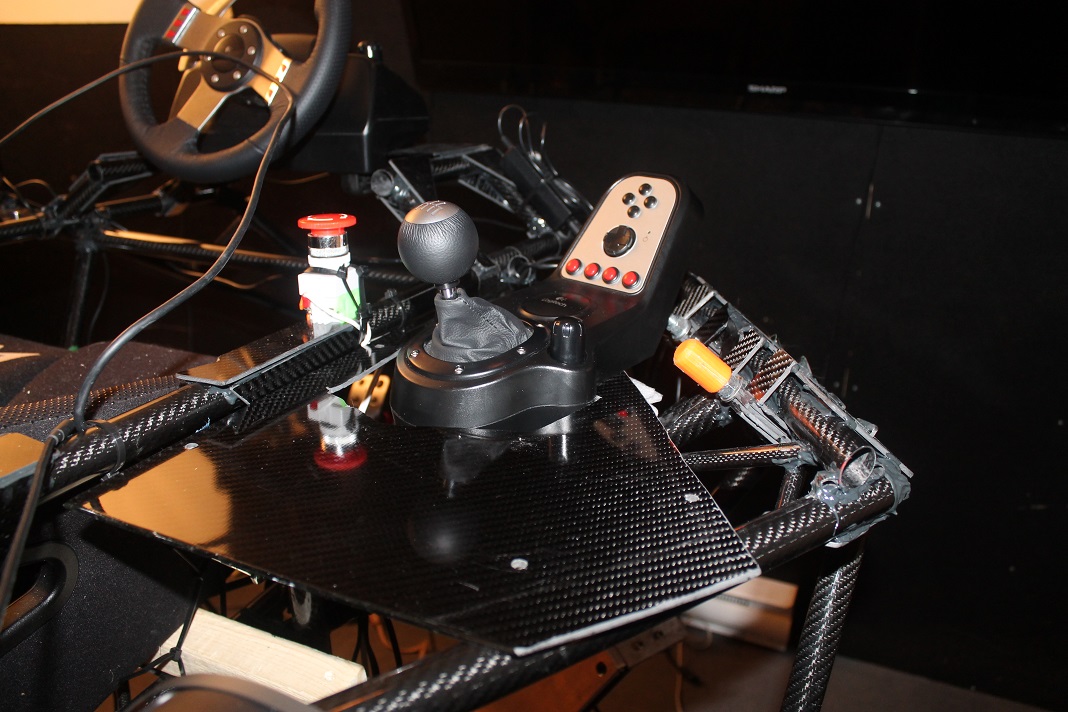

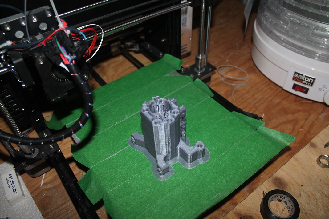

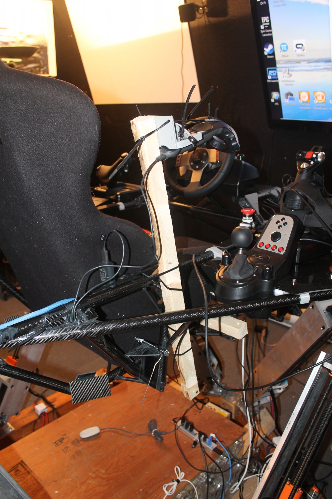

    Last week was strange. It started smoothly with me playing Elite Dangerous at least 4h every day, mining Void Opal in asteroid fields, boosting my ship, visiting space engineers for extra boost and all. It was quite a blast and the simulator performed like a champ.
    So, I decided it was time to add the shift gear to the rig. I first started to evaluate the hole I had to make. Soon, I realize it would be huge hand I could not put a joystick back on the plate. So, I did another plate instead.
    I was only missing the clips to fix it to the frame, but I had no plastic left. So, I used the joystick attaches
    Now, if I want to use the joystick, I just unclip the shift gear and clip the joystick (after printing the attaches).
    Yet, I tested a new position for the motion cancellation controller. There, it's not invading my personal space. Unfortunately, it was unstable as it seams there ain't enough triggered sensor by the lighthouse base. The last position was way better (for the tracking). For now, I leave it off.

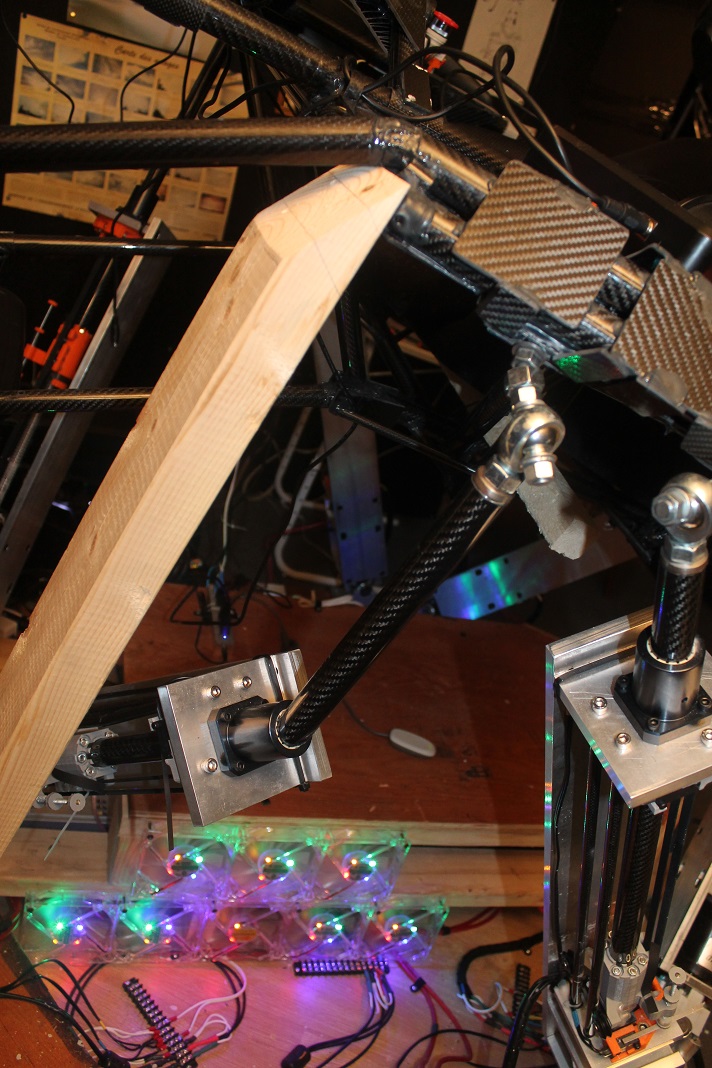

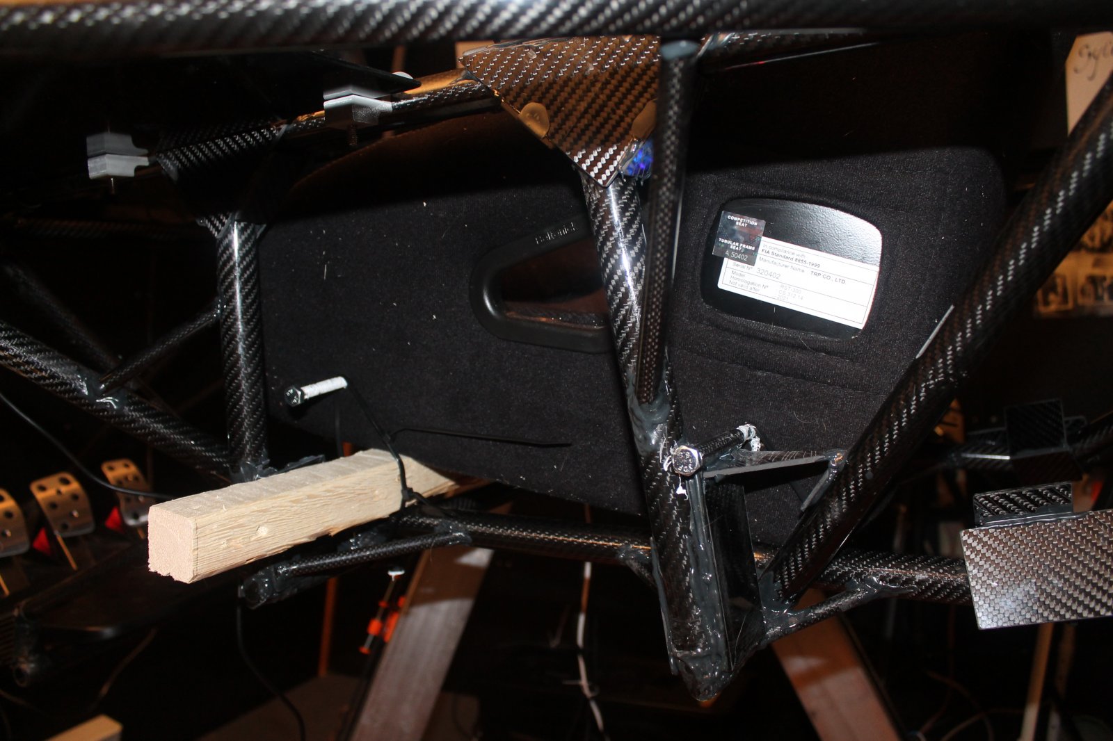

    This is when I decide to invite my mechanical friend to test it. He's the one who designed the frame of my actuator based on my wood prototype. He drove it like he drives his car. I understand now why is car is always broken.

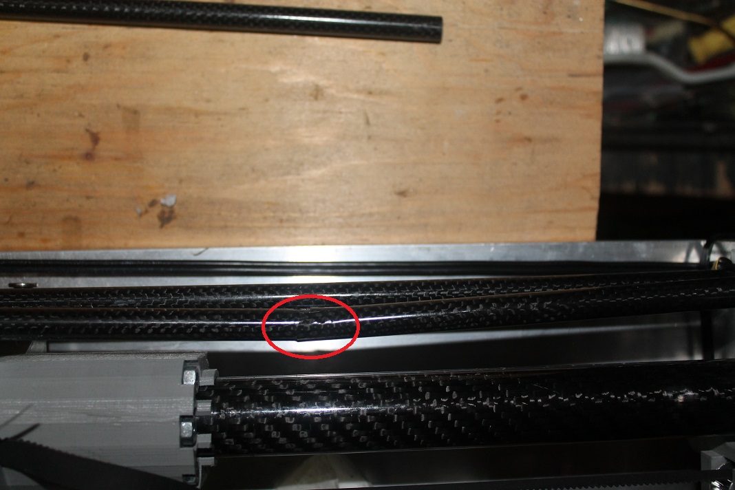

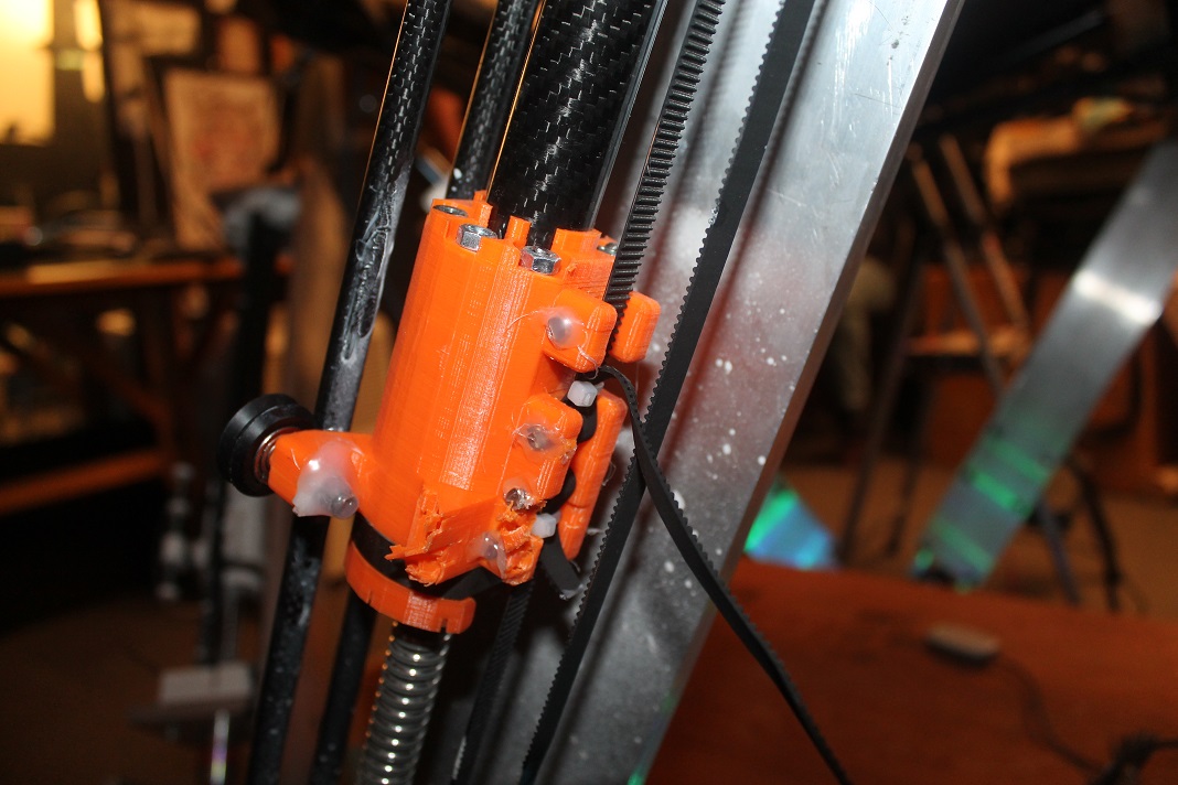

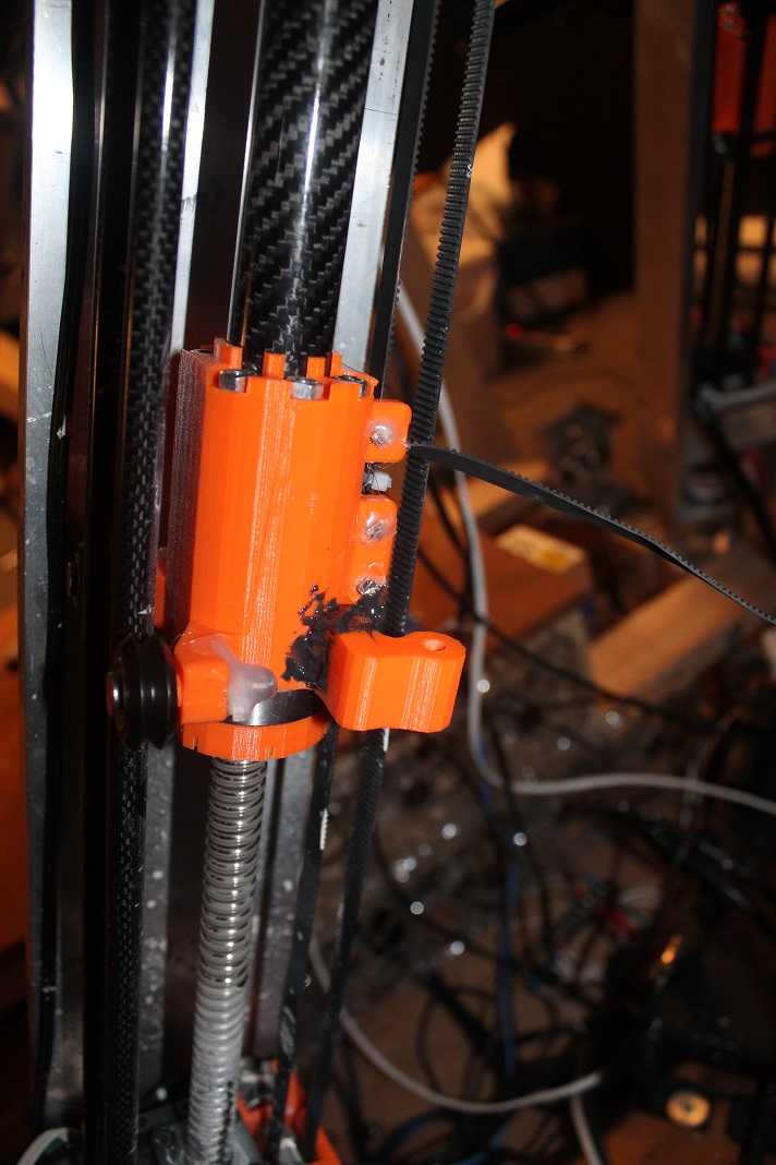

    Indeed, he broke my simulator by pushing the limits, hitting walls in Assetto Corsa. As a result, 0ne of the attache at the end of the actuator popped out of its socket. The simulator felt on the other side and one carbon tube took the beating.
    End of the session. I did not have time to present Elite. On the other side, the actuator felt and hit the computer. One of the structure tube had broke on the impact.
    The limit switch trigger was broken too. But I had no plastic to print it again.
    Ding-Dong, later that day, two day before Christmas. Perfect timing.

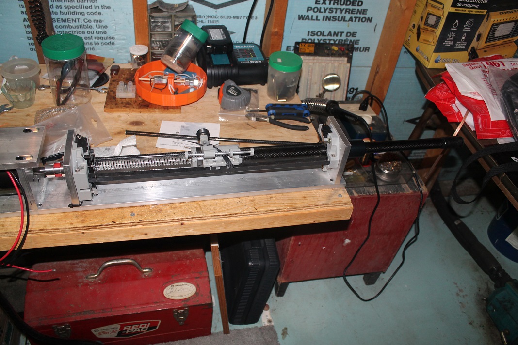

    I had a few part left. Using my imagination and a lot of glue, I could repair my actuators.
    Even though I could print the broken part, I decided to glue it back. It was simpler and should hold long enough.
    The rig is back together. All forces as been tested. I didn't do a run yet, but I am confident it is good as new. I will ride it later, after Christmas, with a lot less intensity than my friend.

    Nice story but bad result you need to make sure all those critical components are nice and secure.
    Are you actually up to full power yet ?

    I was indeed. I still am.
    The bad result came from using a more powerful car than the one for calibration. Trying to do 360 and hitting walls in series, not knowing in VR how bad it treated the rig.
    If it wasn't for the top that came out, it would have probably been fine. But I let him be a little too rough with it. I would never treat my rig that hard. I have a better idea on how far I can push it.
    I had played Elite the whole week, and it performed without a single problem at full power.
    My other friend is coming back Friday and we will calibrate it for Assetto Corsa a bit more conservative, to say the least.
    I am thinking about stronger carbon tubes, different attaches to the ball joints and platform. But until I get a budget for those parts, I secured all the possible failures I could think of.
    Bottom end story, it was a bad manipulation of a powerful and possibly dangerous contraption.
    Fortunately, nobody got hurt. Thanks to the safety panic buttons.
