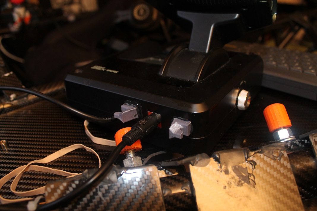

    I did a one hour ride in Elite Dangerous yesterday. All went fine. It might be a bit jerkier than it use to be. I feel the new tube has a lot of friction into the Igus, but, accordingly to their publicity, it should improve over time as the self lubricating plastic should fill micro gaps for a perfect fit.
    I also adjusted the rolling force as it was going to the max way to rapidly. It should help to not pop out the end of the actuators.
    Anyway, the jerky movement was not my biggest problem. I had continuous fails from my controller because the wire disconnected all the time from the movement of the rig. I printed 2 little hooks to attack a elastic band and hold the wire in place.

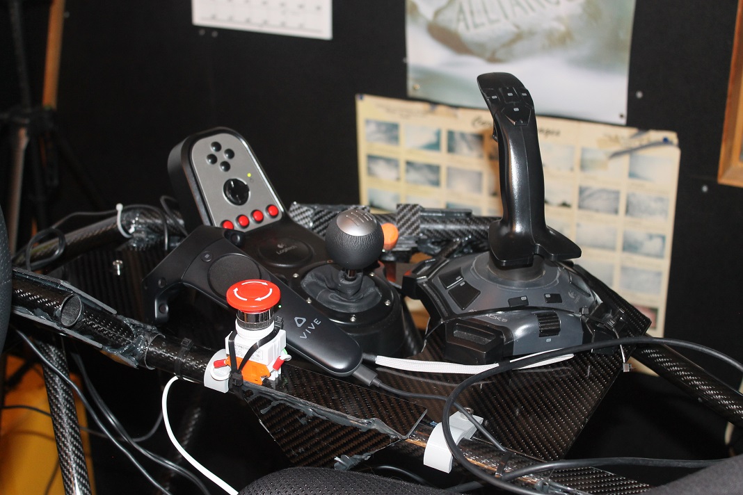

    Those are the carbon tubes I need, and they are not that expensive. But, no money, no candy. The rig may rest in that form for quite a while.
    Today, I added an handbrake to the rig, using the Atack3 that I got from a pawn shop.
    It works quite well. I cannot say the same about my way of using it. I made a little video. This is me trying to learn too many things at ones: Gearing, drifting, hand brake and obs capture.

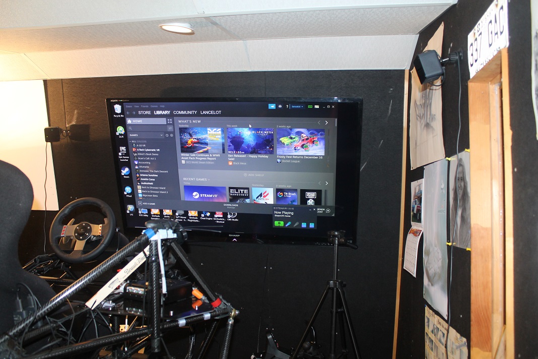

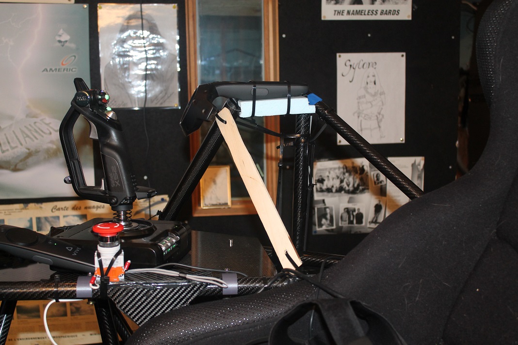

  9. Pierre Lalancette
    Dec 11, 2016
    1,012
    Tech Artist
    Quebec, Canada
    8,052Coins
    +947 / 6 / -0
    3DOF, DC motor, Arduino, 6DOF
    Yesterday, I played until 3 o'clock in the morning and I didn't get any issue with the joystick cable. The elastic bands are doing their jobs.
    Did a little test with Elite again. First, I change lighthouse positions to be more in front of the seat. It improved the tracking a lot. Then, I tested yet another position for the motion compensation. I think we have a winner. It still have small vibration issue, but the rest is more stable.
    So we could pass from tie-wrap to carbon structure.

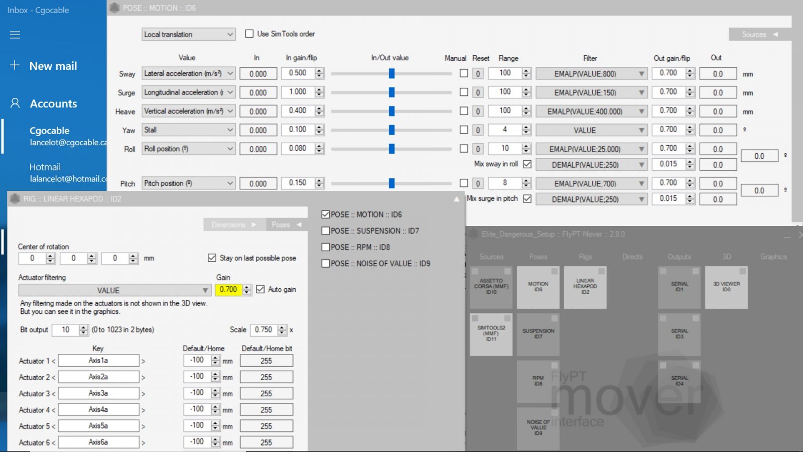

  10. wannabeaflyer2
    Jun 12, 2015
    724
    london uk
    8,362Coins
    +958 / 7 / -0
    Hi @Pierre Lalancette can i ask a favour , can you do a screen shot of your mover setting showing the Motion Module and the linear Hexpod Module Please , im slowly trying to understand what i need to change in terms of values and filters for my 4DOF version ( i know yours is 6DOF ) but i can look at Filter values to see how and why you used those ..Cheers Sorry cant make them out in video my dodgy eyesight )
  11. hannibal
    hannibal Active Member
    Sep 29, 2018
    677
    4,492Coins
    +298 / 4 / -0
  12. Pierre Lalancette
    Dec 11, 2016
    1,012
    Tech Artist
    Quebec, Canada
    8,052Coins
    +947 / 6 / -0
    Sure, this is Asseto (for the toyota G86) :
    And this is Elite:
    As you can see, I do not use the Yaw force for now. It was pushing my rig too far on the front actuators for not enough feedback. It's okay for me. I did not play with the cor (cog) either as it was fine for me.
    I should add that the out gain of each force is at 0.7 trying to adapt to the 70% travel I had calculated for the actuators (with simtools). The Gain is at 0.7 to accommodate the scale.
    Now, I'm trying to get Dirt Rally working.
  13. Pierre Lalancette
    Dec 11, 2016
    1,012
    Tech Artist
    Quebec, Canada
    8,052Coins
    +947 / 6 / -0

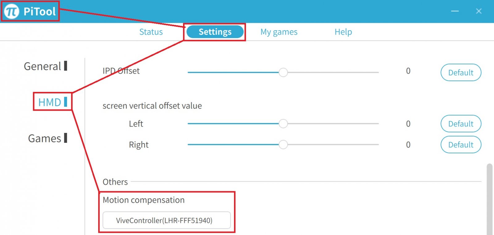

    For the motion Cancellation, I use the build in setting of the Pimax PiTools. Quite simple. In the setting, there is a HMD tab, and at the bottom, you have a drop down to select the controller. The center of the world goes to that controller. Then, you reset the seat position. Pitch and Roll are not centered. The controller need to lay flat facing forward.
  14. wannabeaflyer2
    Jun 12, 2015
    724
    london uk
    8,362Coins
    +958 / 7 / -0
    Hi @Pierre Lalancette many thanks for this info, i've been fumbling around changing values with no real understanding of why or how they impact on platform/Sim operation , thanks to your info a few more grey cells have lined up also something i misunderstood became a bit clearer ...so the out gain is a % of total actuator travel .. thats def a key bit of info i missed . its in Mover post but its so big it a case of going from page 1 again and shifting through picking out thise gems .. i need stuff in laymans terms LOL .... making mechanical stuff is easy for me ---- tech info hhhhmmmm takes a while to sink in . Cheers Pierre

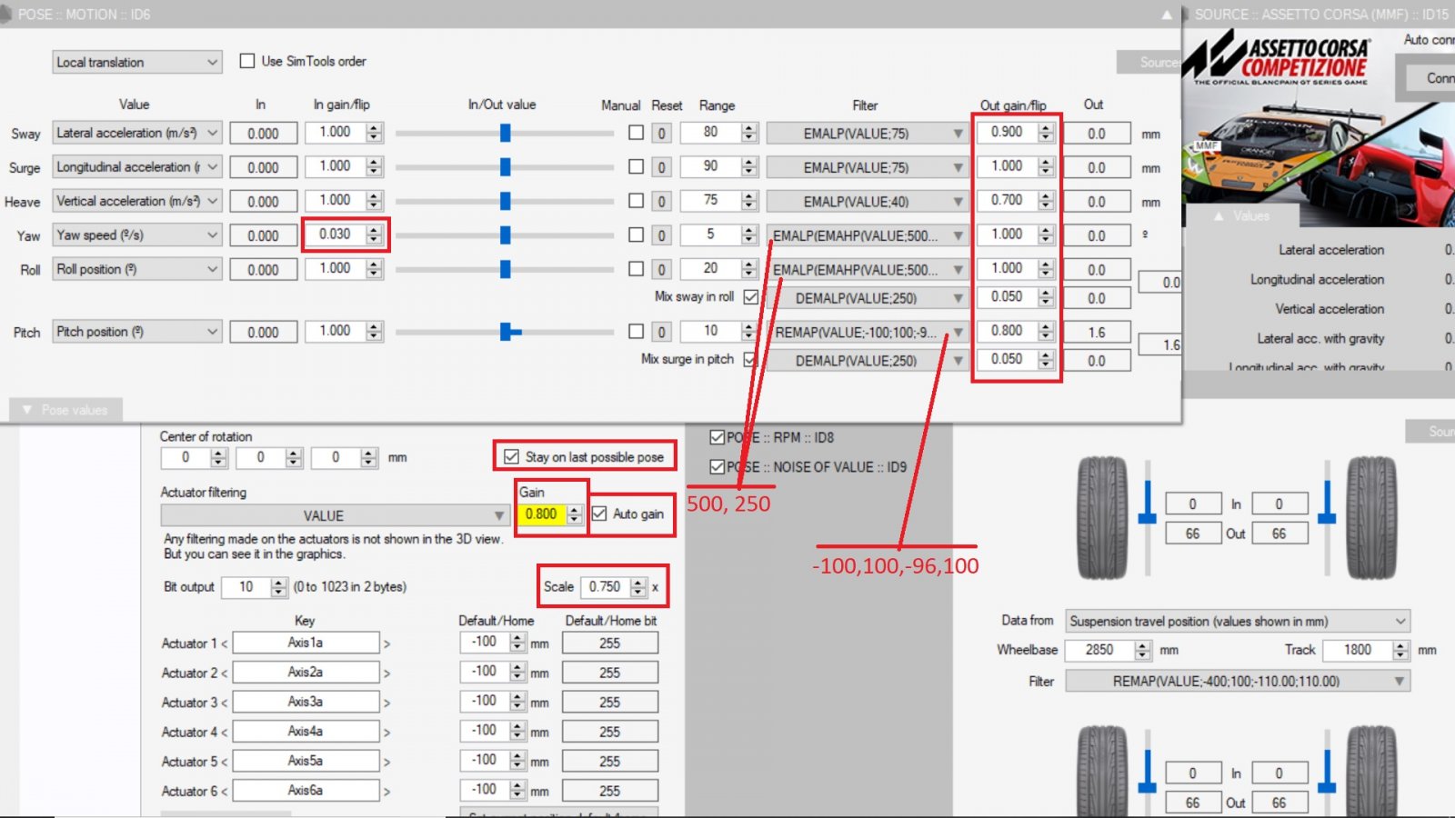

  15. Pierre Lalancette
    Dec 11, 2016
    1,012
    Tech Artist
    Quebec, Canada
    8,052Coins
    +947 / 6 / -0
    No, its not the travelling of the actuator, but the travelling of the force. I use it that way even though it's wrong. Actually, it is not a necessity. Because, if all the value you enter in the size are good, just setting the main gain should give you the right amount of move for the 100% range.
    The out value is a way to reduce (or augment) one of the force if it is not in sync with the others (or reverse it with negative value).
    I would recommend to set the out gain to 1 and reduce the main gain a lot. Then work your way up until 100% movement gives 100% range (in heave for example).
    Then, you check your other forces and adjust the out gain to fit.
    I will probably do that in a near future. This old way is a bad adaptation from simtools to mover.

  17. Pierre Lalancette
    Dec 11, 2016
    1,012
    Tech Artist
    Quebec, Canada
    8,052Coins
    +947 / 6 / -0
    Well, you should not listen to me, I'm wrong most of the time.
    This is my setup for Assetto Corsa now:
    I was saying the main Gain was for the scale... WRONG. There is a SCALE value that you need to set. The GAIN is the main power of all forces. You can see that all my IN GAIN are at one, except for the YAW that was way to strong. I could have set it to one (1) and set the OUT GAIN accordingly, but I found it easier visually to do it that way. It is only a preference.
    The OUT GAIN are set on how strong I want to feel a specific force on my rig.
    I was told that my YAW force filter could be smoothed out as there is some jerks going from right to left (left to right) rapidly.
    I boosted the main GAIN a bit, but kept all safety feature on (STAY ON LAST POSSIBLE POSE, AUTO GAIN). The SCALE was adjusted after comparison of all RANGE values with real rig displacement measures.
