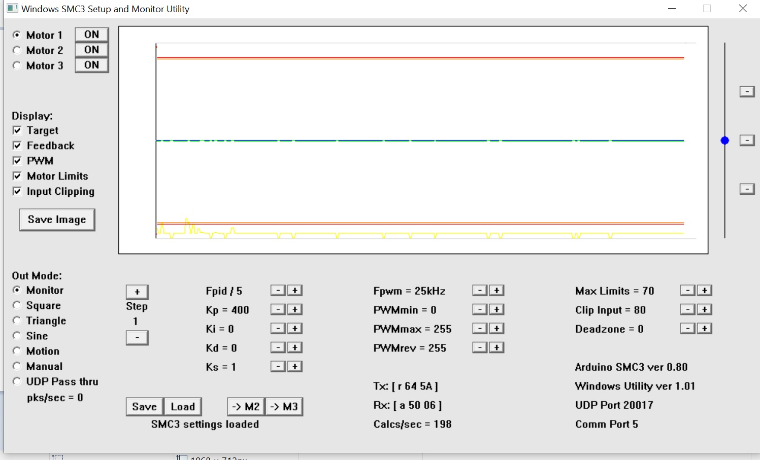

    I explain a little bit here why I chose those setting for max limits and clip input.
    6 DOF from scratch

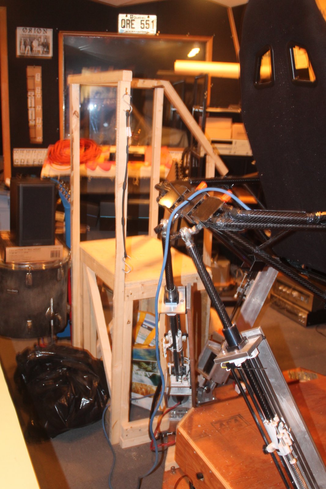

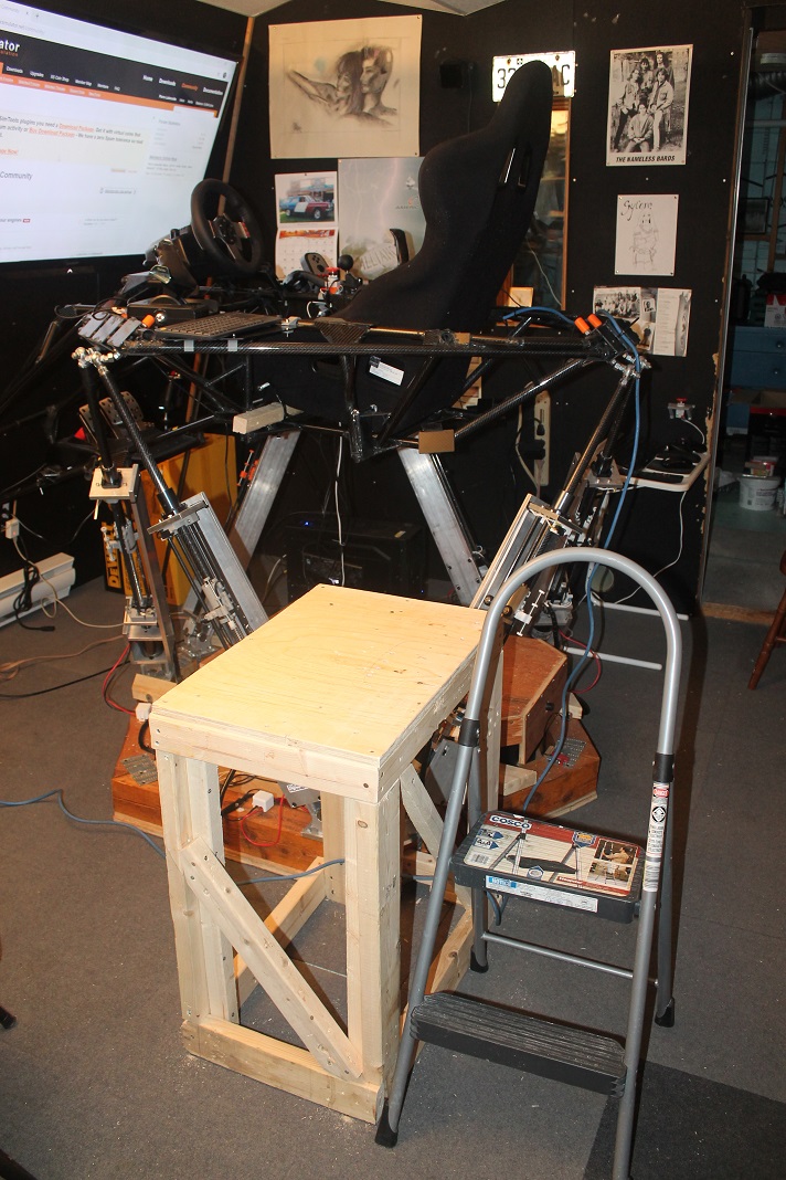

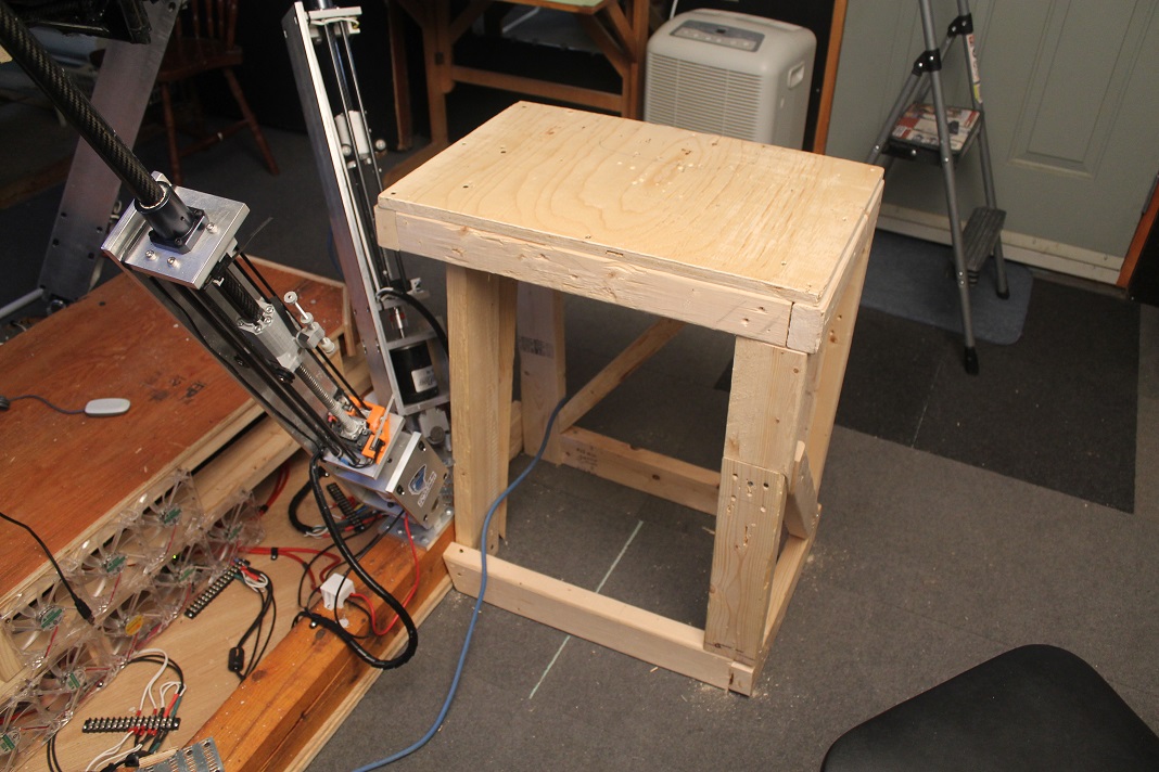

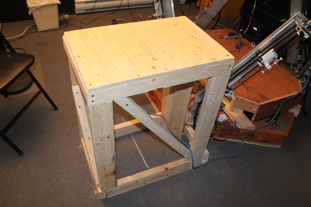

    My friends came over last weekend and they tried my simulator.
    Many little problems.
    I change a car in Assetto Corsa and the car just didn't move. It shifted, we could see the rpm and hear the motor, but it did not moved out of the pit. We had to go back to my tested car. All worked fine with that one.
    Not everyone likes VR. We are all getting old. Vision needs glasses and they do not fit all that well in Pimax. They would have preferred a 3 monitors setup. One even got dizzy a bit.
    Last but not least, as we are all old and getting older, getting into the rig was a... challenge. This is why I spend this first morning of the mid session break to make an access platform.
    I tested the clearance with Assetto Corsa mover setup and it made it, barely.
    It is quite strong. It should be a lot easier to get into the rig.

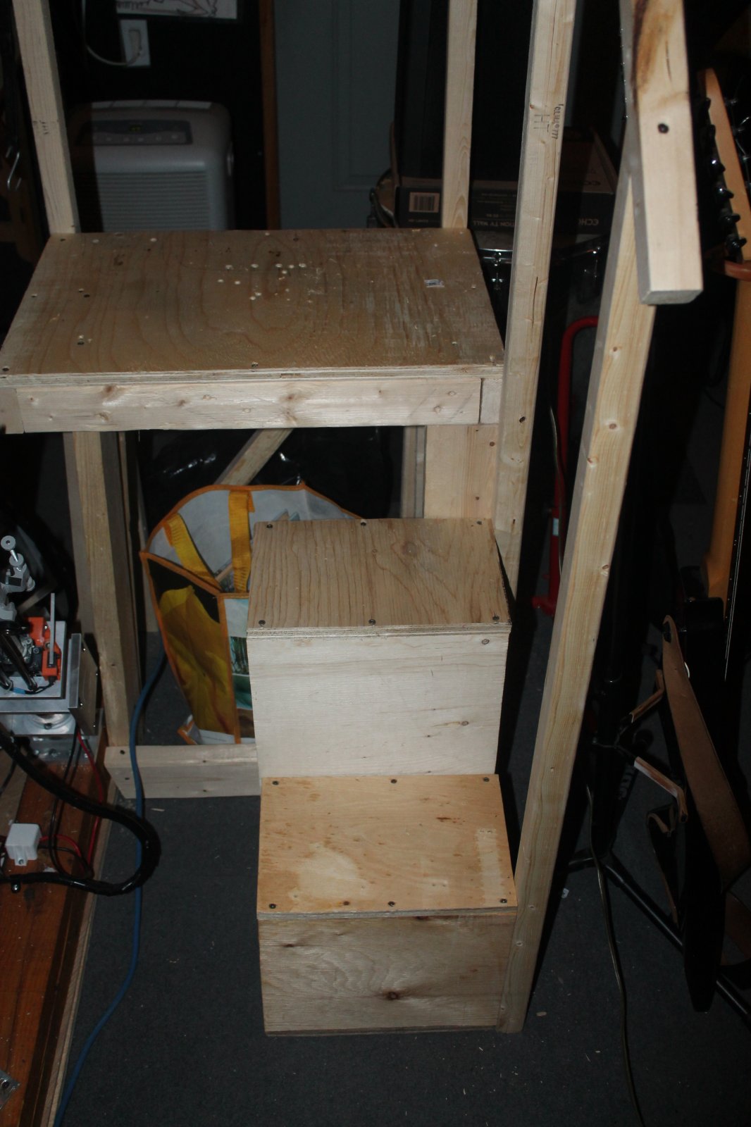

    Not much of an update, but I did the stairs to boarding platform, plus some safety ramps.
    Getting in and out is still a challenge, but it's quite more easy.

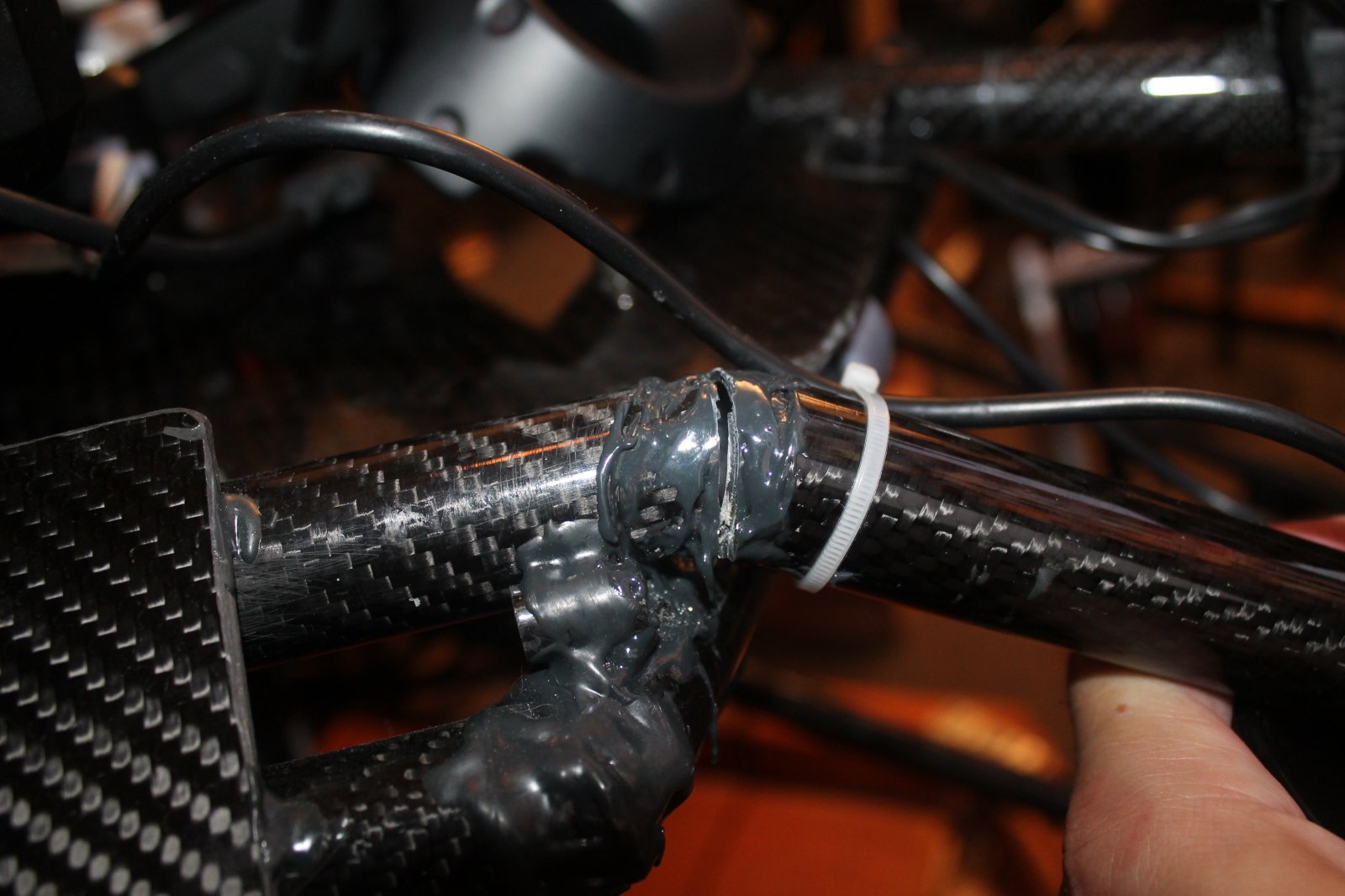

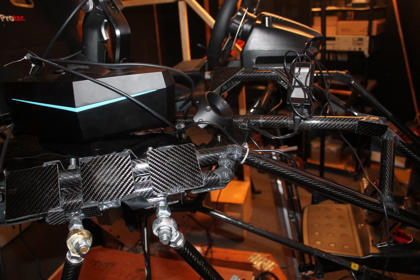

    My rig is officially down for a little while.
    The first reason being Half-Life Alyx. I need my VR setup in an other room, with actual space.
    I could still be using it with the TV screen, but while taking out the wire for the VR, I found out that a corner has cracked. Not just a little crack, but it was totally detached.
    This part hold the pedals. I have no idea when it broke. It could be a long time ago. I need to do some fix and inspect the rest of the rig in case, before getting on again.
    I found that totally by accident. Which is great, before I got a real accident.

    Ouch! good find though. it's our worst nightmare, being in the rig if it were to catastrophically fail. Hope you get it sorted.

    Don't worry, it's an easy fix. I just want to make sure there is no other structure problem. It was a break from the glue part, so, I just have to glue it again (and do it better).
    But it's summer, there is stuff to do outside, and it it Steam summer sale. Half-Life Alyx is now my priority. :p

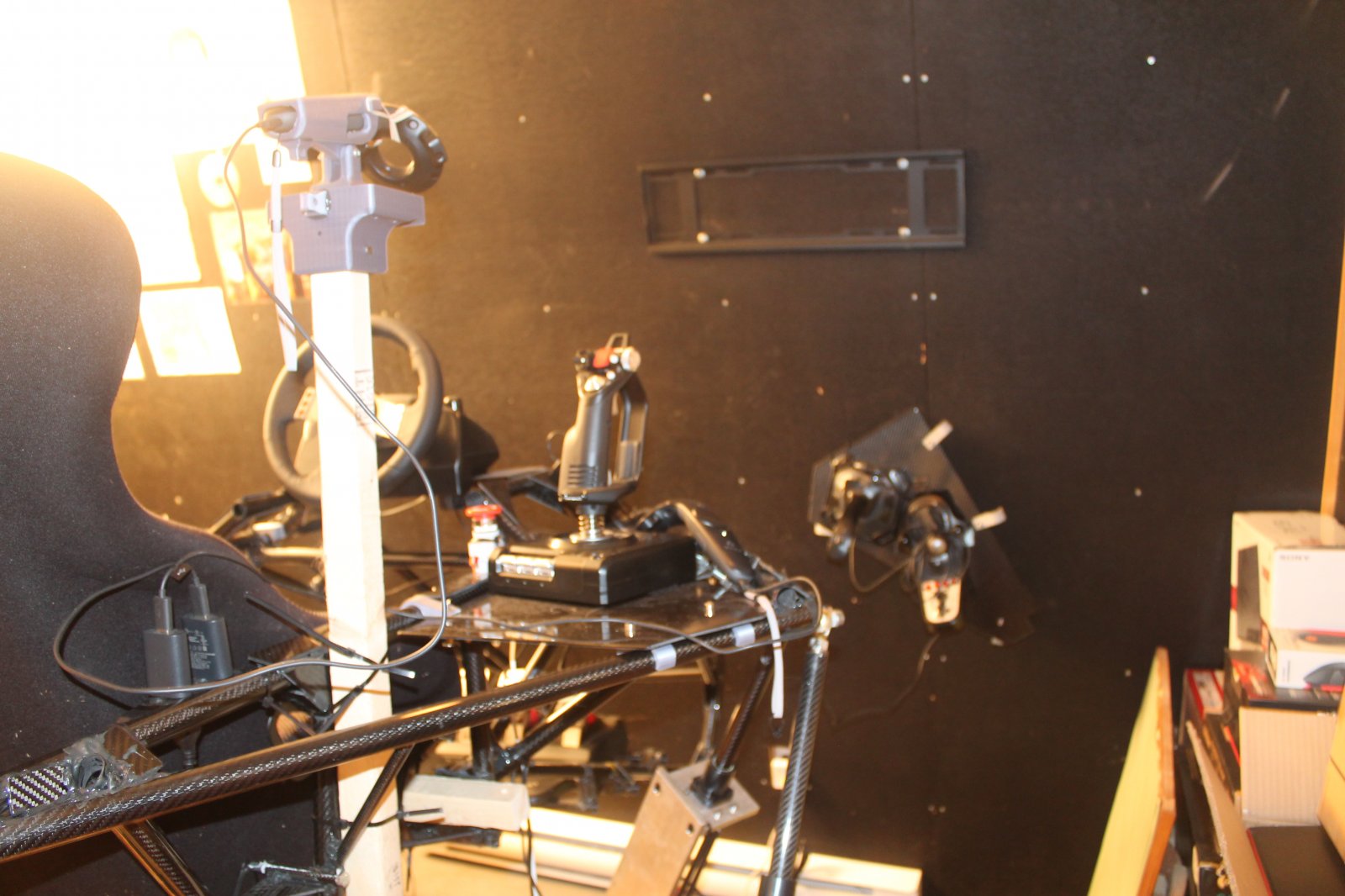

    Hello everyone,
    After Half-Life: Alyx, The last of us part II, Uncharted 4, and many other little test and TV series, I was going back to my simulator. It has been at least 3 months since I used it. I had a few little things to update on it.
    I change the position of my contrôle center.
    Prepared the motion cancellation rig.

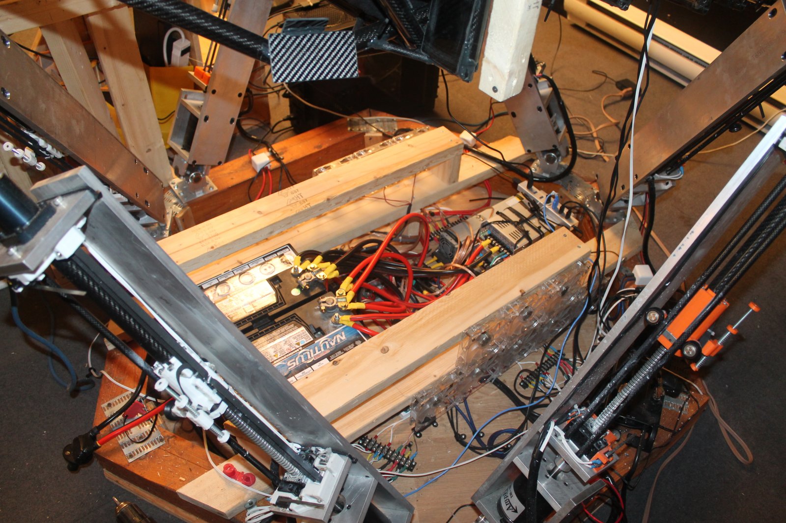

    All that to find out that 2 of my actuators are not working anymore.
    One actuator would have been probably easy to fix, but two, this is a bad sign. That means that eather the arduino or the sabertooth is not working anymore. So I opened up the beast. It seams like an eternity since I look under the hood of that thing.
    The relays and wiring look good. The power is fine. The arduino lights is on, but not the sabertooth. Of course, all are pointing to the most expensive part of the electronics.
    I will have to think about that one. I can either repare, dismantel or redesign the thing. I have a perfectly healty computer doing nothing right now, at it bugs the hell out of me.
    The true is, that I did not like that much the results I had out of that thing. Too big, too hard to get on, hard to set up, to make it work properly. I'm really thinking about something else. Anyway, i always prefered to work on the sim that to play with it. It's the way I am. Quite a curse.
    It might be the end of an era. Depending if it starts again without to spending much money that I don't have right now. Or do I dismantel it in prevision of redesigning it again, later. Who knows (I certainly don't)?
