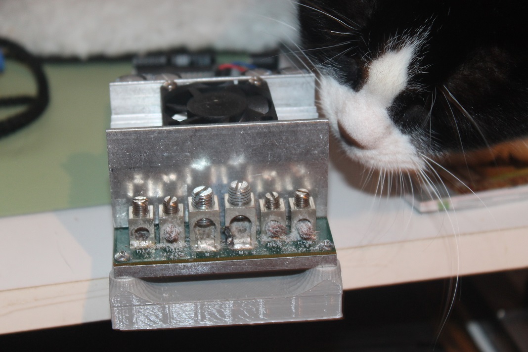

    I have remove the sabertooth and the arduino, but it turned out to be harder than expected. On screw didn't want to turn and 3 wires got stuck and broke into the connectors. The cat is there... Because I could not get rid of her!
    So the thing got more heat than I expected. The soldering I did to each ends of the wires probably got hot and melted down into the connectors.
    Then, I tried to communicate with it using the methods explain in the link from my previous post. It never responded, but neither did the good one I disconnected too. So, I have no idea if it works.
    I need to reconnect the bad one to the good connection and see if it works. The more I test, the more it goes into the redo it all option.

    Okay. I exchanged the 2 sabertooth, and it's still working.
    So, putting back all the code into the arduino that I messed up to end up failing communicating with the sabertooth. It looks ok as it loaded everything back and communicated with smc3.
    All I need to do now is to reconnect those wires and make sure all COM are in the right order.
    I might end up not redoing everything after all... Yet.

    i Had to do a reset to one of my sabertooth... i had put an external battery charger while the batteries were still connected to the 2x60. i guess it didnt like it. and it died.
    i was told by dimension engineering to do a reseat.. which the reset was easy, as long as u have the TTL converter..
    after the reset, my 2x60 started to work again
    WOWOW weee... i cant believe your sabertooth melted the solder...

    The connectors look strange. As if they got wet and moldy or something like this. It could also be corrosion from excess soldering flux.
    Its also not good idea to solder the ends of a wire if you are going to use a screw terminal. The solder will move under the pressure of the screw leaving you with a bad connection. Best practice is to use a ferrule.

    Yes, maybe I put way to much soldering flux from the start. Ferrule (in french Virole, I learned 2 words today) is a good idea that I did not have at the time, and still don't so far. I put the wire directly this time, with no soldering, to see how that will work.

    Those soldered wires in your Sabertooth terminal block looks like a 'cold joint' - too little and even too much heat plus the wrong flux can cause this (also clean off any excess flux) It should form as one solid mass and look all shiny when finished (Many moons ago I did the NASA soldering course in the RAAF (HRHS) - taught me a little bit about soldering). I soldered mine and used it for a few years thrashing my stewart platform and later G systems with no issues. Ferrules are a good idea, but as I wanted to fit the maximum size cable they were not a option and to try and push a big un-soldered high current high-core count cable into those closely spaced terminal blocks would have been risky. I would look at your soldering tools and Technic, as a poor soldering joint is still a poor soldering joint even into a ferrule.

    Always use crimped wiring for high current power lines. If the wiring is not correct AWG rating , solder will melt...
