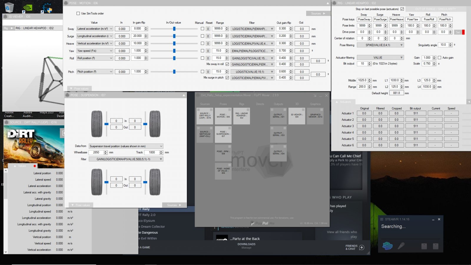

    Spend the owl evening setup to set up Dirt Rally and Mover for it. I followed the instruction video made by pmvcda (Thanks @Flymen ).
    FlyPT Mover
    It is by far the best calibration I ever had so far with my sim. Need to do a video to see how much beating it takes while I play.
