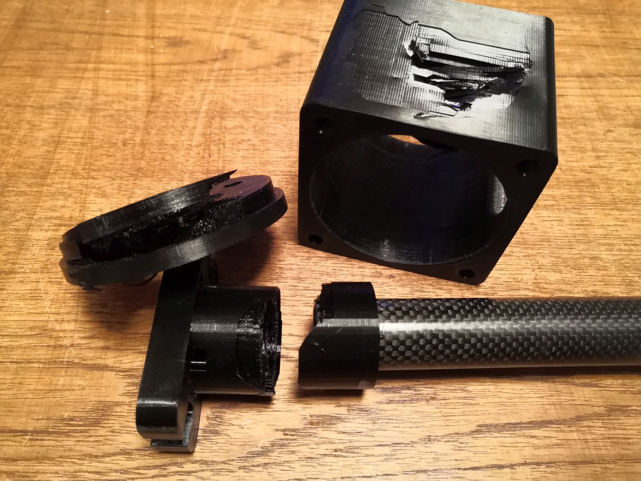

    You don't mean by chance these short interruptions in the challenge to build a working rig?
    Sometimes (especially today) it looks like this:
    But that is not "Kaputt", it´s just a small deformation and more work for the 3d printer. *rofl*
    ... and of course a new "Herausforderung" ;o)

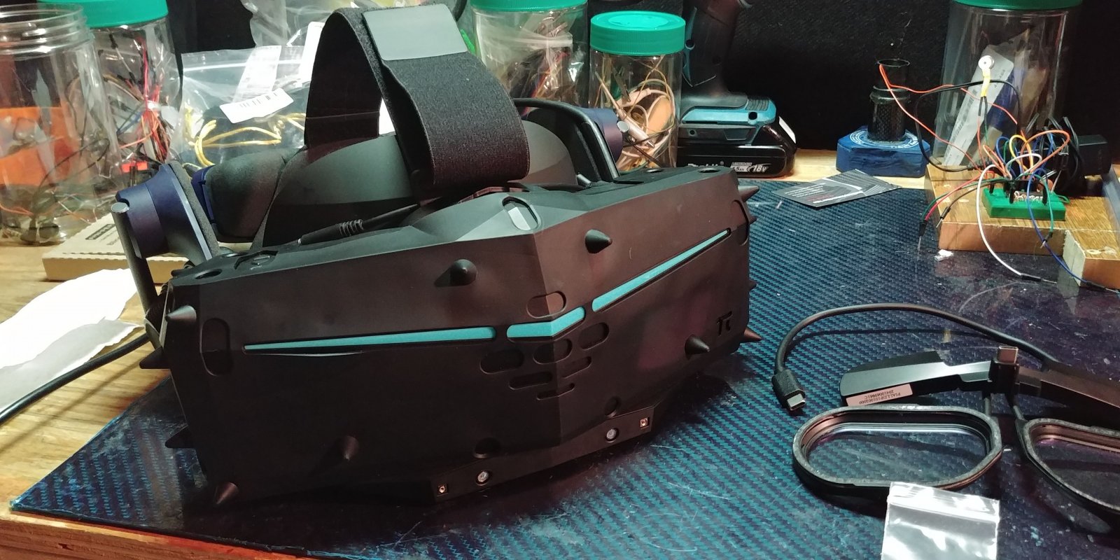

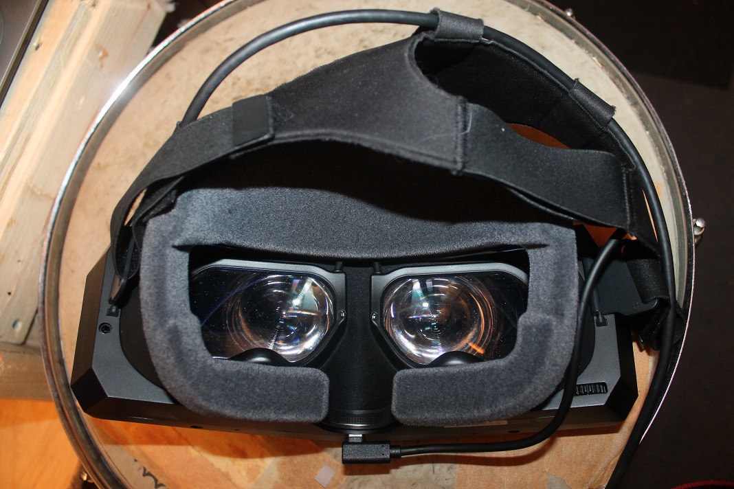

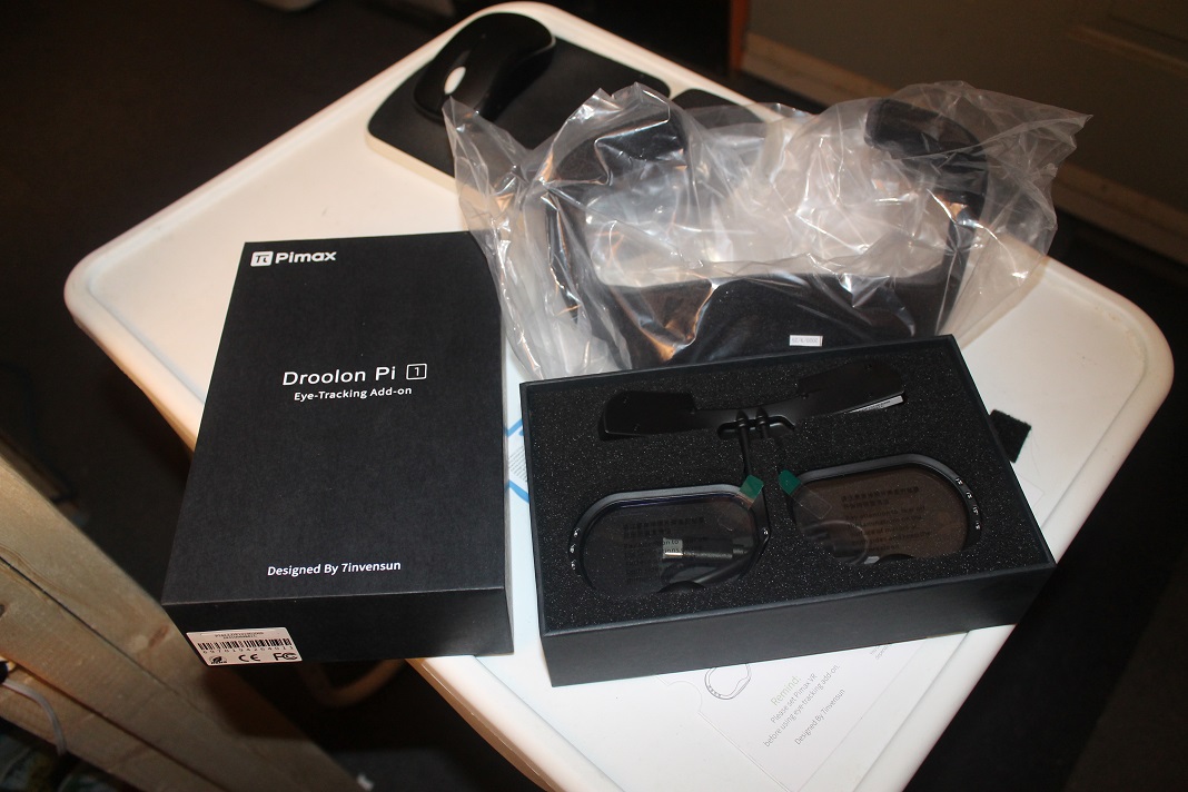

    Like I said in another thread, I received my eye tracking module from Pimax.
    Right from the start: Don't buy that thing. It's a piece of scrap.
    The installation paper is a joke. It basicaly says : install the eyes trackers and follow instruction on screen.
    You have to STICK the eyes trackers ON the lens. YES, STICK.
    The tracker attach to support by magnet that barely hold them up. Cheap.
    It introduces reflection.
    It reduces the FOV.
    It introduces lots of distortion at lens edges.
    It introduced delay in the display of parts of the environment (seemed ok once loaded). The Pimax beta Pitool is required. Maybe that's the problem.
    The New foam is thicker and less conftable for me.
    I calibrated it. It has a delay of 100-200ms. (GTX 1060) and it's not precise.
    I have no idea how it works beside calibration. No further instruction.
    I tested it with Elite dangerous. No change (beside loading delay). I have no idea what to do with it so far.
    I hate it so far.
    Listen to that video for a descriptive example. I had similar results.
    As for the rest. I did a new calibration for Elite Dangerous using my new knowledge from calibrating Dirt rally. I am not quite satisfied. Sometimes, the rig is choppy. Really hard time to get a smooth result.
    • Informative Informative x 4

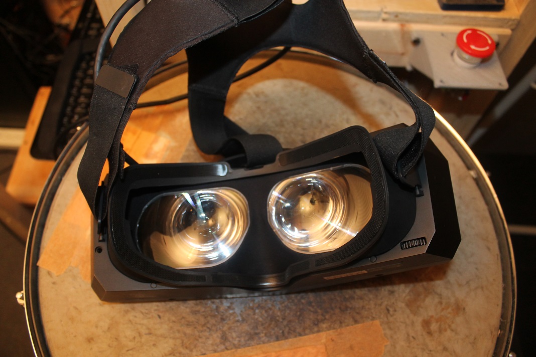

    A little update that is not really one.
    I have installed my KDMAS comfort kit for my Pimax, but I had to remove the eye tracking.
    It looks cool. The eye tracking was incompatible with the adaptor that you have to install for the head wide strap. Of course, Pimax were not aware of this and I had to explain it to them. Am I the only person on earth with a 8k and an eye tracking? They say they are looking for a solution. What about refund?
    Pierre.

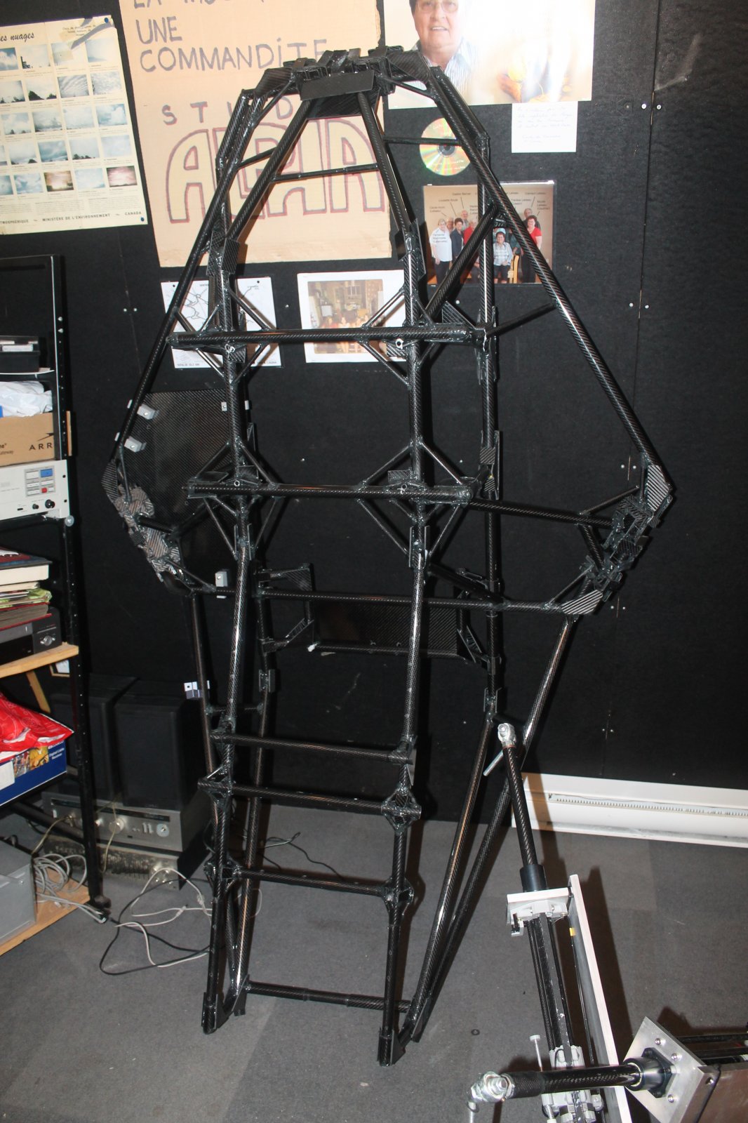

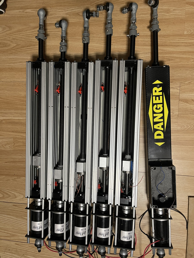

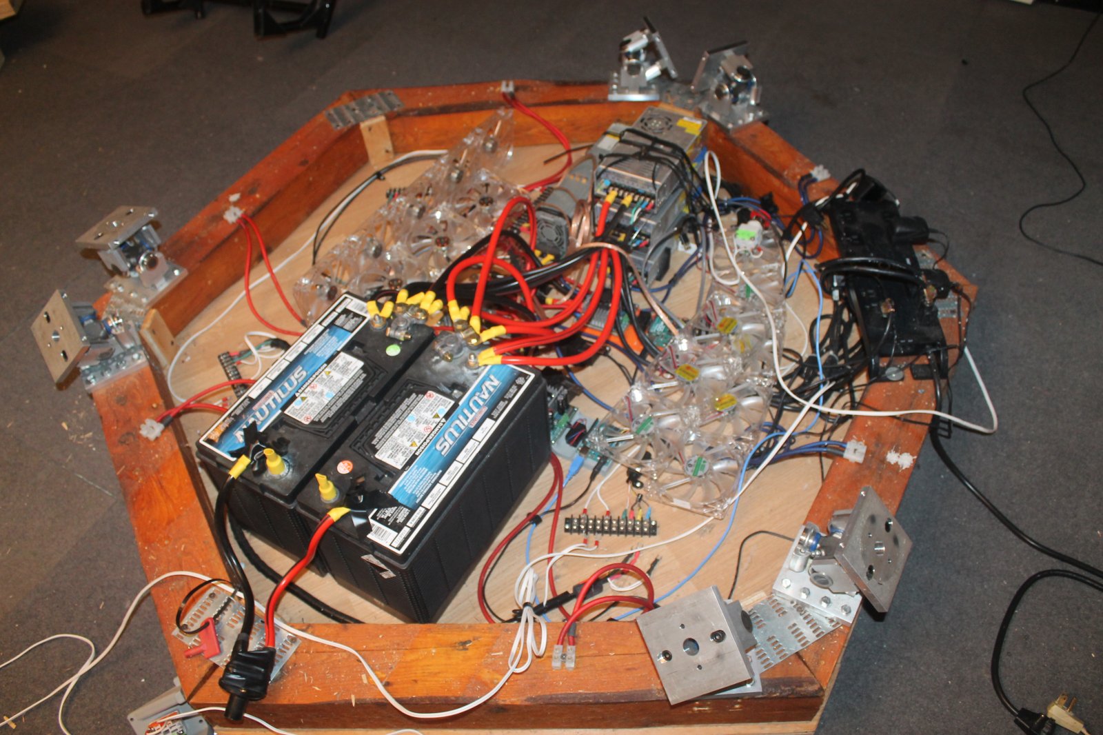

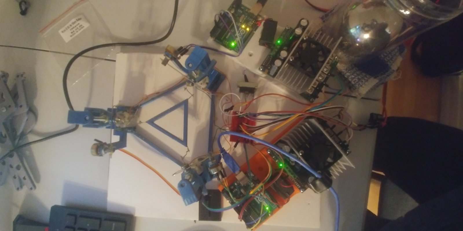

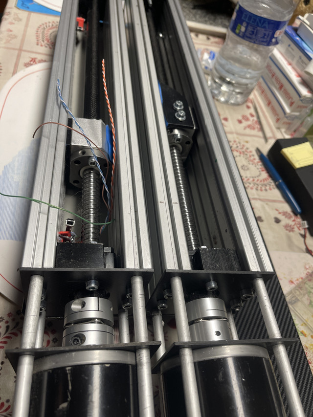

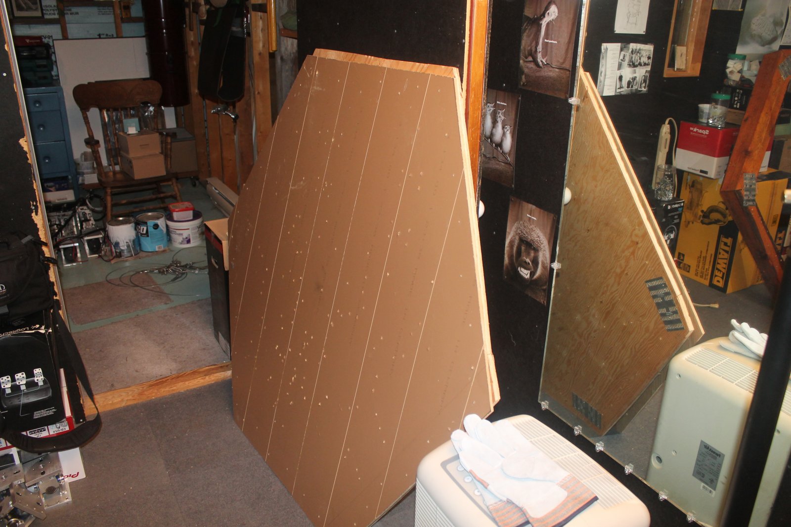

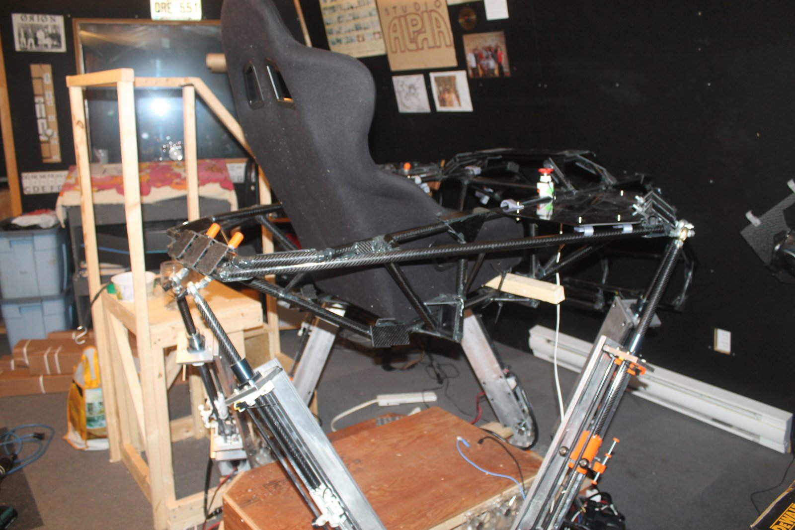

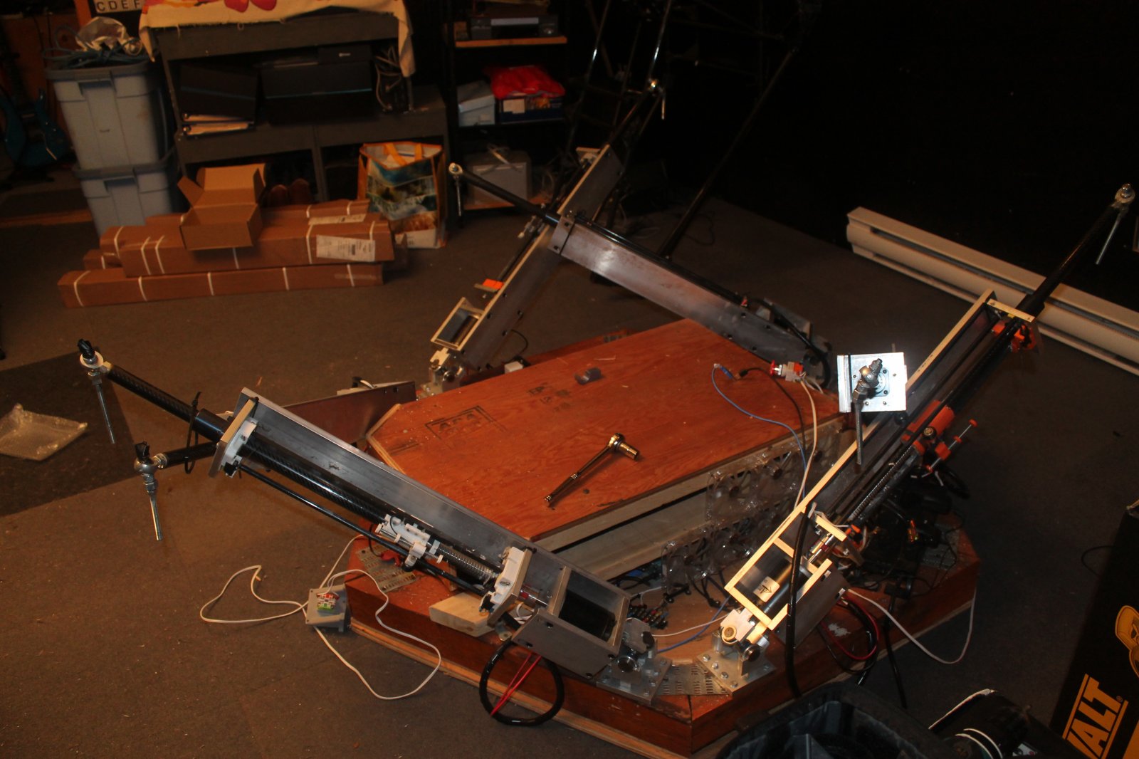

    The end of an era.
    After almost a full year that my rig was down, I decided last year to tear it down. First the controls.
    Then the seat and stairs. Unfortunately, we had to let go our cat and put her down as she was sick.
    Then the carbon structure.

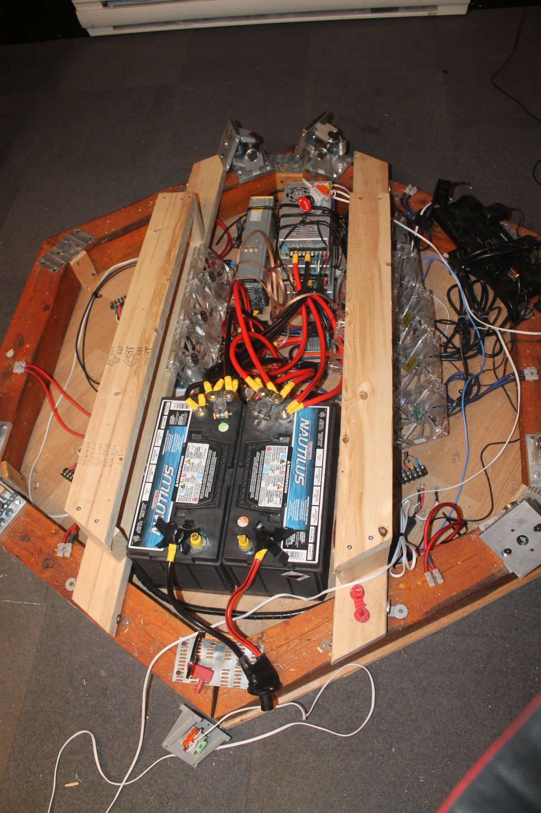

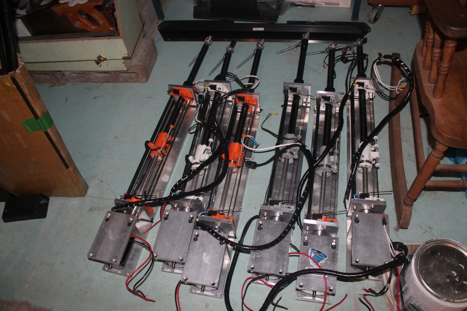

    Then the actuators.

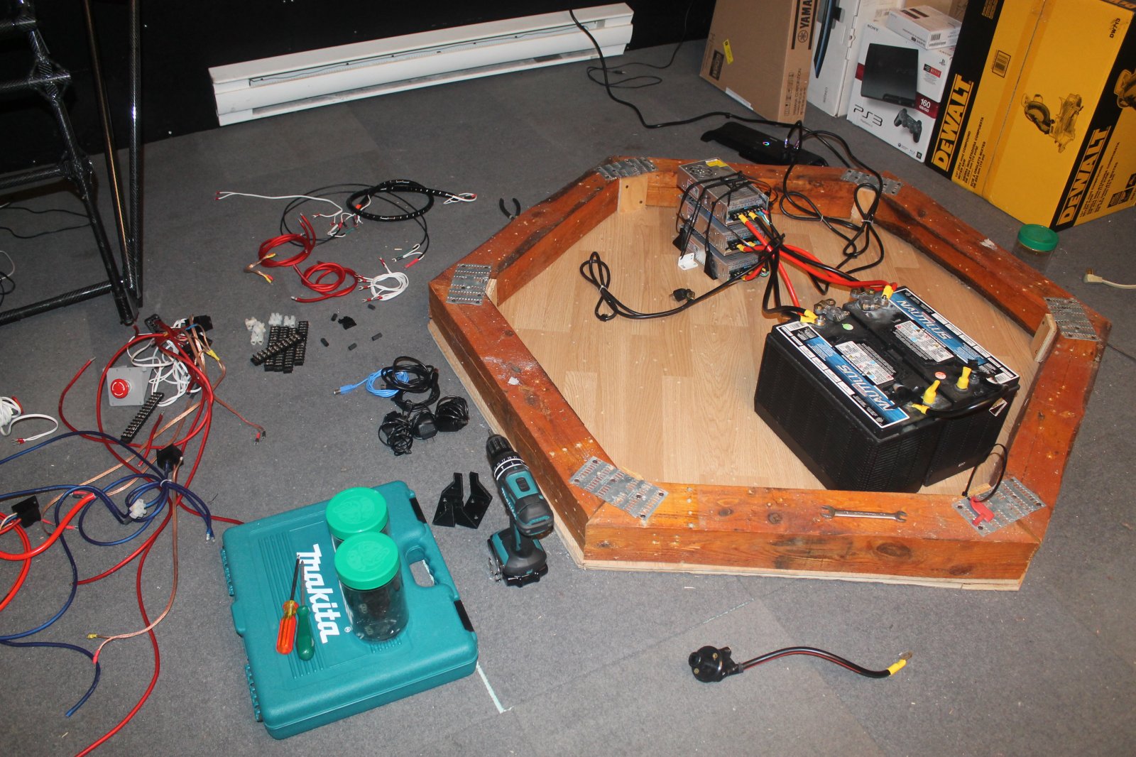

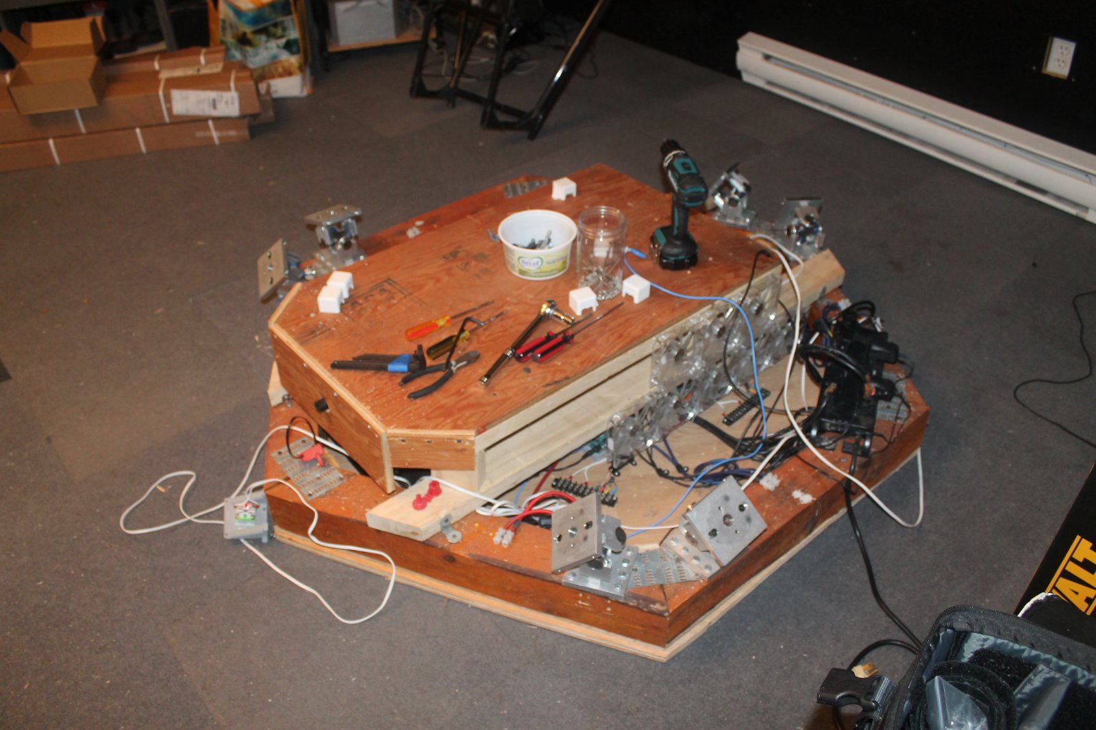

    Note to myself: Never put electronic in a cramped place a ground level. Once again, my wires were mostly cooked to dust by the current (reason for the failure of 2 actuators).
    Remove the electronics and clean the base.

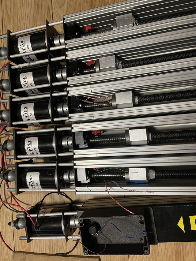

    The good news are that almost another year later, I have moved almost all my stuff to my other house (so I can get back my music studio) and I am starting new experimentations about simulation and rigs. I made this little miniature rig during Christmas vacation, putting my 3D printer back to life. I am testing a rig in the style of SeatTime. I should start a new thread soon.
    See Ya!

    I ended up using three LED Power supply (24v, 12.5A).
    I think the thread is a good read as it is full of good information.
    After, you could check out my new thread where I rebuild it differently with the same parts (almost).
    Lalancelot's Rigs Experimentations
    And in this video, I explain the power management of the motors. It is the same than my last rig.
    I never had any issue with the motors. They are great.
