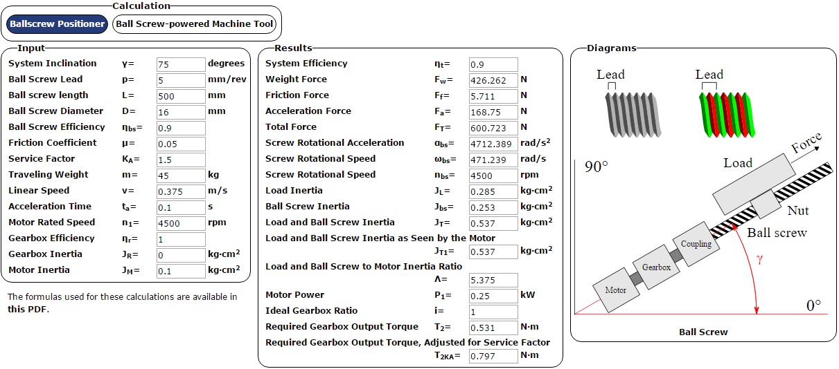

    3DOF, DC motor
    Also as you want to direct drive the ballscrew, use a gearbox efficiency value of 1.0.
    Using .75 will just increase the required power by 25%.
    Those ampflow motors look like relabelled chinese scooter motors, you can buy them for a lot less on ebay.

    Maybe I'll be able to lift up the house. Of course not! I always put extreme scenario, so I know that is I use 6 of them, I won't have to worry.
    I checked your video and I am proud to say that I could follow along. When he said that sin of 0 offer no acceleration and sin of 90 was free falling, it made a lot of sense.
    Agree.
    What really throw me off on that chart is that the power goes up and down. I guess it is because as there is to much torque, the motor simply gives up and the power goes down.
    1Nm torque at 4500rpm, 0.375m/s, sound good to me. Really close to the first target.
    1/5 of 710 = 142 oz-in. Conversion to N-m = 1.00274036033286. I think we are right on the money.
    That is just in case I would eat 2 hot dogs ketchup mustard and a maple sirop pie just before getting up on the rig.
    Make sense. I will keep that load and put a more conventional 75% inclination.
    I was a bit mixed up by the efficiency of the motor that is 76%. What does that mean?
    Do you have an link that I could compare? I could not tell a good DC motor from a refurbish washing machine.
    So now, the motor requires 250 Watts.
    I = 250 / 24
    I = 10.41 Amps, Multiplied by 6 gives 62.5 Amps. I think we are safe.
    But then again, looking at the chart, the power for 1 Nm torque is more 460 Watts.
    Mmmm, that power curve really puzzle me.
    Required Gearbox output torque: 0.531 and 0.797. Still in the safe zone.
    I think we are good. Did I forgot something?

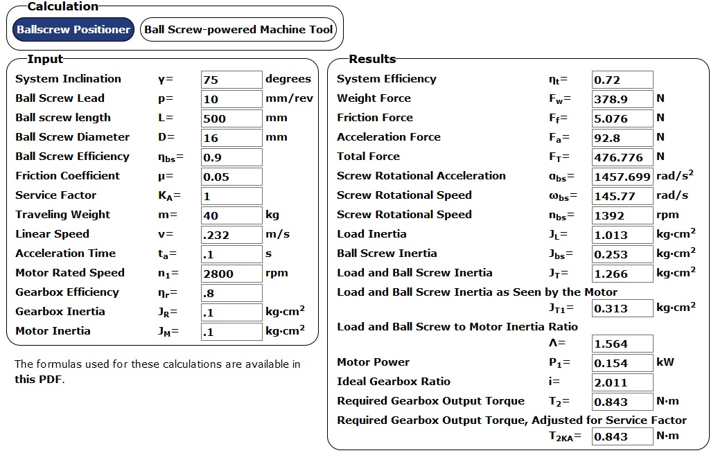

    You're confusing mechanical and electrical power. At stall torque mechanical power equals zero, because of zero rpm. Looking at the performance chart (which shows mech power), you'll notice that the motor will then draw like 125 amps (at 24V). So electrical power will be 3000W. Nothing converted into mech power, but everything converted into thermal power. A big heater (and smoke generator after a few secs)... ;)
    See above. 76% of the electrical power gets converted into mechanical power. Rest is frictional and thermal losses. Output of the calculator is the required mech power. But you can enter motor efficiency into the gear efficiency input field. Then calculated motor power will be electrical power. Just keep in mind that motor efficiency isn't a constant value. So e.g. at 2Nm torque, efficiency drops to 56%.

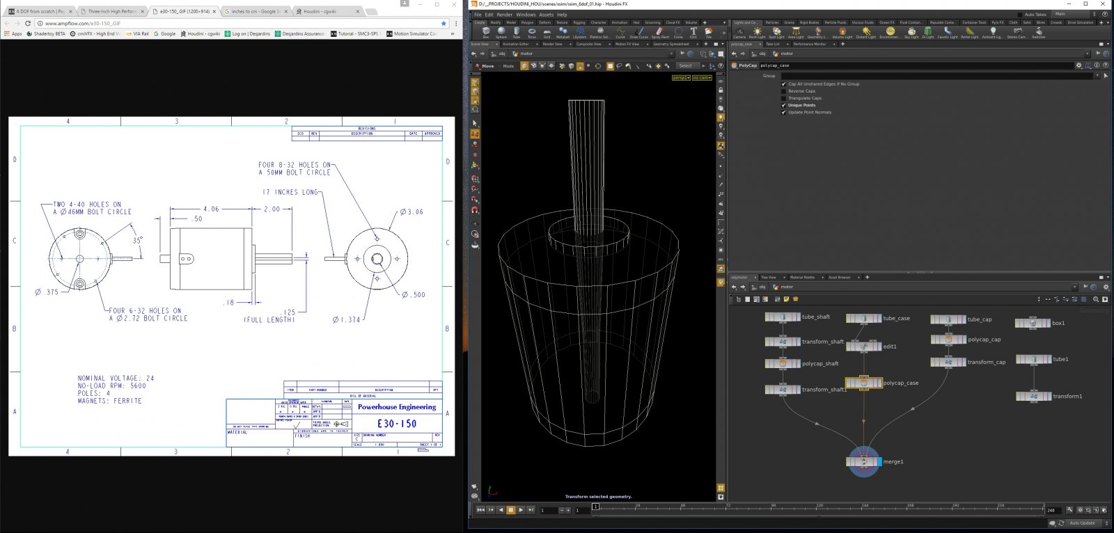

    And last, until I can afford any more equipment, I started to do 3D design of my simulator. Since I am learning Houdini, this was a good project for it.

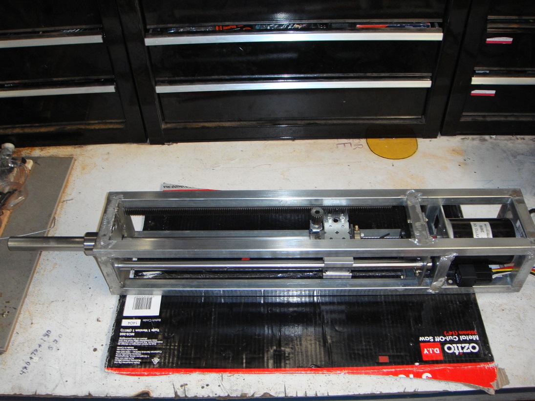

    Nope - PVC won't do. Steel pipe or something similar - A bit of history, like when I built my first actuator a few years ago. Pipe was close in size, but had to be hand finished to properly run in the linear bearing.

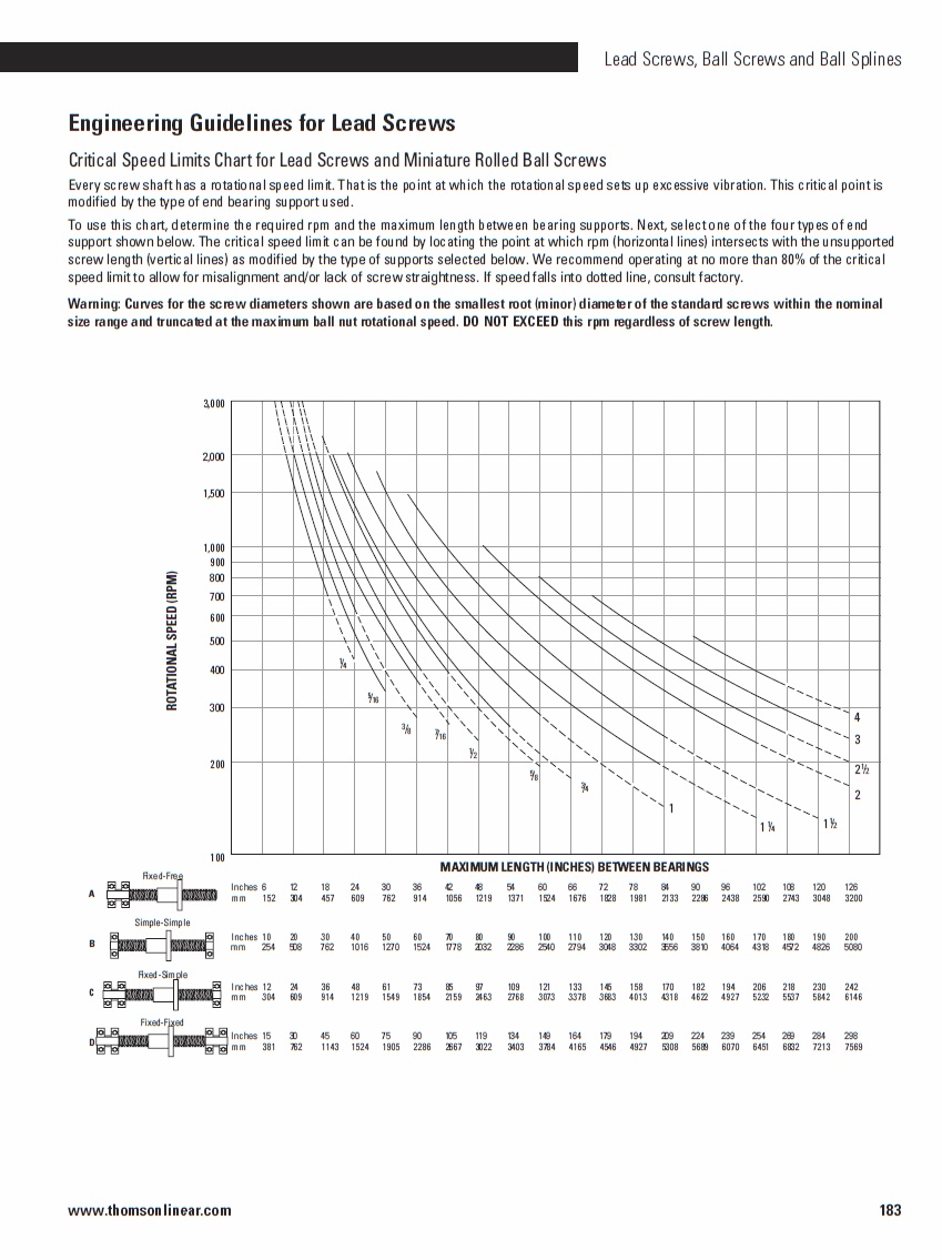

    source http://www.thomsonlinear.com/downloads/screws/Leadscrews_Ballscrews_Splines_cten.pdf
    A 16x5 ballscrew has a root diameter of approx 1/2"
    Roton should correct their app notes.
    "Ball velocity in a Ballscrew should not exceed 3,000 rpm x in. (rotational speed (rpm) times the nominal diameter (in.)). For example, a 3/4 x .200 size Ballscrew should be limited to 4,000 rpm (3,000/.750 = 4,000 rpm)."
    3,000 rpm x in. (rotational speed (rpm) times the nominal diameter (in.) does not equate to their example 3,000/.750 = 4,000 rpm
    Nor do they take in to consideration length of ballscrew.
