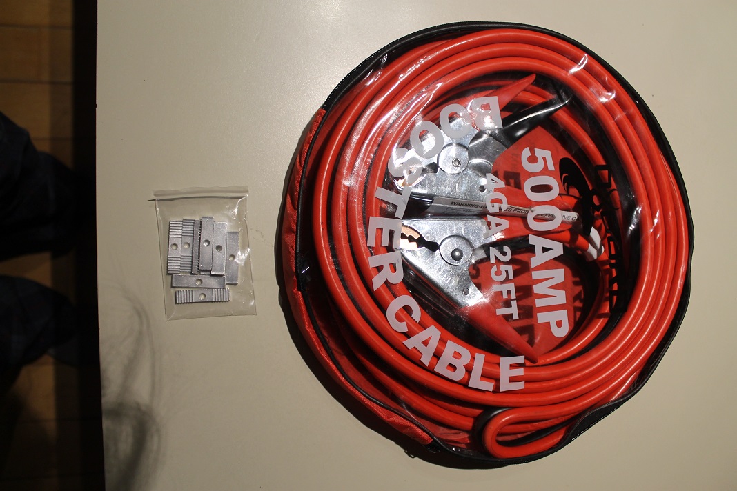

    I have receive other gifts from Santa.
    Cables and strap locks. Those wires are huge. They might be hard to solder to the power supply. Anyway, I don't think I'll have much time this weed-end to work on the power supply.

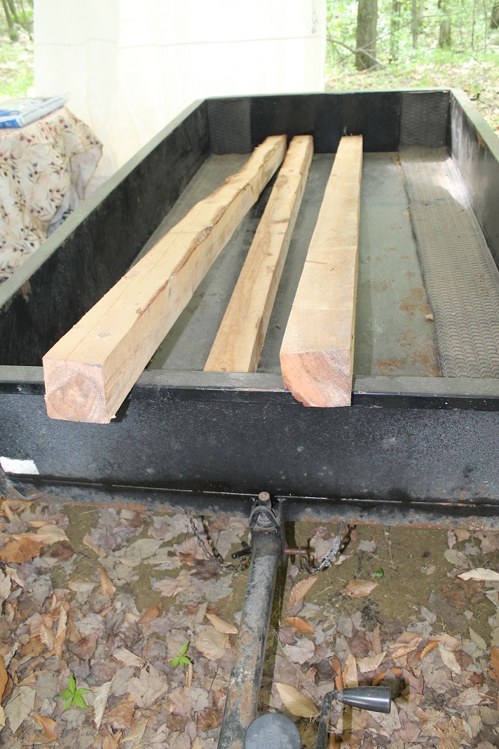

    Some wood for the base. I help my brother with cutting all is wood, like we do every years, and I ask him to have logs to build the base of my simulator. Will have to determine the size of it and cut the wood accordingly.
  15. SeatTime
    2,572
    +2,854 / 40 / -0
    How seasoned is the wood? Hate to see it all warp on you when it is sitting as the base of your sim on a floor.
  16. Pierre Lalancette
    Dec 11, 2016
    1,012
    Tech Artist
    Quebec, Canada
    8,052Coins
    +947 / 6 / -0
    3DOF, DC motor, Arduino, 6DOF
    I asked my brother if it would work over time. I know as much about wood than about DC motors. He told me that it has been cut for a long time and there was no problem. It is hemlock spruce, quite heavy.

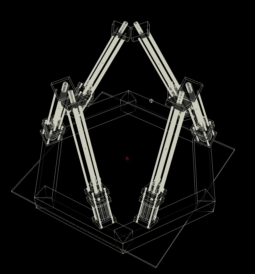

    Trying to figure out a few things. Less easy than I expected.
  18. SeatTime
    2,572
    +2,854 / 40 / -0
    There is nothing easy about building a 6DOF :). Especially once you start building six of everything. If it was easy everyone would do it...:D

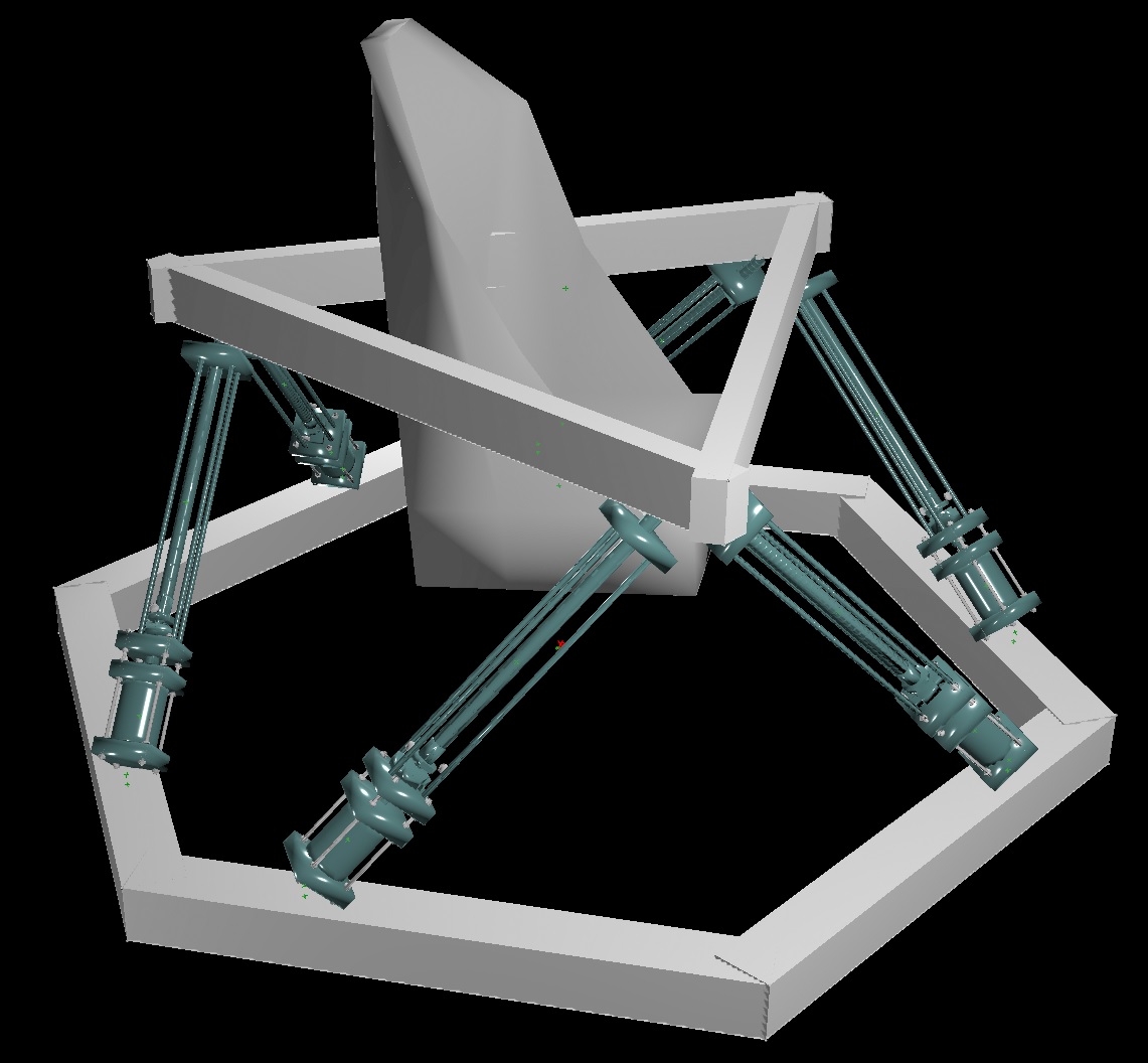

  20. Pierre Lalancette
    Dec 11, 2016
    1,012
    Tech Artist
    Quebec, Canada
    8,052Coins
    +947 / 6 / -0
    Still pushing stuff around. With the incredible seat modelling. At least, it's about the right size.
