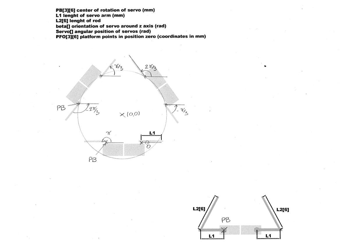

    Thank you Robin
    But i'm still don't know what PB means. From where to where is this measuring? Could you also imagine the other measurings (beta, Servo and PFO) a bit more? From where are platform points in zero pos and is the orientation of servo 4 and 5 the same or is one in positiv and the other in negative? Please complete and Ilustrate for 6DoF dummies :D
    Many thanks...
    Greetings Martin
  2. Robin
    Robin New Member
    May 8, 2009
    44
    51Coins
    Hello Martin, great to see someone interested in 6dof design!
    So I'll do my best to explain this, if this is still not clear don't hesitate to ask questions.
    Servo[] are the angular position of the servo, it's our output variable. In 6dof master source code these are in radians. The servo moves, so that the platform moves. When a servo moves, the servo arm moves to a given position (Servo[] is this position) around its rotation axis. PB is situed on the rotation axis of each servo. This points give the correct positioning of the servos to the software so it can apply the reverse kinetics algorithms. For good accuracy you can mind the KneeCap and ServoArm thickness as I did in the previous drawing.
    All PB[] points should be situed on a circle which center coordonates are (0,0,-height).
    All PF0[] points should be situed on a circle. The center of the circle is the origin of the cartesien system (0,0,0).
    PFO[] are the basic points for the platform but are nor used in reverse kinetics algorithms. The points used are PF[] which are calculated like this:
    PF[] = PFO[] * pratio;
    PB[] = PB0[] * ratio;
    About that your graphic, there seems to be a mistake, maybe need to replace the servos.
    Hope this help, see attachement ;) .
