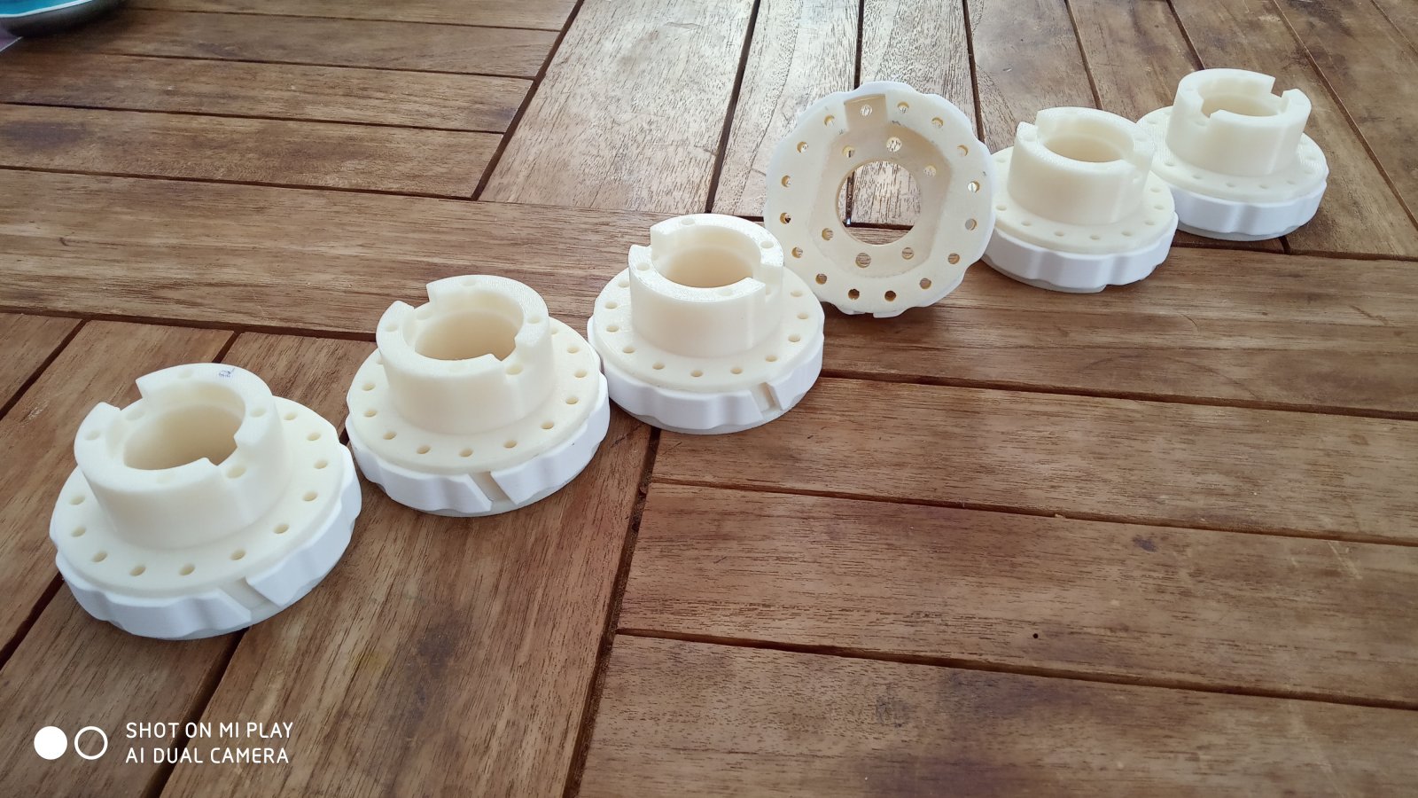

    An example of 3D print and CNC version ;)

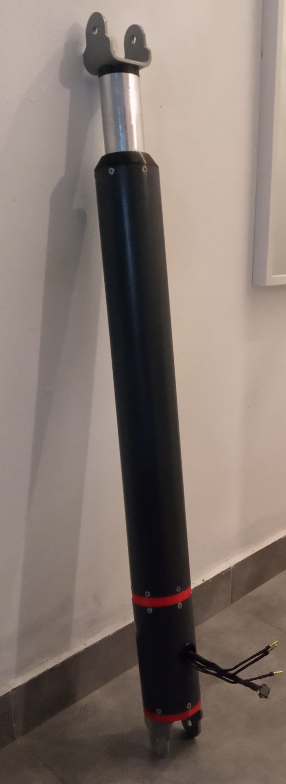

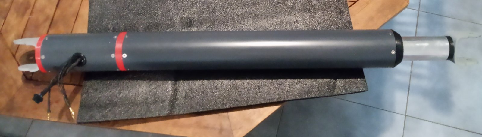

    Just a photo of my finished actuator ;)
    Fit and strong ! :) IMG_20210311_193938.jpg

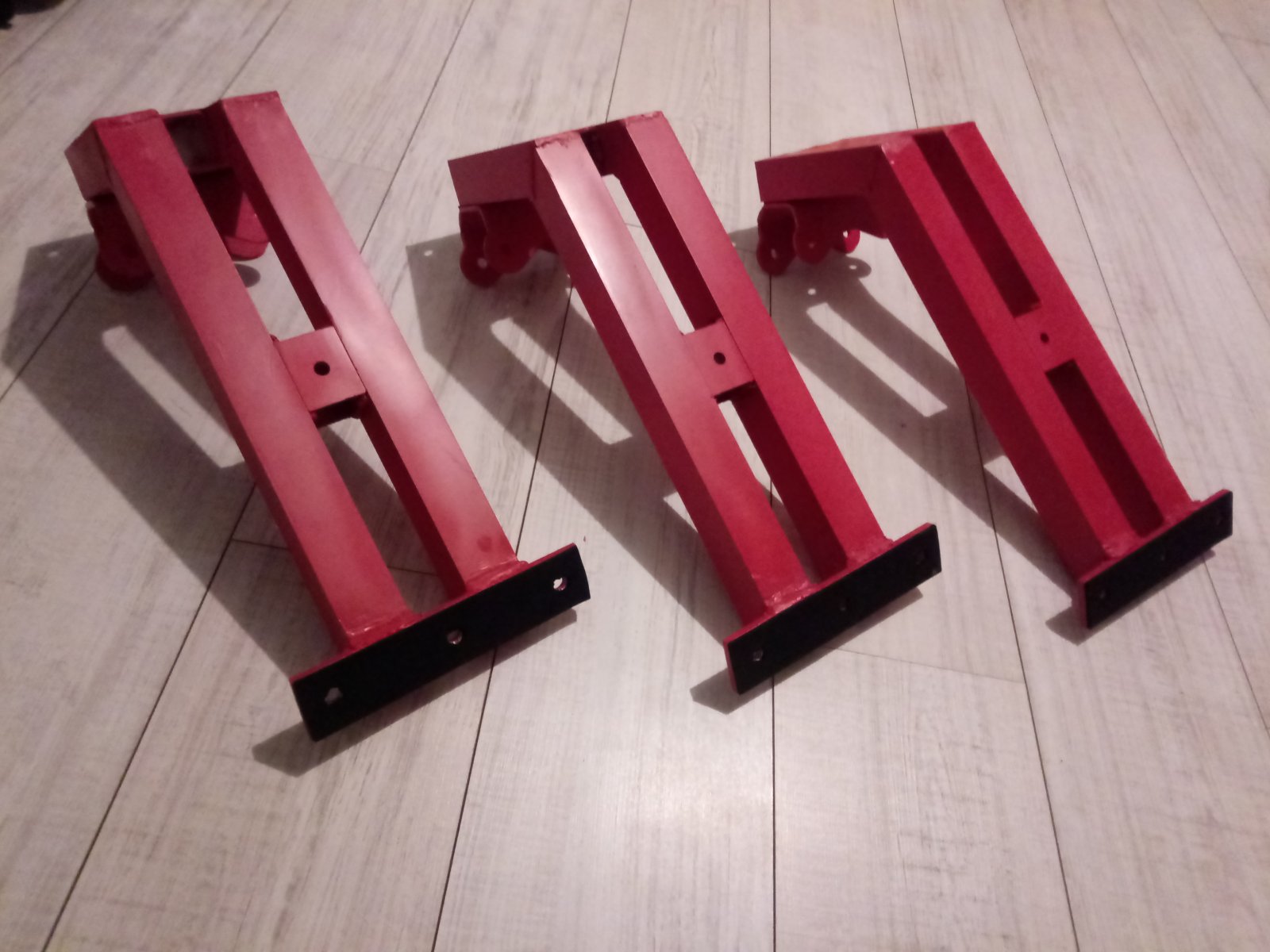

    The different arms are ready :) !!! It looks so pretty ! P10517-194213.jpg

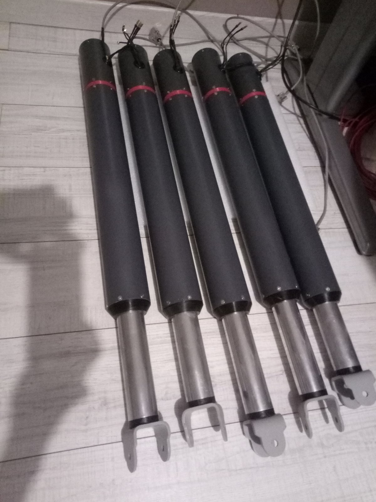

    The six actuators are also ready ! (The missing one is on my bench test) P10524-221915.jpg

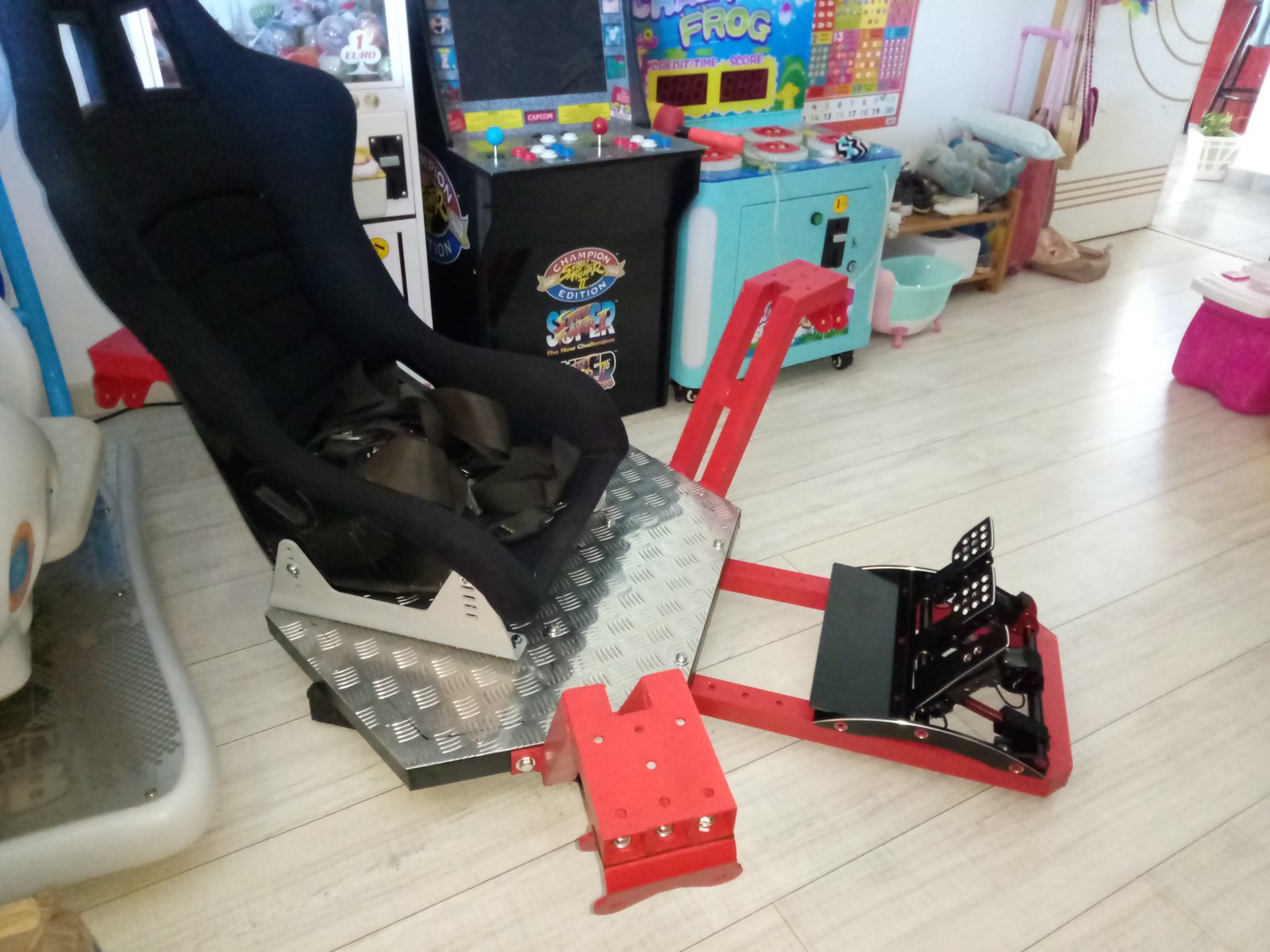

    The upper platform is ready !

    Hi everyone,
    Just a short video to show the rig in action. All plastic parts seems to be good ! My 3D printed linear actuator concept is OK !!!! I tested the rig with 90 Kg user and there was no problem. Demonstration of plastic parts is OK ! Now, it's time to switch to aluminium parts :) !!!! Actuators will be more professionnal and strong ;-) See you next update !

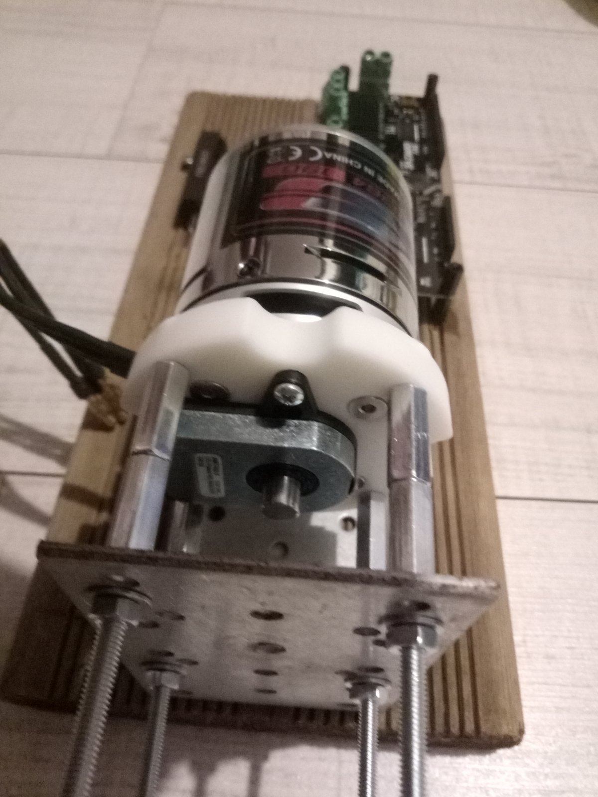

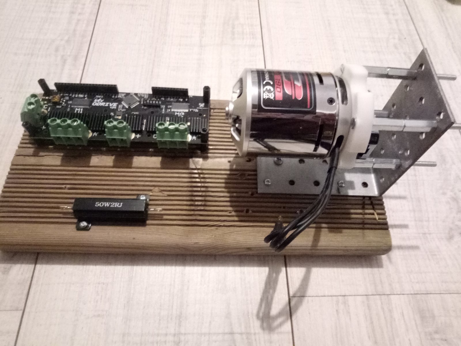

    hi,
    I'm using Brushless DC motor. It's the same motor that you can see on my bench test page 1. Power is about 2450 Watt....

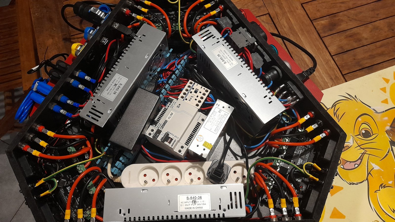

    Hi, just a short update,
    I work on my electrical box..... It's pretty finished ... It misses the cover grid... Electrical box.jpg

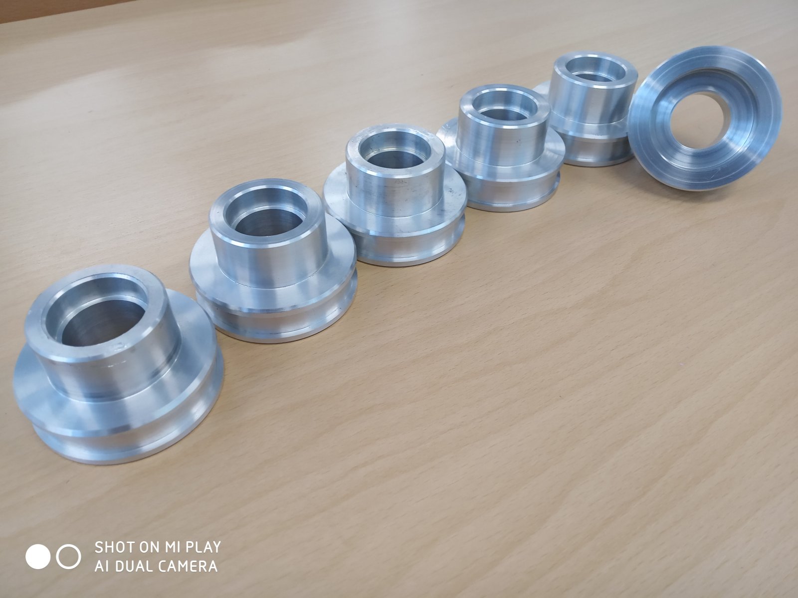

    The rig is still in development.... I have stopped the rig to update actuators by switching plastic parts with aluminum parts... I must also replace the encoder cable with a high quality shielded cable.... and many things... It takes many times but at the end, the rig and actuators will be stronger !!!! Photos will come soon ;-)
