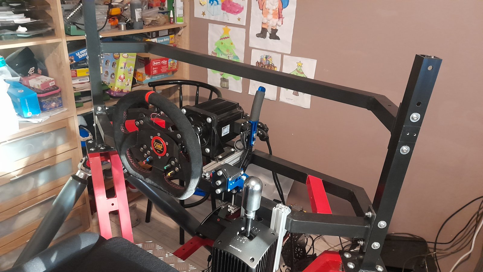

    Hi everybody !!!
    The construction is still following....VR headset is cool but it makes me sick..... So i decide to update primarily the custom triple screen mounting as you can see on the photo. The support of the screens is maked with 3d printing parts . (10 mm thickness). For a first test, i can see that it is really strong... 20220722_172104.jpg 20220715_154915.jpg

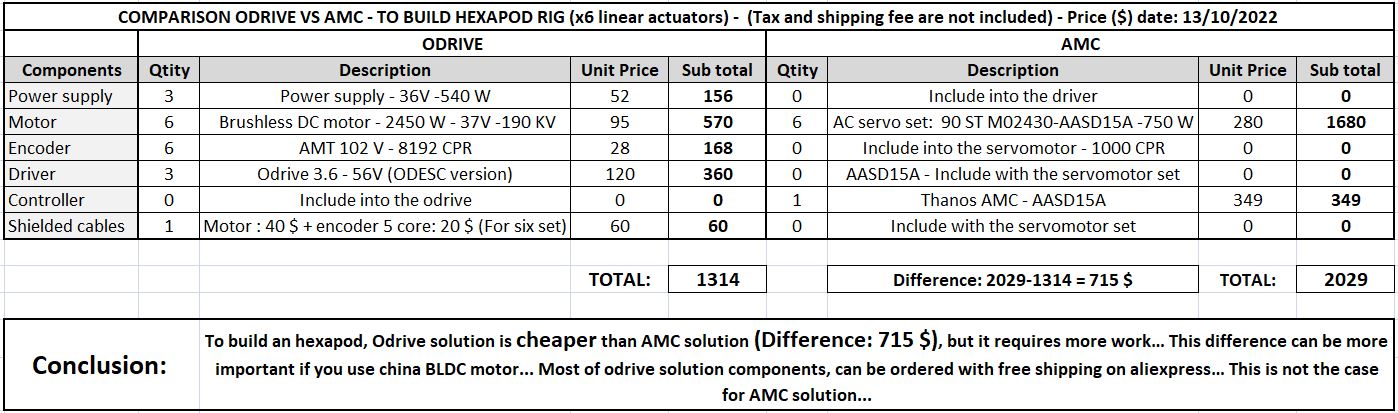

    Many people ask me always the same question.... Is odrive solution cheaper than AMC solution ?
    This table is my answer to this question... I'm sure that somebody will not be agree with this table...However, i give you the warranty that prices is true and come from my real experience.... I don't want to discuss about this subject...Make your choice my friends ;-) Comparison -Odrive vs  AMC.jpg

    Just a quick observation, the thanos cost should really be divided by the number of actuators as no one will only be using 1. Most people would be running 4, so this should be shown as $87.25, taking the total of each AMC unit to $357.25

    Thanks for the observation. I have updated the table . :)

    In the table you mention that Odrive is cheaper but requires more work, you detail the cost in the table of the Odrive but not the comparative complexity. Do you intend addressing the latter in some sort of similar comparative chart?
  16. Will974
    Will974 Active Member
    Jan 11, 2020
    134
    Industrial Ingeenering Teacher
    Reunion Island
    965Coins
    +141 / 1 / -0
    My table is just a comparison with the price criteria only. As i write in the conclusion, Odrive solution requires more work. But in my experience, it's not really a problem if you have technical experience...And more, you can find several tutorial for odrive configuration... You have just to apply.... When you use odrive, you are really in the DIY world...

    I raise this as complexity has a time cost, and potential risk of project failure/delay, with a number of members already having to seek considerable support re Odrive use.
    That is not to suggest that Odrive is flawed, but if a detailed cost comparison is drawn it is only fair to also point out the potential time and possible project completing impediments.

    I'm fully agree with you... That's why i wrote in my conclusion "Odrive requires more work...." . This table was the answer of a member that's asking me the price comparison in another thread....
    Me and other odrive users are working to simplify the use of Odrive. It will comes later ;-)
