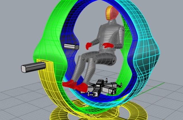

    Designing Carbon Fibre rings
    Well this was harder than I thought ( probably not the last time I am going to say that! )
    CF has great tensile strength, not that great compression strength but here I am asking for the rings to be able to have forces if two planes.
    Yeah I have to design for max load in one orientation and max load at 90 degrees to that orientation. So its all about bending moments and area moment and lots of physics. Sooo much easier if I was to do this with mandrel bent box tube steel. But then it would look as agricultural as F#$%.... and who wants to make that.
    With Carbon fibre Tension is good
    The design will use an outer light weight weave for cosmetic appeal.
    Reinforcement right underneath of uni-directional wide tape with supporting verticals coming into the central plain.
    All the strength comes from the ring wanting to either;
    1. Collapse the weight of the ring down and pushing the side out
    or with the weight on the bottom
    2. Collapse the ring down in the bottom centre pulling the sides in (like standing on plank of wood)
    The answer is to use the outer skin in high tension like the metal rings on a wine barrel and support them with verticals on the inside.
    I needed to remove a scection of the inner skin to allow me to;
    1. Mould the damn thing up, I have to get the stuff in there.
    2. Lay wire and the like,
    3. It will filled with foam and laminated to add strength and rigidity.
    This is a small video snapshot with the other little mind stimulating CAD shapes I used to do mass calculations and just to get me realising where the forces a really were.
    Horizontal stiffening next
    This is just the vertical forces, now I have to add structures to resist the strain when the ring is parallel to the ground.
    That is a whole different discussion. And it also means laying up CF weave in different direction and good quality bonding agents or adding a strange vacuum bagging techniques...which I only mildly want to think about right now.

    After some calculations (and more estimation than I like to admit) I now know the Torque I need to apply to the rings to produce 250 degrees per second roll and pitch, with 120 degrees for deceleration to stationary.
    So if you're rolling at 260 degrees a second, I am giving 120 degrees from full speed rotation to totally stopped.
    Who can figure it out?
    Anyone wanna guess how much Torque in N.m of any other force x distance that is required for this with a 100kg person and 35kgs of motors under them and all that other junk?
    Its not a small force.
    Lets see who gets close.

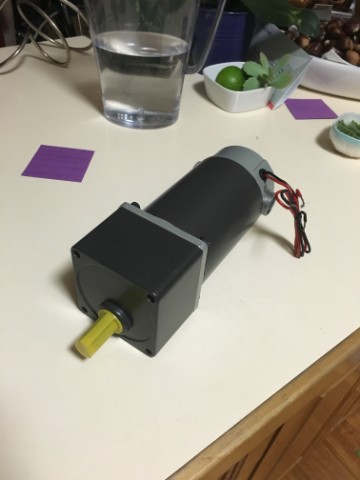

    One sample Motor purchased.
    200W DC 24 V 20:1 spur gear ratio.
