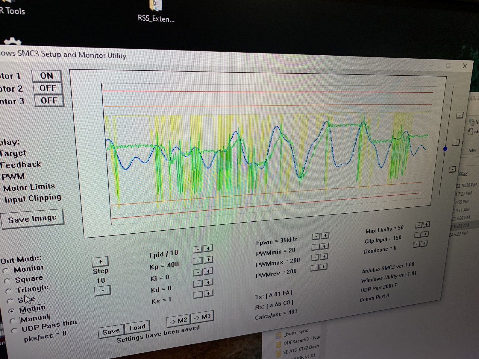

    So I did a bunch of testing last night. That last screen shot with all the noise on the green line must have been from a wiring issue because I elliminated that when I simplified the wiring and am testing just a single motor at a time. I was able to confirm the pot is fine, and I was also able to confirm that all my IBT2 controllers I was using are working fine by testing each one with one of my other motors/pots.
    So I hooked my new powerful motor up to what i now know is good a good pot, a good ibt2 and a good arduino and I was still getting the cutting in and out.
    So my conclusion is that eaither my PSU or IBT2 must be cutting out when it gets spikes.
    So I have ordered a 1000w PSU which will arrive tomorrow. I will daisy chain 2 or 3 IBT2s and connect them and just this single motor (which is a 600 watt motor) to the 1000 w PSU and test again.

    Oh! The other thing that might be a clue is the fact that when I am in SimTools and running a game and the motors all of a sudden stop, I can quit SimTools and open SMC3 and I get full motion. So that tells me that the motor controllers didn’t overheat and the psu didn’t trip because the motors still active when I open the utility without waiting at all or restarting the Arduino

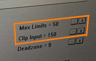

    My guess is it's something to do with your clip input and max limits settings?
    Max Limits Used to create a band at either limit of the feedback range beyond which if the motors move (typically through inertia) the SMC3 will automatically shutdown the drivers and keep them disabled until reset. This is essentially a safety mechanism if something goes wrong. The value can be between 0-255 (however can’t be greater than the current clip setting).
    What happens if you set the clip input and max limit settings to zero in the smc2 app, and then simply set axis limiting to 90% in SimTools?

    @noorbeast I think I misspoke about using the same settings regarding your comment "With respect to the SMC3 settings for the heave motor, those should be optimised for that hardware combination, not the same as some other hardware combination." I just meant I used the same Interface configure, like baudrate, and that stuff. I did adjust the actual motion settings seperatly.
    @yobuddy I just gave your suggestion a try setting the clip and max limit to zero, and I even reduced my axis limit down to 50% but it still stopped working after a few seconds of driving.
    BUT maybe it actually IS the PSU. I was thinking before that if the spike was above the PSU limit it would cut out, which is does, but I think they come right back on again which is maybe why I seen the motor still working when I shut down Simtools after a failure and opened SMC3 and everything worked.
    I get my 1000 watt PSU today, so I can test that theroy and I will report back
