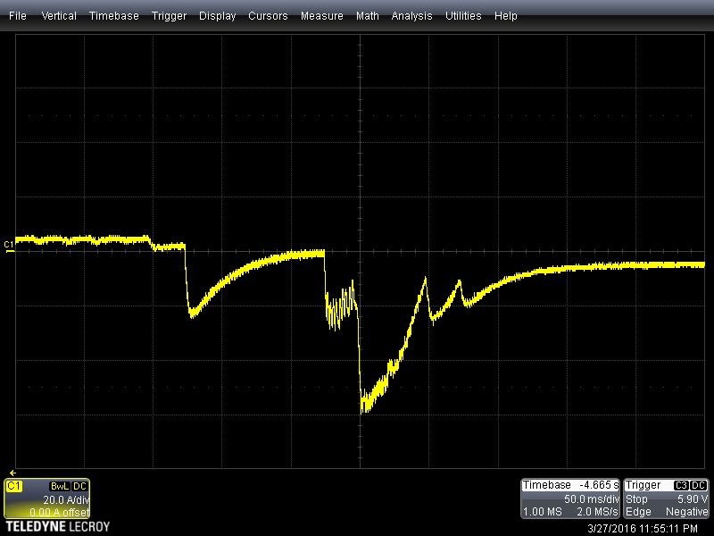

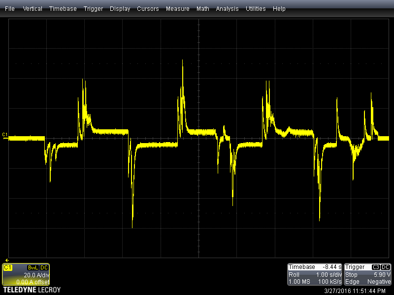

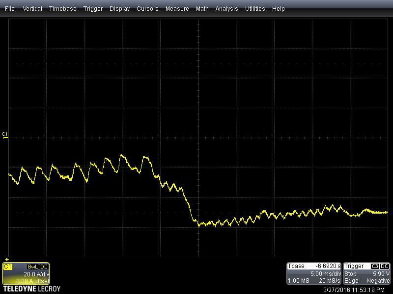

    Just took some scope plots of the Bodine 42A motor. Here is the video to go with the plots. @bruce stephen, @cgodwin, this information might be useful to you both.
    Scope plots display 20A per division. As you can see that @ no load, on reversing the current draw jumps up to 60A which I believe was clipped by MM. The power supply is rated for 47A. I called Bodine and the only number they give out is "23A rated current" :mad:
    I think with full load, I will need more juice out of my power supplies. I am thinking about wiring three of HP DPS-600PB power supplies in parallel for two motors and two MMs per motor, which should be enough.
    Any thoughts or suggestions would be appreciated.

    Those lever assemblies look familiar :) My roll lever is about the same CTC as yours using your outside holes, and my pitch lever is much longer. I haven't had any problem driving that, but of course my design is completely different that yours. With your geometry you don't need as much CTC.
    I'm still about 2 weeks away from having my sim back together, and then I'll check amp levels. I would guess the PSU's can absorb a pretty big spike. The 47A rating should be continuous, and the big capacitors in the PSU might allow it to handle a 60A spike without a problem. I might have gotten away with it in my case since by JRK's were set to 12A max. I also ran under load, which doesn't necessarily mean more current with a direction change, and could mean less. I haven't had a power supply shut down yet, and I'm using one power supply per motor. But I'm mostly just guessing, and I'll need to run more tests in a couple weeks.
    Running 2 power supplies in parallel with 2 motors will give you more safety margin, since it is unlikely both motors will have a maximum spike at the same time.
    How are you measuring current? A very low value resistor in series maybe? Or a DC current probe?

    With 23 amps rated , you should be considering up to 80-100 amps stall (4x to 5x).
    On the other hand, such powerful motors may not even stall at all...

    @cgodwin, I am using a Hall Effect DC current probe. How much spike current do you think HP DPS-600PB are capable of ? as you can see from scope plot 2 that even though the PS is rated for 47A, it had no problem supplying more than 47A for about 20ms.

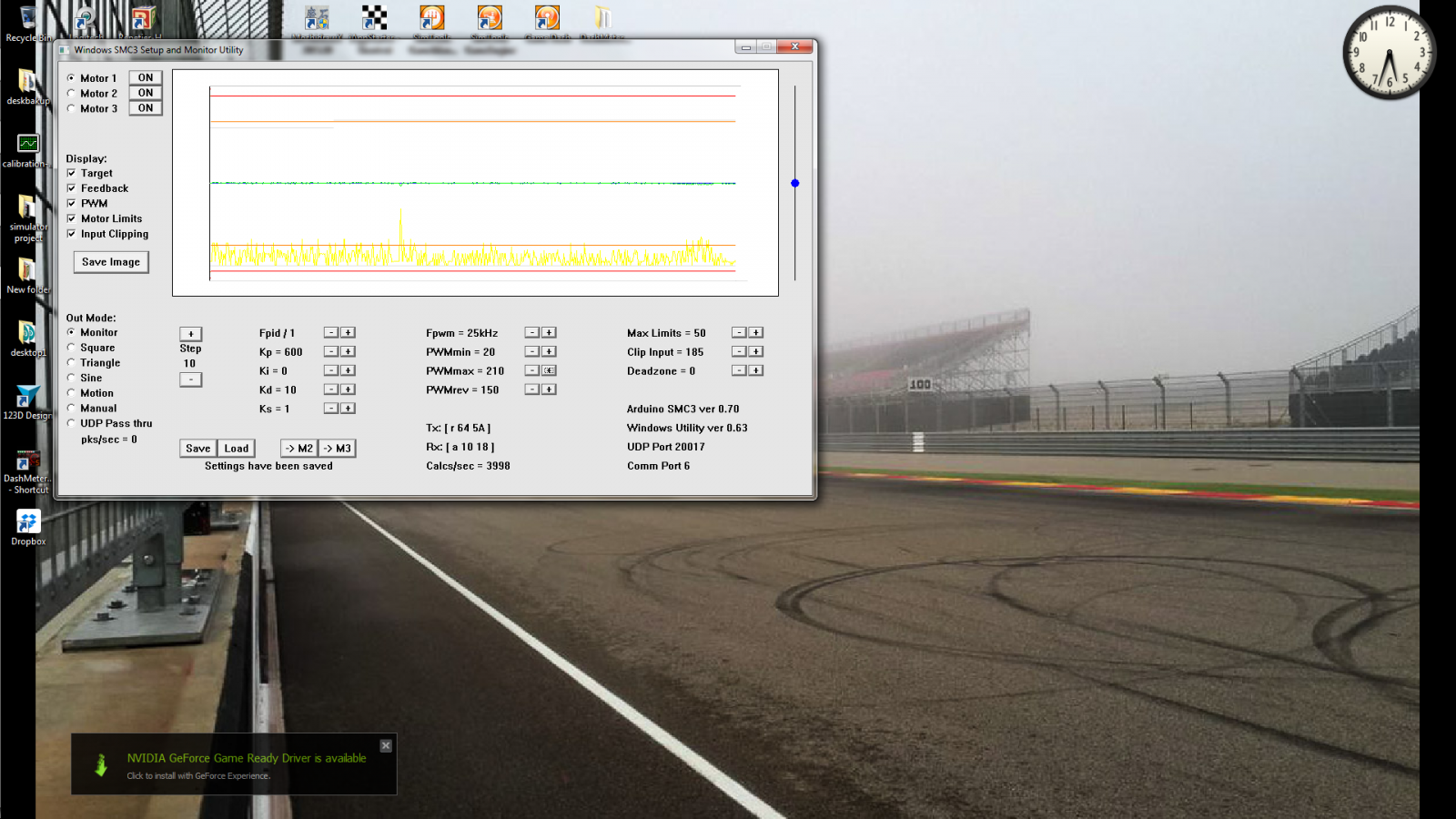

    Thanks @bruce stephen, so if you ever want to make your ride more or less aggressive, do you play with the PID values or is it done in SimTools?

    in simtools, but you can take the kp value down to reduce duty cycle

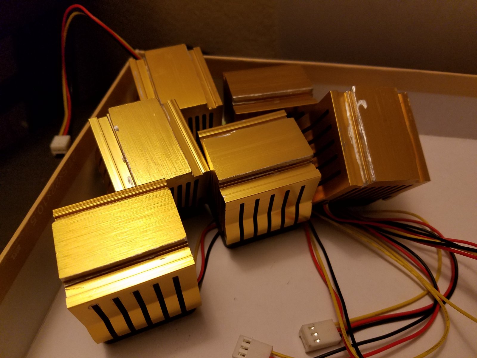

    Guys which way should the air blow on the heat sinks for MMs? I am using these coolers.

    Already trimmed :)
    From what I am reading, they are saying that it doesn't matter which direction air flow is. I hope they are right :)

    +272 / 1 / -0
    Positive pressure seems to be mostly preferred than negative pressure.
