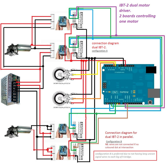

    Hi, i dont see a schema for battery with ACourant, i’m here :
    750w/24v=32A x3(approximate tolerance) =96A
    So I must have a power supply and card that tolerates 100A peak power and 35A idle
    So 1000w power supply for ibt2
    or 2000w for sabert 2x60a
    And 30-40a fuse everywhere to protect everything.
    And a 20a circuit draws a direct line from the table for the 4 actuators.
    :popcorn
    with this :
    https://www.xsimulator.net/community/threads/6-dof-350w-motors-with-ibt-2-43a-h-bridge.11538/page-2
    ibt2 x2 per motor:

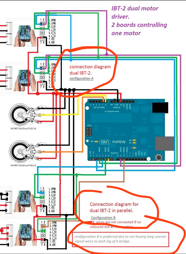

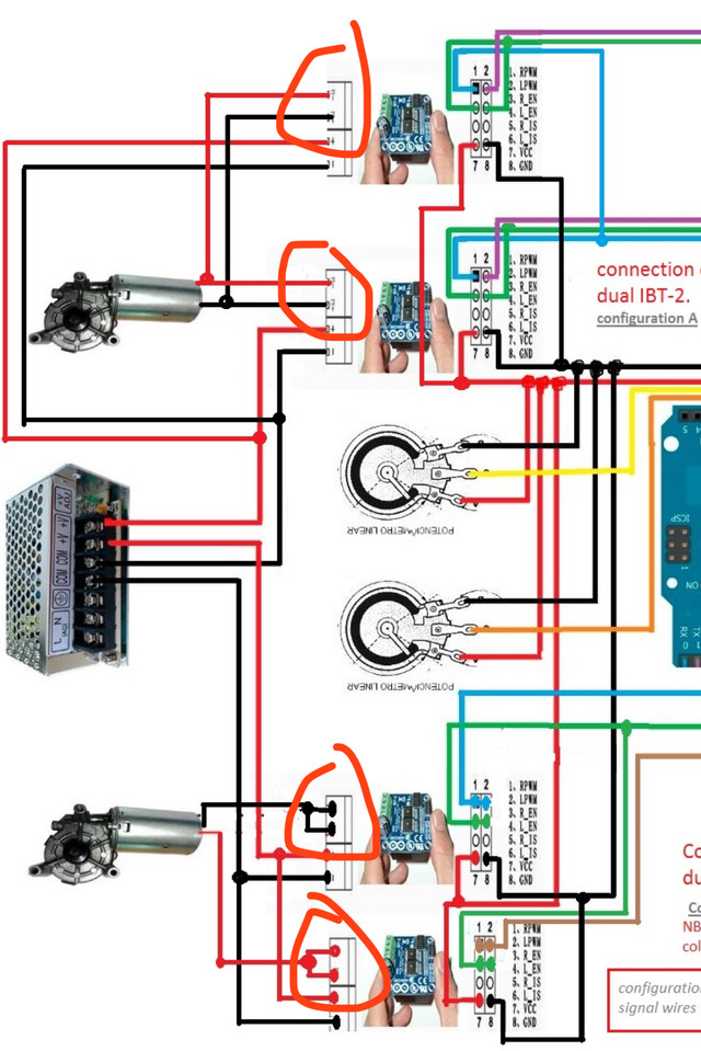

    Hi sry got one error? :nerd?
    sorry if someone could tell me which one is correct for 2 ibt2? because on a bridge on one side there is a card for the negative and a card for the positive and on the other side it is not the same wiring of the motors? Has anyone noticed this flaw on the diagram?
    Ok not see that lol ..
